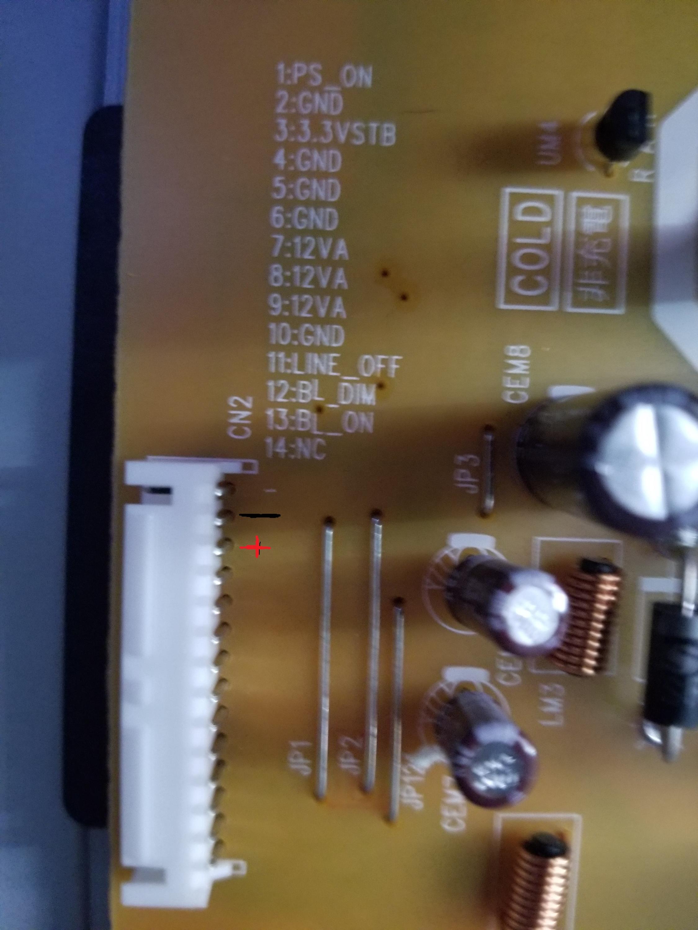

    With 20V DC and probes touching where illustrated I still have a reading of 0.
    Is there a separate 5V standby or were you referencing the 3.3V?

        Re: Vizio E500AR No Power
        STBY voltages is 3.3 in some TV's and 5V in others. Go by what is on your board, prolly says STBY_5V or similar?
            Yeah, pic confirms it's 3.3VSTBY

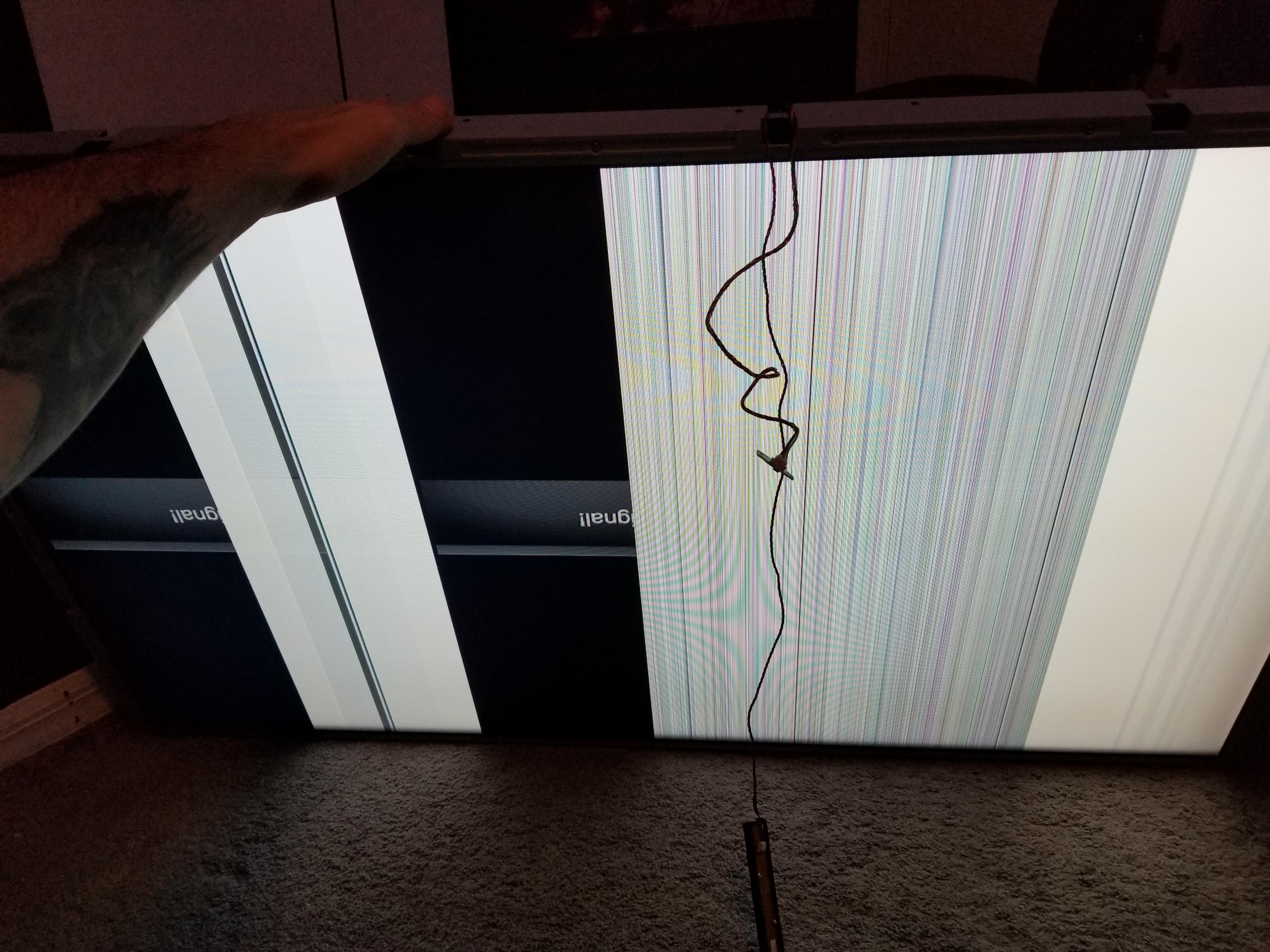

                          Bad news: Picture isn't. (see picture of picture).
                          I tried both mainboards and both sets of ribbons (have two of each now) to no avail. The picture remains nearly unchanged (came through a little clearer but with the same fragmenting).
                          What's my next step?

                            Worth noting that I cleaned and looked over the LCD pretty damned closely with a flashlight during the first troubleshoot to ensure it wasn't damaged (to the best of my knowledge).
                              #34
                              Panel problem.

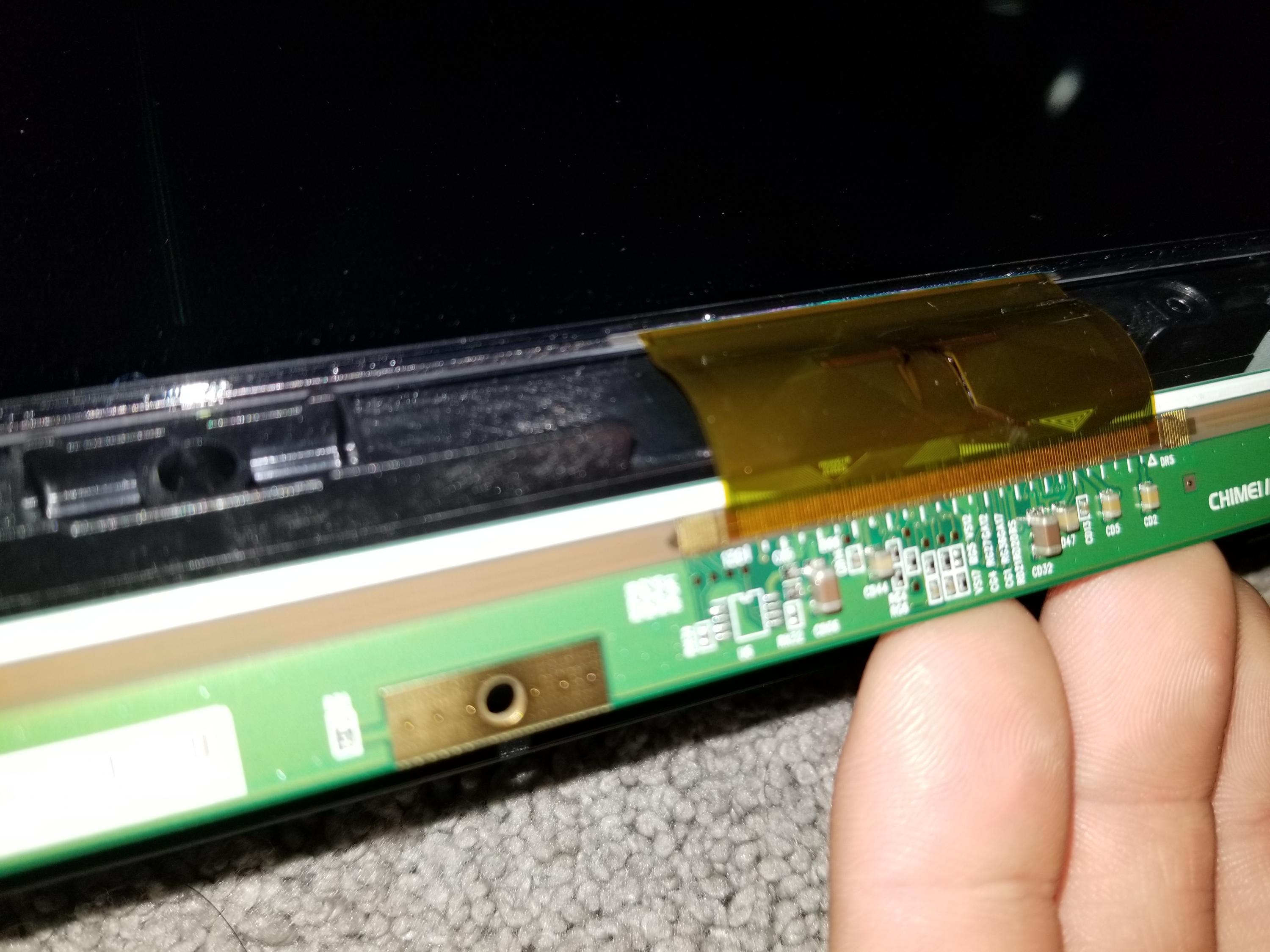

                                #35
                                Is there any chance of replacing this ribbon? There's some mild creasing in the others but this one is ripped (and I'm assuming the burning is a result).
                                Replacing the panel?

                                  #36
                                  Good chance I inflicted this damage when I took it apart all the way. Won't ever know, but lessons learned the hard way!
                                    #37
                                    No, you are out of luck.
                                    You need to buy the new screen, expensive.

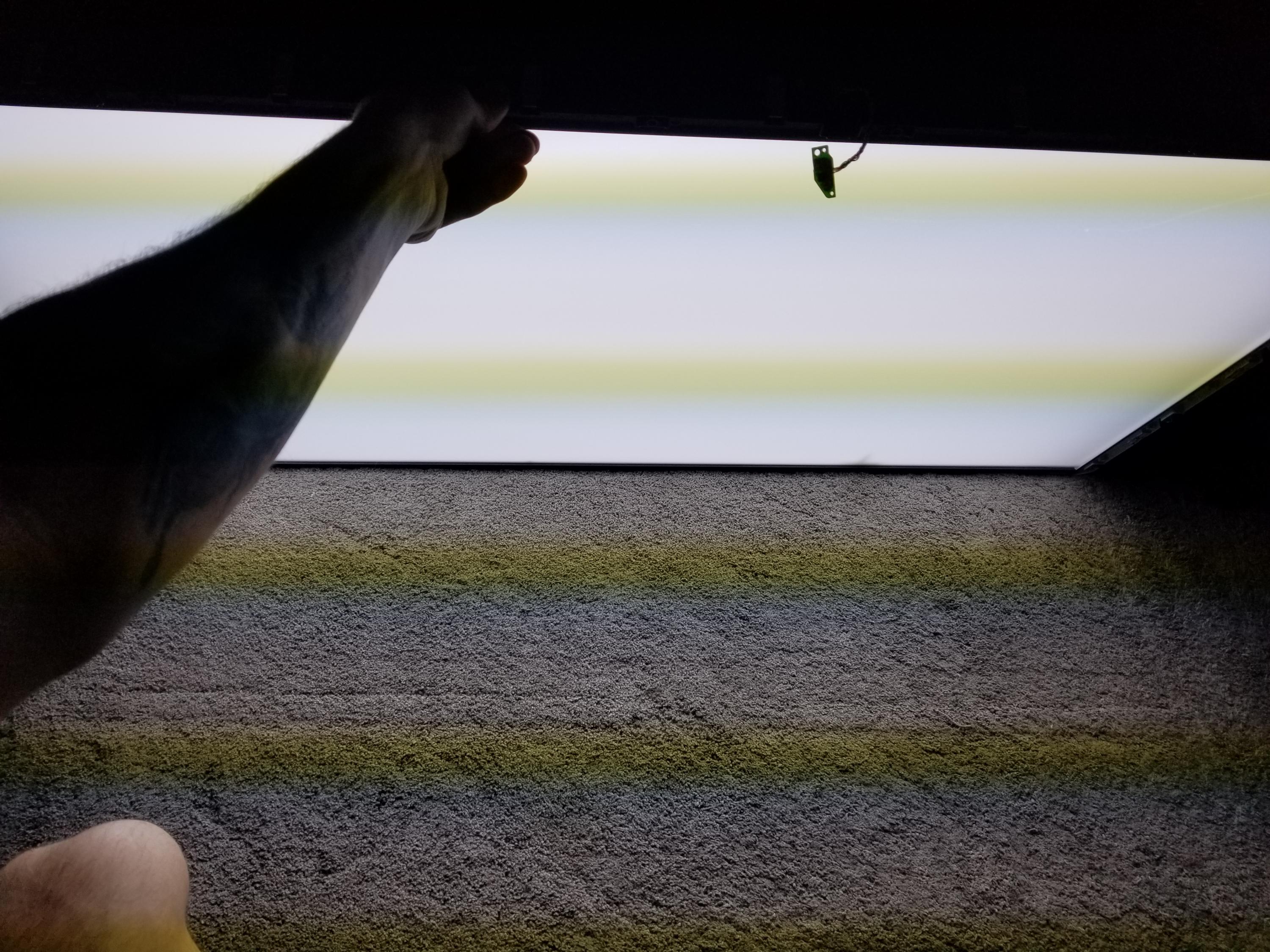

                                        #39
                                        Backlighting is really strong. Thinking about putting it back together and using it as a lamp for the garage, haha
