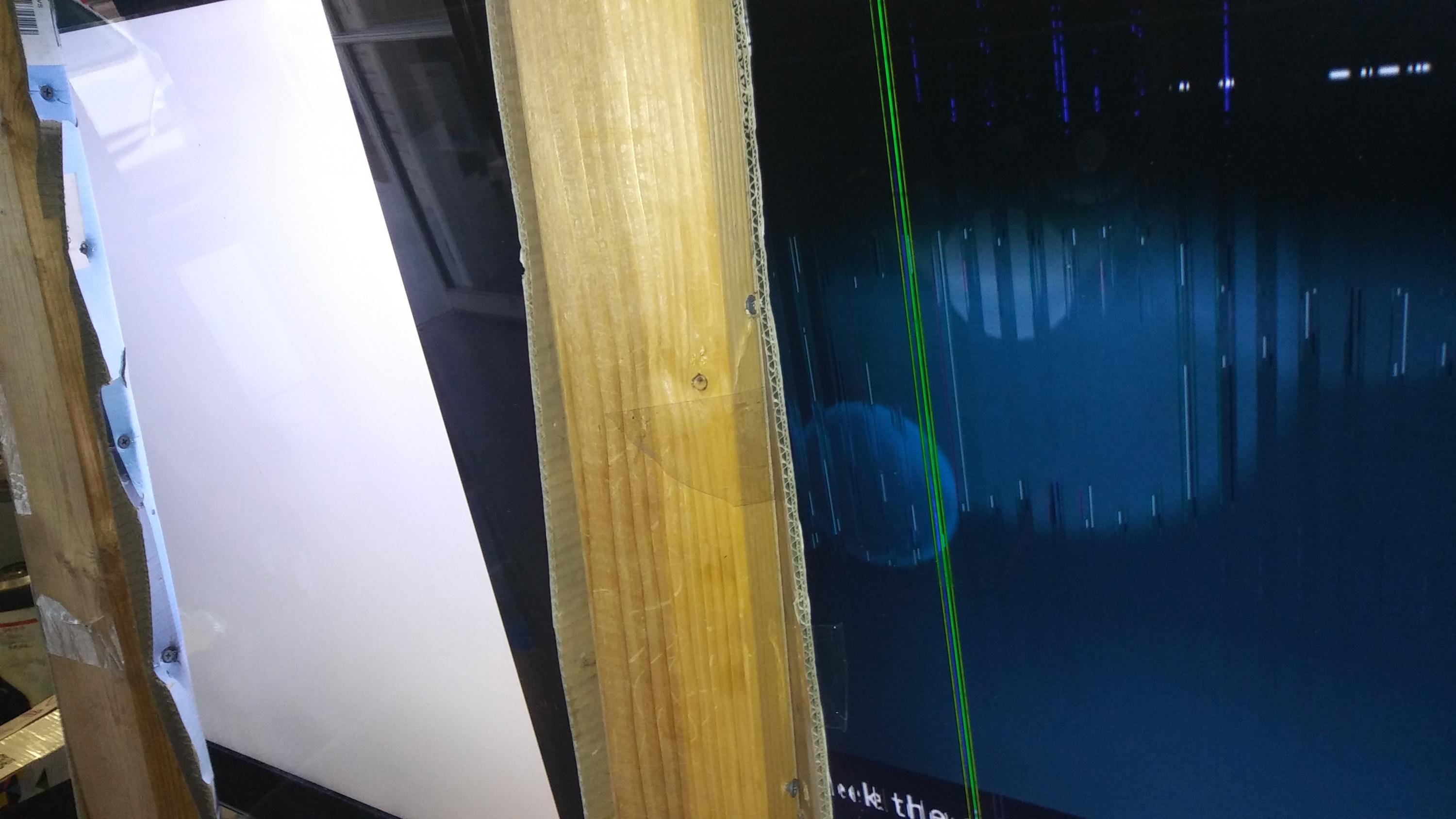

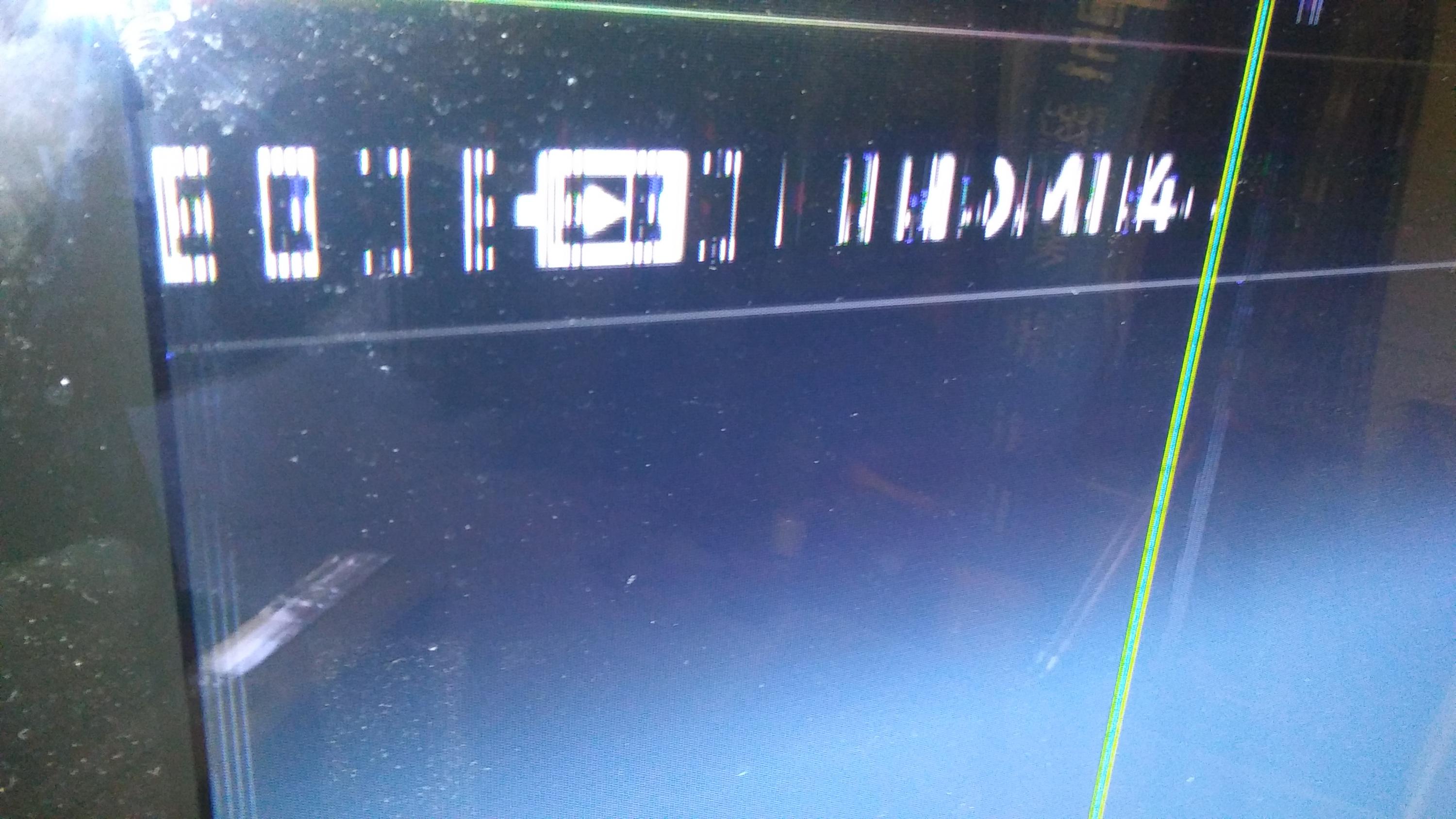

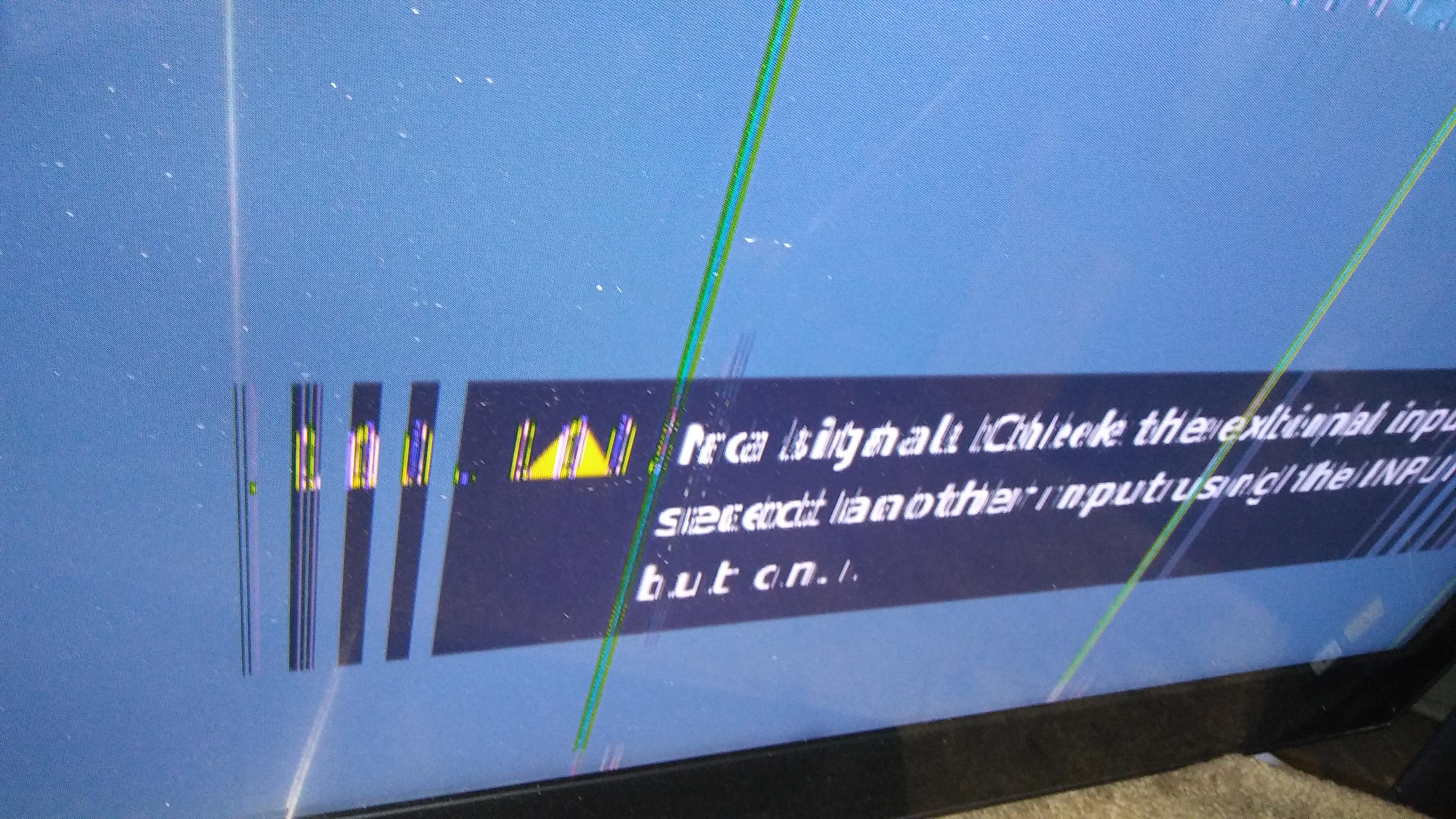

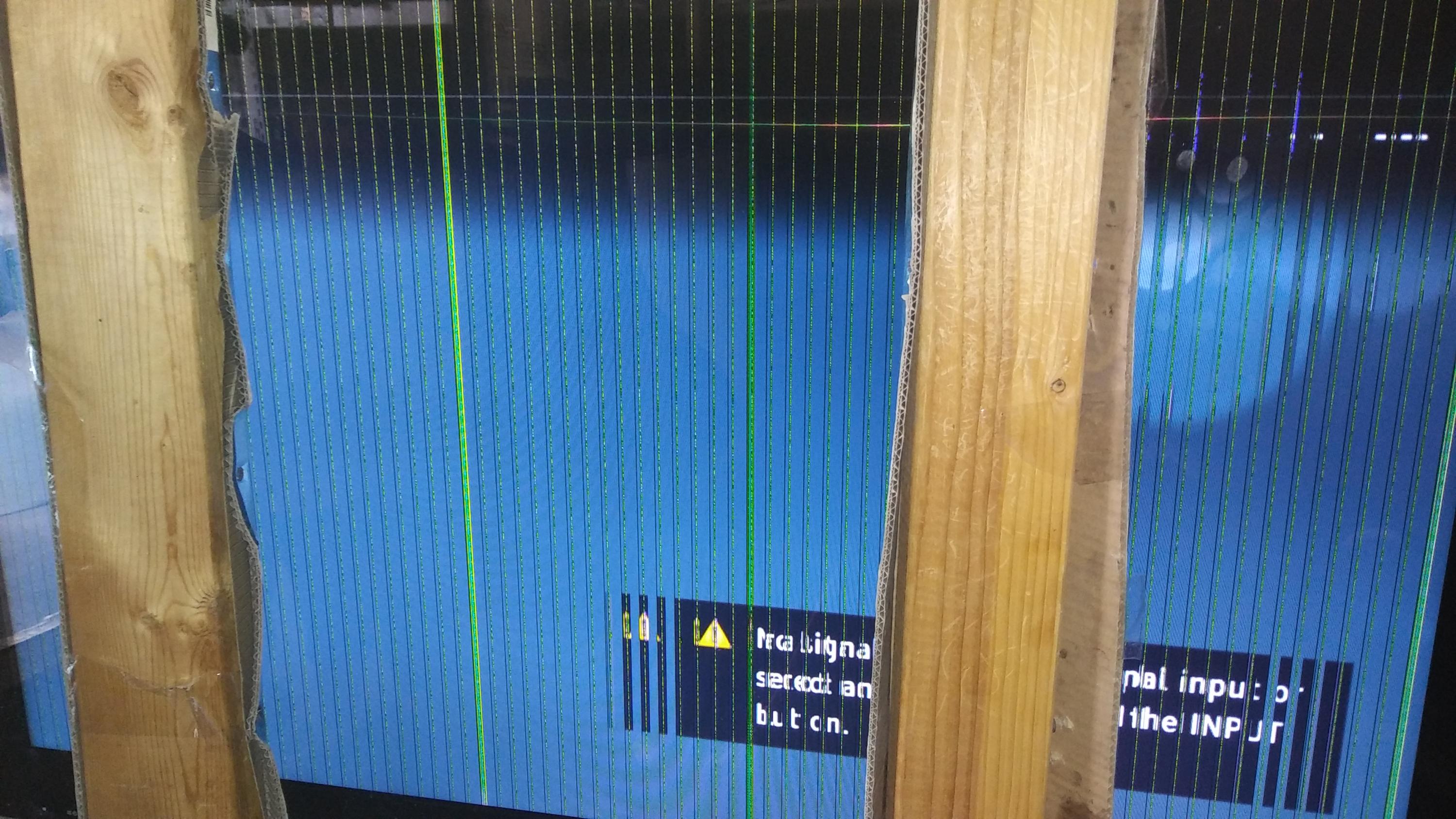

Sony KDL52NX800 lines in the picture.
  • capwizard
    • Jun 2016
    • 1991
    Sony KDL52NX800 lines in the picture. this symptom is screen problem?

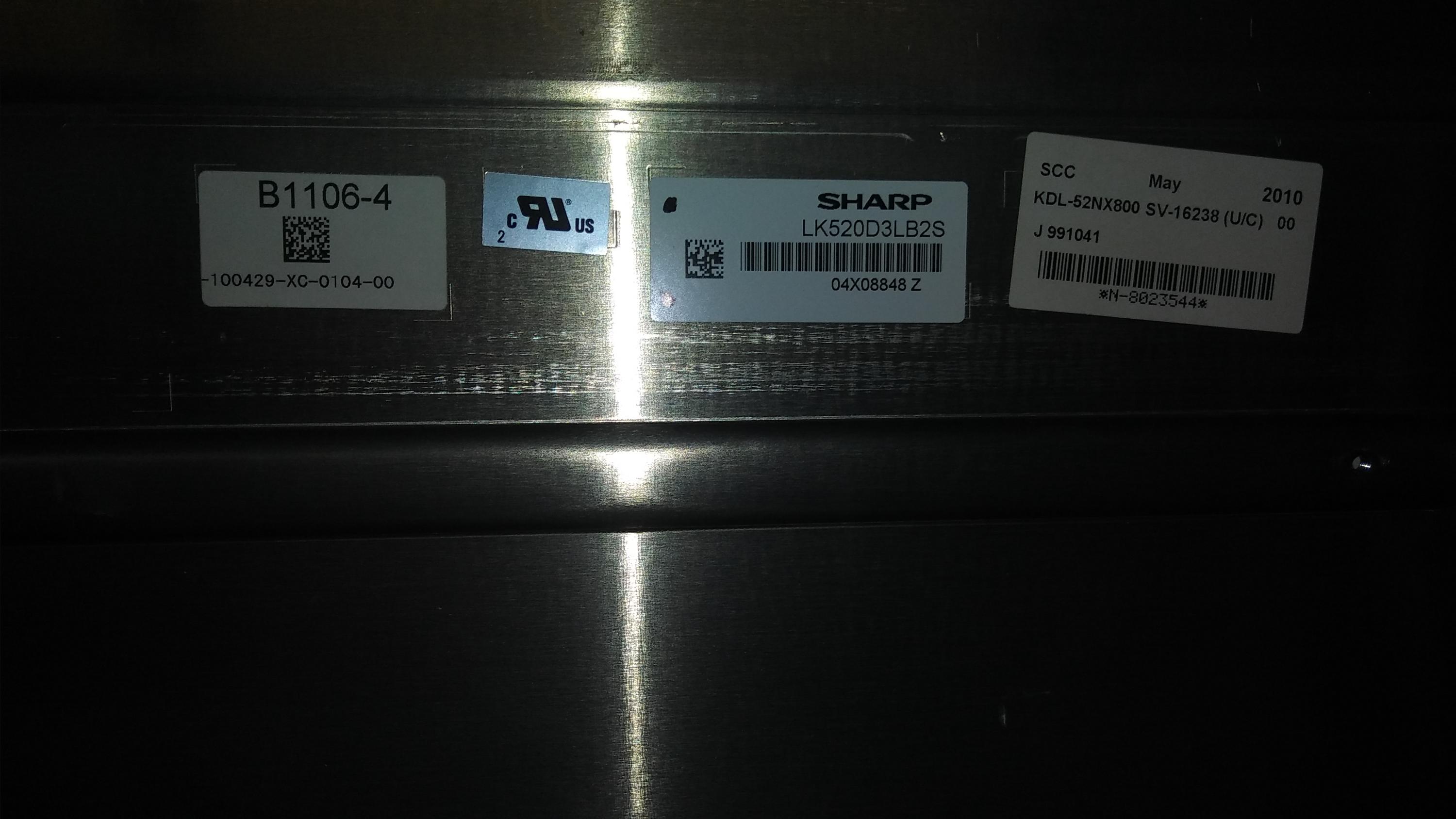

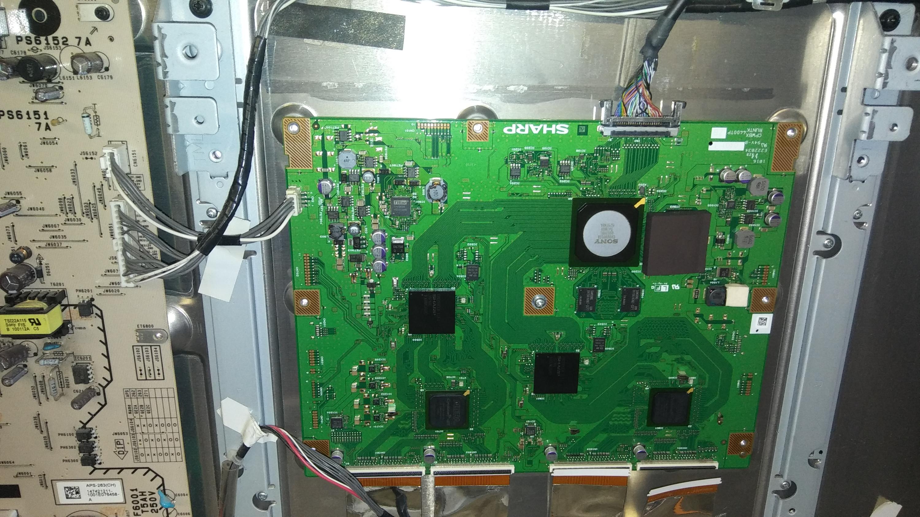

    Screen has 4 flex cables go into. Fist take 2 off then other 2 flex cable.
    Yes it is Sharp panel.

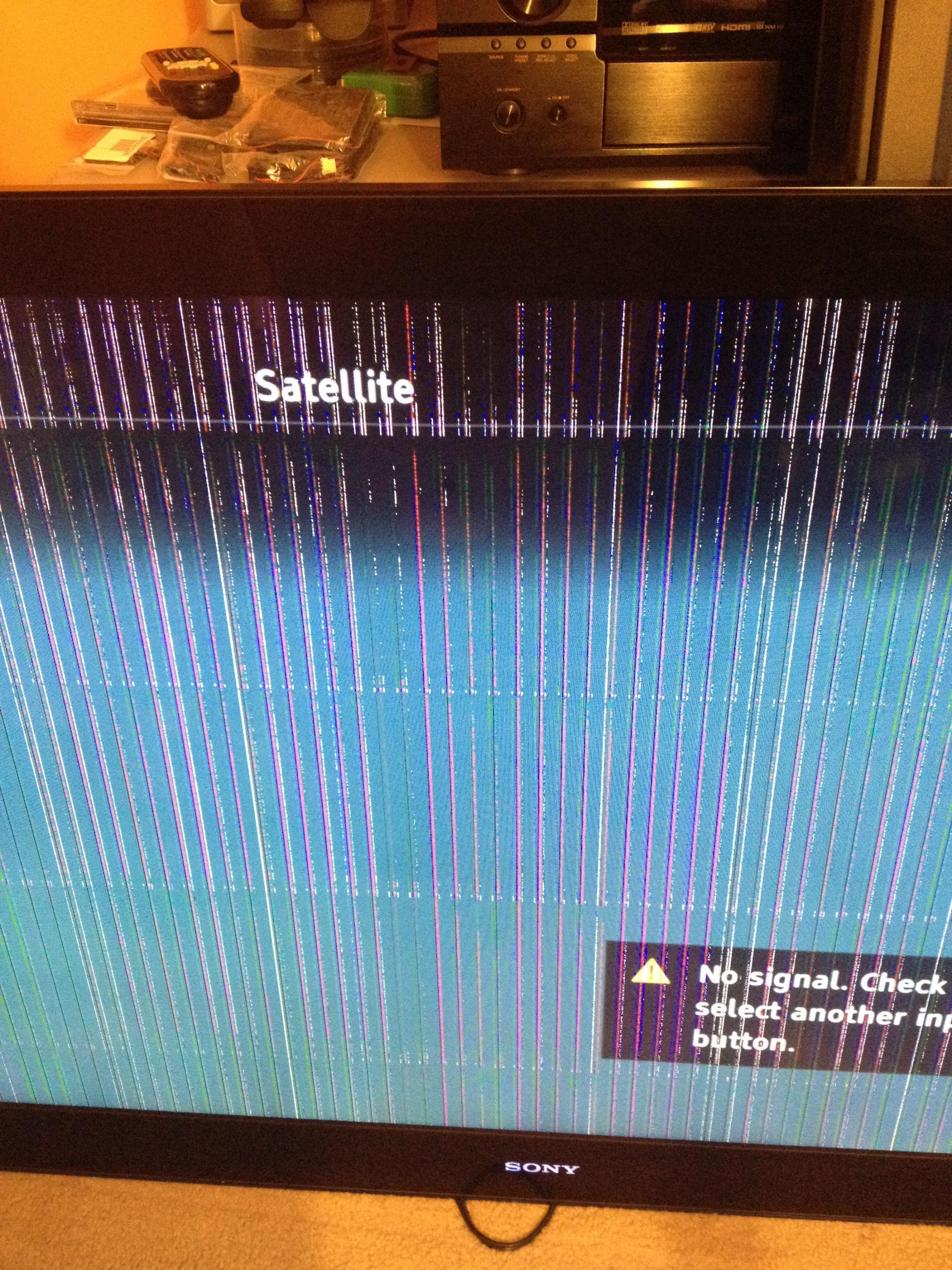

    Re: Sony KDL52NX800 lines in the picture.

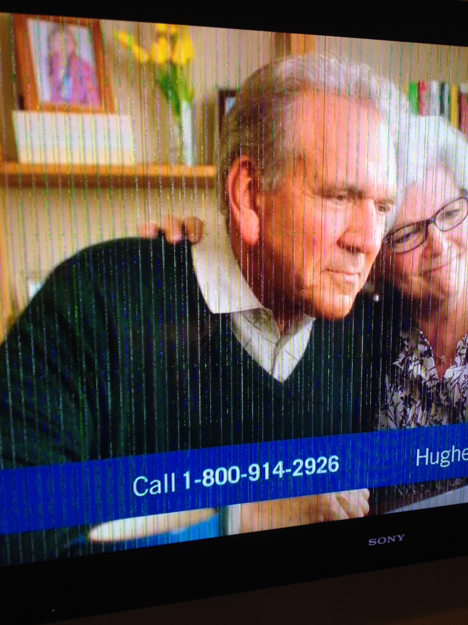

    It looks similar to the pictures I save from one of the SONY thread, do not remember which one it was but it was bad T-CON according to OP.
    • capwizard
      • Jun 2016
      • 1991

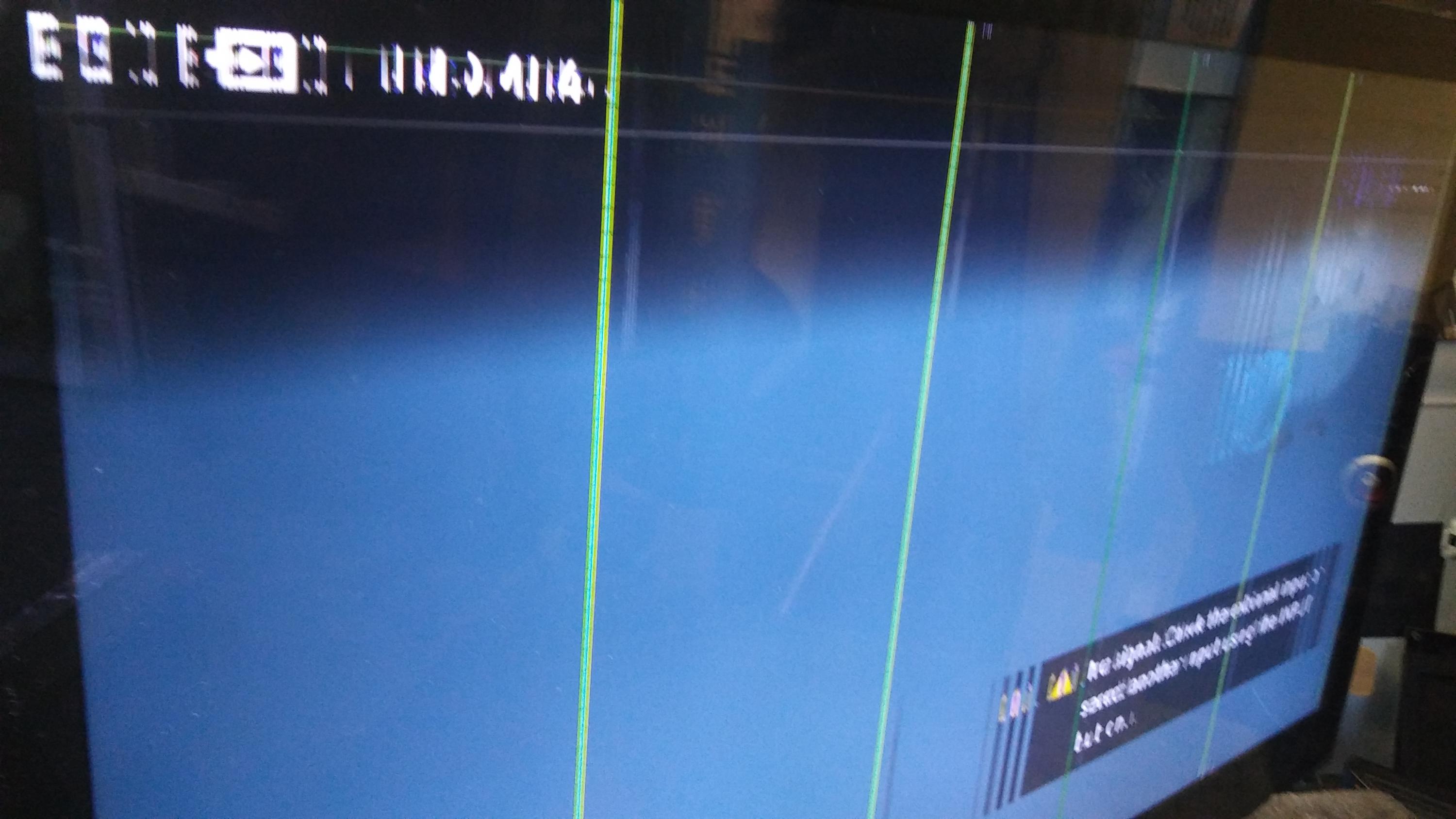

      Thank you very much
      T-Con Board RUNTK4400TP CPWBX before I order T con I will reflow and oven bake. See what happens?
      I will be back.
