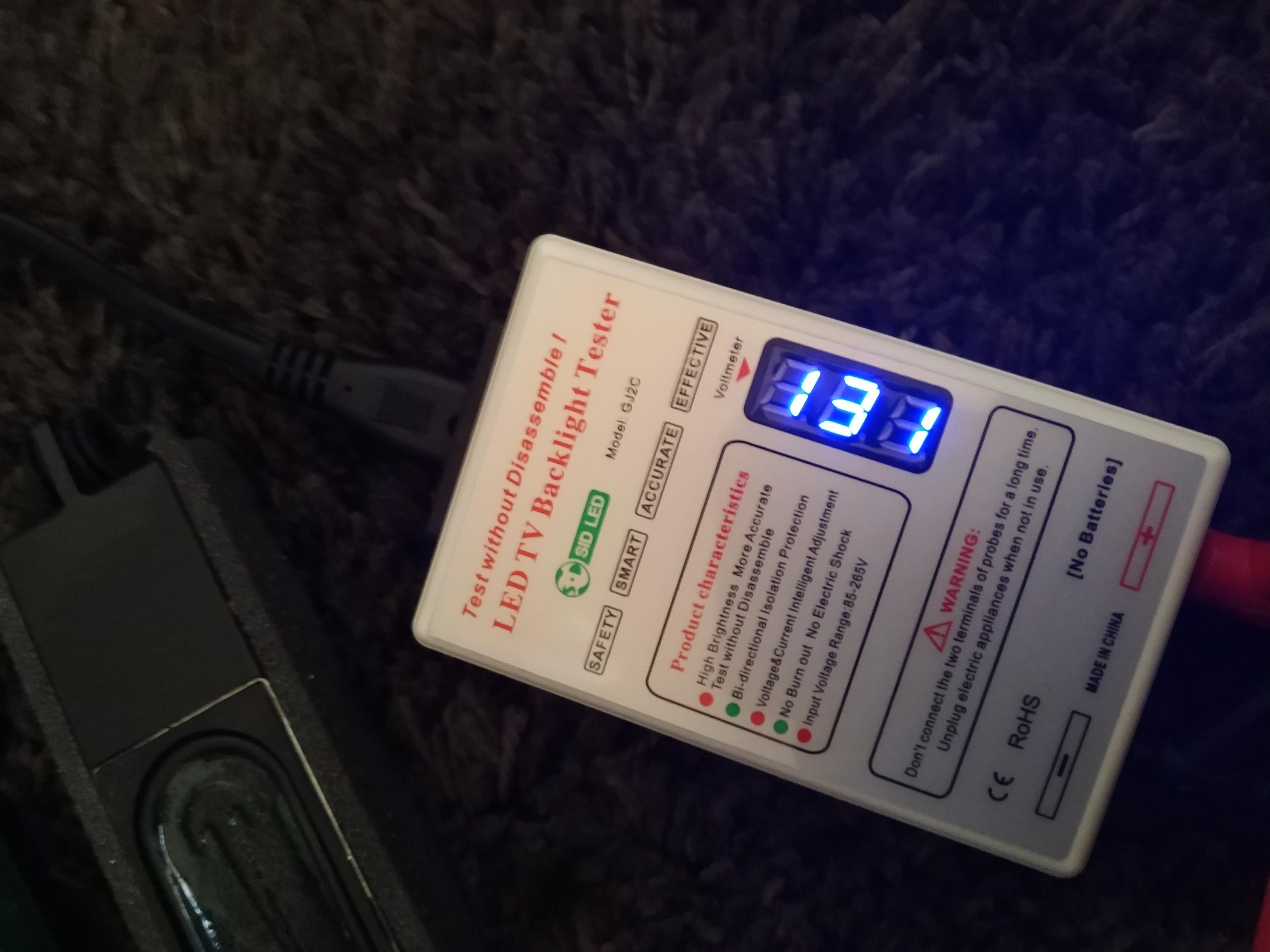

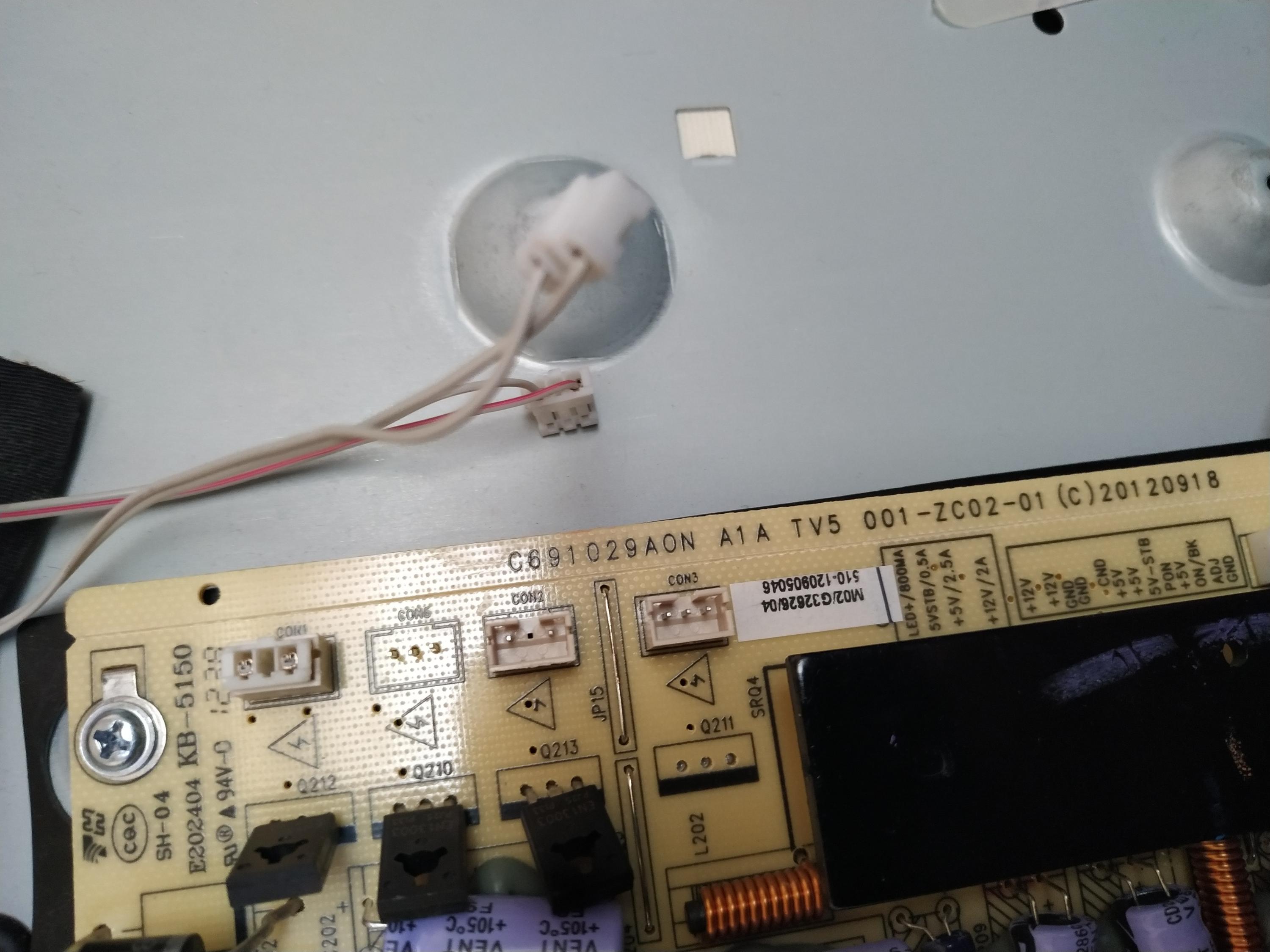

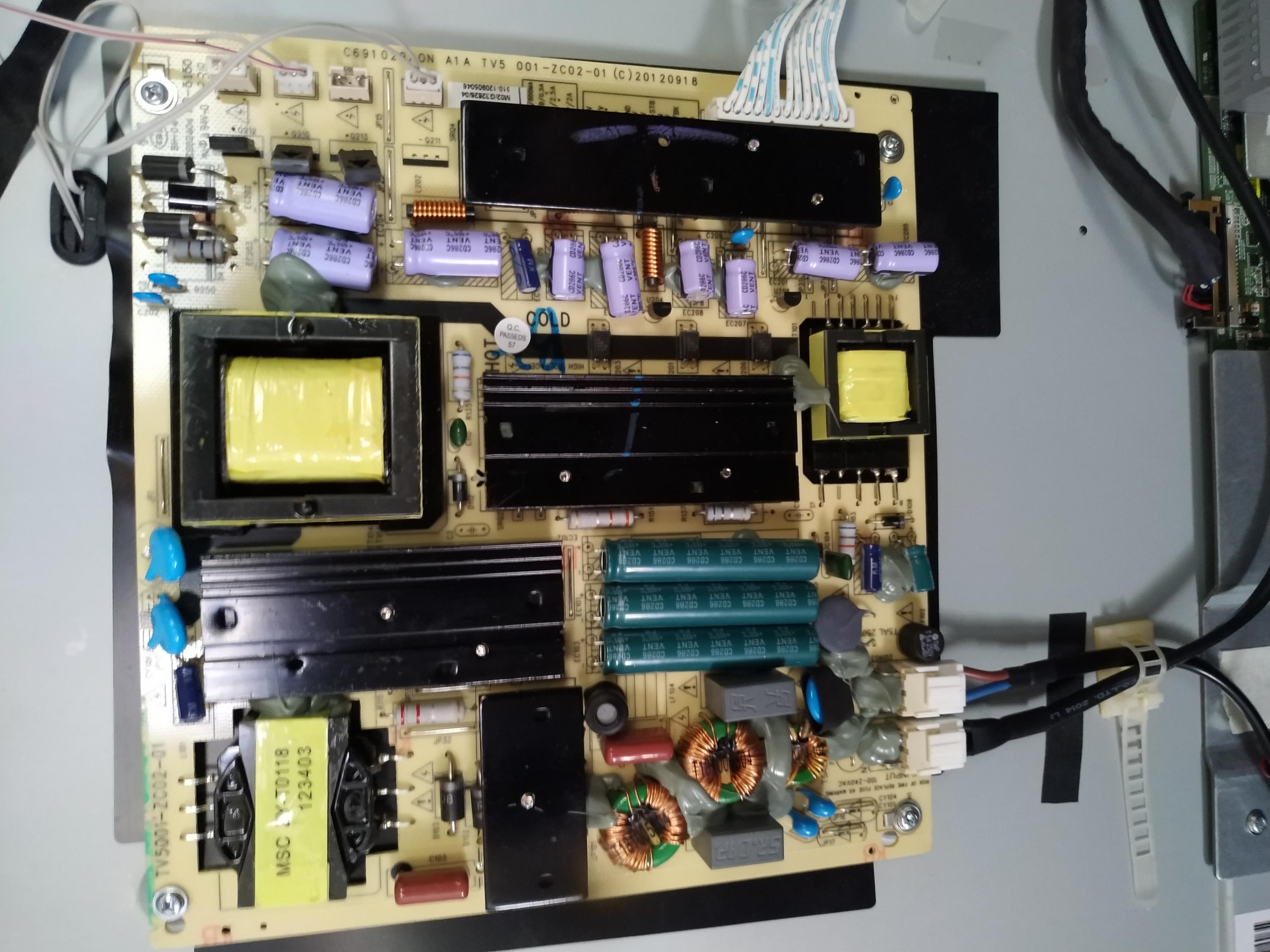

    Can I get some assistance please?
    I have this TV that backlights won't come on at all, I can jump them with the backlight tester okay & the voltage is 131v on each connector.

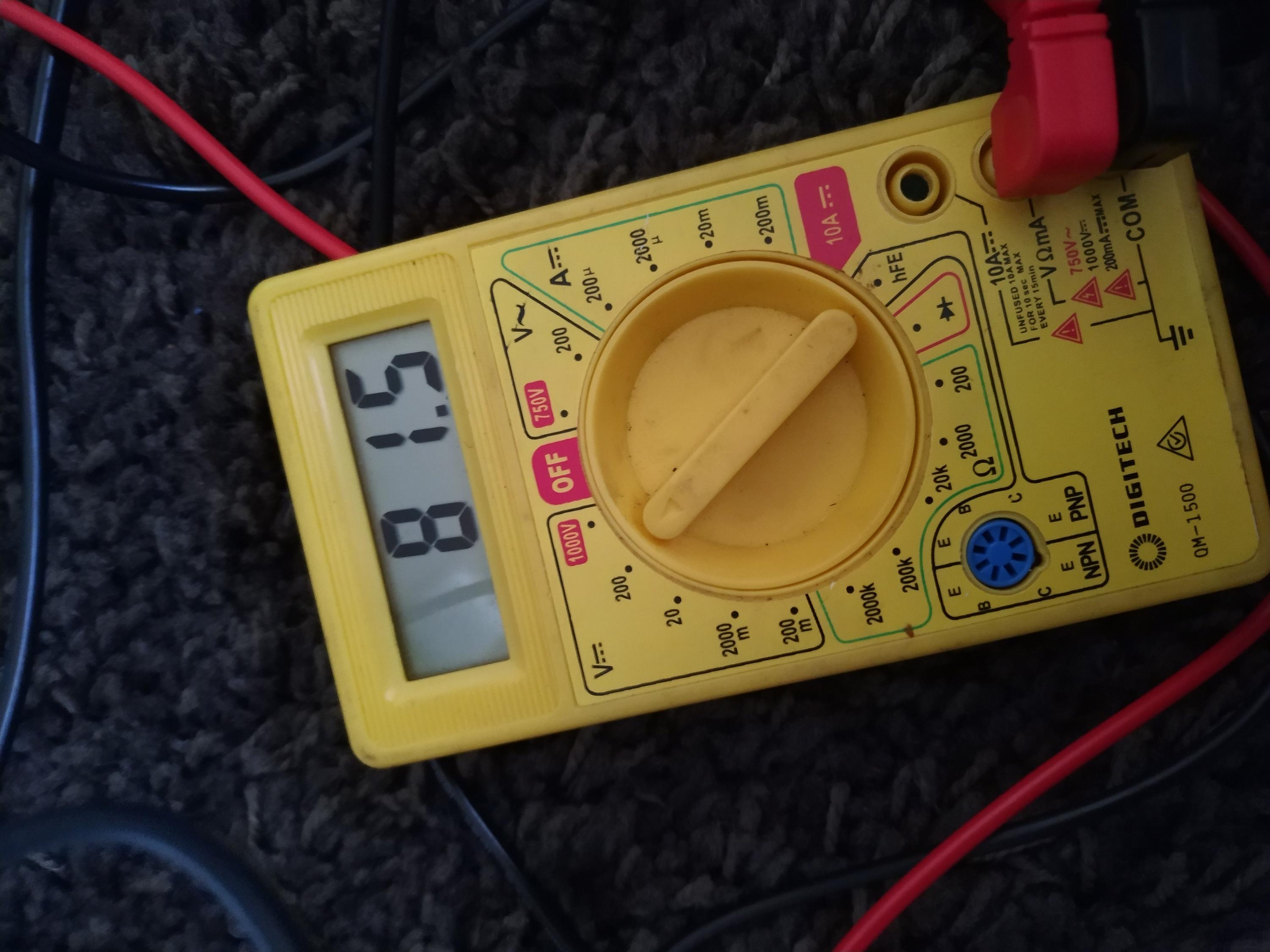

    The voltage from all 4 power supply connectors is 81.5v with reference to chassis ground.
    But still no backlight?
    Re: Help with Backlight voltages DS GE6880
    1) Make and model of the TV?

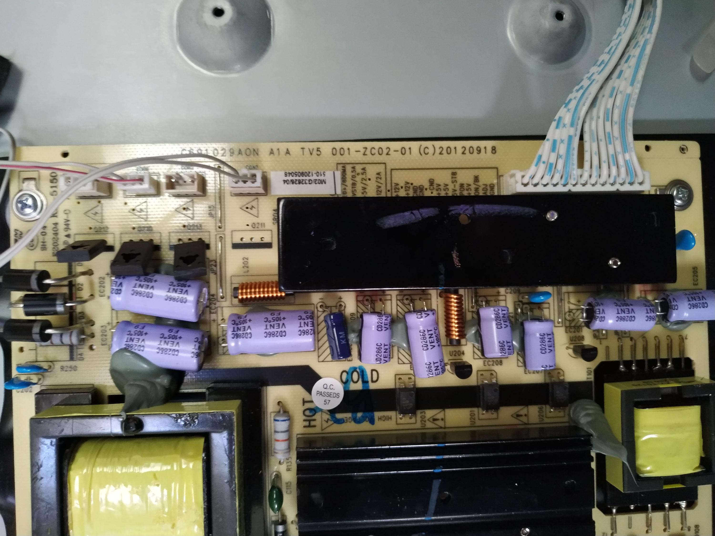

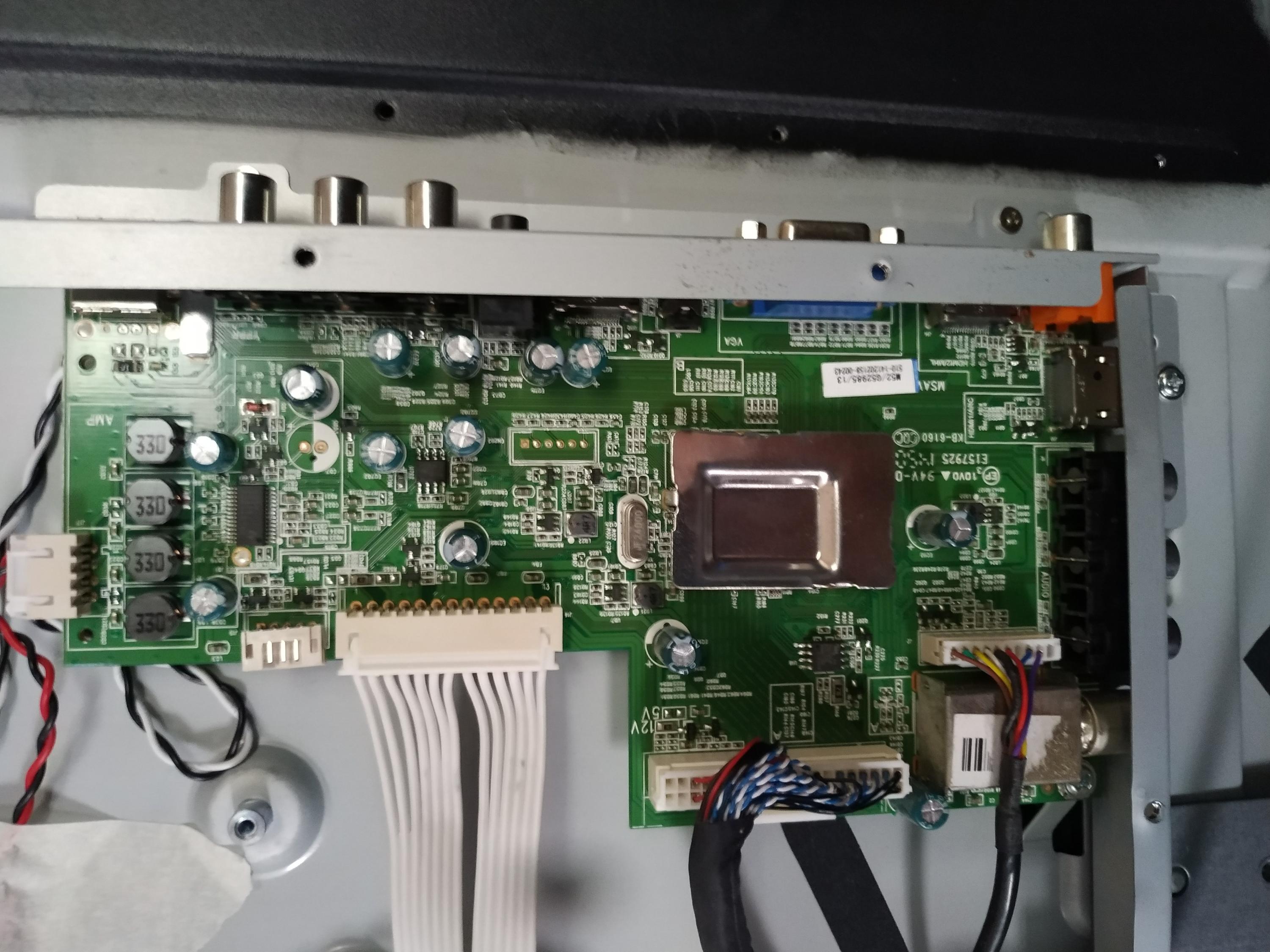

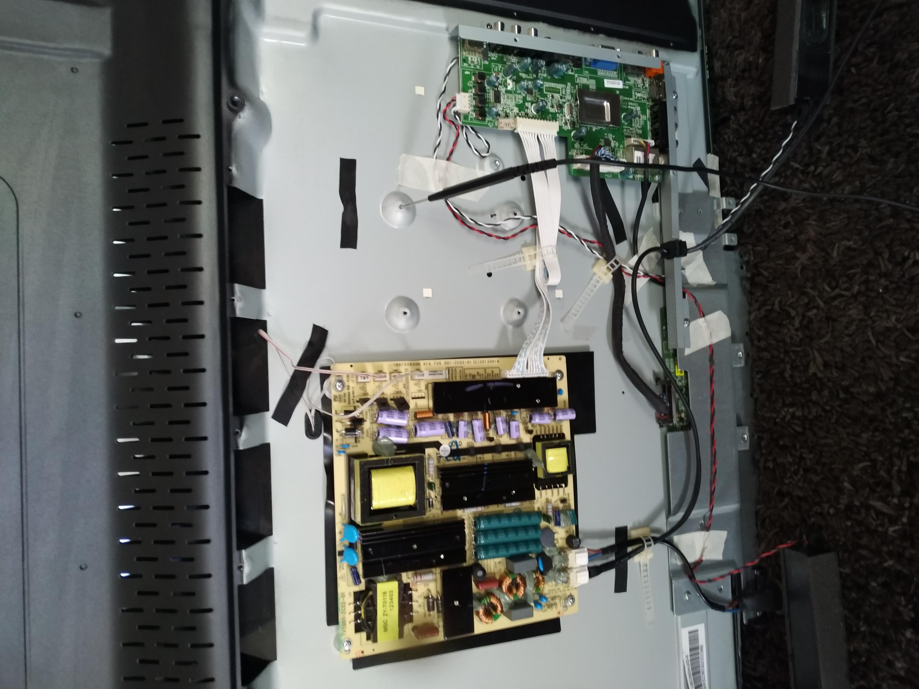

    2) Pictures of the whole backside of the TV showing all the board?

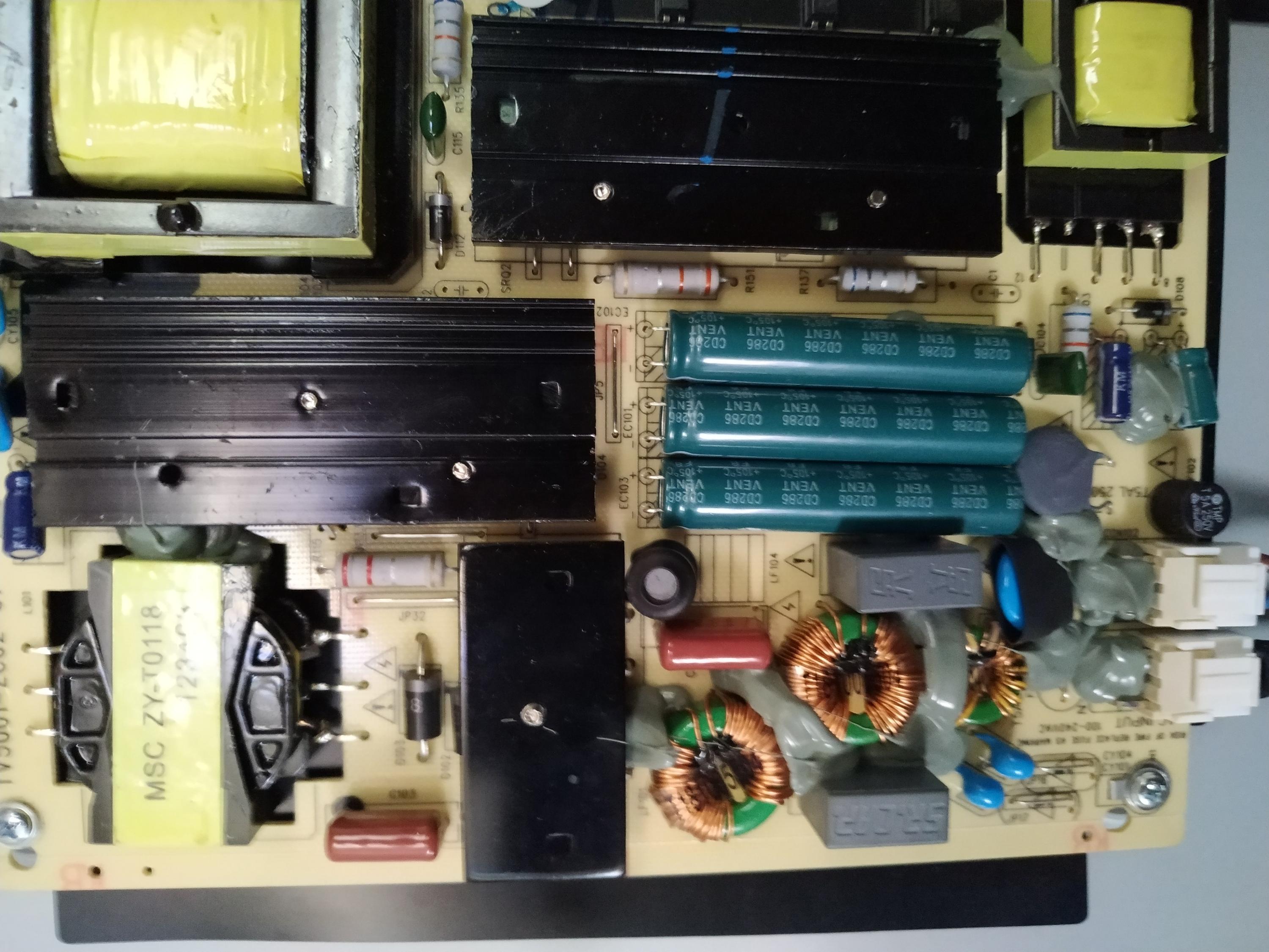

    3) Pictures of the whole top and bottom side of the power supply/LED driver board?
    4) How high does the Voltage jump up to at the LED + if you leave the Black probe on the chassis and Red probe on the LED+ and then turn on the TV?

      1) Dick Smith GE6880
      4) 109.7v then down to stable 81.5v ( I don't have a min/Max function on my Multimeter but it's close to 110v
