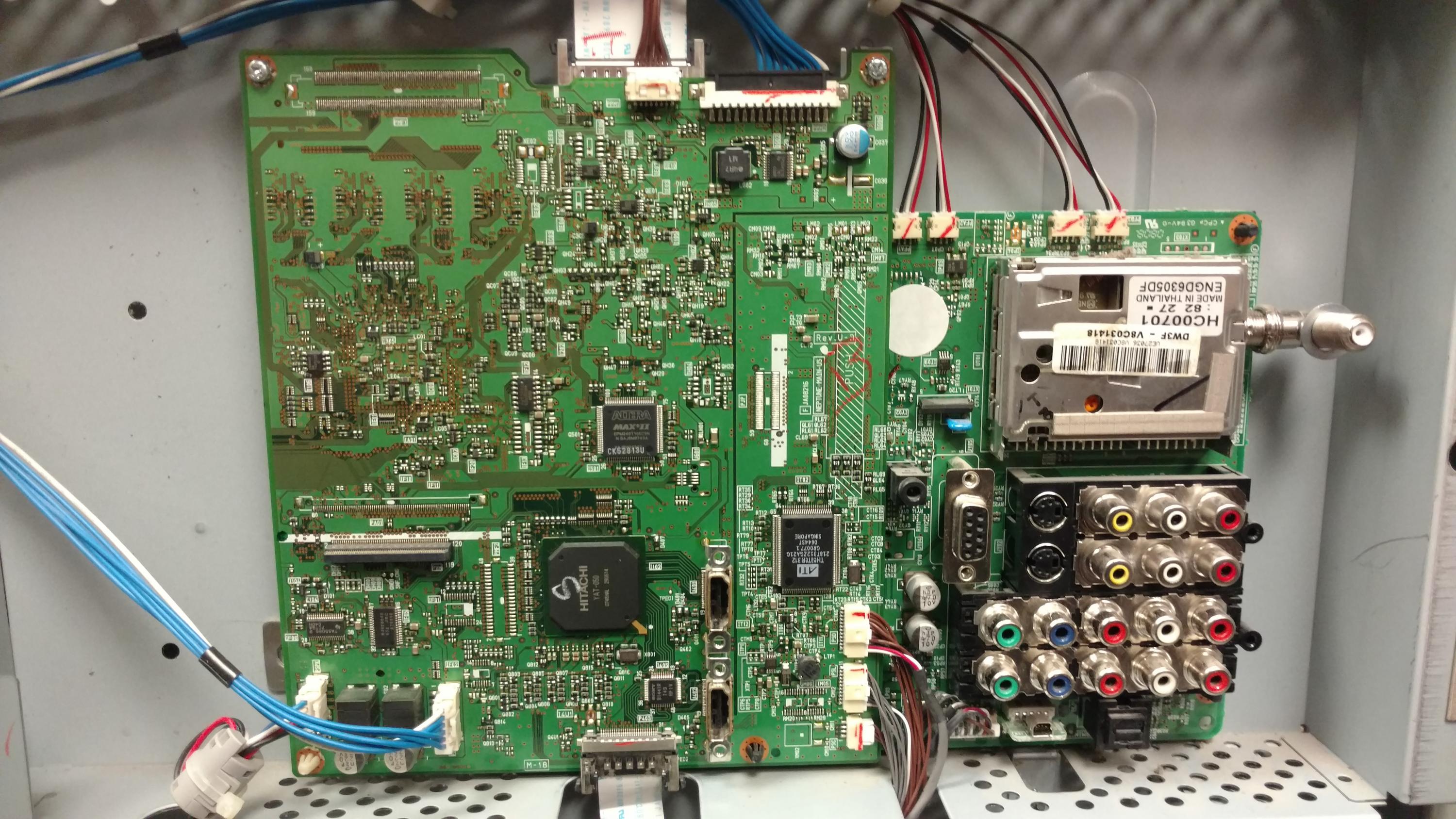

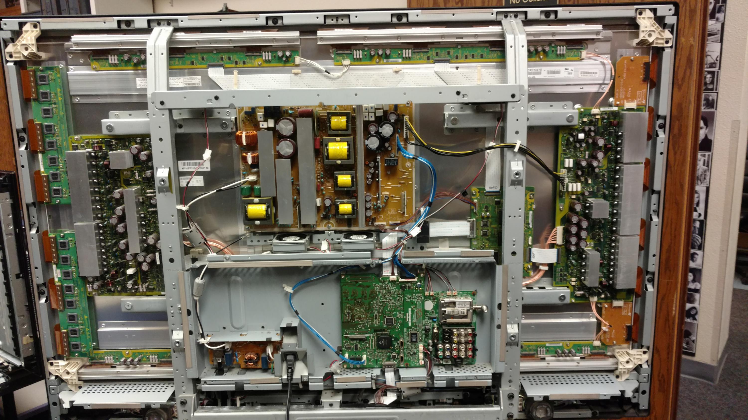

    This is my office TV and came back to work after the weekend to find the TV with blue power light on (which is normally the on state), but no picture. Power had gone off over the weekend in the building. Also, found that TV was plugged into a 3 prong outlet surge protector with the ground prong cut off sometime in the past. Tried resetting the AC and found that it clicks on when plugged in, no panel prime, blue LED turns solid, can hear fans come on, then another click as if it's shutting down, but blue LED stays on. Pressing power will not do anything; it's just stuck that way.

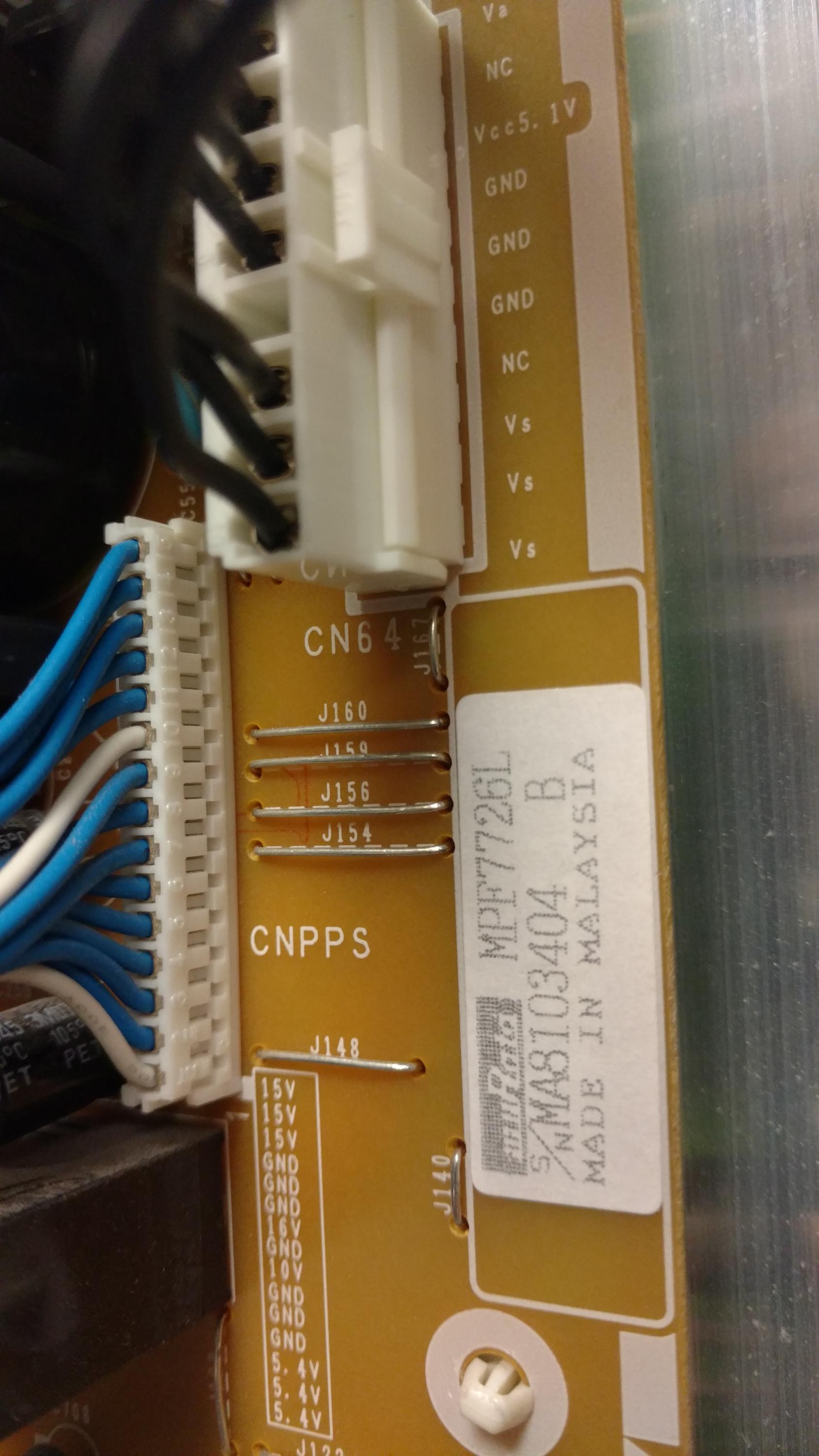

    connector: CN64

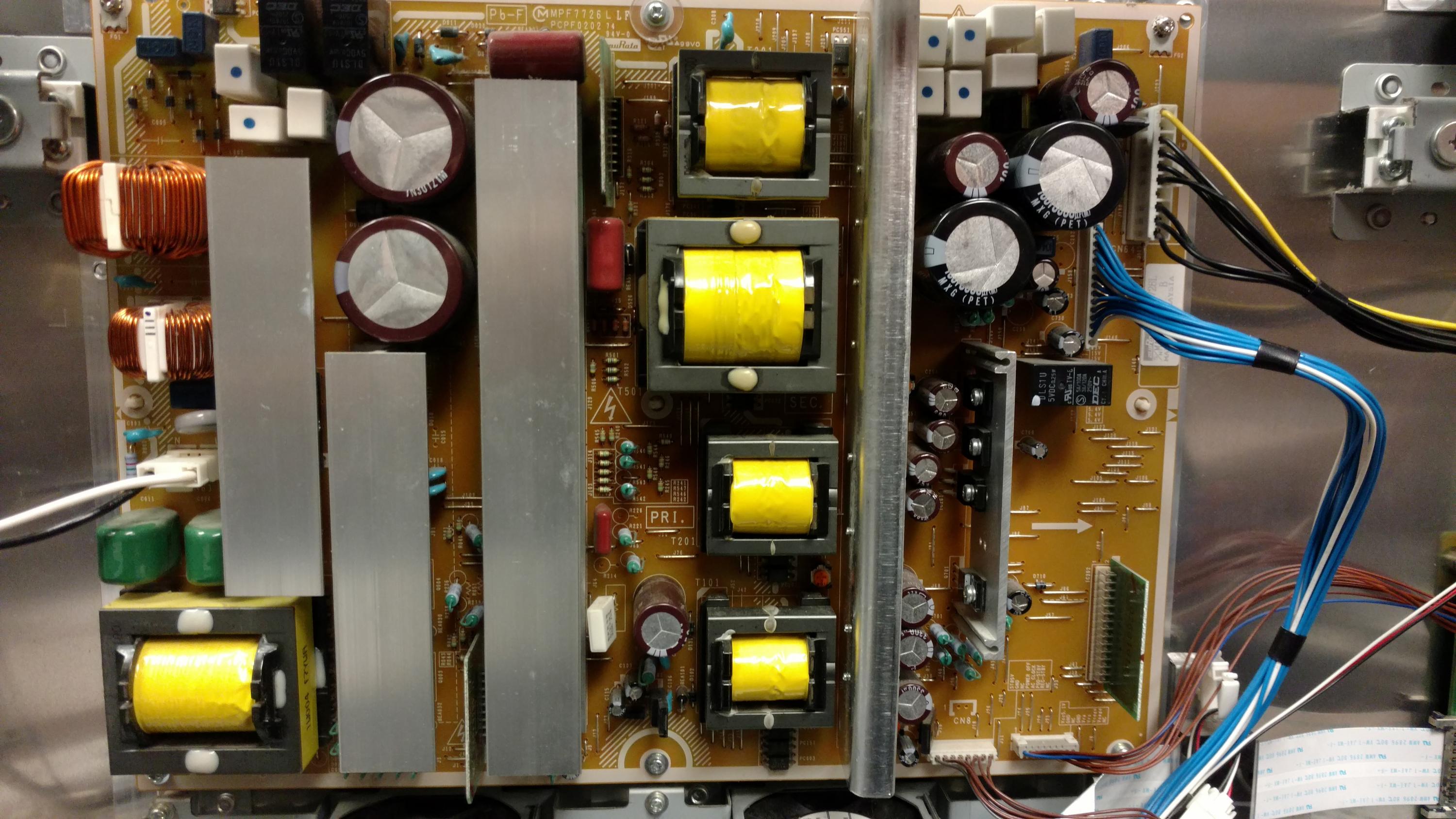

    VA: goes to 4.0v at initial click, then to 66v (full) when fans come on, but goes back to 4.0v when shutdown click is heard, then slowly to 0v.
    VS: goes to 4.0v at initial click, then only to 66.6v (full is 89.5v) when fans come on, but goes back to 4.0v when shutdown click is heard, then slowly to 0v.
    Vcc5.1: goes to 5.1 after initial click, but drops to 0v when shutdown click occurs.
    connector: CPPS
    15v: comes up to 15v at initial click, drops to 0v at shutdown click.
    16v: comes up to 16v at initial click, drops to 0v at shutdown click.
    10v: does not come up (0v)
    5.4v comes up to 5.6v at initial click, drops to 0v at shutdown click.

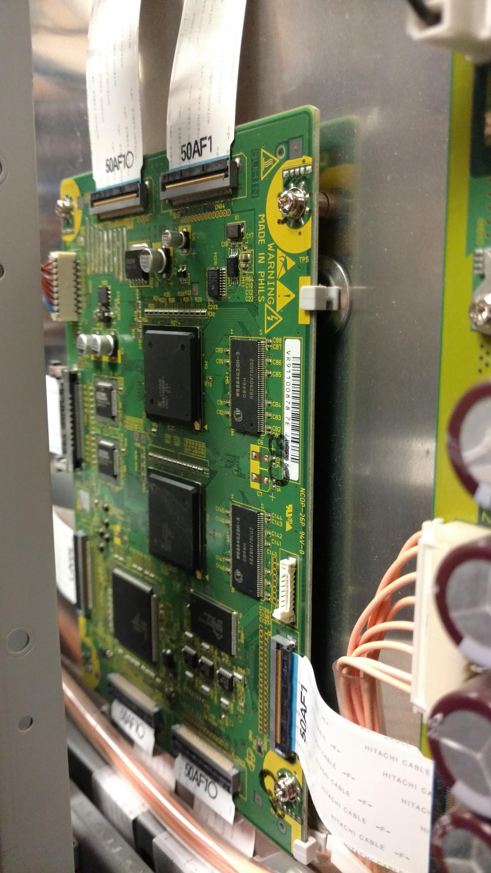

    Logic board replaced (used) no change in symptom.
    Main digital board (used) (the one with the HDMI connectors) replaced and no change in symptom.

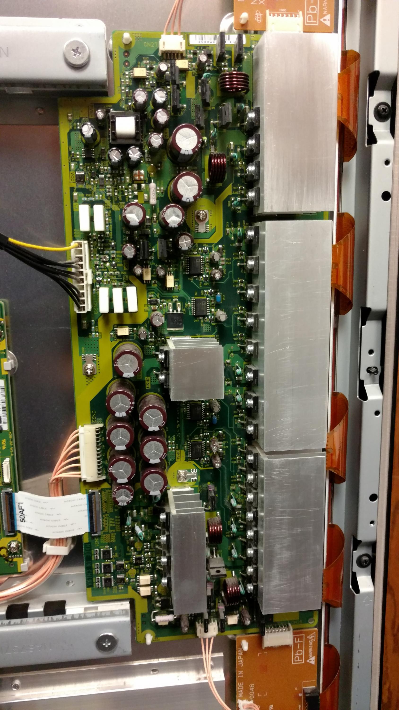

    Note: I've also removed both Y-DRV buffers completely and no change in symptom.

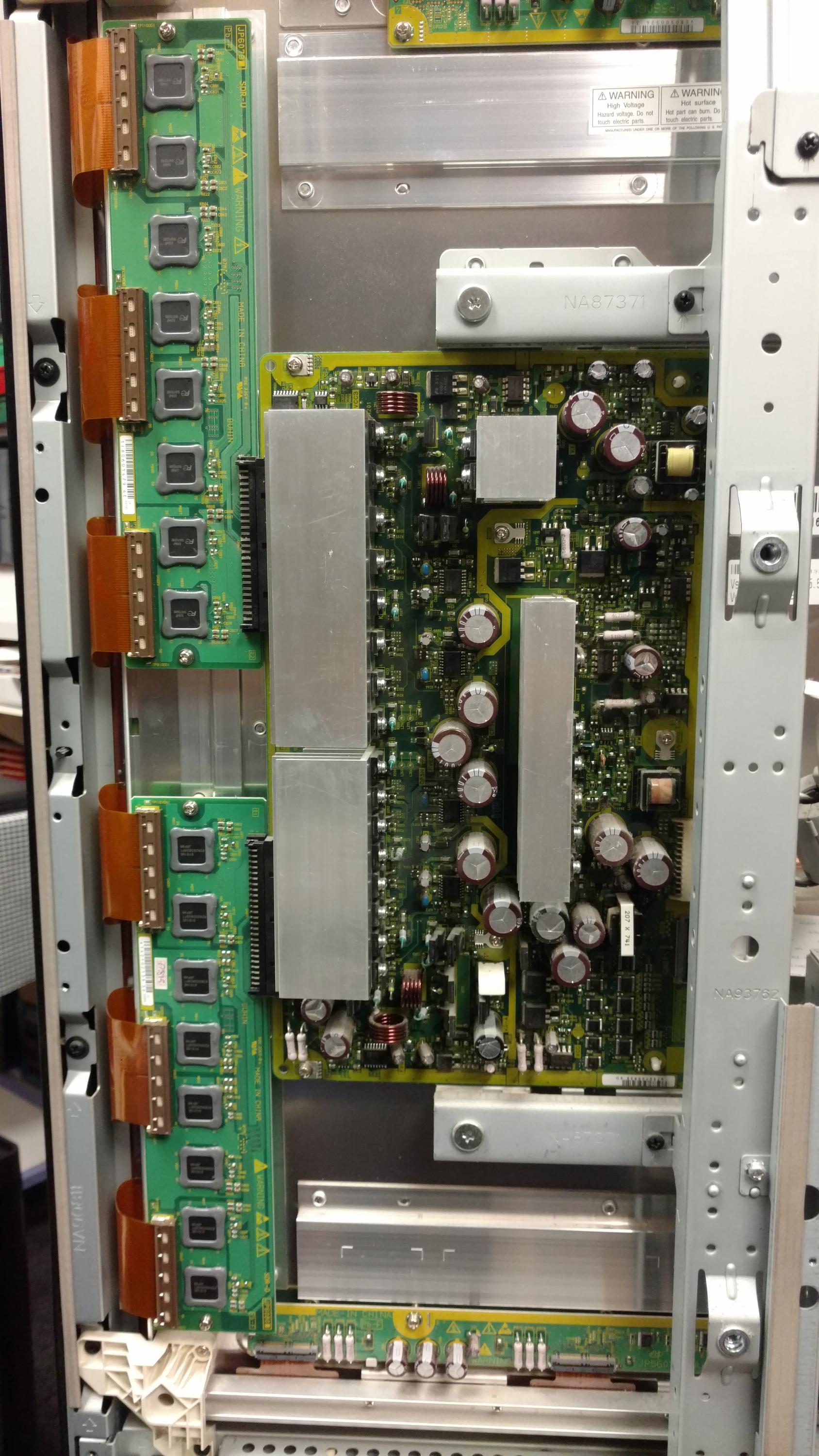

    Here's the photos:

      Someone told me you can't remove both buffers at once, is that true? Should I try removing one at a time? Also, I'm concerned that the logic and main I got could have been defective, too, but need to confirm before trying additional boards.
      • R_J
        • Jun 2012
        • 9550
        Re: Hitachi P50S601 - No prime, Solid Blue LED, can't turn off
        You can check the buffer boards with your meter using diode test, I do believe you can disconnect both, but I know you can run with upper or lower by themselves, just don't run it for a long time.
              I did the buffer removal tests one at a time and no difference, TV still shuts down in same way and VS still only goes to 66v before shutting down. Anyone have anything to try? Any help?
              • R_J
                • Jun 2012
                • 9550
                There is likely a fault on the Y-sus board, There are no schematics for these boards so they are very hard to troubleshoot.

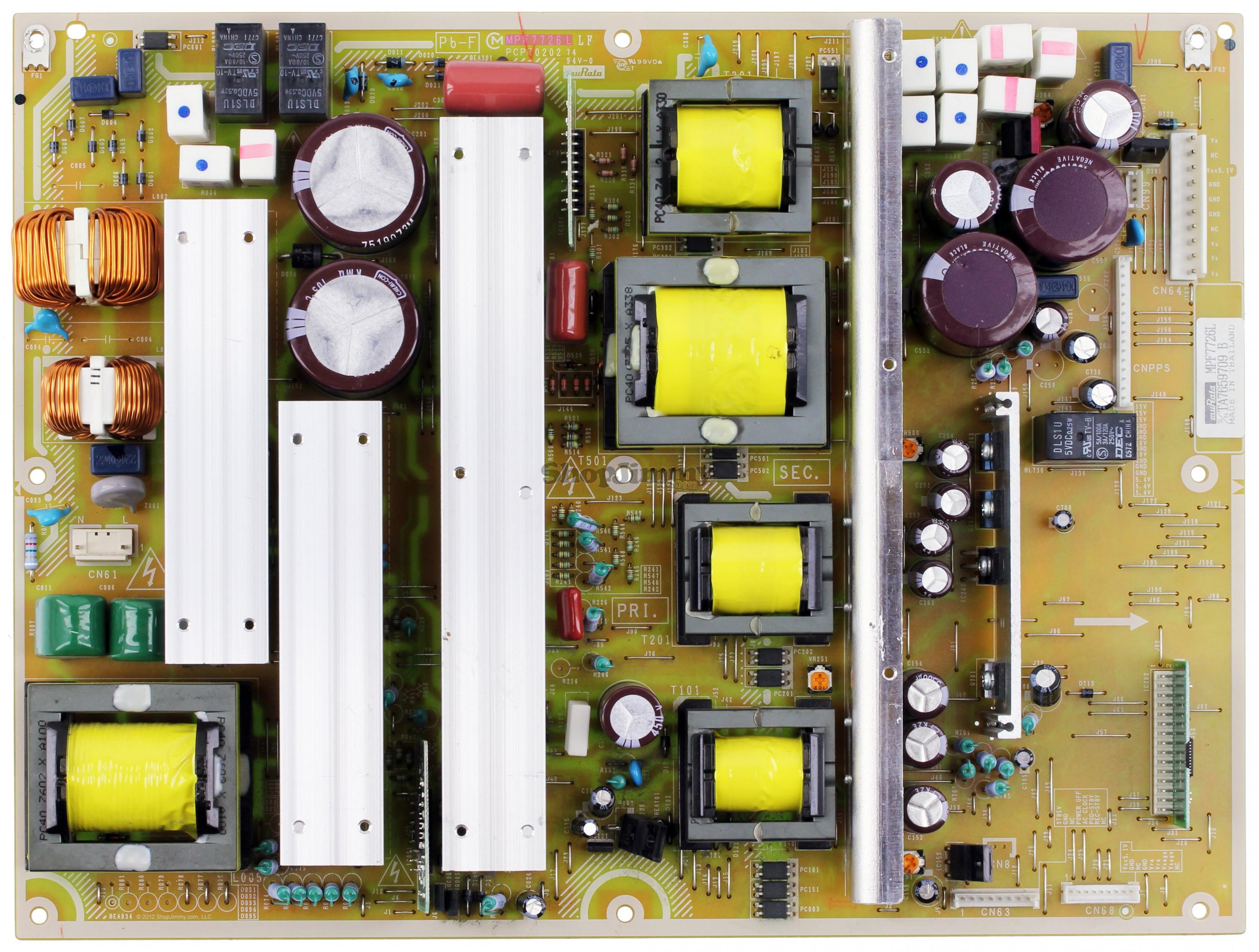

                  Got a service bulletin showing how to force on the power supply to see if was capable of reaching full VS and it was not, so replaced power supply board and that fixed the TV. Very odd that it was locking up and not responding, though.

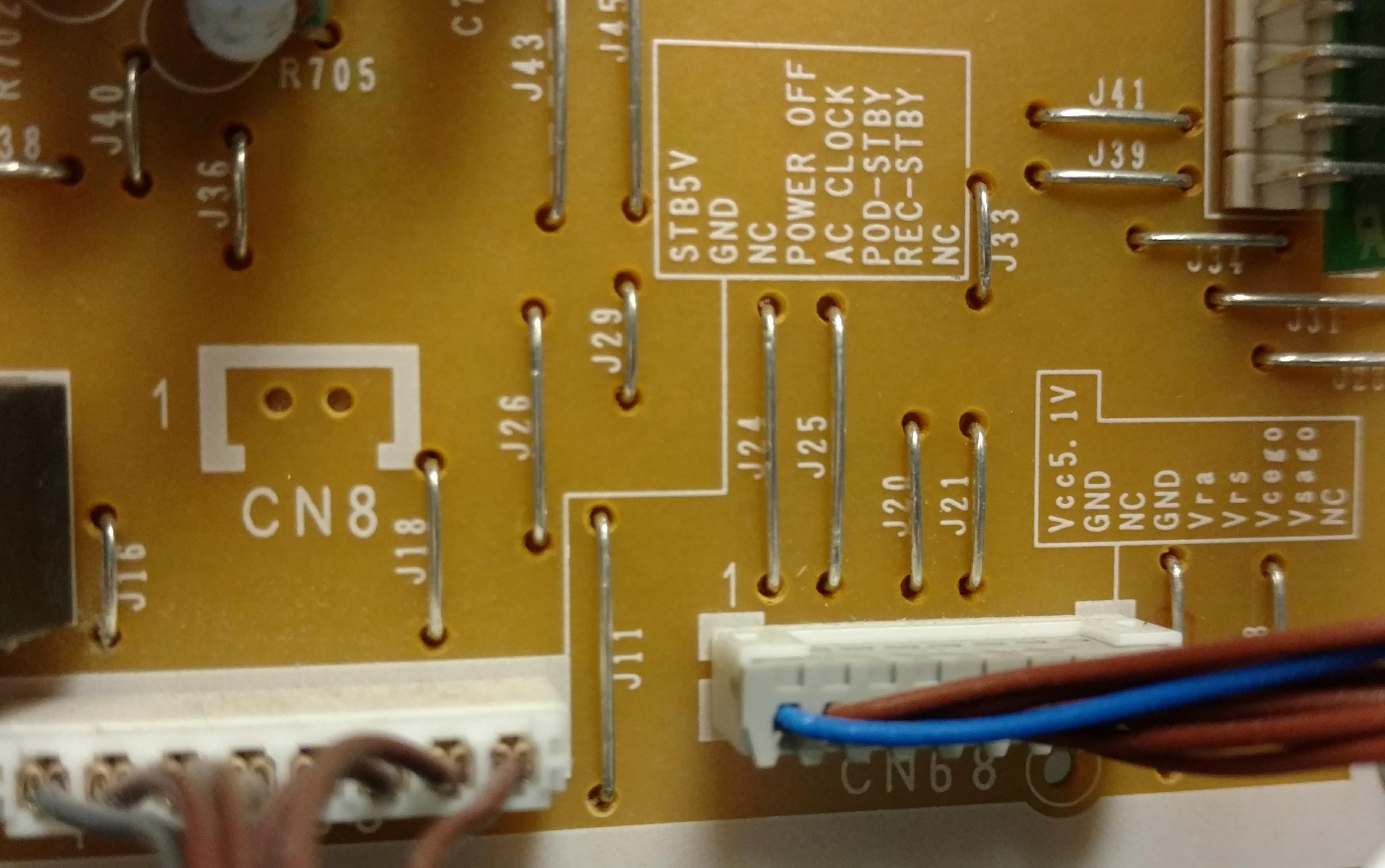

                      Re: Hitachi P50S601
                      Hitachi P50S601
                      Does anyone know how to force on the power supply on the set?
                      power board is---ha02202.
                      Plug CN63 as follows
                      1.--stb5v
                      2.--GND
                      3.--NC
                      4.--power off
                      5.--AC Clock
                      6.--POD-Stby
                      7.--REC-stby
                      8.--NC
                      Plug CN68 as follows
                      1.--vcc5.1v
                      2.--GND
                      3.--NC
                      4.--GND
                      5.--vra
                      6.--vrs
                      7.--vcogo
                      8.--vsago
                      9.--nc
