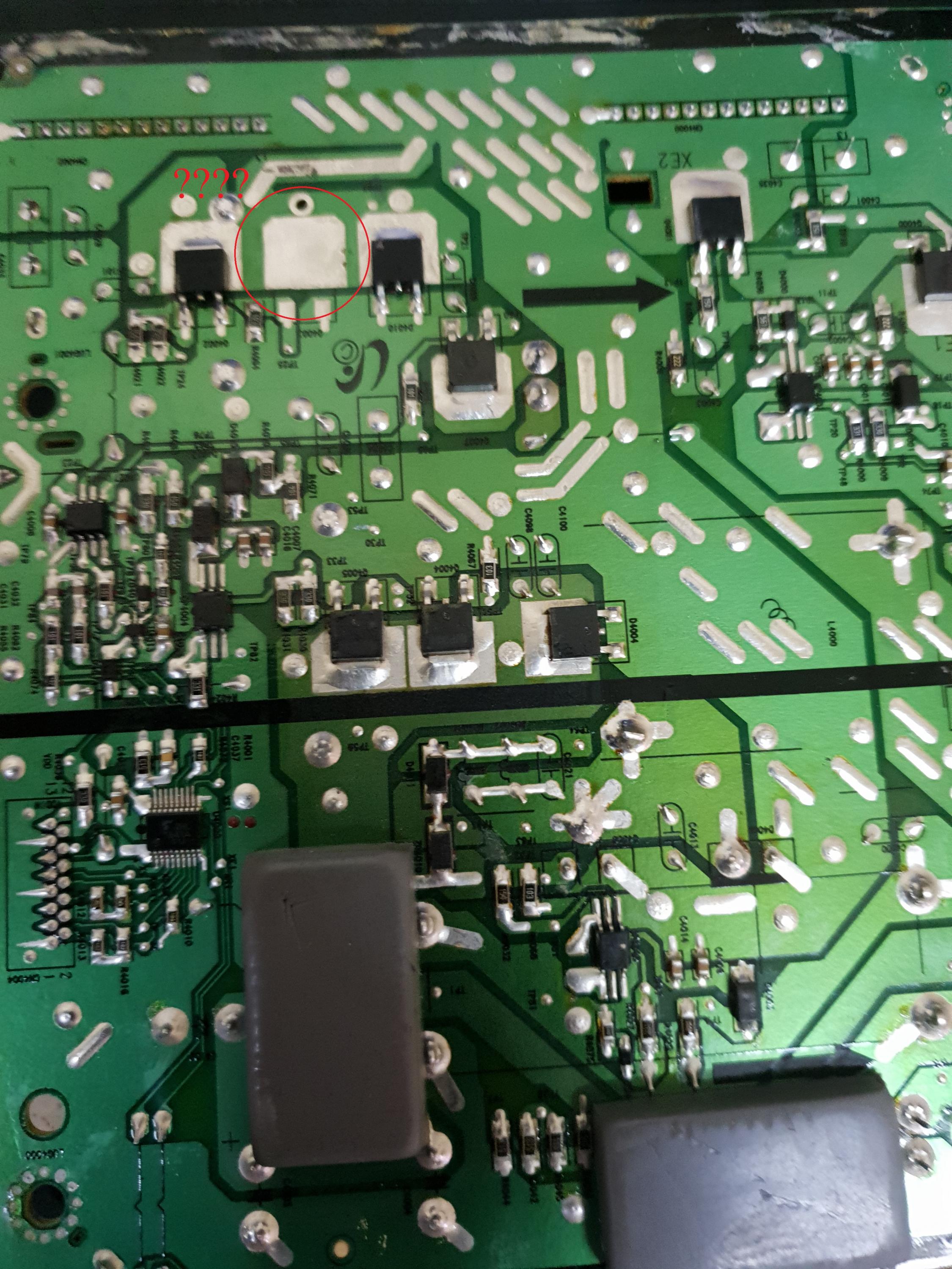

      can anyone tell me how is the middle stuff missing?
      doesnt seem like it melted away or some sort of manufacturing defect?
      note: this is the xmain board
      comparing with:
      https://www.badcaps.net/forum/attach...1&d=1384187712

          Its just an unused mounting pad. Do you have a meter that beeps when you touch the leads together? Post a clear pic of the white sticker on the x main board.

                yea noticed its just a ununused pad, some units i saw on ebay have this too.

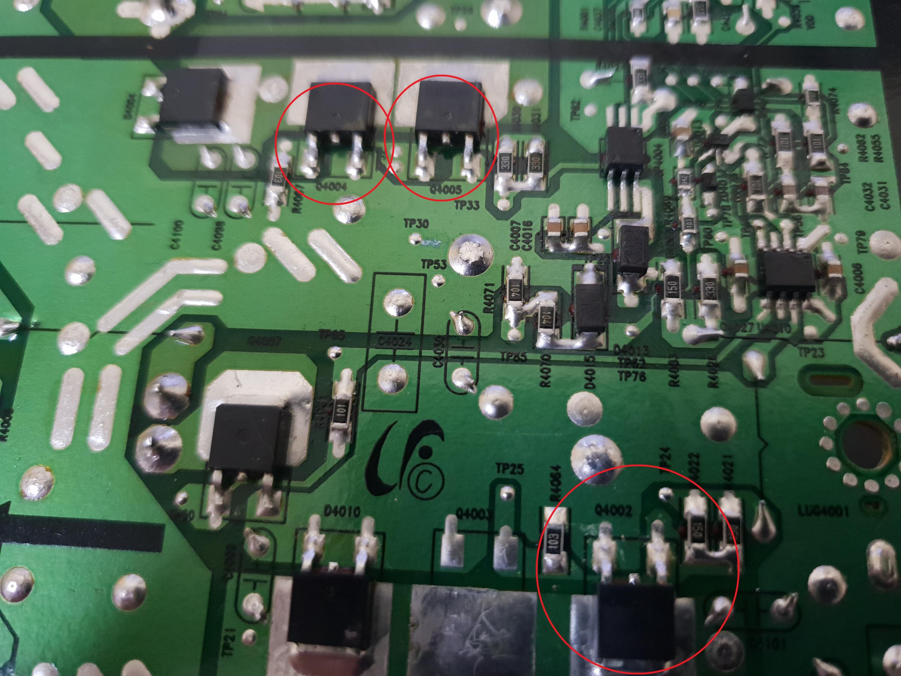

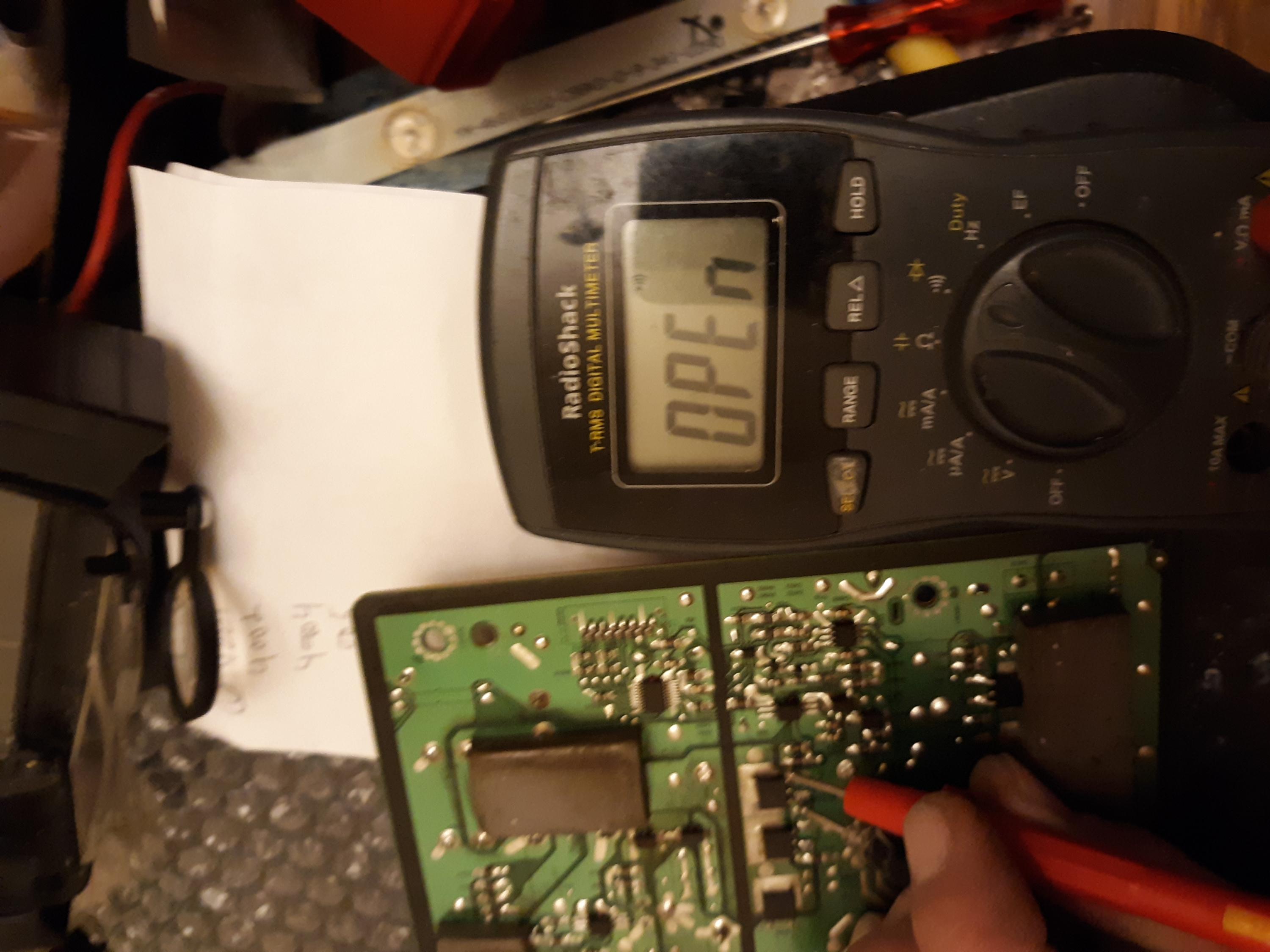

                        Take your meter and put it to continuity mode and put one lead on one leg and one on the other of Q4000,Q4001,Q4002,Q4004, and Q4005. Does the meter beep? Retest each by putting a lead on a leg and one on the mounting pad. If any test short, and Im pretty sure they will, that is the problem. U4010, the 8 legged ic usually goes bad with them. All are included in the repair kits.

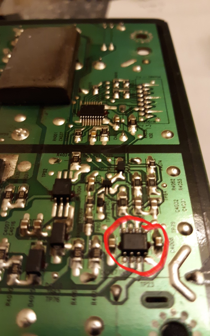

                          This is th ic. If you want to replace the board you can use any of the 3 for this tv. Ebay uk has them for $30 usd.

                                from the one mentioned
                                only Q4002 beeps,
                                other than that,D4010 and D4004 also gives a beep. when tested with mounting pads, Q4004 and Q4005 gives a beep gives a beep on one leg and about 500+ohms resistance on the other.
                                guess both board need replacing

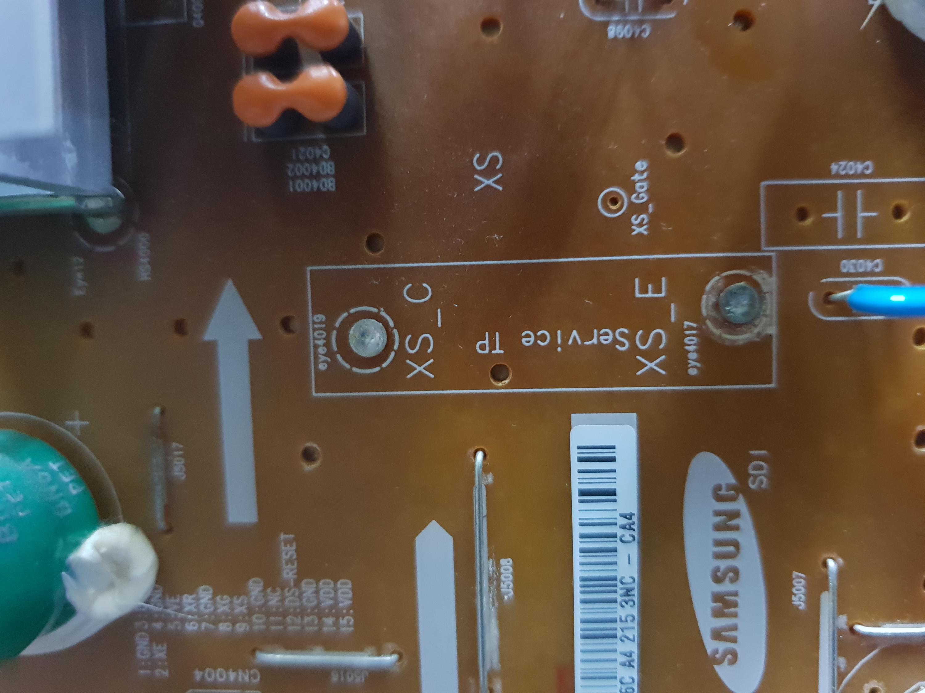

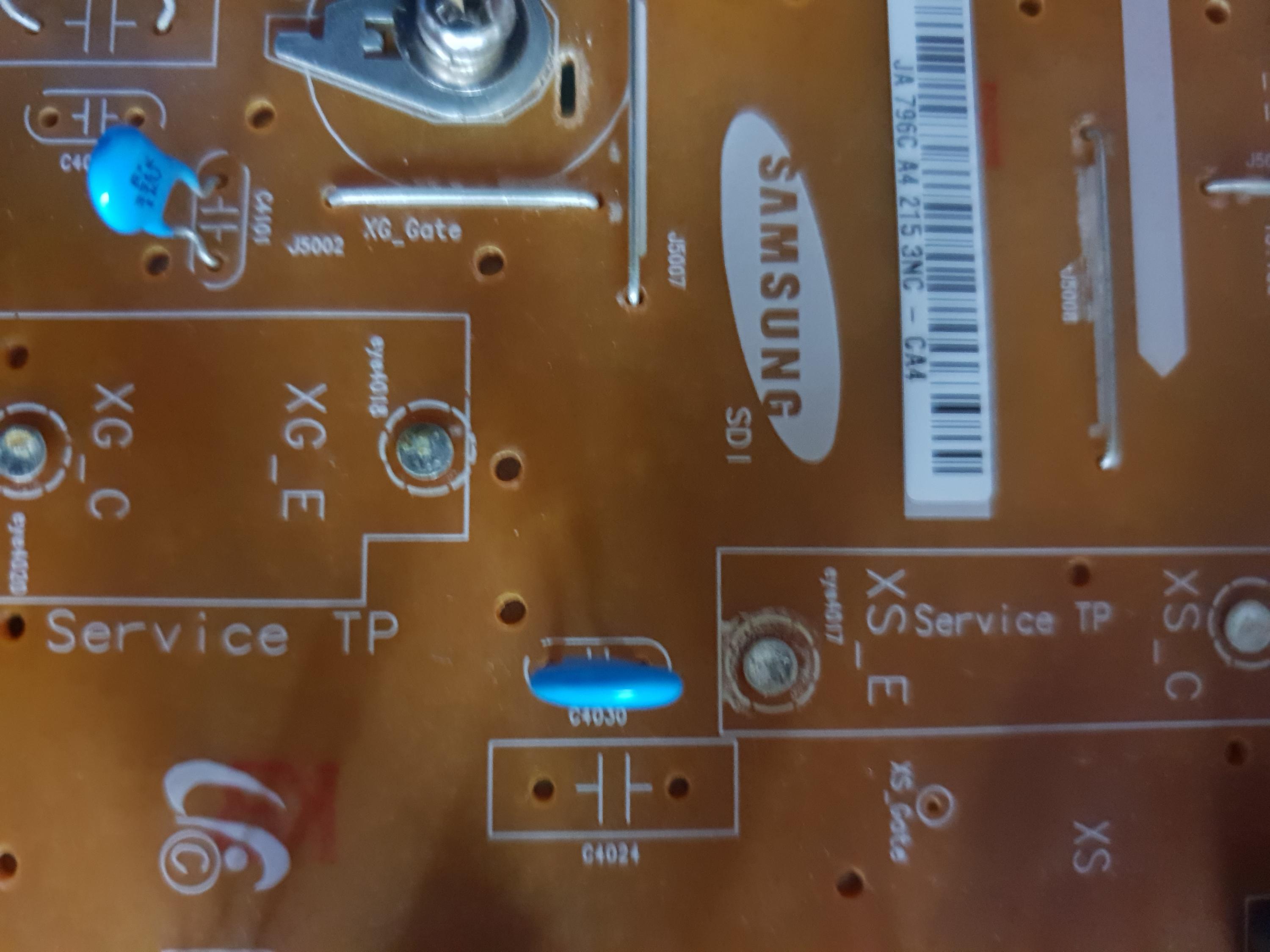

                                  for the x boad test points, the XG_C and XG_E doesnt show any resistance now, while the other test point still show.

                                      D4004 & D4005 are diodes. Both legs are tied together so you will always get a beep. I dont have a y main to look at, but test all the transistors for shorts. They have the "Q" in front of the number.
                                        i have tested all so far only the Q4002 has beeps, rest are fine with no beep
                                        and btw those are Q4004 and Q4005 not "D", you can notice it from the pics
                                        so if you suggest x main is fine i will not order it, otherwise i will buy it in case.

                                          Re: PN43D490A1DXZA power supply broke?
                                          Opps. Had a brain fart. If anything with a Q beeps it is bad. Like I said the ic could be bad. I think this is your only problem board. It can be repaired for less than $20. I have done several. A hot air station comes in handy, but I have used a 45 watt soldering iron in years past. You can just get a new board and be sure to update the firmware so it doesn't happen again.
