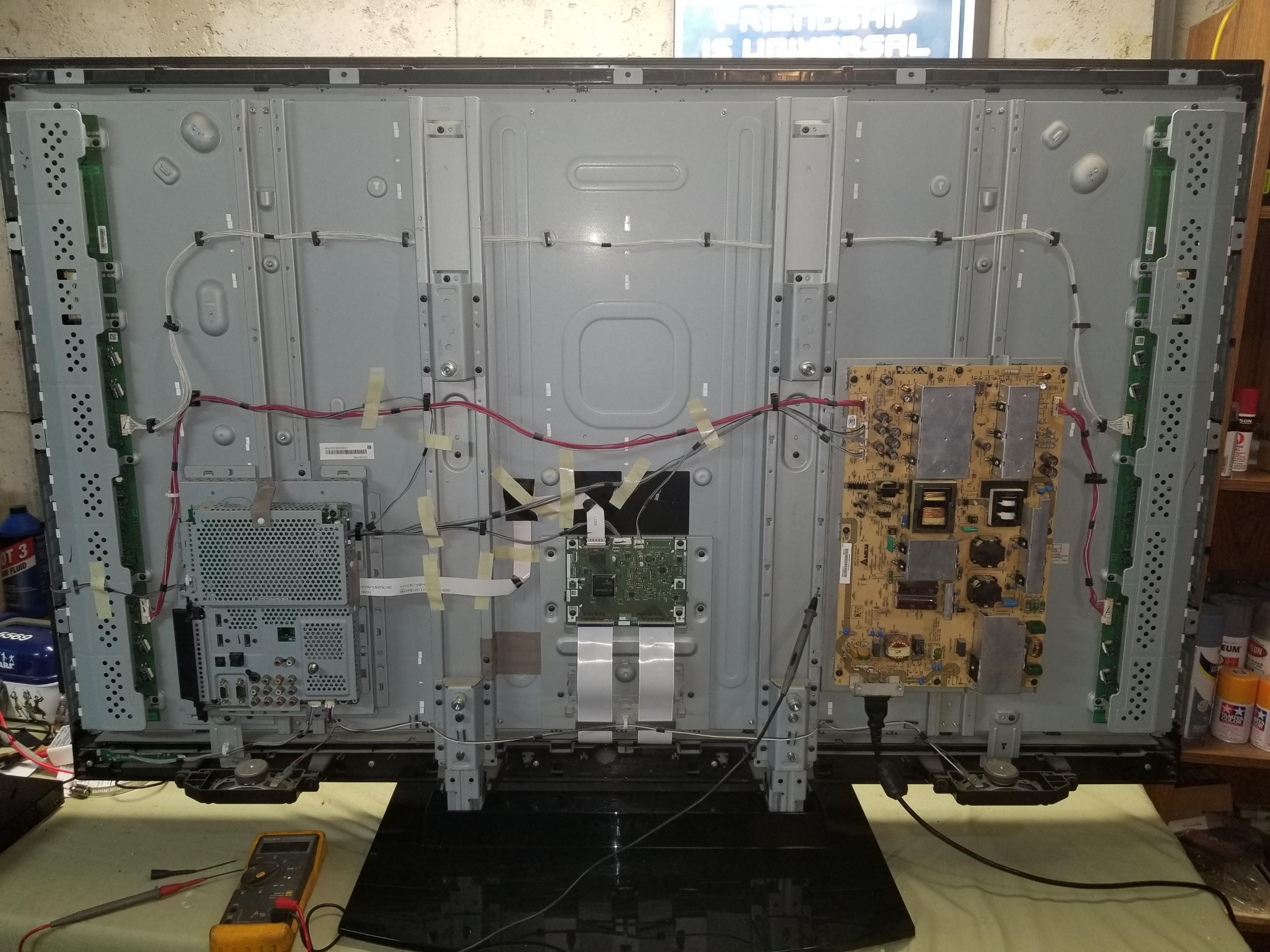

    Hiya folks.
    This one has a backlight flicker problem as the title states. Eventually the set will shut itself down into protect mode.
    Right now I have it in my basement running Youtube videos off an Xbox 360 for a source. Gonna let it run over night to see if I can get it to crash.
    It seems to flicker mainly on the right side of the screen. Tapping on the metal top piece of the inverter board seems to make it stop for a few seconds before the flicker starts back up.
    The main model number of this set is LC-60E77UN. https://www.manualslib.com/manual/91...page=65#manual
    I'll check in tomorrow and let ya'll know what happened.

    Re: Sharp LC-60E79U Backlight Flicker
    cold solder joint, or bad transformer.
      Error code is DET_15V (34pin) error (L). UR13V is not applied.
      If error is detected during operation, error standby is activated by
      polling. ( Pwr flashes x2, OPC flashes once )
      On the power supply or the inverter, CapLeaker?
      Voltages on Power Supply going to Main:
      PNL_POW = 3.26
      BU5V = 5.00
      PS_ON = 2.8
      AC_DET = 3.0
      S14.3V = 14.39
      UR14.3V = 14.39
      PNL12V = 11.97
      PNL12V = 11.95
      Both red wired cables have 24V where it should
      All voltages recorded white TV is on and flickering.

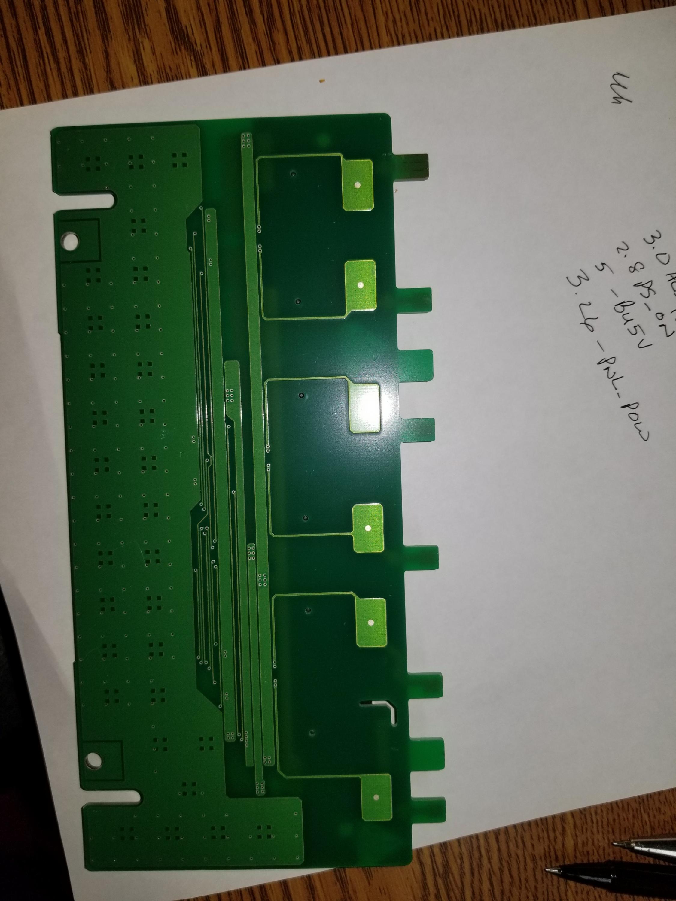

        Look at the solder joints on everything on the HV side on the inverter board. Also check these blue litte HV caps at the CCFL plug. Compare the HV output (secondary) on each transformer with your DMM on Ohm scale and note it down. If one transformer is more than 3% off, that's the bad one. The bad transformer will also run hotter than the others. Hope that helps you to get started.

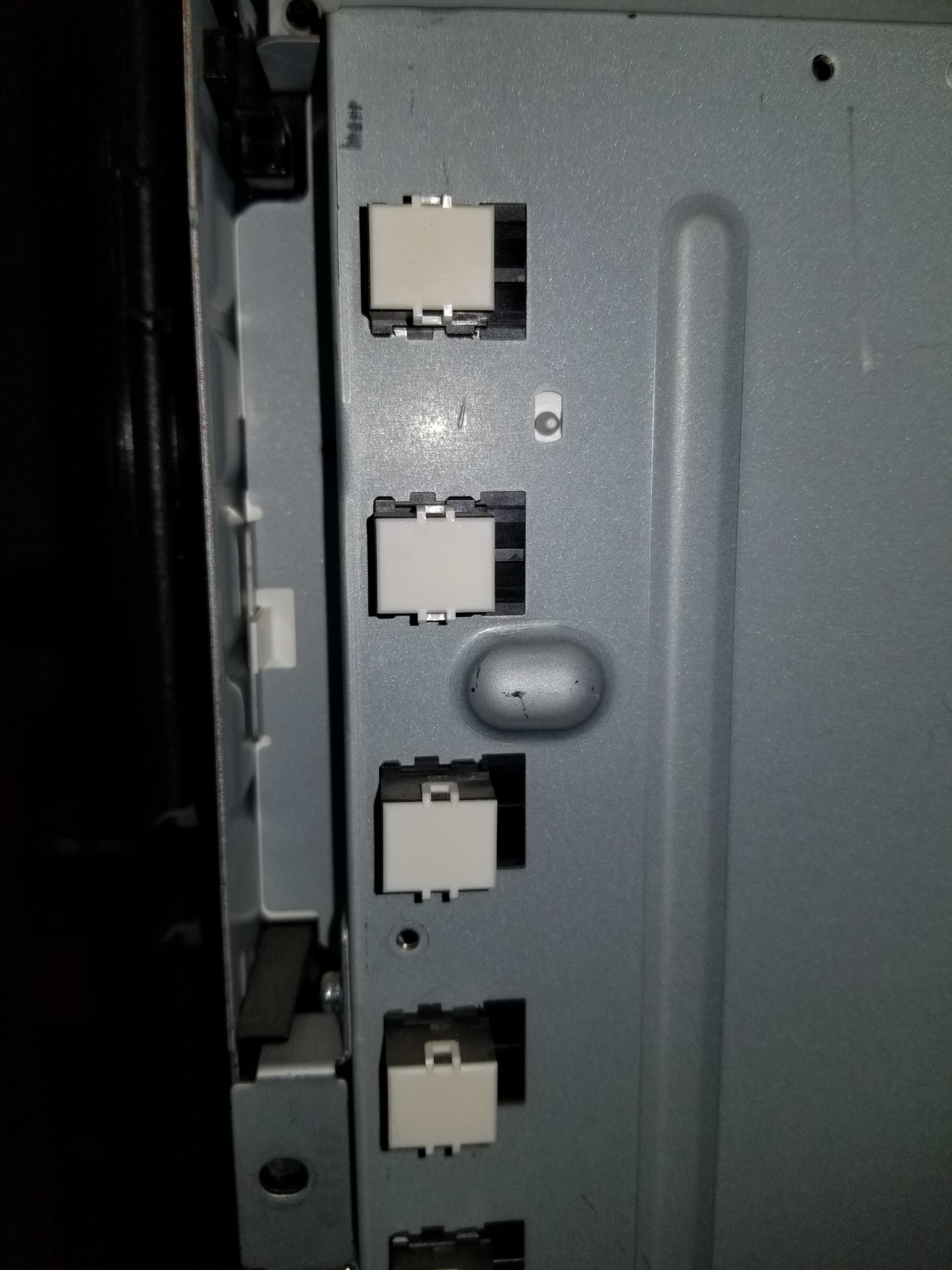

          I took the slave M2 board out, smaller one with 3 transformers on it, and measured Ohms from Hot to DC, the only one that reads any different is T1601. Lower at 1550 Ohms vs 1580 like the rest of them. Also, there is a "cooked" look to the connector going into the CCFL connector. The back side of the CCFL looks "cooked" as well.
          Can that be replaced along with the board and/or transformer? I do have experience replacing LED strips on LED Tvs so I'm not afraid to tear the whole thing down.
          What little blue caps?
          Set now flashes "Lamp Error" 1 blink of the Power light.
              This set is now stuck in the lamp error mode. I can force it on, backlight comes on for a split second then turns off, then tv shuts down flashing lamp error. I was able to get into service mode and using a flashlight, navigated to the lamp error reset and turned it on. Powered down set, and restarted. Tv came on for a second then shut down again with lamp error.
