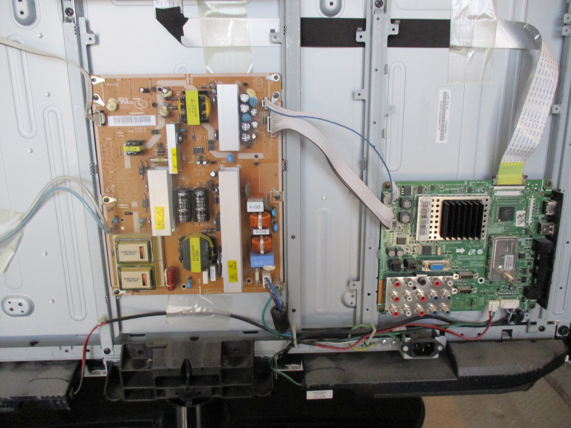

    I recently took the back off, and looked at the caps, but they all look ok to me. No bulging caps.
    I'm the original owner, and the power board appears to be in pristine condition.
    I didn't know what else to do, so I bought a "refurbished" power board from ShopJimmy for 50 bucks.
    They sent me a beat up board, dusty and scratched, with the corner of the circuit board cracked and
    hot-glued together. This was the first time I have ever used ShopJimmy, so I was shocked they
    sent me a Frankenstein board.
    Anyway, I replaced the power board, and after a day or so, nothing has changed.
    The TV still takes several minutes to turn on in the morning.
    If replacing the power board didn't solve the problem, what else can be done?

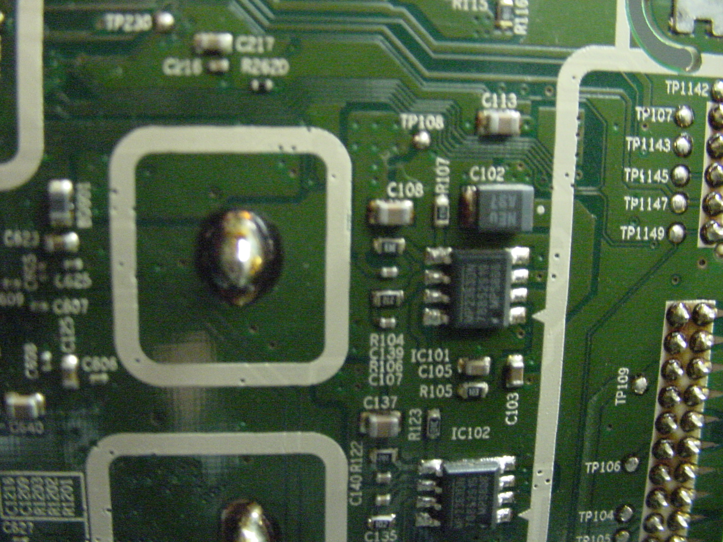

            How big of a SMD component can I fit in C102? I looked at 10v and 16v capacitors on digikey, and the SMD dimensions increase
            with larger voltage. I found these lines:
            C102
            2409-001118
            Samsung C-polymer,Chip;47uf,20%,10v,wt,tp,3.5x2
            Must SMD stay within same size of 3.5mm x 2mm ?

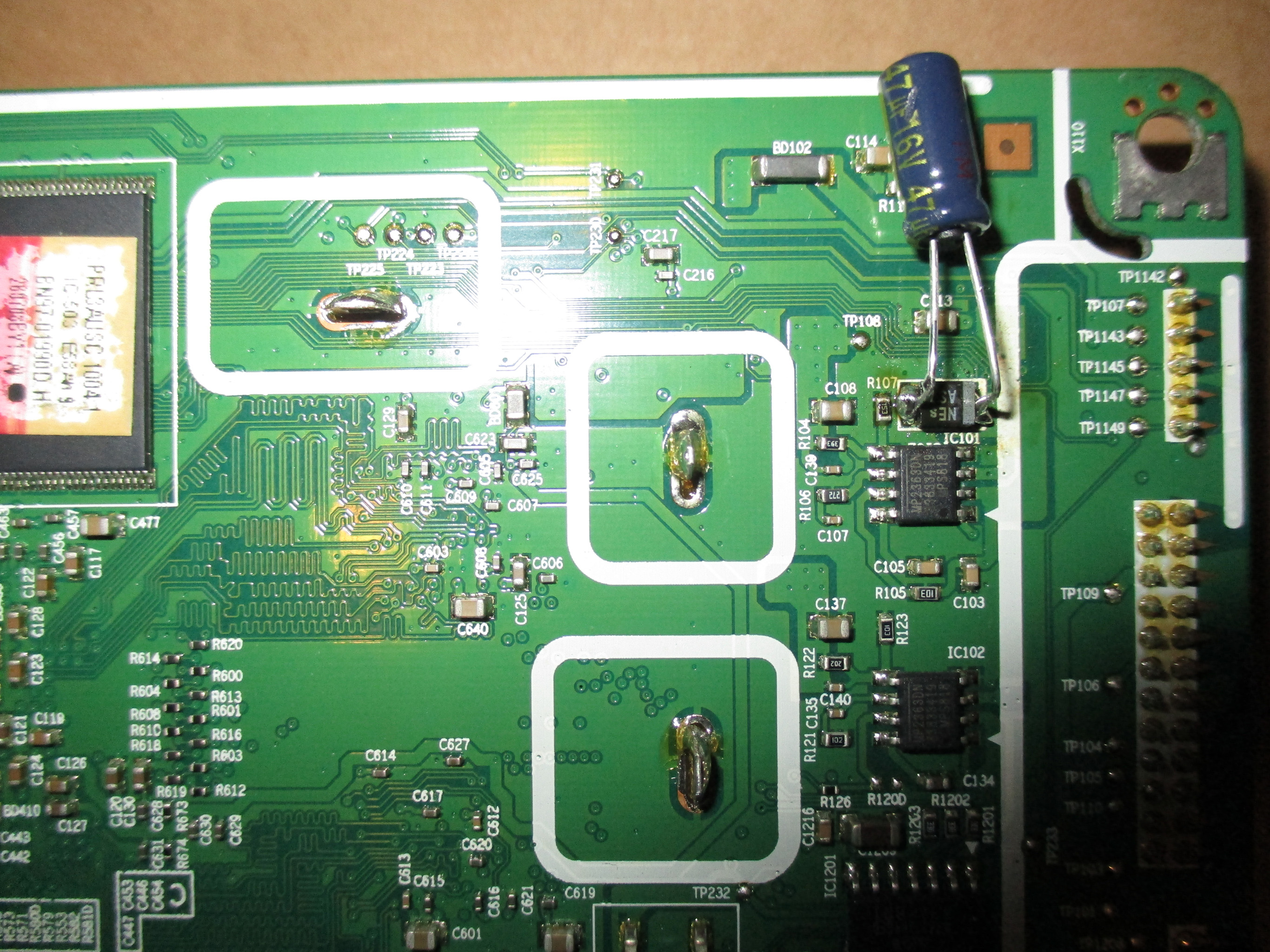

                              Just an update. I finally got a 40w iron, and... the solder still won't flow. It must be spot-welded on or something.
                              I went for plan B, and solder a 47uF cap across the SMD chip, making sure the leads matched the polarity of the SMD. I assume the marked end of the SMD chip is positive.
                              I turned on the TV, and nothing happened. The red LED light continues to blink on/off.

                                • aaronwt6
                                  • Apr 2013
                                  • 855
                                  • US
                                  Re: Samsung LN40A550P3F 40" HDTV, slow to turn on
                                  Could we see a picture of your repair to verify it's correct?

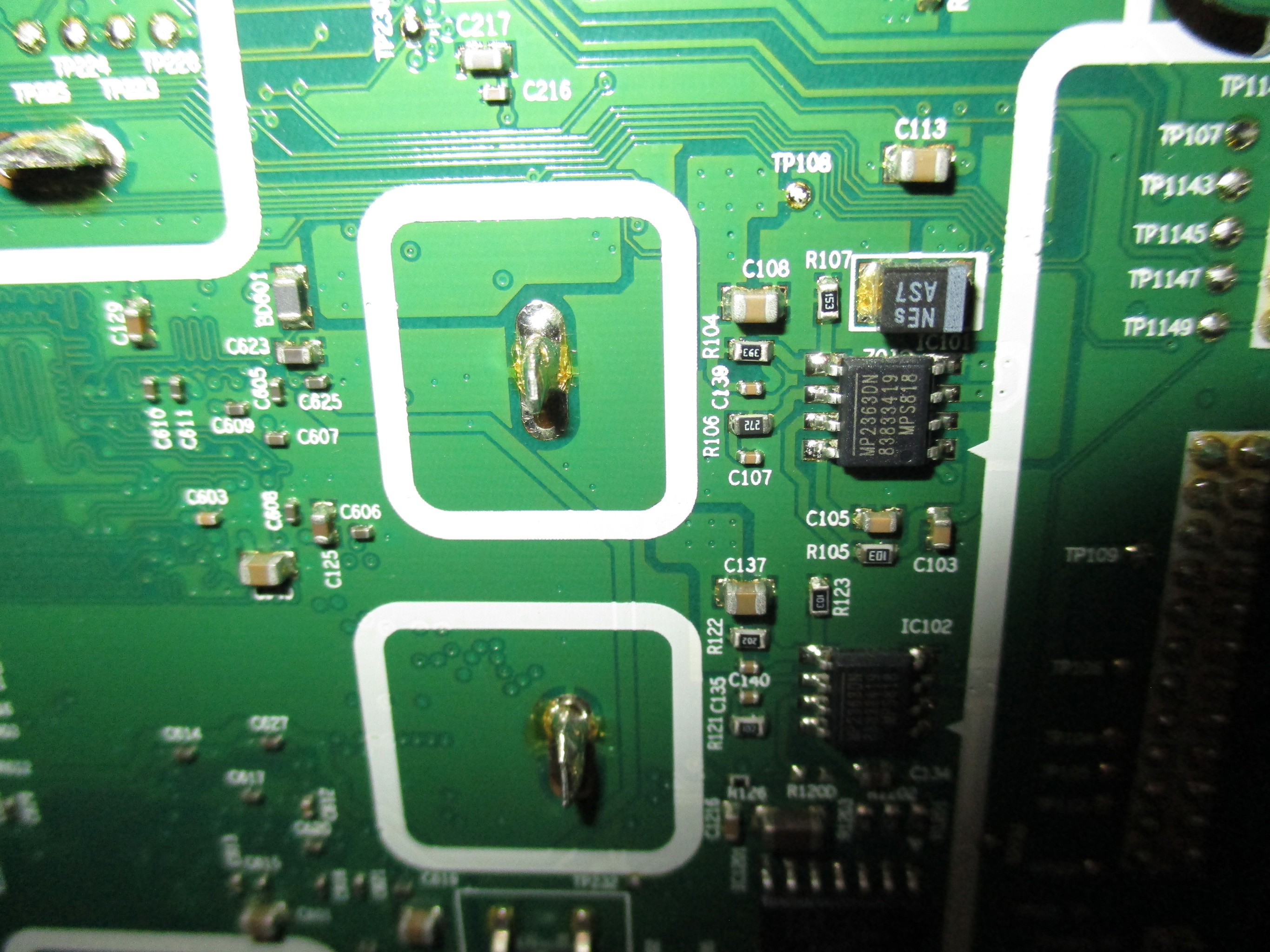

                                    Sure, I added a before and after pics.
                                    Looking at this pic in the link, it's hard to tell where they solder the negative end of the cap. Did they dig into the board and create a ground spot? Why didn't they solder it to the end of the SMD chip? Not enough room?
                                    https://www.badcaps.net/forum/showth...highlight=c102

                                      It appears that you have the capacitor on correctly. I offer a repair service on these and have fixed 100s of them. I have run into cases where the boards were used for so long that the original issue caused something else to fail and the end result is just an indefinitely flashing light even after swapping the cap. Not saying if that's the case or not with yours but in that instance, I've never been able to get one going again.
