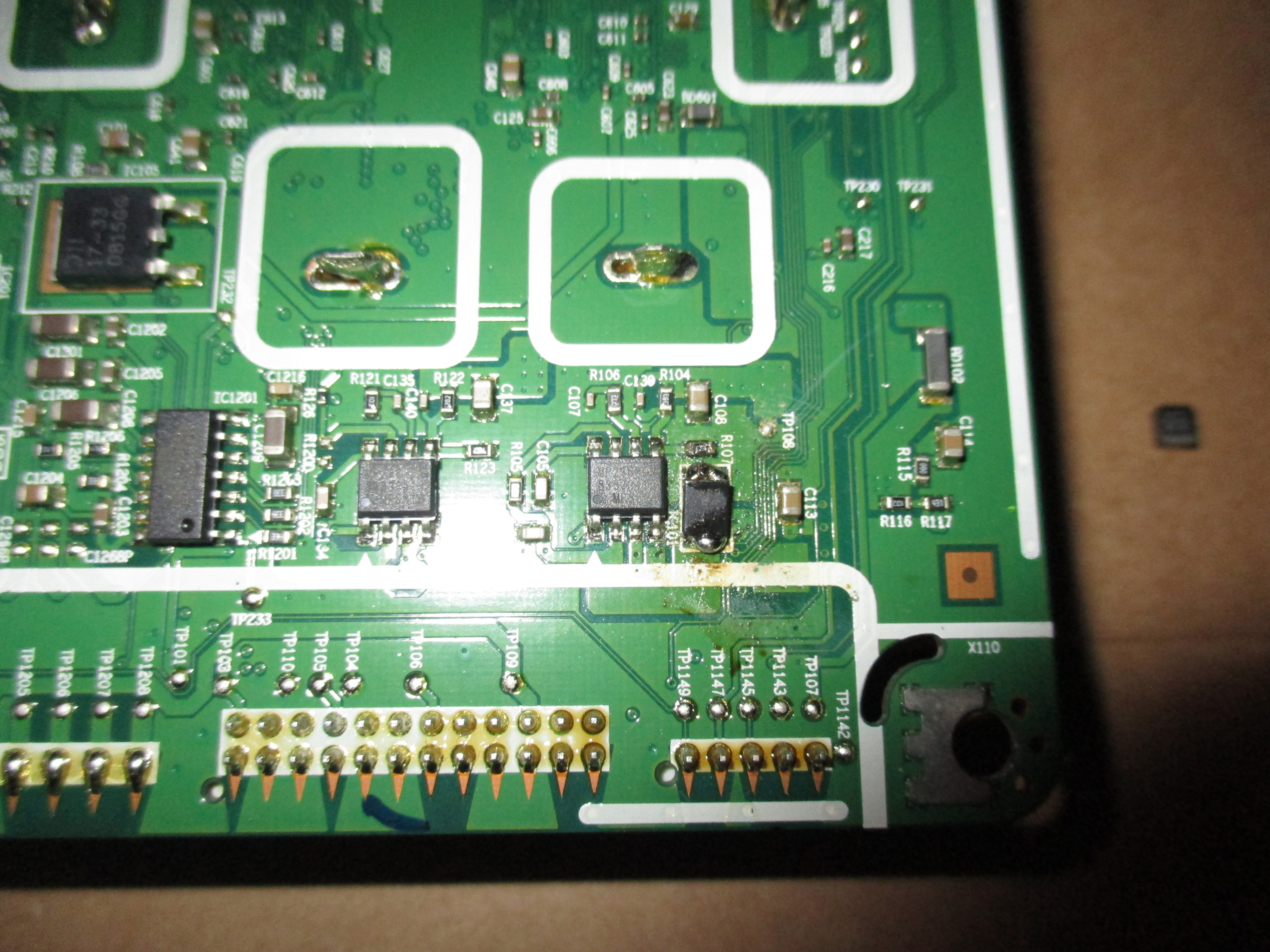

      Personally, I've never had any luck with changing that chip. Either the capacitor does the trick or nothing works. I do typically change C131 on the front of the board as well (same cap rating as C102).
      Originally posted by samsonite
      This video at 5:00 explains that both c102 and a nearby 8-pin IC chip should be replaced:
      https://www.youtube.com/watch?v=oC4f2Ik8rCI
      They also used a heat gun and tweezers to remove that stubborn SMD, btw. I don't have a heat gun, so I would
      need some kind of heat clamp to remove the SMD in one go.
      My IC chip says:
      MP2363DN
      83833419
      MPS818
      My Main Board:
      BN41-00975B (2008.01.13)
      MODEL: PEARL
      This link doesn't describe the IC chip they sell:
      https://www.shopjimmy.com/samsung-bn...a530p1fxza.htm
      Is this the chip?
      https://www.digikey.com/product-deta...366-ND/5299123
      I could try replacing that as a last resort. Does that sound reasonable?

        Re: Samsung LN40A550P3F 40" HDTV, slow to turn on
        Yes, I remember them changing both C131 and C102 also.

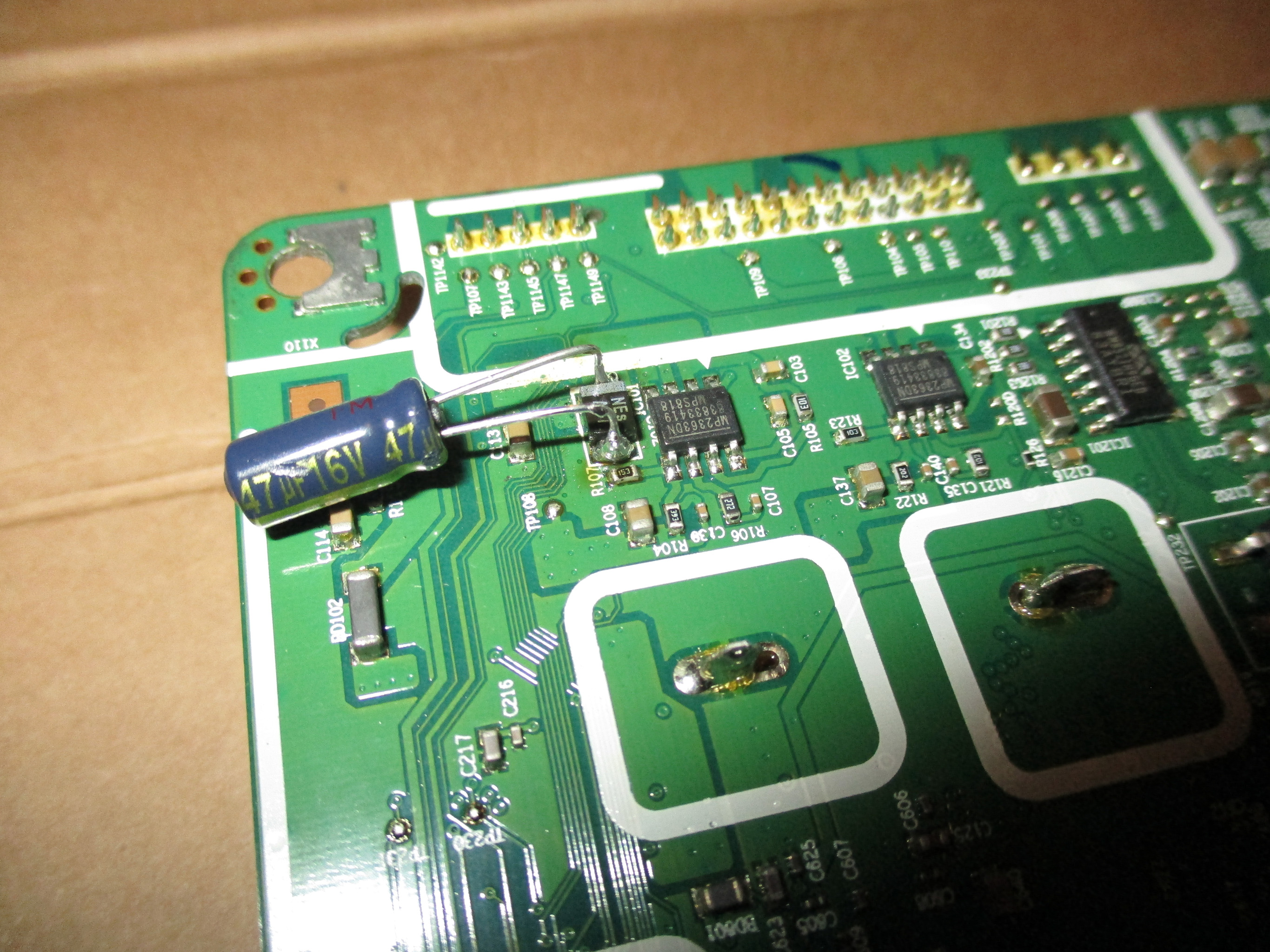

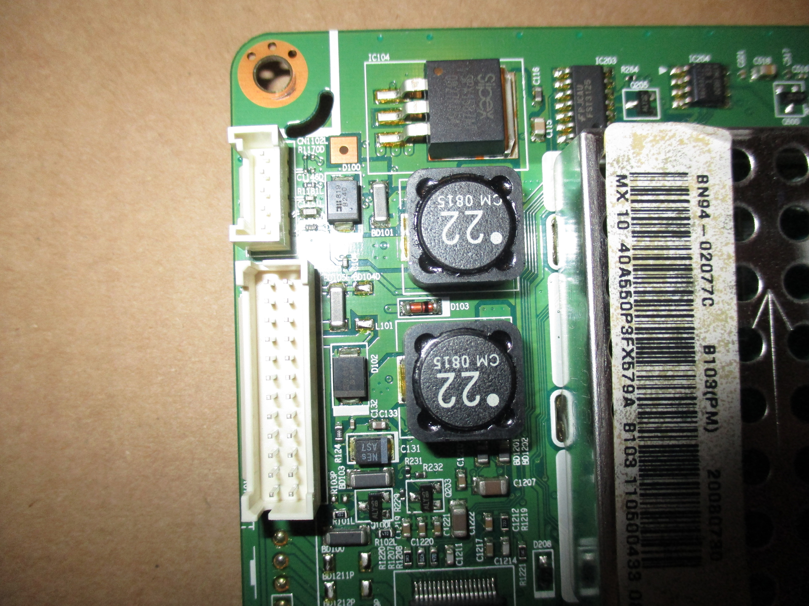

          I may try to re-solder C102 again. I think I need a cheap heat gun, because it isn't coming off for me.
          And C131 is on the opposite side of main board near a power connector. It looks crowded, so I will have a difficult time with it without a heat gun.

            Just add solder to both sides of the cap and you could use both irons to heat both sides at once and remove it.

              What DC voltage do you have across the capacitor you soldered in?
                That sounds like a good idea. I was trying to wick away solder instead of adding more. But my luck, the solder will ball up and stick to the iron instead.
                As for the voltage, sorry, I don't know. How do shops test these boards when they only have the board and no TV?
                    https://www.badcaps.net/forum/attach...2&d=1548278425
                    What is that silver color blob between the two legs on that added on cap?
                      Yes, I realize I would get a better connection if the capacitor legs actually touched the pads instead of being blobbed on, but that's the best I can do with the tools I have. I don't have the hottest iron or the smallest diameter solder core right now. But, I think I'm going to put this project on hold for another week until I get some better stuff. Thanks.

                        #31
                        Take a pic of the capacitor from the legs. There looks like a "blob" between the legs what brand is that capacitor?
                          #32
                          I am talking about the silver blob between the two legs (where the legs come out of the body of the cap) of that Blue shown in your picture.
                            It must be the lighting, because it's really some kind of black plastic plug. Specs call it "sealing rubber". The cap doesn't look ruptured. That's the way I received it.
                              The cap is a Panasonic, red M stays for Matsushita.. anyway the not removing the old cap is not a good thing, tantalum caps last longer than electrolytic ones for a matter of capacity but them can go short circuit...
                                    There is one more cap on the top side of the board you could try and replace. I can't remember where it's located, but I know it's in a tight spot.
