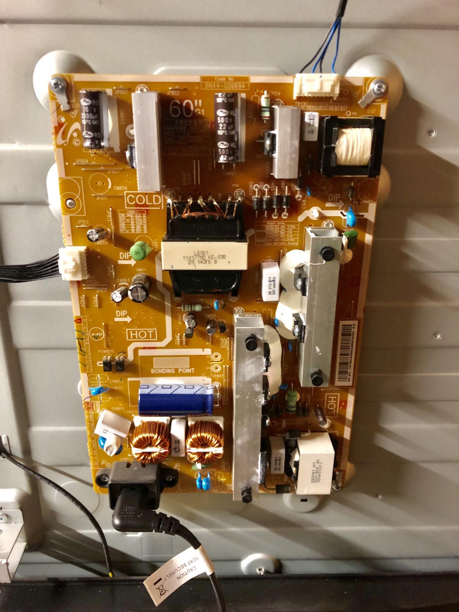

    Hello, I have a Samsung UN60FH6200F LED TV with no backlight. It has sound. I can do the flashlight test and can see the image. Here are some voltage readings on the connector that powers the panel. Top connector of power board. Looking at pic, from left to right:
    Pin 1. 15.0 vdc (it fluctuates a few volts)
    Pin 2. 313. Vdc
    Pin 3. 313 Vdc
    Pin 4. 416 vdc
    I’m in USA, AC line voltage is 120v. No bulging caps. No obvious heat damage to boards. Any help will be greatly appreciated. This is for a friends parents. Hate to see this TV wind up in a landfill. Thanks

    1) What did you use for meter GND?
    2) Lift up one end of diode D9151C in the LED driver section and then use Ohm meter to check the resistance of that diode in both directions.
    3) So far it looks like you have open circuit in the LED, or connectors, or wiring.
    Power supply/LED driver board BN44-00669A.

      Hi budm. Thanks for your reply. My original voltage readings were with negative meter probe to metal chassis ground.
      I lifted (unsoldered) the cathode (banded) end of diode D9151C. With ohm meter negative probe on the cathode, red probe on anode, I get 1.85 Mohms. 0 reading with meter leads reversed.
      Can I test a mosfet with my multi meter? Q9151C ( 3N50NZ) looks to be part of this same circuit

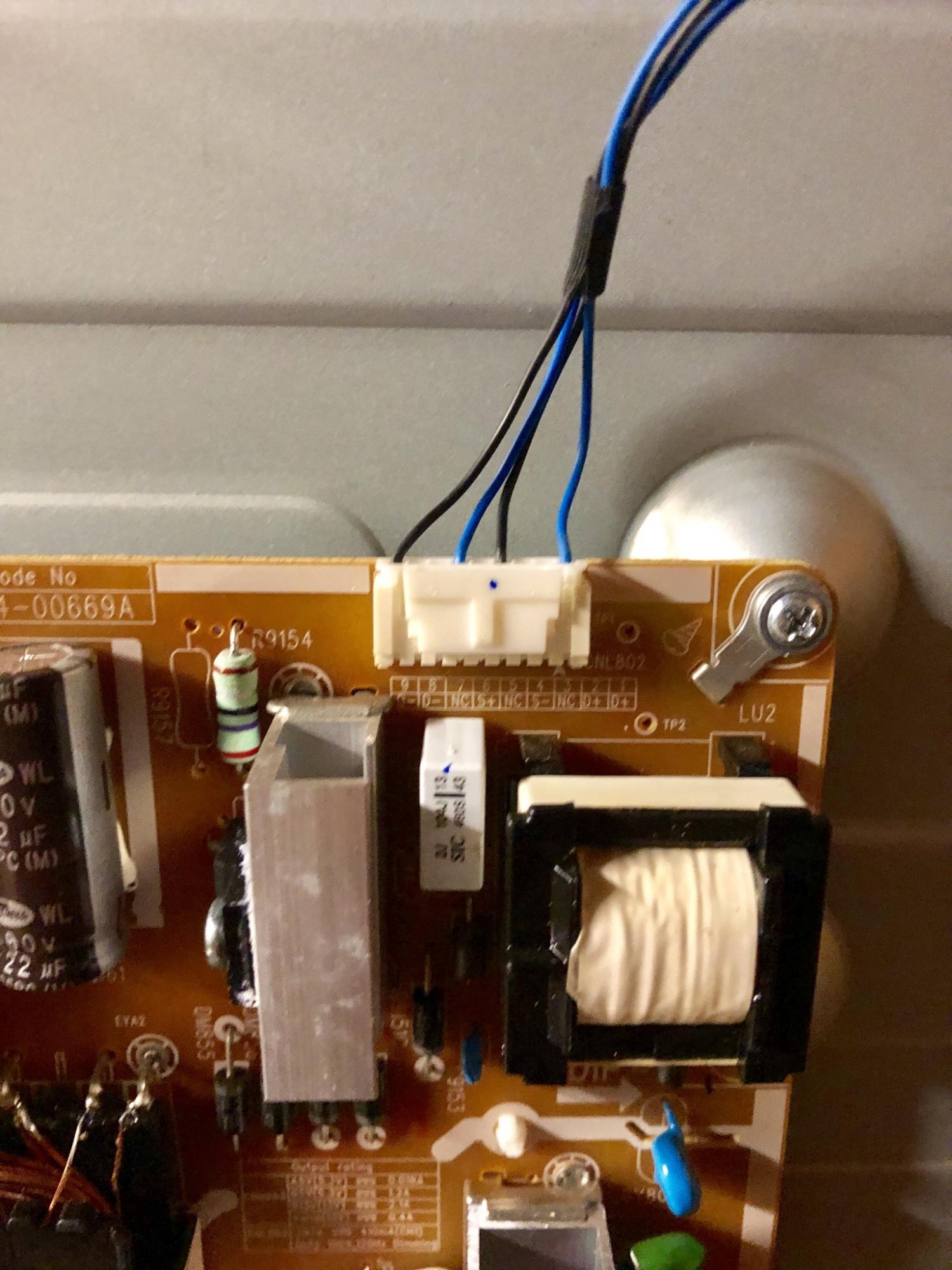

        Re: Samsung UN60FH6200F TV - No backlight - Please help
        Pin 1 (Actual pin number is pin 9). 15.0 vdc (it fluctuates a few volts).
        Pin 2. (Actual pin number is pin 6) 313. Vdc, pin 6 is directly connected to pin 4)
        Pin 3. (Actual pin number is pin 4) 313 Vdc
        Pin 4. (Actual pin number is pin 1) 416 vdc
        You have two LED strings connected in series to form one large LED string, String # 1 is connected to pin 1 and pin 4, string #2 is connected to pin 9 and pin 6 (see the pin names as printed on the board).
        The Voltage reading of pin 6 and pin 9 indicating problem in LED string # 2.
        The LED Voltage with good load is 297V as printed on the board, but since you have open circuit some where so the Voltage went up over 400VDC.
        This may be the LED strips for your panel.

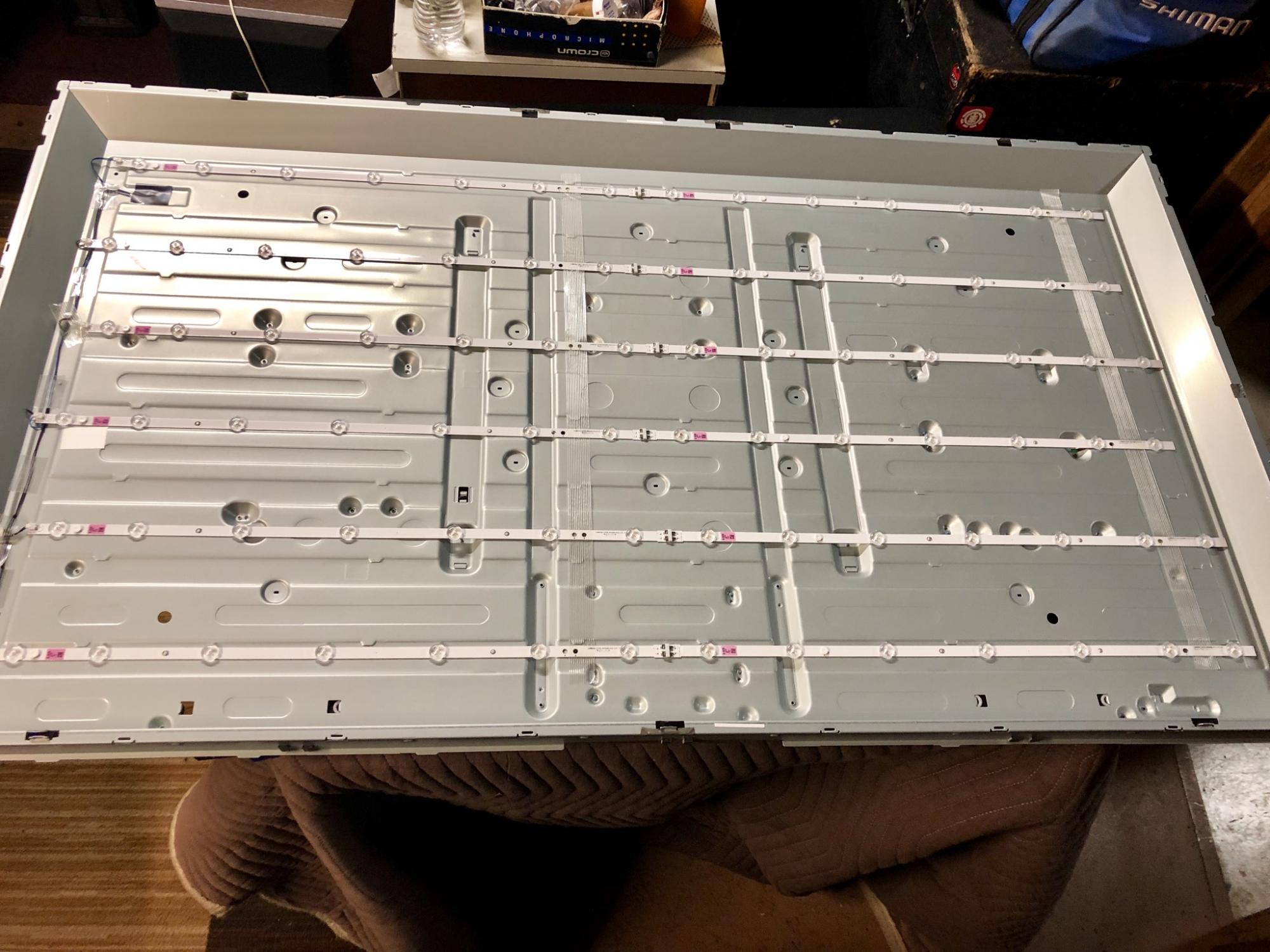

                I’m going to attempt the repair. If I’m successful at removing the old LED strips, I’ll order the new ones from ShopJimmy. I’ll update my progress as I go. Thanks for all of your input
                • TubeJunkie
                  • Oct 2012
                  • 107
                  Well, I’ve made it down to the LED strips without breaking anything. Guess it’s time to order the new ones!
                  Update: new LED strips have been ordered!
                  Question: Is there a way to test each individual strip?

                    You can use a multimeter in diode mode and test each individual LED. Easier if there are test points or you will need to scratch each side of the LED until you see copper. Or you can buy a LED tester which will let you test the entire strip.
