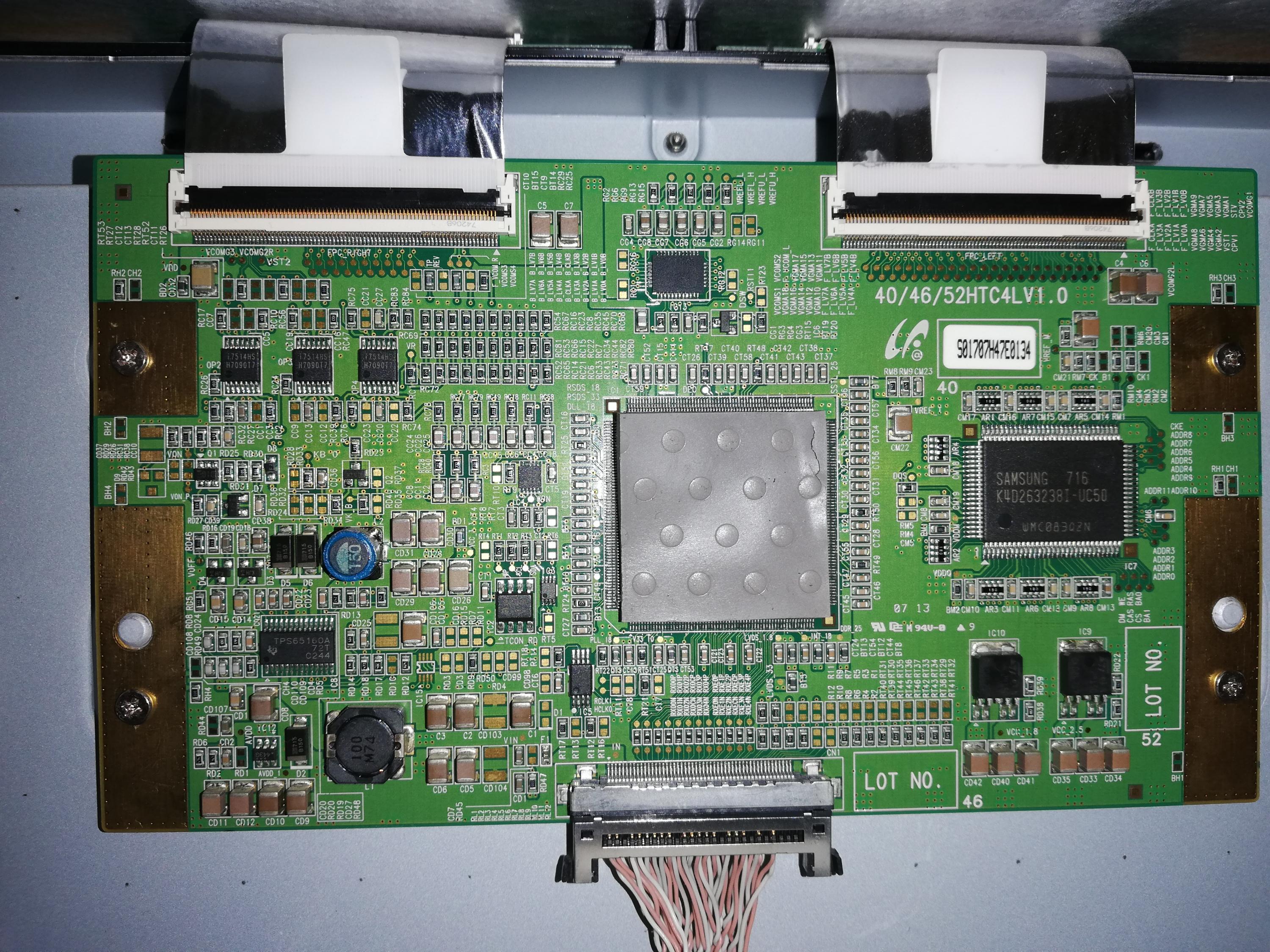

              Video resembles a tcon problem?

                      Try heating things with a hairdryer on the mainboard and tcon, see if picture changes and maybe the one ribbon at a time tcon check.

                        I checked both sides of the tcon left and right, left side pulled was white with right side still showing this defect.
                        right side pulled was the same as well but opposite.
                        heated up around the main-board and tcon the problem doesn't go away.

                          Check the capacitors on the tcon for shorts, tv unplugged, meter in diode mode.

                            checked all caps for shorts on the tcon board couldn't find any shorted

                                  I believe you removed the video.
                                  I'm just going to give my 2 cents nonetheless by saying it's probably a T-con issue since you're saying both sides of the screen display the same. Ideally, you'd have a second main board/T-con to compare how each performs.
                                  Do some measurements on the t-con board: there should be test points labeled VCC, 1.2v, VGH, VGL, etc. Really curious to see how this telly gets fixed

                                    Here is a photo of the tcon all the VCC lines seem to match their values I can't find vgh or vgl
                                      Re: Sasmung la40m81bd - Recapped
                                      How about AVDD, AVDD_1, VDD around the left side of the board around IC8?
                                      You can also look up the spec sheet of that IC8 TPS65160A to see how many output Voltage sources it has.

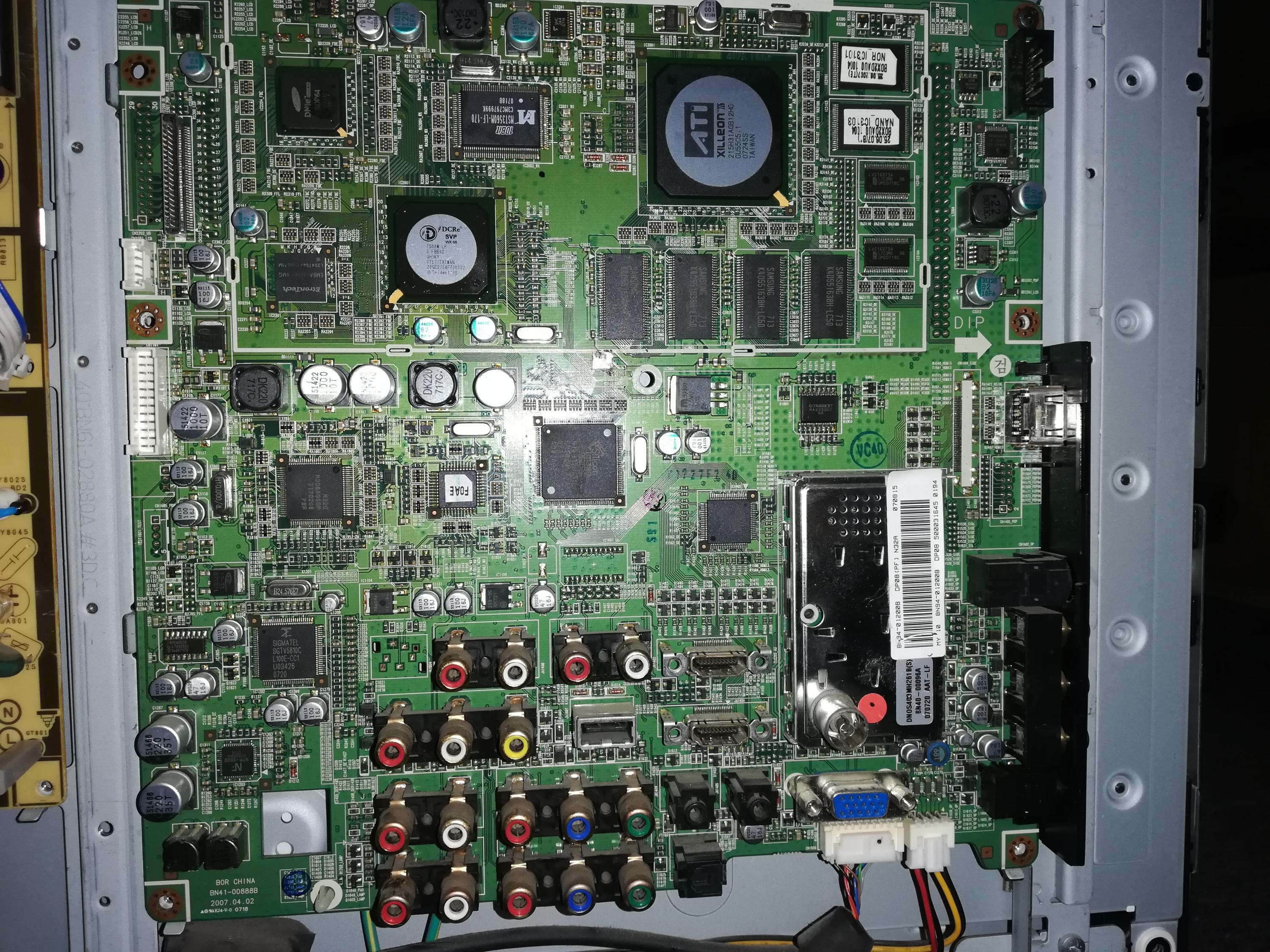

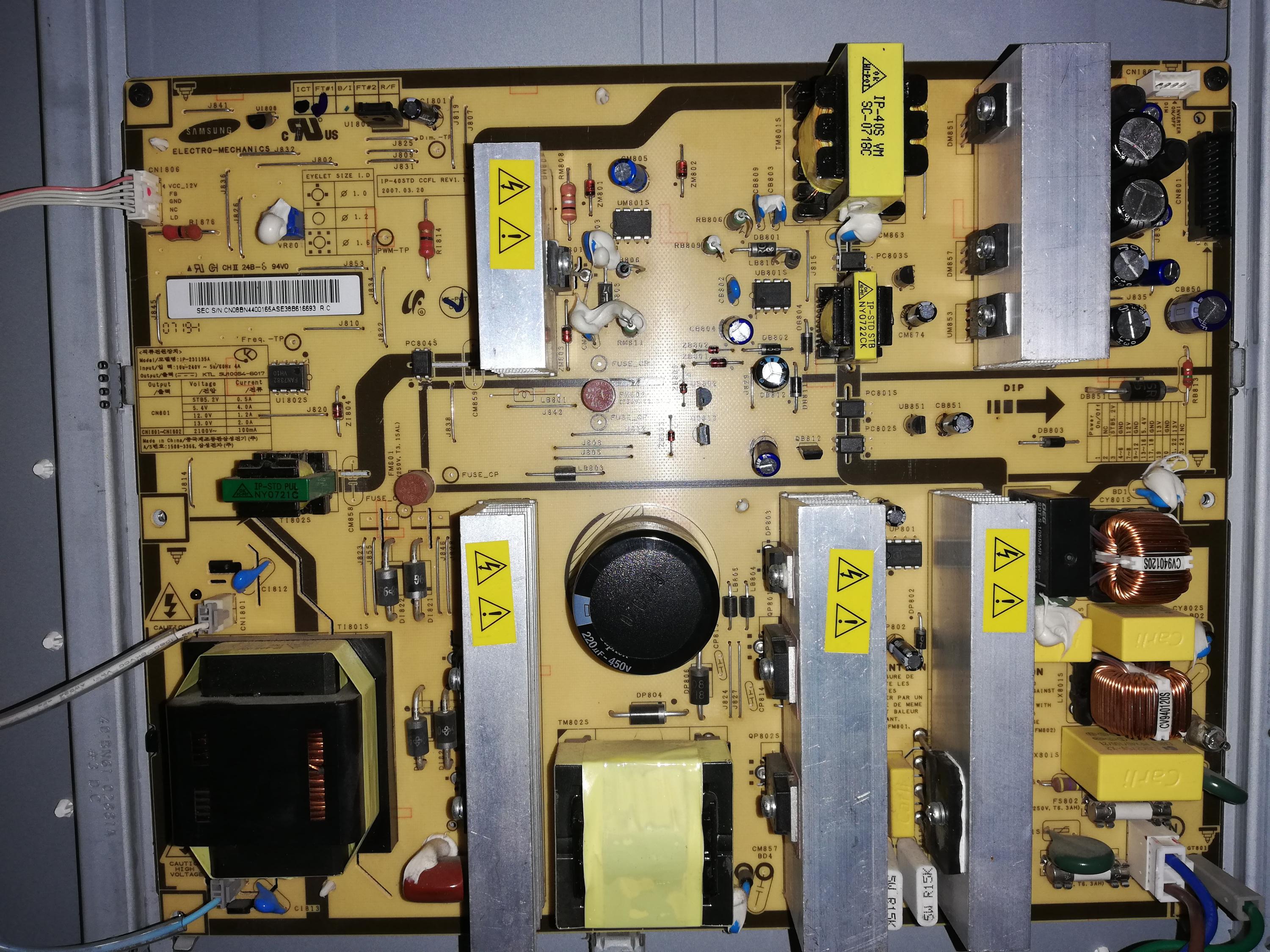

                                        Some more photos
