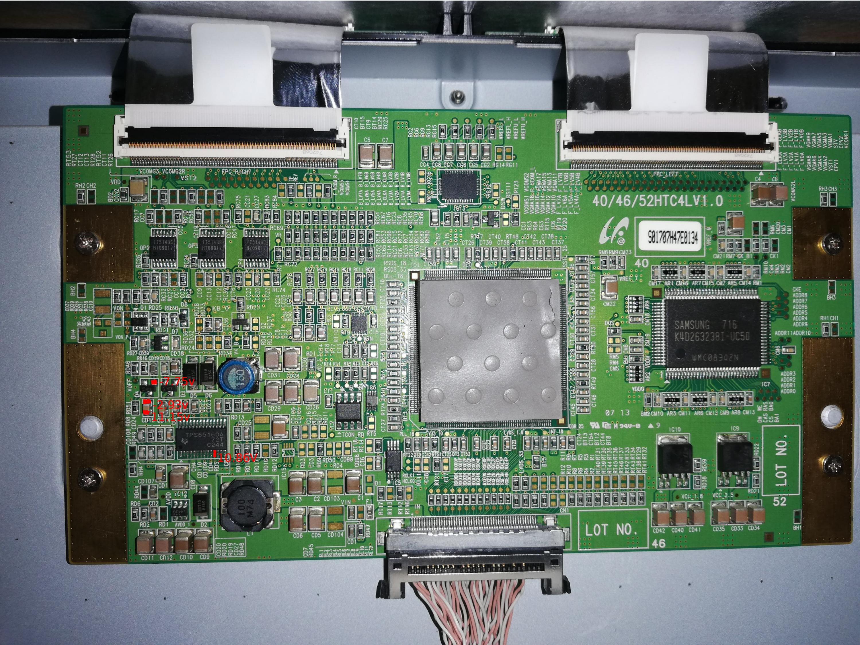

                • Amraks
                  • Nov 2011
                  • 725
                  Re: Sasmung la40m81bd - Recapped
                  Just measured pin 4 on TPS65160A in diode mode its reading 0.168v
                  • Dannyx
                    CertifiedAxhole
                    • Aug 2016
                    • 3912
                    • Romania
                    #29
                    Would that reading be in relation to GND ? If so, repeat the measurement in ohms just for the sake of thoroughness. Still, pins 4 and 5 give you the boosted 15v output, which you seem to be getting, given you last results: AVDD = 15v. If there were any dead shorts, you probably wouldn't get any picture at all.
                    This is a good time to measure VGH (voltage gate high) and VGL (voltage gate low) as well since the pins are clearly labeled in the datasheet for the TPS. They are pins 10 and 11. From what I've seen, "ghosting" occurs if VGL is not functional (the screen is not "discharged" and the picture gets stuck). Conversely: if VGH is not "charging" the screen, well, quite predictably, you get no picture. These seldom fail though and from what I've encountered so far, if VGH/VGL are not up, the fault is not in the T-con, but in one of the buffer boards where there's a short that kills VGL/VGH and it's not repairable at that point (the short is most likely in the COF - chip on flex)

                    • Amraks
                      • Nov 2011
                      • 725
                      #30
                      Never mind I wasn't even looking at the packages legs right lol
                      I measured pin 10 and pin 11
                      10 = 15.12v
                      11 = 4.54v
                      • Dannyx
                        CertifiedAxhole
                        • Aug 2016
                        • 3912
                        • Romania
                        #31
                        Pin 11 should read negative (usually -5/-6v). Try and see if there's a pad labeled VGL connected to that pin (there's a diode in series with that pin, so don't measure AT the pin, measure after said diode). The example schematic in the TPS's datasheet illustrates this. See how there's a diode D2 on the VGL pin there ? Measure after it and see what you get. Should be negative. If not you could be getting closer to the issue now.

                        • Amraks
                          • Nov 2011
                          • 725
                          #32
                          So pin 11 goes to CD15 then to D4
                          D4: -7.79v
                          Added a picture of the voltages across that line.
                          • Dannyx
                            CertifiedAxhole
                            • Aug 2016
                            • 3912
                            • Romania
                            #33
                            Would that value happen to appear at the test point marked V_OFF ? If so, it would seem they're not calling them VGH and VGL but rather V_ON (slightly higher, towards the mounting hole) and V_OFF, which is the same thing.
                            The value would seem right...a bit low, but should be within spec (the datasheet for the panel itself tells you exactly what it should be).
                            EDIT: also, could your describe, or better yet, post a picture of what the picture is doing currently ? I missed the video.

                            • Amraks
                              • Nov 2011
                              • 725
                              #34
                              Here is some more voltages I took.
                              VREFL_L = 330mV
                              VREFL_H = 6.45V
                              VREFU_L = 8.49V
                              VREFU_H = 14.68v
                              not sure if the top one is meant to have voltage going through it but it stands out as being something to pick on.
