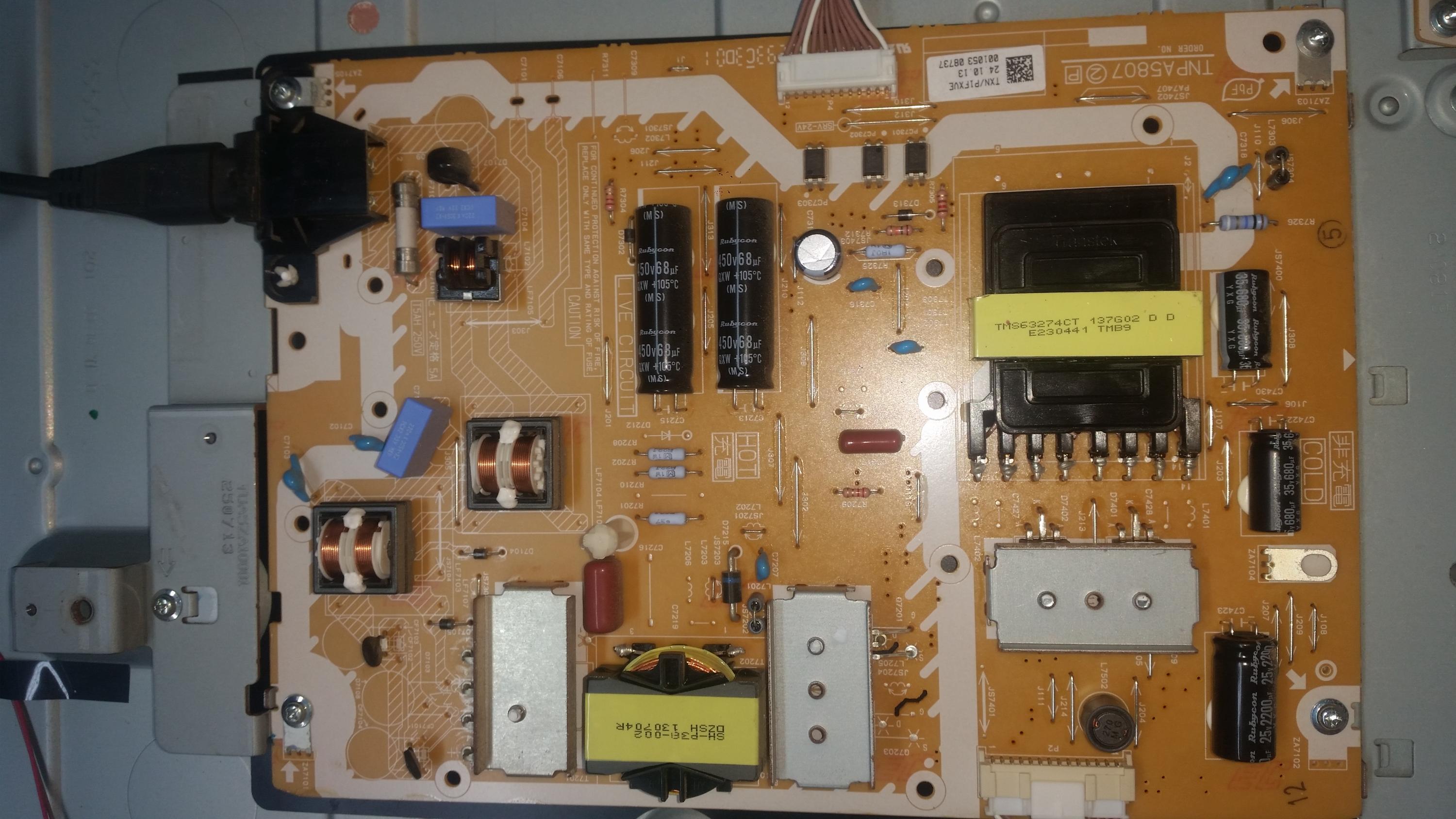

    I have this Panasonic TX-L50BL6E here

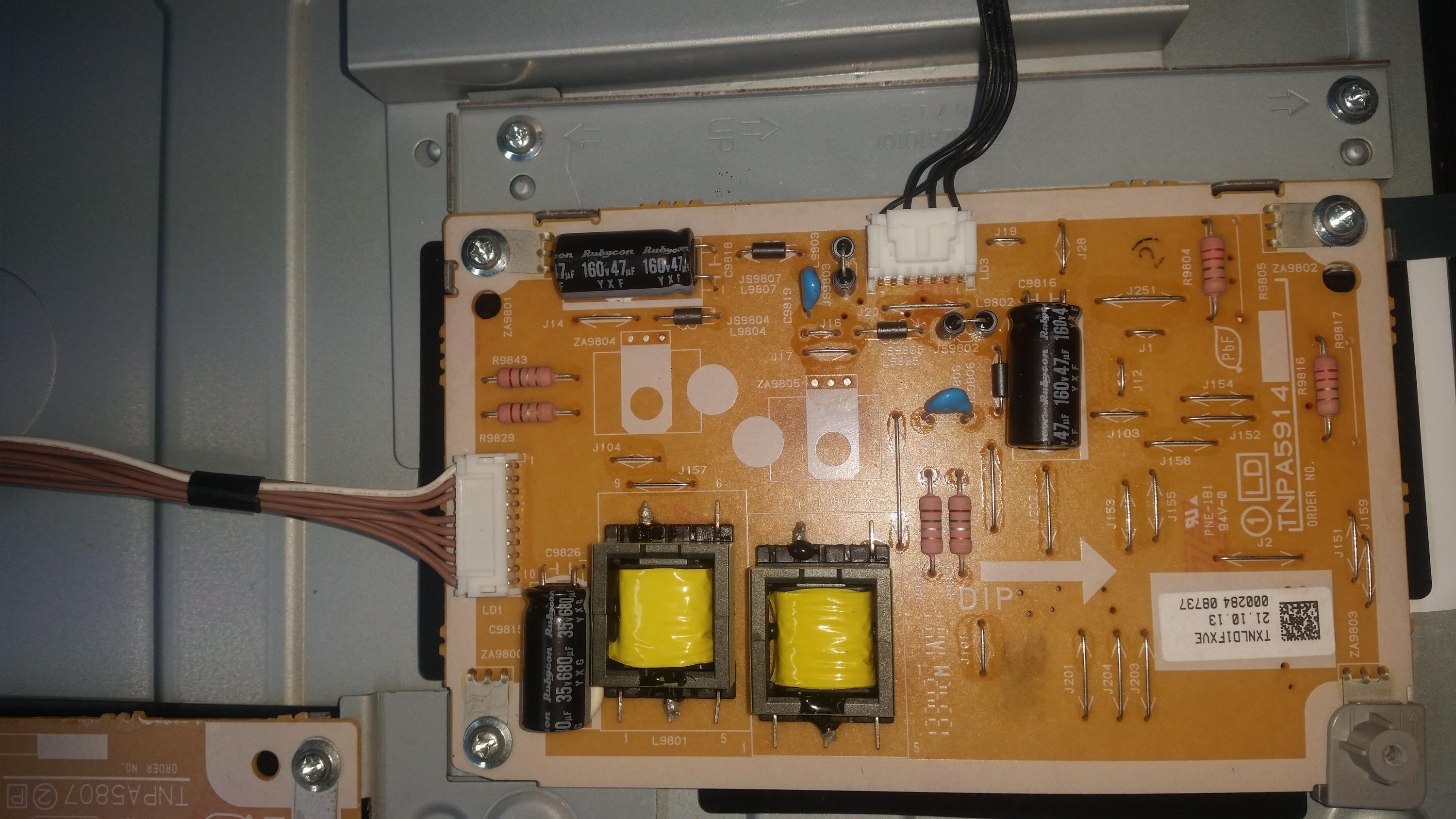

    The original problem was blown backlight LEDs and a short circuit power FET on the backlight driver PCB
    I've replaced the whole set of LED strips and the short circuit power FET. The set now powers up but is has another problem

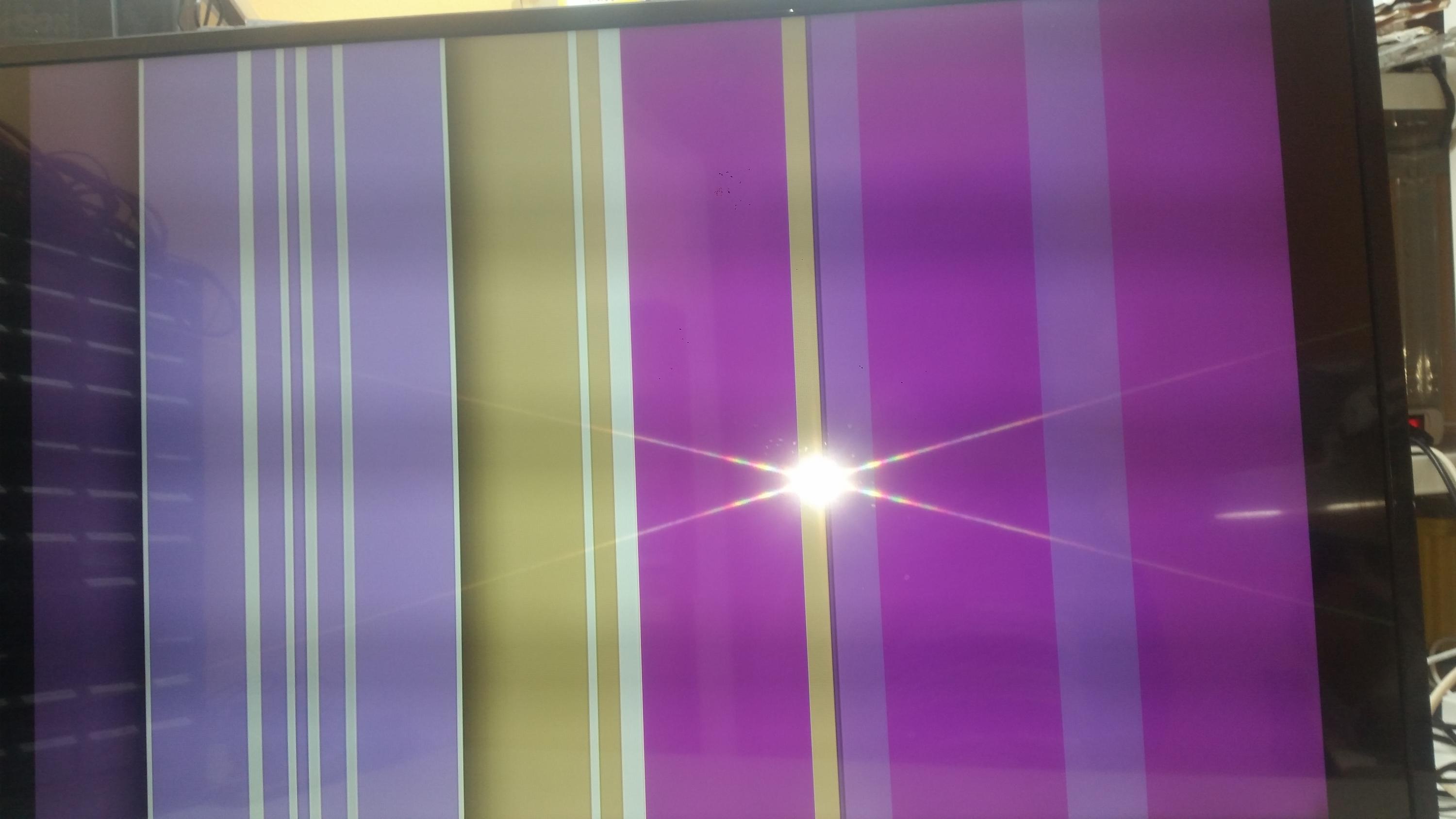

    When first powered up I get an image with the wrong aspect ration (too narrow and too high to fit the screen). Also on the left hand side of the screen there are regular spaced black horizontal lines that fade away towards the centre of the screen. The right side of the screen looks fine. These can be intermittend, the black lines flickering in and out.
    I can see the same horizontal lines on the onscreen menu and HDMI 1 message block before the image from the video source appears.
    Then after 5-10 seconds or so the picture disappears and I have a mainly purple screen with vertical lines, but no horizontal lines. This stays on screen until I power off and back on again, in which case the same sequence occurs

    I tried the TV with no video source and menu on screen. It behaves differently with no video source, I don't get that purple stripy screen after several seconds.
    The right hand side is OK, the left hand side has the horizontal lines which flash on and off at a regular pace and the brightness changes when the lines are on screen

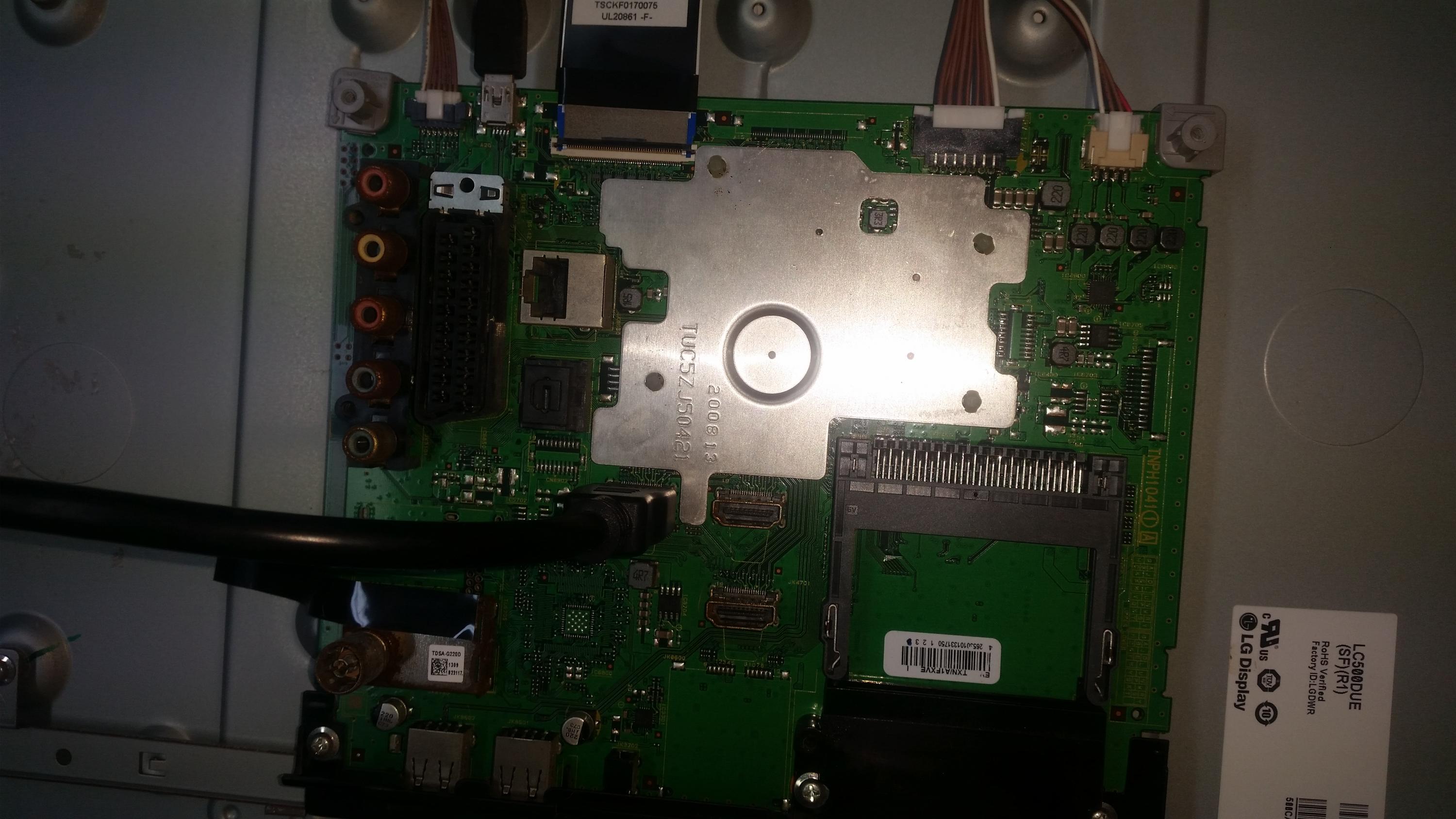

      The aspect ration i blame the motherboard,but it looks like your screen is defective also,at the first picture with the menus the bottom is trembling,common display fault,what a shit tv to have this many problems all at once.
      Update firmware on main,and/or enter service menu,try to do a factory reset.
      http://av.jpn.support.panasonic.com/...uk_cis_02.html
      latest firmware link,i hope that this TV can output comprehensible display long enough for that to be possible.

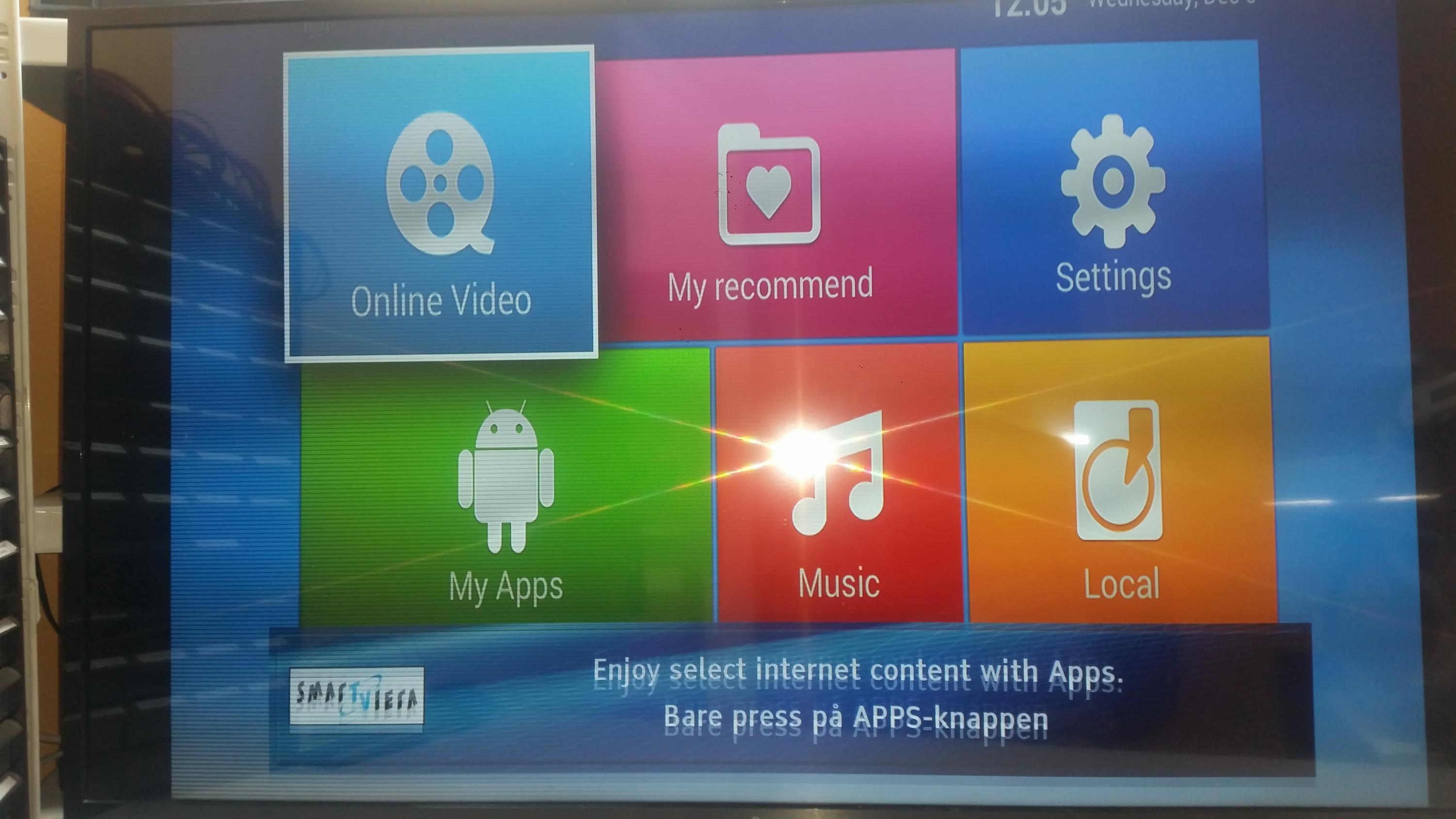

        Now I saw that ghosting effect you mention on the first photo but I think it is camera shake or something. I didn't notice it on screen
        OK so from your suggestion I got into the menu (I don't have the remote for this TV by the way) and this video shows there is a good picture all the way to the bottom of the screen.
        This video also shows the weird flashing with horizontal lines, ticking away like a metronome until all of a sudden........... whammmm wtf?

                  In this new video of yours seems like the aspect ratio problem is gone?
                  I say LVDS could be problematic and this flickering is main or t-con,the backlight does not become brighter etc.

                    I had a look for corrosion or deposits on the main board and it looks really clean to me. I removed it and checked both sides. The only corrosion is on the HDMI and component/composite connectors and metal casing of the Tuner.
                    I haven't checked the TCON board for corrosion/deposits but I will have a look. I did try reseat the LVDS already at the main board end but not the TCON end
                    The Panel PCBs are dry and clean, I already removed the panel to replace the backlights as mentioned. And fixed the backlight driver PCB fault
                    I do agree - the aspect ratio looks OK with the menu on screen but not with a video source
