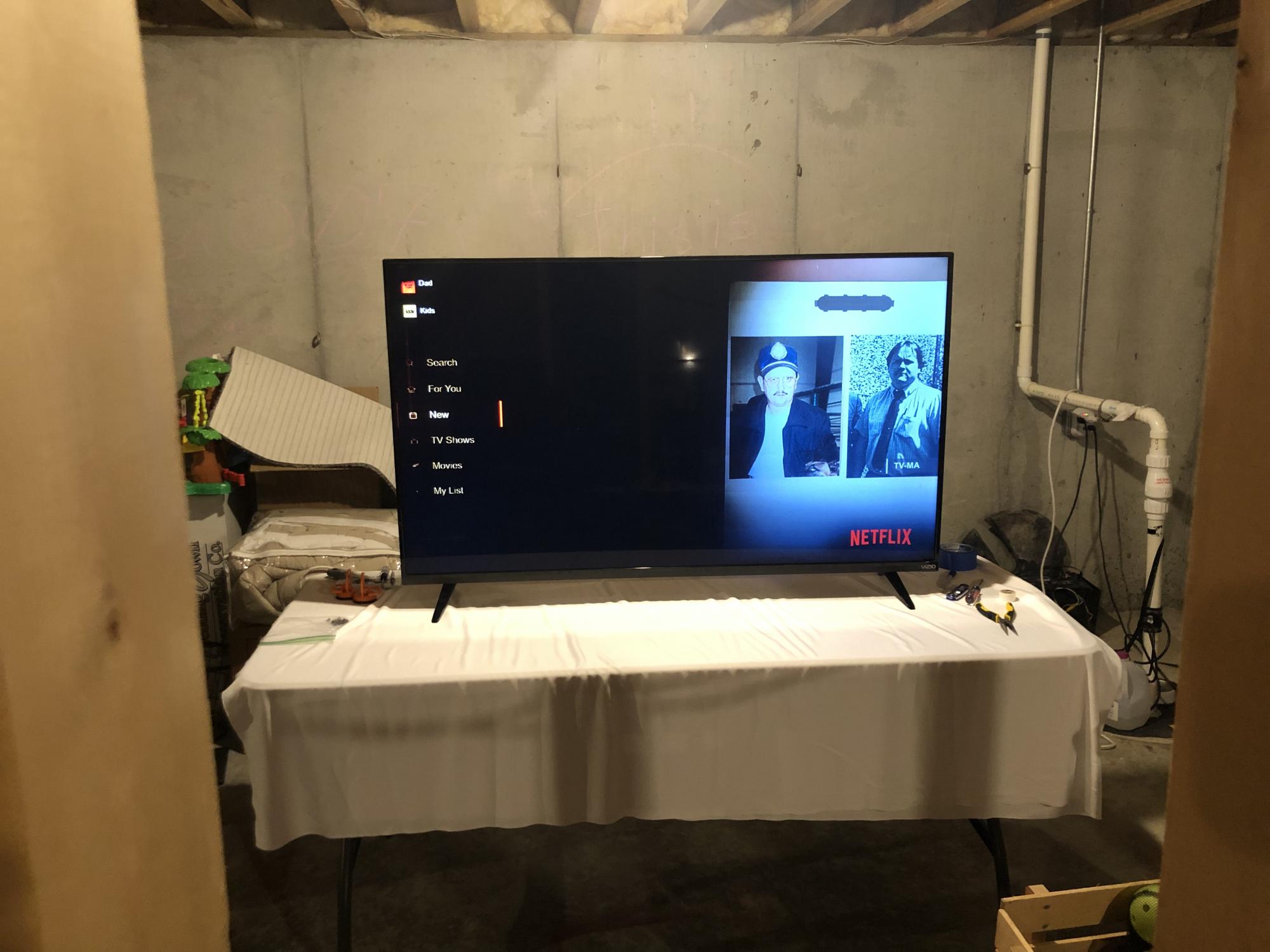

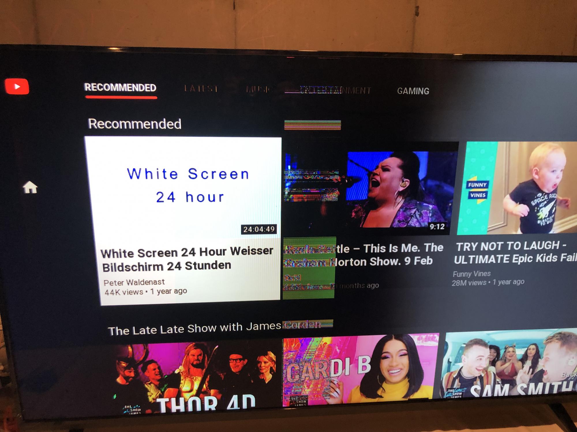

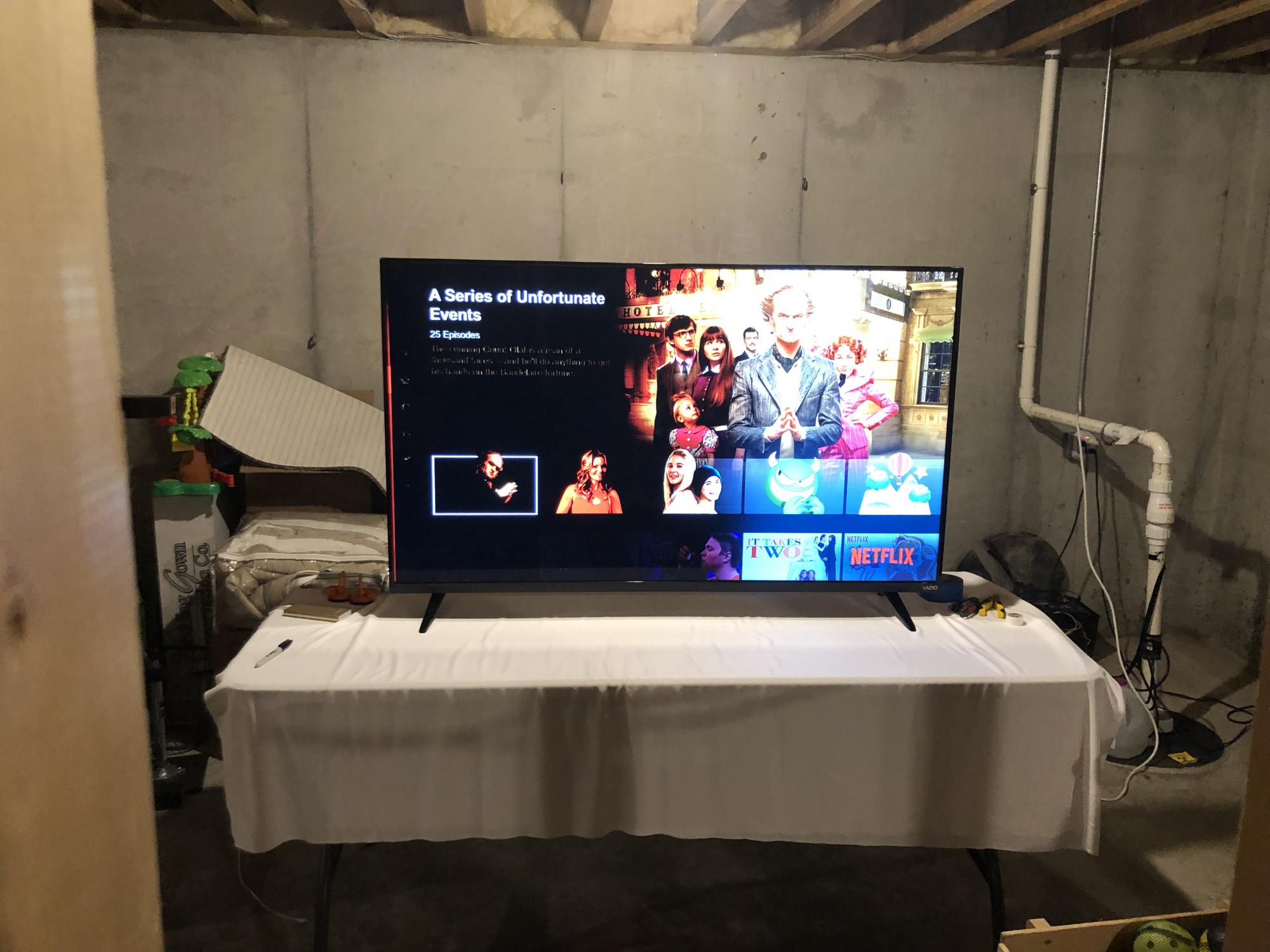

                                      Update-01/07/19
                                      I finally have received my replacement backlights and have installed them successfully. The disassembly of the tv actually went very smooth. Took my time, wore gloves, used sucktion cups to remove panel. When I put it back together, again, everything went smooth and without issue.
                                      I turned tv on and the left side of picture is darker and there is pixel lag. The right side is bright and sharp. I have included images of new issue.
                                      Things I have tried:
                                      Disconnected Tcon ribbons, inspected, cleaned, and installed correctly.
                                      Ensured the “address bar”, things connected to tcon board are not damaged. Nothing visible.
                                      I have attached images of the new issue.
                                      Any suggestions would greatly be appreciated.
                                      Please keep in mind I am not a professional and do not have a deep knowledge of “electrical systems”. But I am techy and willing to take a shot.
                                        Re: Vizio D58u-D3 failing leds, seeking strips or leds
                                        That is usually a symptom of bad tab bonds (the flex circuits that connect the panel to the narrow circuit boards). Sometimes they can be shimmed to create some pressure as a workaround.
