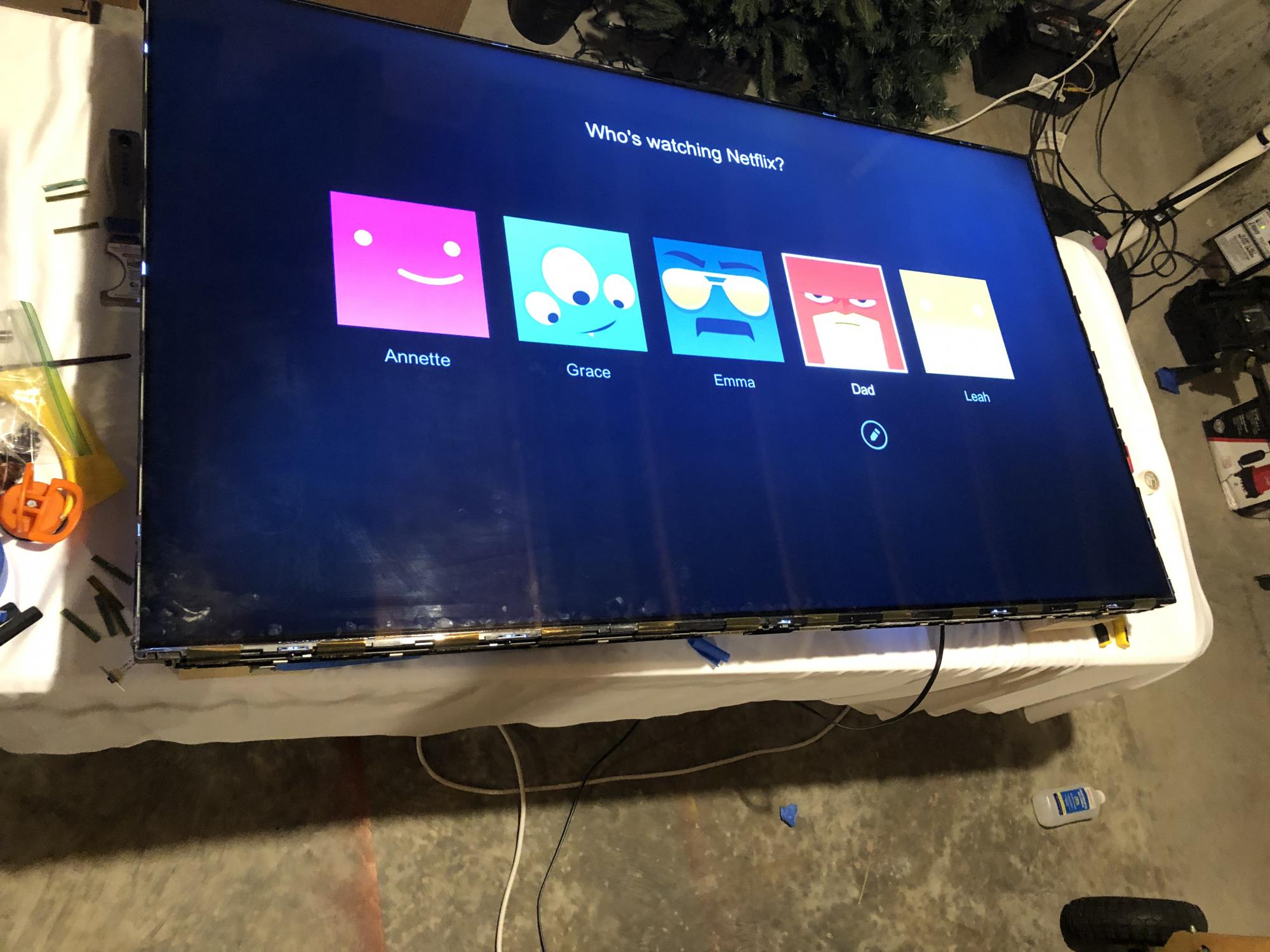

    Do you know of any youtube videos that show the the tab removal process? I havent found any just yet.
    • dragonsbb16
      • Nov 2018
      • 37
      #42
      Re: Vizio D58u-D3 failing leds, seeking strips or leds
      Also, not sure if you can see it on the pictures of the side tabs...on the Vizio there is not side address bar. So the side drivers dont appear to be connected to anything. It almost likethe tab is integrated into the panel somehow.

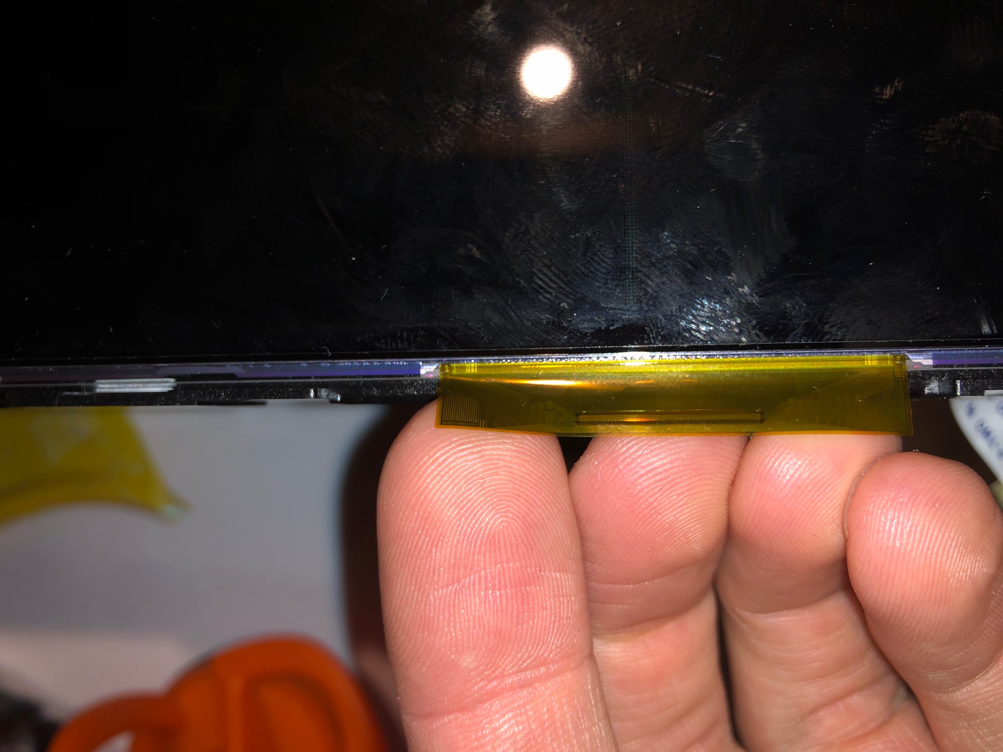

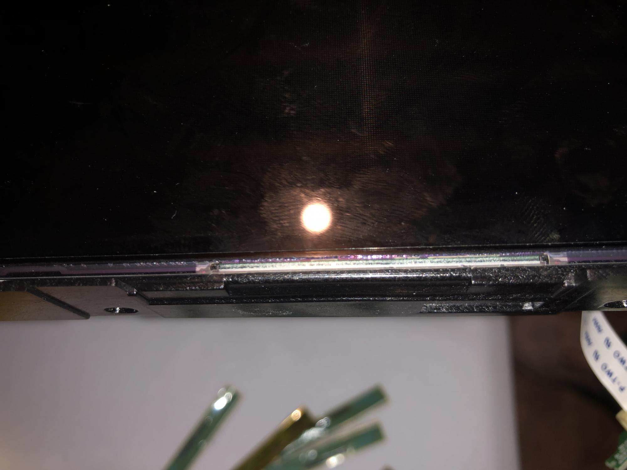

              #46
              Here is upclose pic of the tab closed to bottom of tv.
              It sort of looks like there is about 1/16" that looks like it is connected to the panel. So maybe cutting it off is no good.

                    #49
                    I have actually seen YouTube videos showing people using heat. The glue holding the tabs on will soften with heat. Look here starting at around 55 seconds:
                    https://www.youtube.com/watch?v=vyKOL-Xwo1Q

                          #52
                          Moment of truth....tabs have been removed clean. Hair dryer worked like a charm. They came right off nice and smooth.

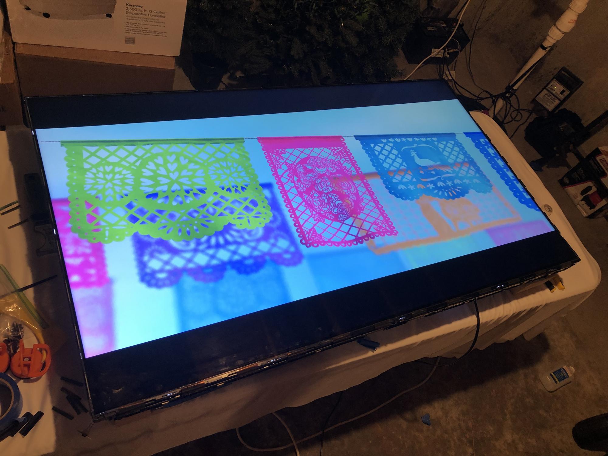

                            #53
                            Wow. Worked like a charm.
                            See images.
                            Thank you for all your help and suggestions.
                            Horizontal lines are gone. Picture is perfect.
