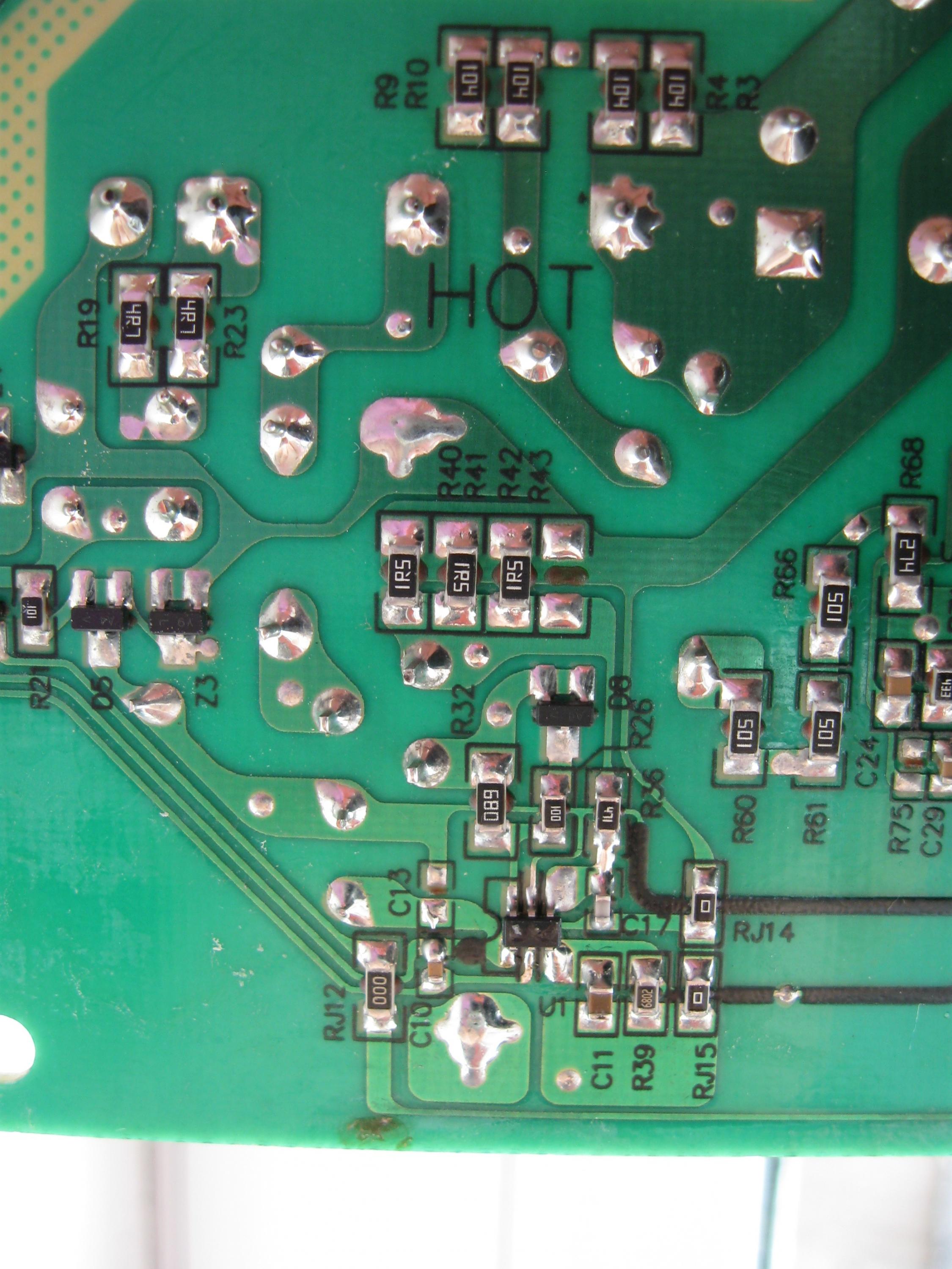

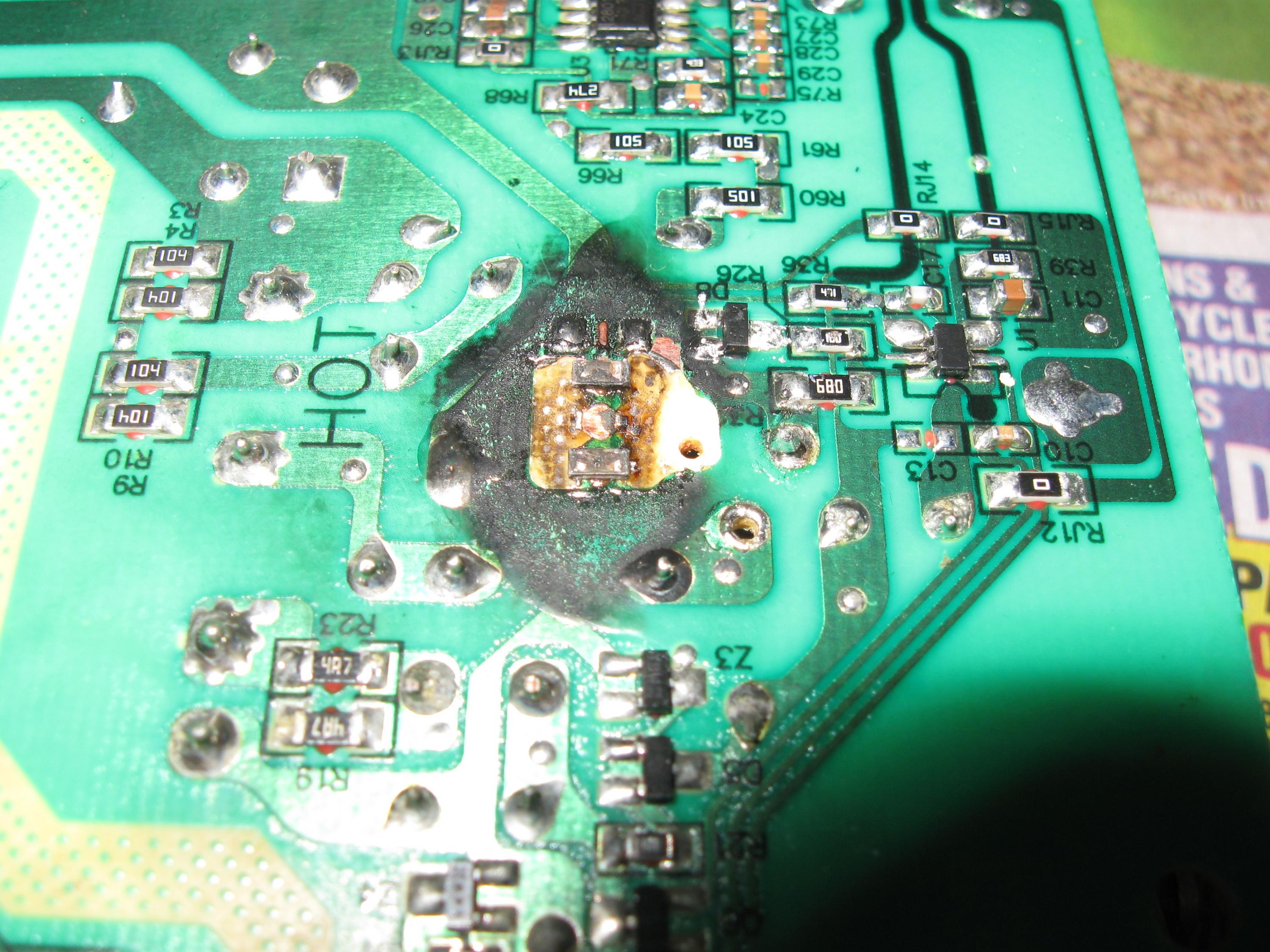

    I have this Megmeet MIP390HW power supply which had some blown components after a mosfet shorted out. I have replaced the blown resistors R40, R41, R42, R26, R32 and the mosfet Q4. The main fuse T5A was also replaced.
    However I cannot seem to find a schematic for this power supply to identify U1 which I believe is blown as a result of the resistors vaporising together with the mosfet.

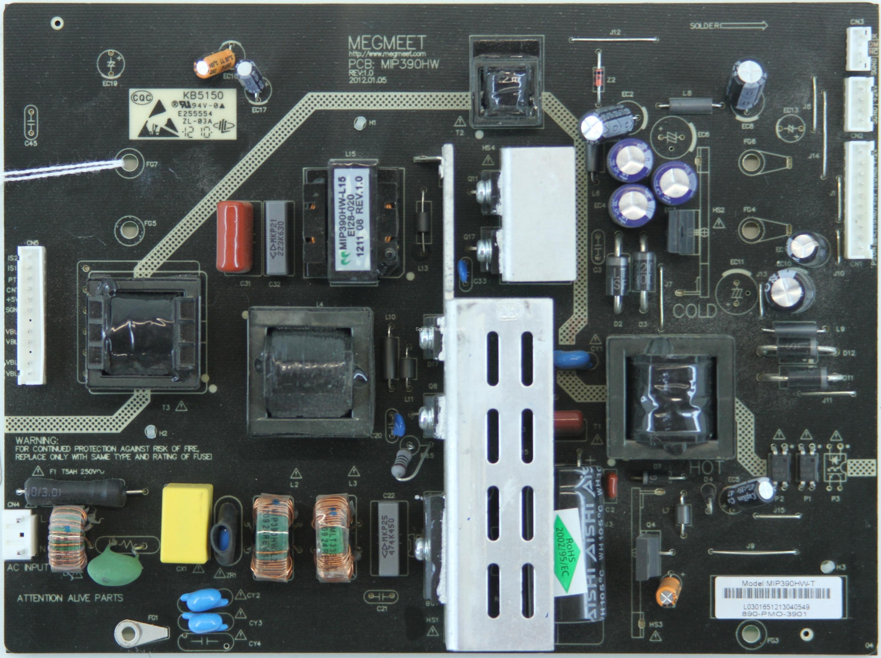

    I have attached a close up of a working psu together with the blown board before replacing components.
    I don't have any standby 5V which I suspect is down to U1. So any help with identifying the IC U1 or schematic for this Megmeet MIP390HW from a Technika 39C273 tv would be great.

    It nay be NCP1250.
    Looking at your board lay out, the connections of the IC's pins seem to match with NCP1250.
    1 = gnd
    4 = CS
    5 = VCC
    6 = Gate drive
    BTW, it also matches FAN6862-D, SG6858.

      Another one might be a OB2262, any numbers on the ic of the working power supply ?

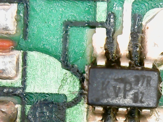

        I took the pictures of the working psu before the TV was sold. Thinking about it I could get the microscope out and examine the old one to see if I can get some numbers off it. It appears to have lacquer over it which might make it a little tricky to determine what it is. Any thoughts as to an easy removal of the lacquer without damaging the information on the ic?
        I will keep you updated on how it goes with pictures...

          Ok here are the pictures of the ic! It doesn't look to be any of the suspected ics as it is marked KvP amongst other things. Over pin 5 it looks like part of the ic has blown a small hole in it which is where R26 and R32 were open circuit.
          I am now trying to identify this ic picture attached.
          I removed the lacquer with white spirit, my finger nail, toothbrush and cleaned up with isopropanol.
          I didn't have any success with KvP but as soon as I searched for 37R came up trumps.
          Datasheet attached.
          Now off to order it
