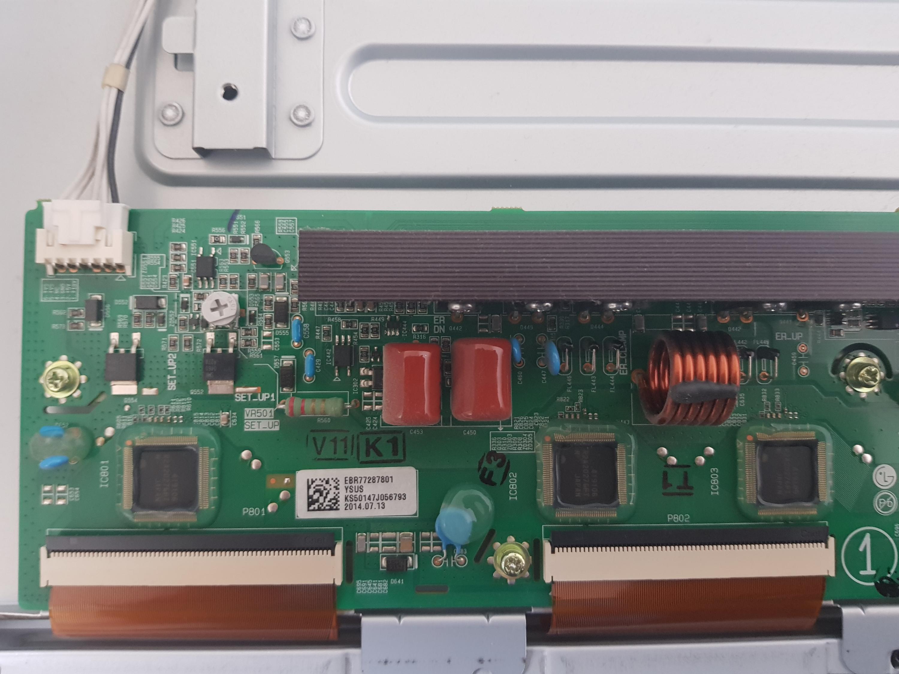

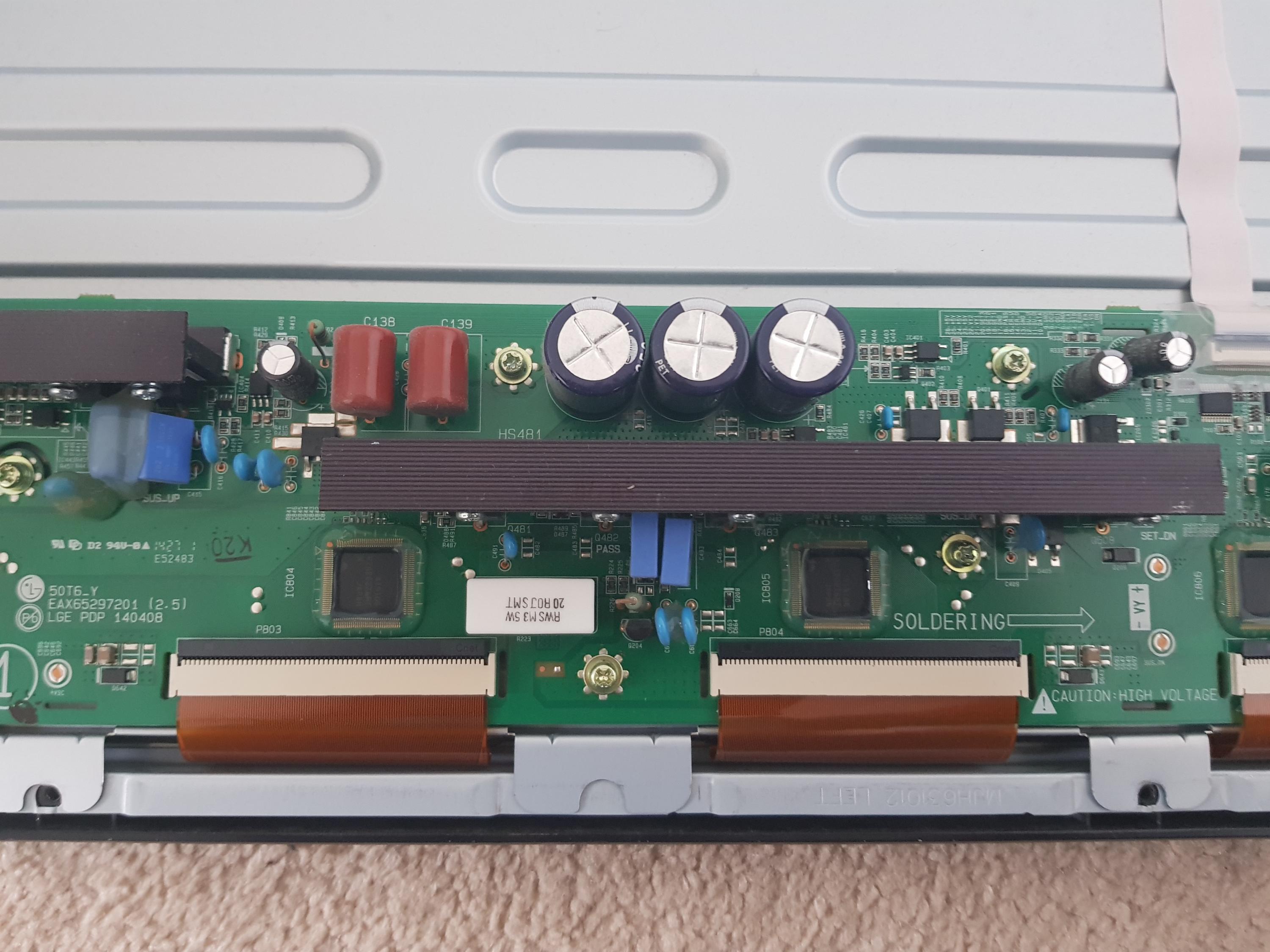

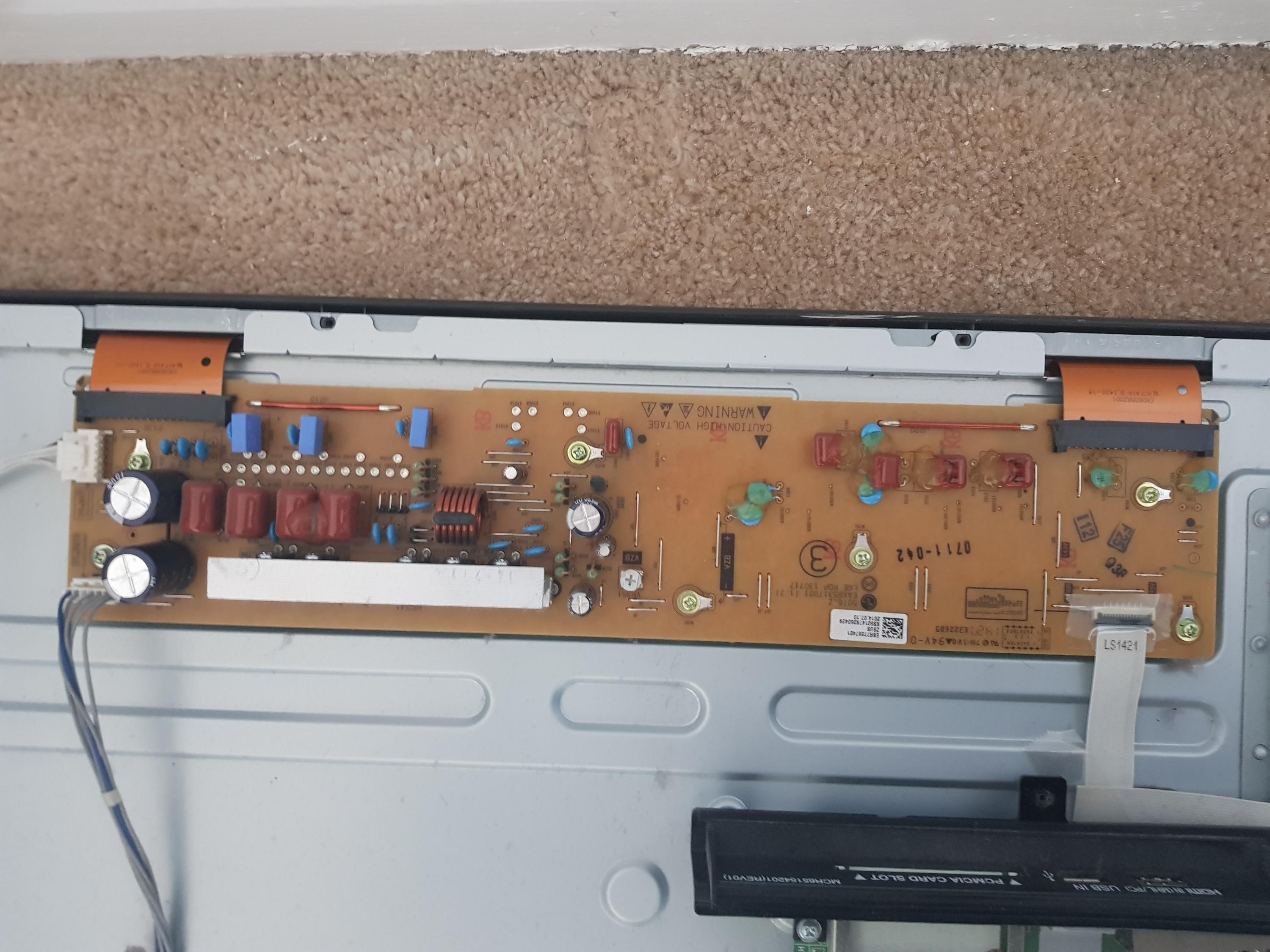

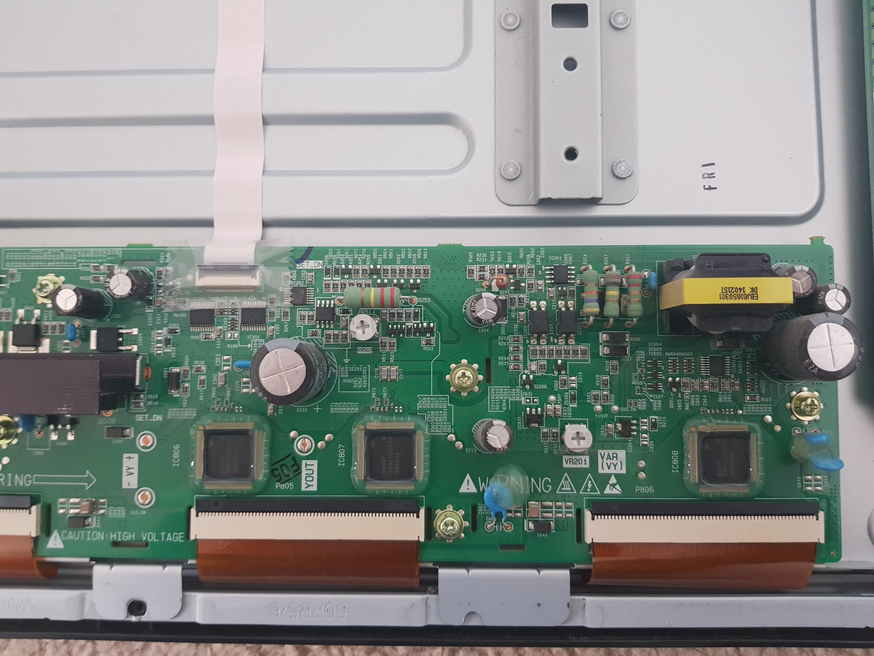

      No. I don't think that will solve your problem. Look at the Y-sus Bd. on the left looking from the back. Did you do any voltage checks??
        Re: LG 50PB560B Plasma wont turn on
        No mate havnt done anything yet, as mentioned earlier I havnt a clue where to start wirh it

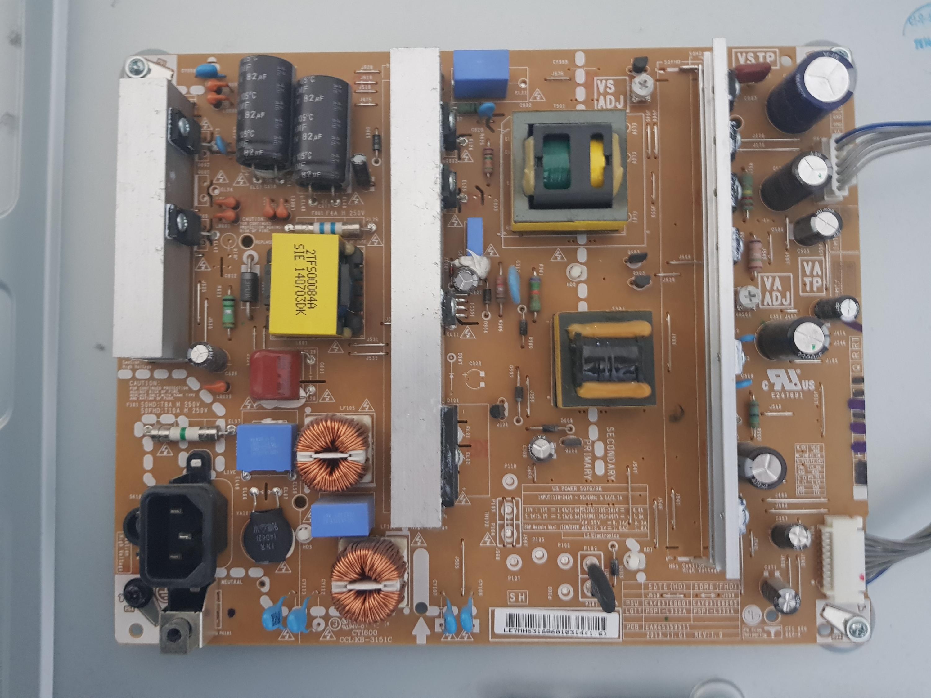

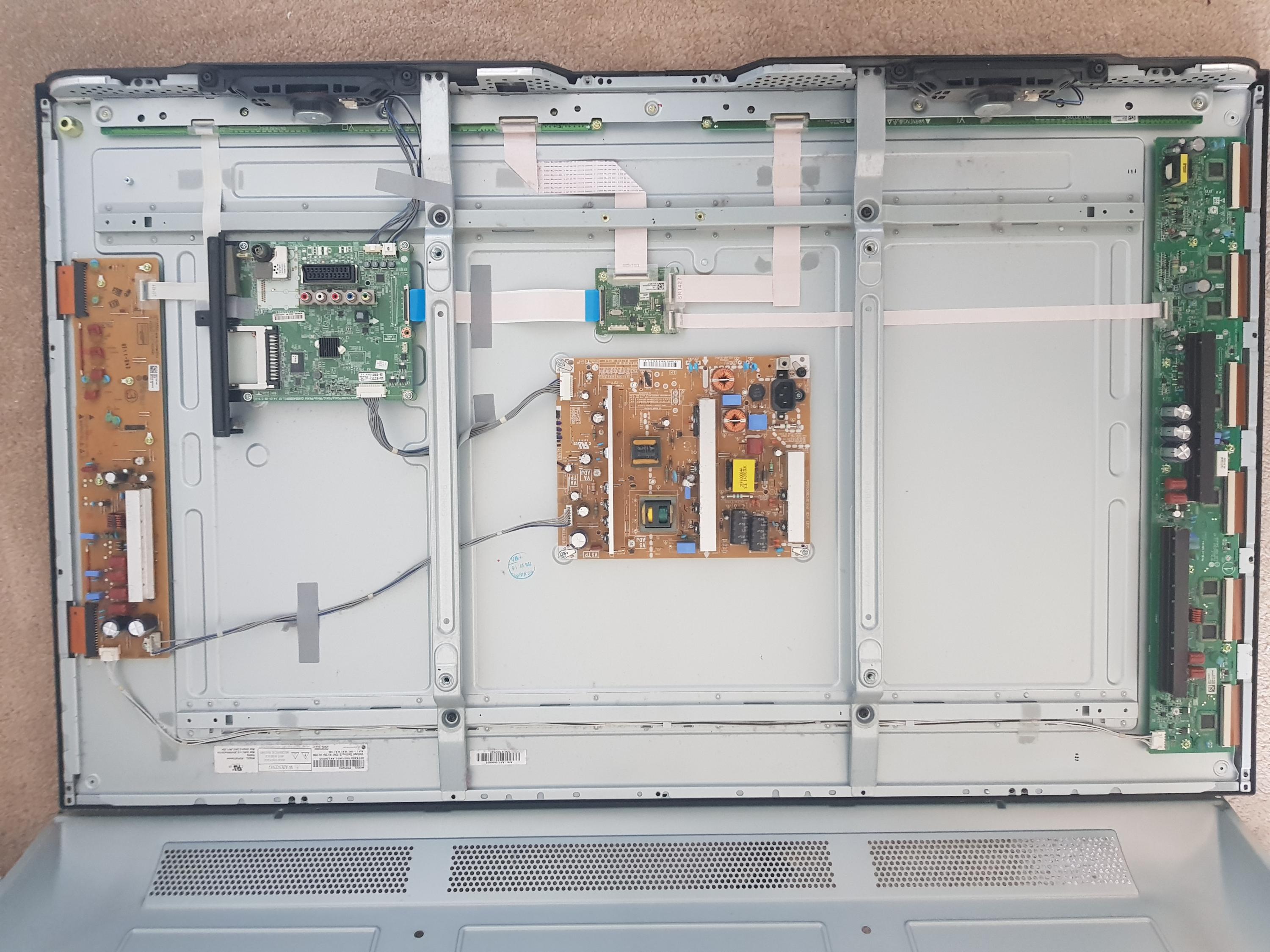

          Post clear, focused photos of the back of the TV so we could see how the boards are interconnected and close ups of the PSU connectors that go to the Y-sus Bd. and the Main Bd. BTW when you press the Power button and the set tries to turn on, do you hear any 'click/s' from the PSU? Do you have and know how to test voltages with a DMM??
            Hi, I have a DMM, but dont know what to test or how to test it lol.
            There is no click from PSU when press the power button, there is litterally nothing, just solid red light.
            I have taken pictures, if you need anymore please let me know. Thankyou very much for your help so far, appreciate it.

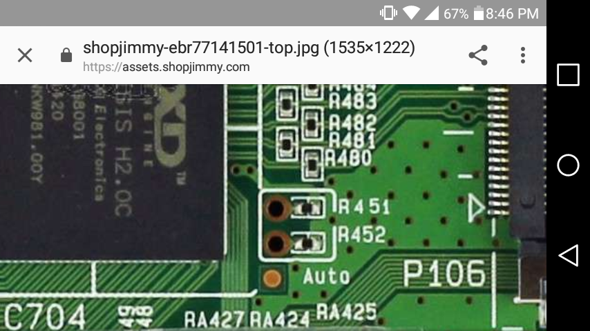

                          Unplug the ldvs cable(flat one) that runs from the Main board to the control board and put a piece of wire in the holes on control board marked r451 and r452. If you have test patterns and colored screens your main board is bad.
                            Hi, did what you suggested, and still wouldnt turn on, so unplugged the cable from PSU to main board, and it turned on, then did what you said and got test patterns
                            So I need a main board??

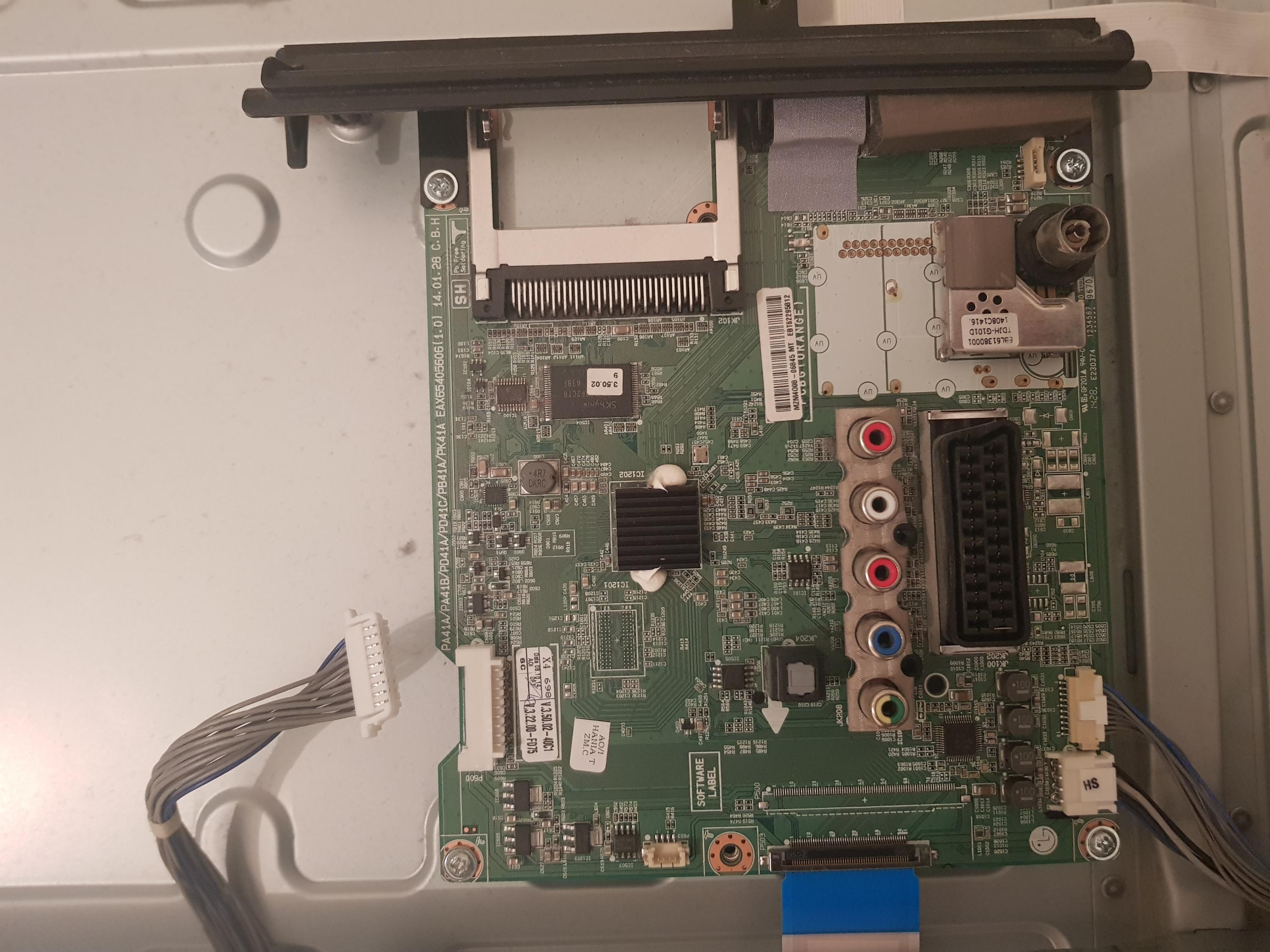

                                  Know this is an old thread, but after searching for almost a year, I still could not find a replacement board, so I sent it off to EMOS for their repair service, they have returned the board saying they cant find anything wrong with it. So now Im really stumped, anyone have any suggestions as to where to go regarding this now please?
                                    Received my main board back this morning from the repair company who say theres nothing wrong with it.
                                    Fitted it back into the TV, and still exact same, stuck in standby.
                                    Unplug mainboard and run test patterns and thats fine.
                                    Does anyone have any idea what I can do before it goes for scrap as no replacement main board available, if it is infact definitely the main board at fault :/
                                      I have finally found a replacement board, strangely enough, from the place I sent mine for repair who said there was nothing wrong with it :/
                                      Should receive it this week, so I will see if it sorts the problem, and if so, question why they said there was no fault found with my original board
                                        So, replacement main board arrived today, swapped it out, and absolutely no difference :/ so clearly my main board was ok as the repair company I had test it stated.
