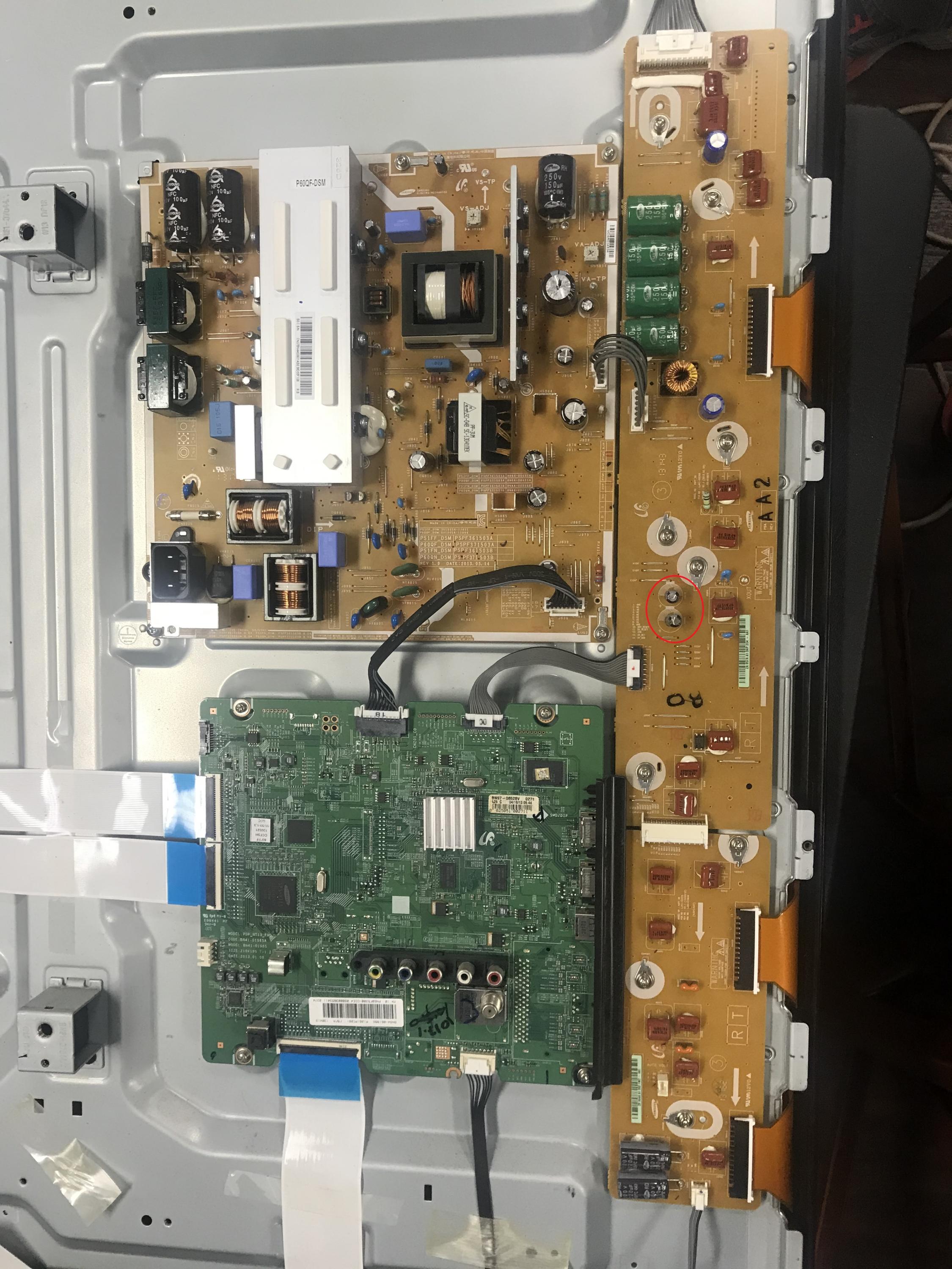

    A sports bar/restaurant with ~40 Samsung Plasma TVs. This is the 2nd TV that has a blinking standby LED. I'd like to learn how to repair these TVs because I'd guess that over time more and more of them will develop this symptom. My hope is to repair the bad PCB, however if that's not realistic then I'd replace the bad PCB.
    Model PN60F5300AF, Type PN60F5300, Model Code PN60F5300AFXZA
    Upon applying power, the red standby is steady. When I tap the power button, the standby LED immediately blinks twice, then it blinks once ~ every 4 secs. Also, Upon applying power, the MB's green LED is off; when I tap the power button it immediately flashes twice (one short, one longer), then briefly blinks about once every 3 secs. No video is seen.
    Panel Info: Model S60fh-yb01, Date 2013-07-02, Vs 208, Va 57, Vsc -192, Ve 108.
    PCBs:
    PS: PSPF 3715003
    Main Board: BN41-01965
    X buffers: 60FF_XM & 60FF_XB
    Y Sustain: 60FF_YM
    Y Buffers: 60FF_YB_UP & 60FF_YB_LOW
    Actual panel voltages:
    VS 208V (for a few seconds, then drops off)
    VA 57V (for a few seconds, then drops off)
    VE 10V ... 8V ... 11.4V
    VSC -2V (for a few seconds, then drops off)
    It looks like VE & VSC are powered off of VS so maybe it's expected that they are nearly non-existent.
    PS CON1
    STBY 5.2V in standby, same after tapping power button
    PS-ON 3.3V in standby, 0.0V after tapping power button
    VS-ON 0.0V in standby, 3.2V after ~1 sec from tapping power button
    VS-CON 0.0V in standby, 1.5V after ~1 sec from tapping power button
    15V pins are 15.5V, 5.3V pins are 5.23V
    Pics are in my GDrive. https://drive.google.com/drive/folde...EX?usp=sharing

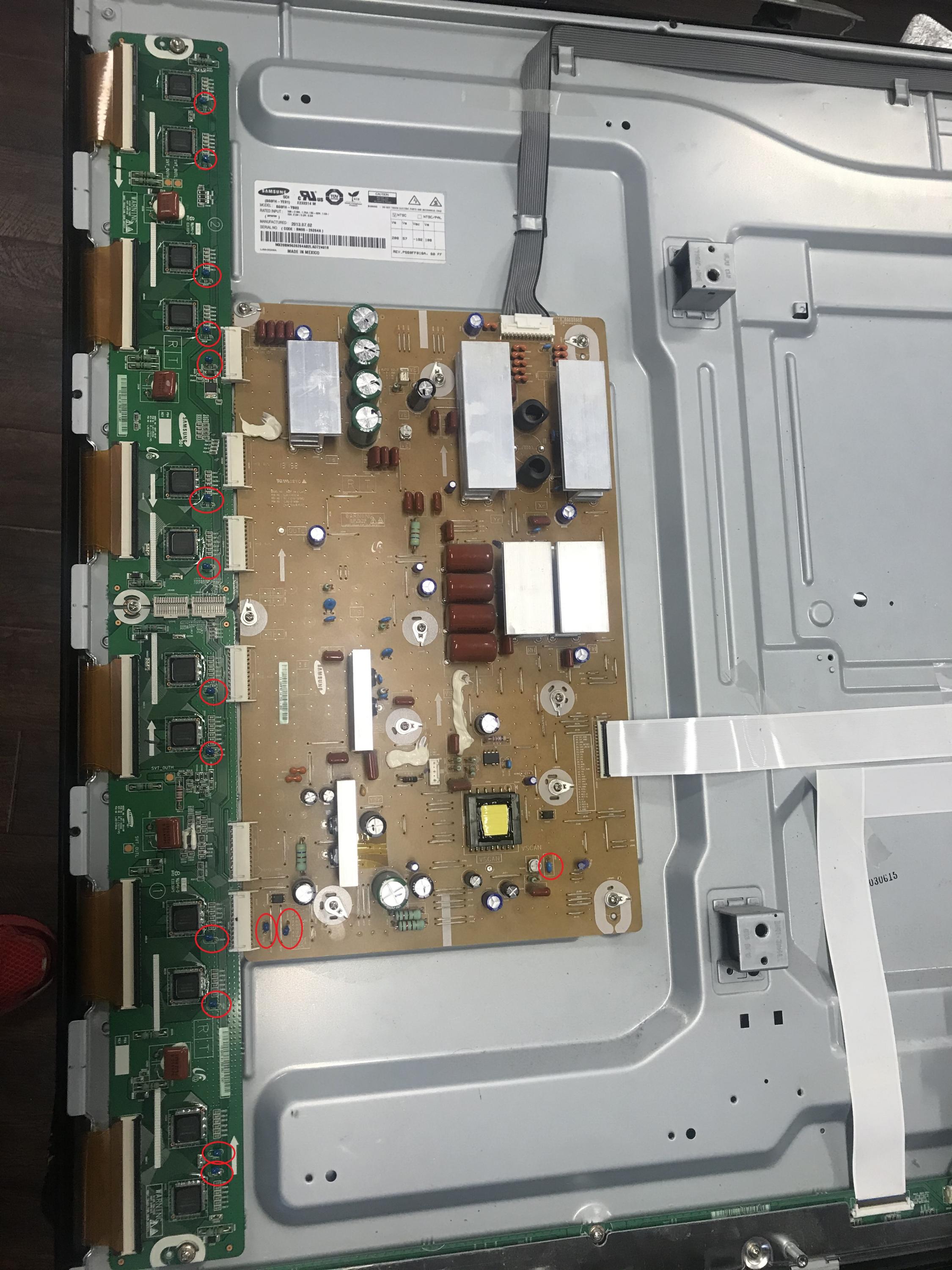

                I replaced the large uF blue ceramic caps, but the PS VS/VA rails still turns off after a couple seconds. Two electrolytic caps on the X board had a tiny dark spec near where the plastic folds over the AL top, which could have been a leak, unsure, so I replaced those.
                C4006 & C4015 - 220uF 25VDC
                Y
                C5001 - 104K 300V
                C5013, C5127 - 106K 50V
                Y Low
                C5536, C5541, C5542, C5539, C5535, C5540 - 106K 50V
                Y Up
                C5434, C5437, C5455, C5436, C5431, C5430, C5435 - 106K 50V
                Does anyone know if I can test the Y SUS's power supplies by forcing the PS on while the X cable is connected to the Y SUS? I don't want to damage anything...

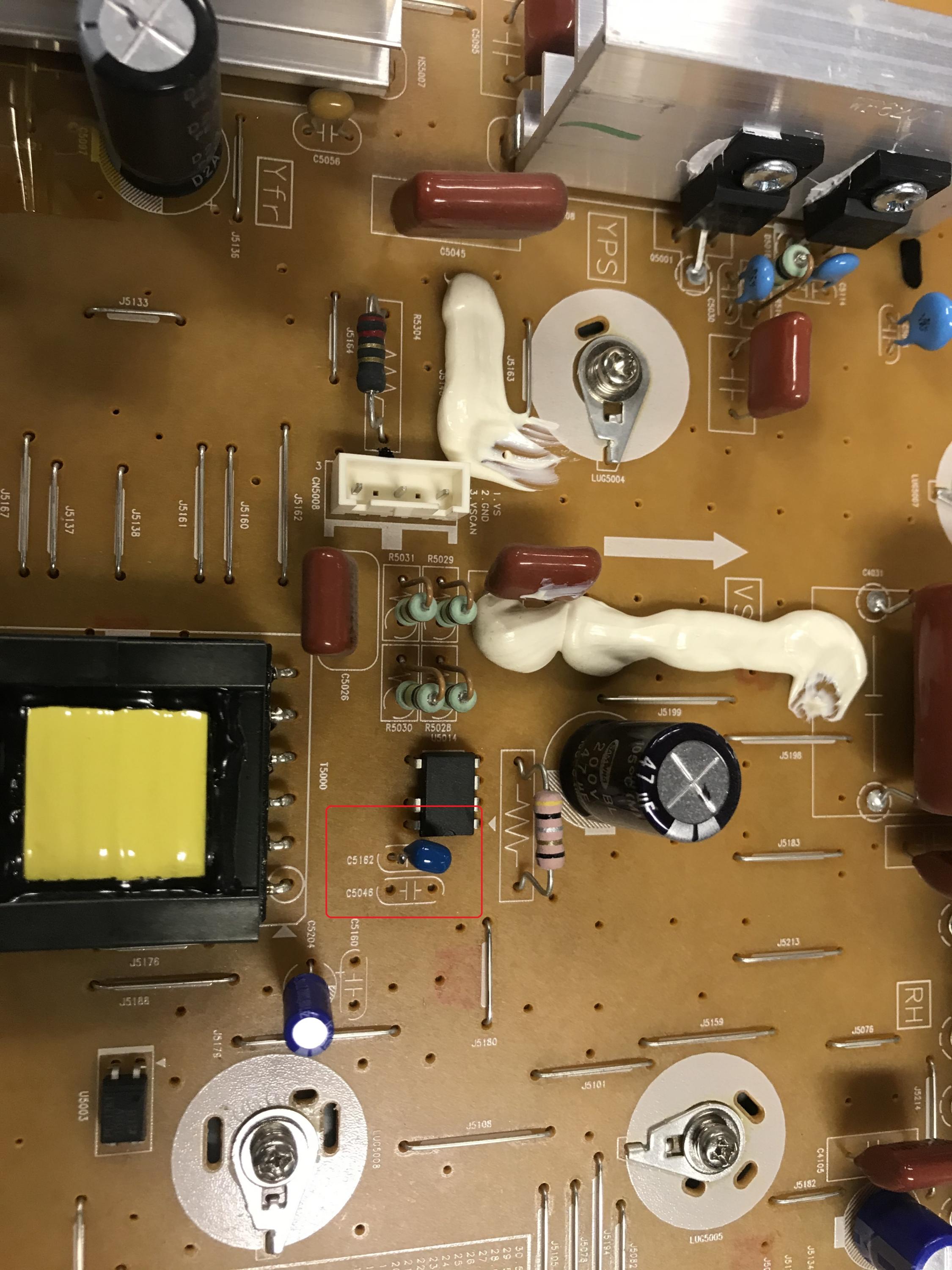

                  See my post may help:
                  https://www.badcaps.net/forum/showthread.php?t=86898
                  • rju
                    • Jul 2020
                    • 10
                    Re: Samsung 60" Plasma TV, Blinking Standby LED
                    @Sevenqi, that cap, that was it! It's a 106K that I missed when I was replacing "all" the 106K ceramic caps. THANK YOU!! ITS WORKING!!

                          I worked on the 2nd Samsung 60" Plasma today. It also had no video, Standby LED blinked. I swapped C5162 106K on the Y SUS board. It works again!
