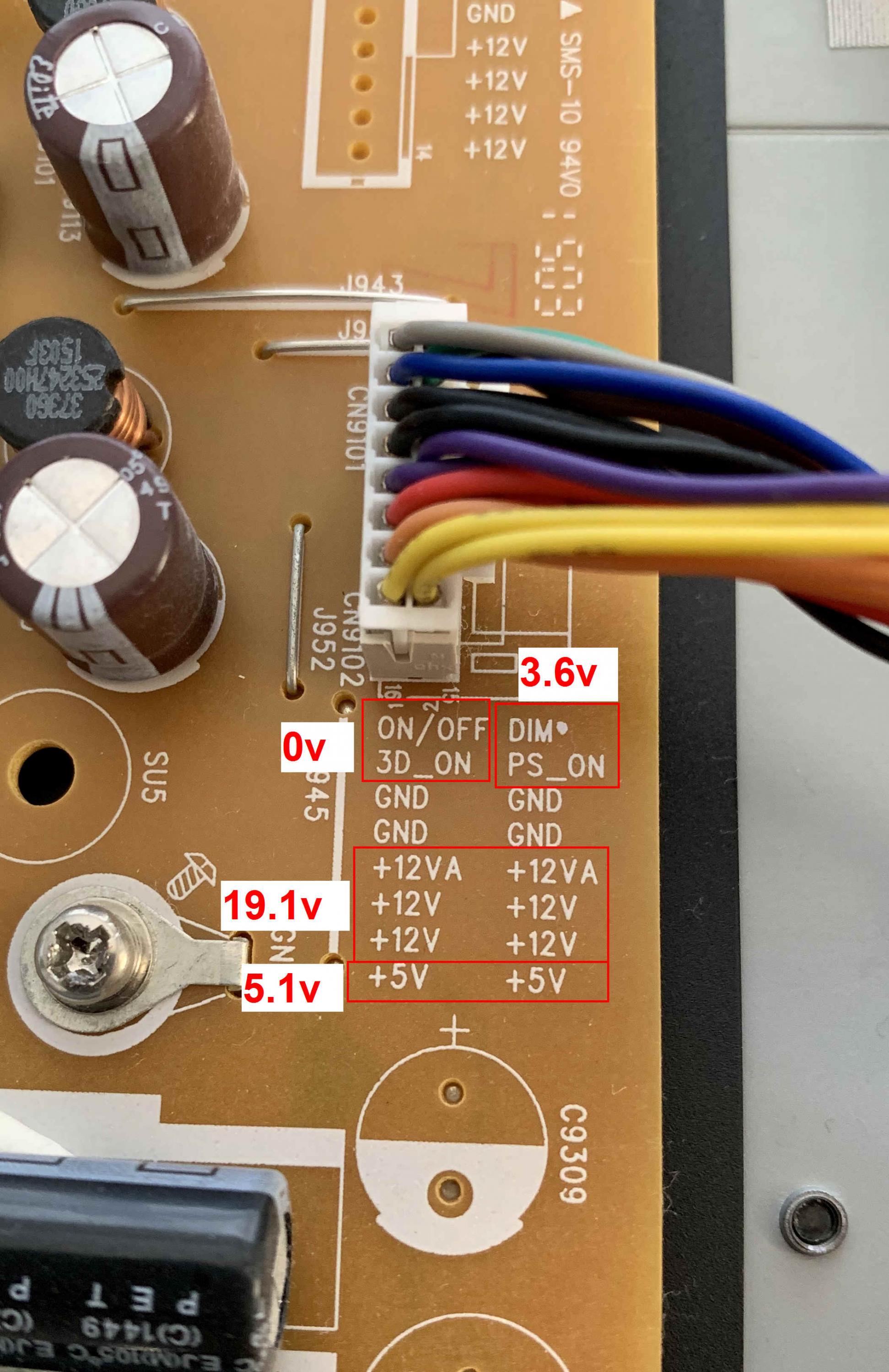

    Does anyone have schematics for any of the boards in the Vizio M50-C1?
    I am unable to power on the TV. I can see a blue-ish LED illuminated, located on the back just behind the Ethernet connector. I assume this is the main board.
    Checking voltages on the power supply board seems to show some odd values. On CN9101 (image attached) when the power is expected to be off/standby the voltage on the "5v" lines is 5.1v as expected, but the 12v lines are reading around 19.1. That seems to suggest PS board issue, but I'm not convinced yet.
    Thoughts?

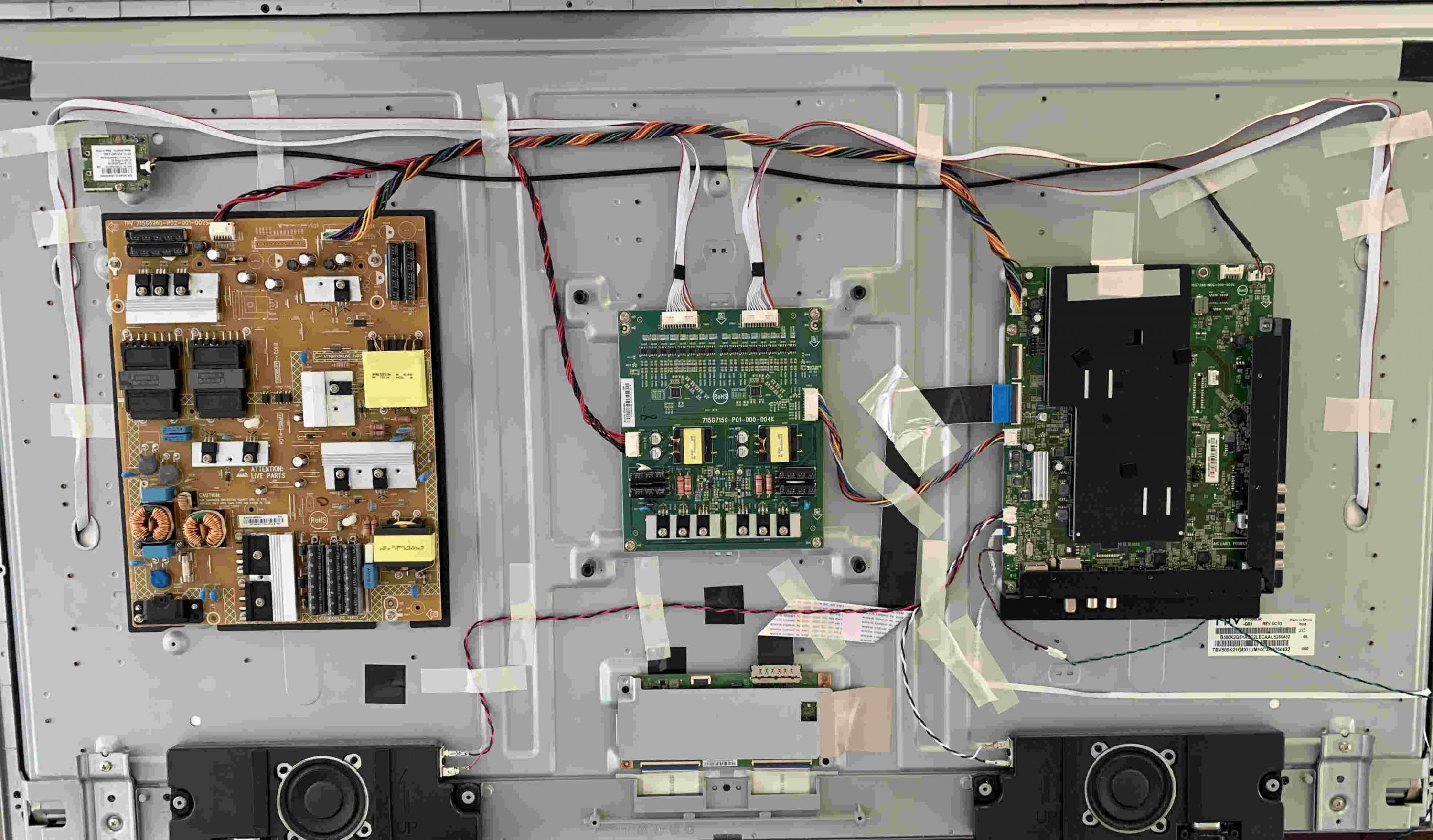

    you need to post pictures of the back layout so the forum can see how things are connected.
    Further, depending on how things are connectecd, the 12v line may go to the main board to be switched to the tcon or go directly to the tcon. It would appear that the 12v is "open circuit valued" based on your measurements... this means an issue at the "destination" which you need to check.
    Still further, besides the "labeled voltages", the values of the other labels (usually controls) are important so you need to check those. Note: some are "active" during initialization / power up and may disappear shortly there after if the system detects issues so you need to monitor them during the whole attempt from standby to power up to watch for changes.

      I realize that the 19v is an indication of an "open" somewhere. The problem is that without a flow chart or schematic, it seems difficult to determine if the open is on the source side or the destination side. It appears that I cannot get accurate readings if I disconnect the PS board from the Main board, so that's making it a bit more difficult (at least for me).
      I have added a picture of the entire back.

        It would be nice if schematics were available but you can still do a lot without them.
        Your picture obviously shows that the 12v supply is switched by the main board to get sent to the tcon... as there is no direct connection from the power supply to the tcon.
        So you need to trace the connection at the main to see where the 12v gets to in the main card... follow the track... you don't need the actual voltage at this point. Of course, checking the fuse at the tcon board is needed.
        Further, as suggested, measure the labeled pins as suggested in standby and with power on... don't disconnect anything at this point.
        Further, as you may know some designs, allows you to disconnect the main from the ps and get backlights... but not all designs follow this. There are "jumper techniques" to cause the power supply to turn on without the main control board.... involves jumpering with a resistor to provide the ps-on signal to the appropriate pin.
        Further, since you are getting some voltages, it is likely that you have a proper ps-on signal but that and other control pins should be checked to confirm and determine.
