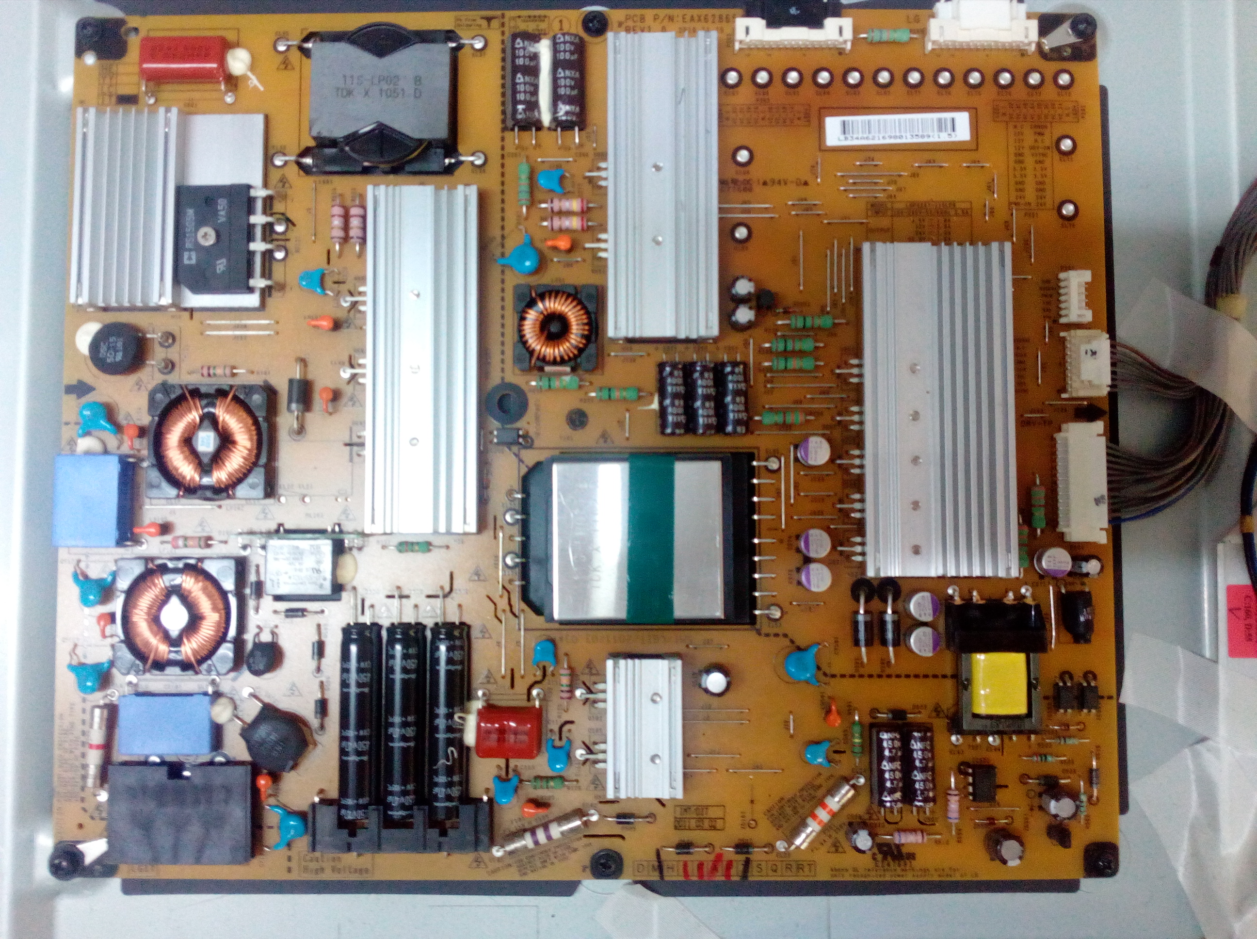

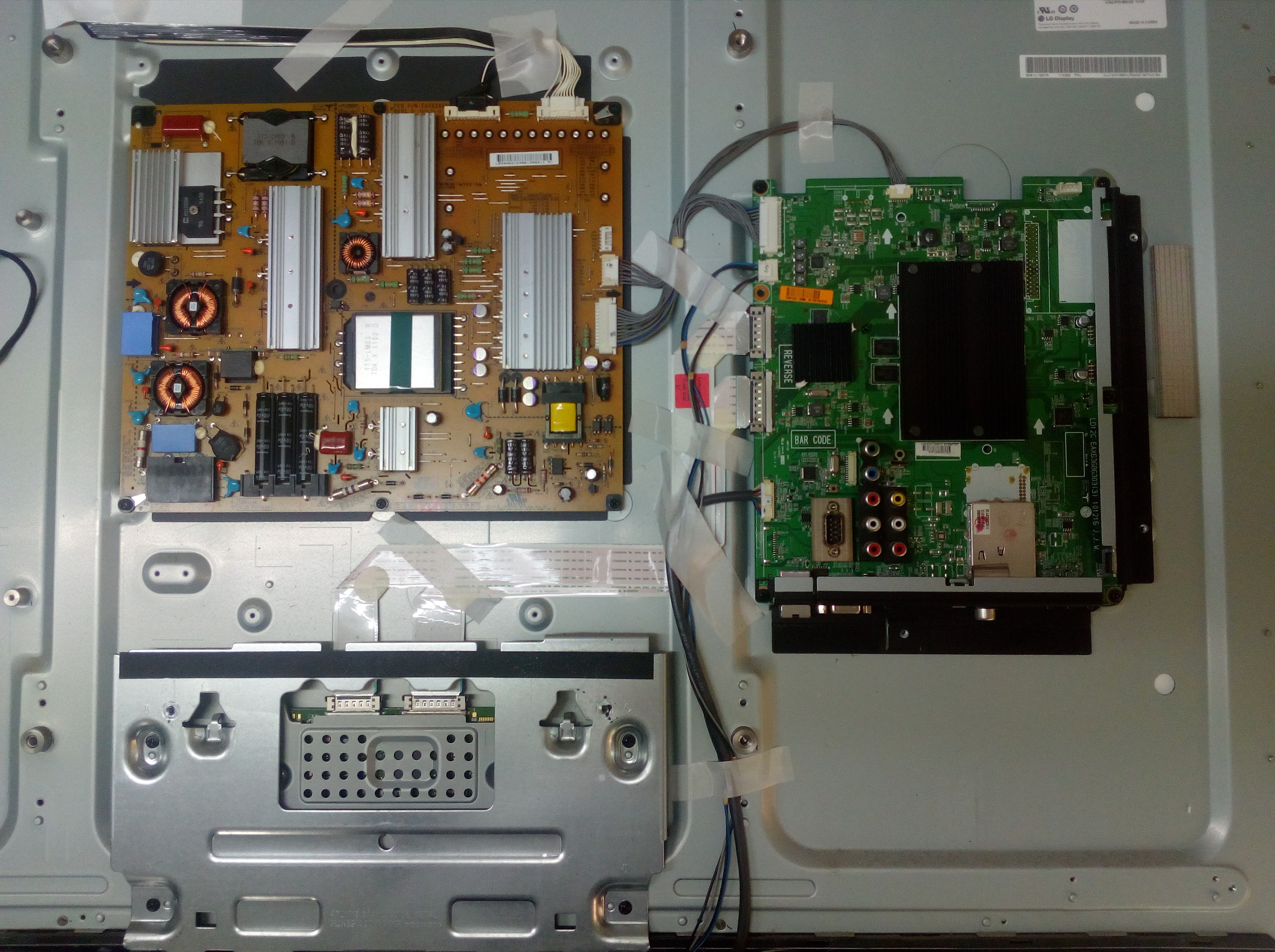

            Re: LG 47LW6500 LED intermittent
            Well I'm back in our main house and able to check this set out properly with dtv signal etc. The led problem was definitely affected by temperature in my opinion and as luck would have it I found in my board stash the same power board which only needed a main fuse replaced. This board has no darkening in the led power output area. Fitted it and set has been running OK for a couple of hours - do have led setting at a low 35 . Now for further testing but I'm hopeful it was a board ic problem rather than LEDs themselves.

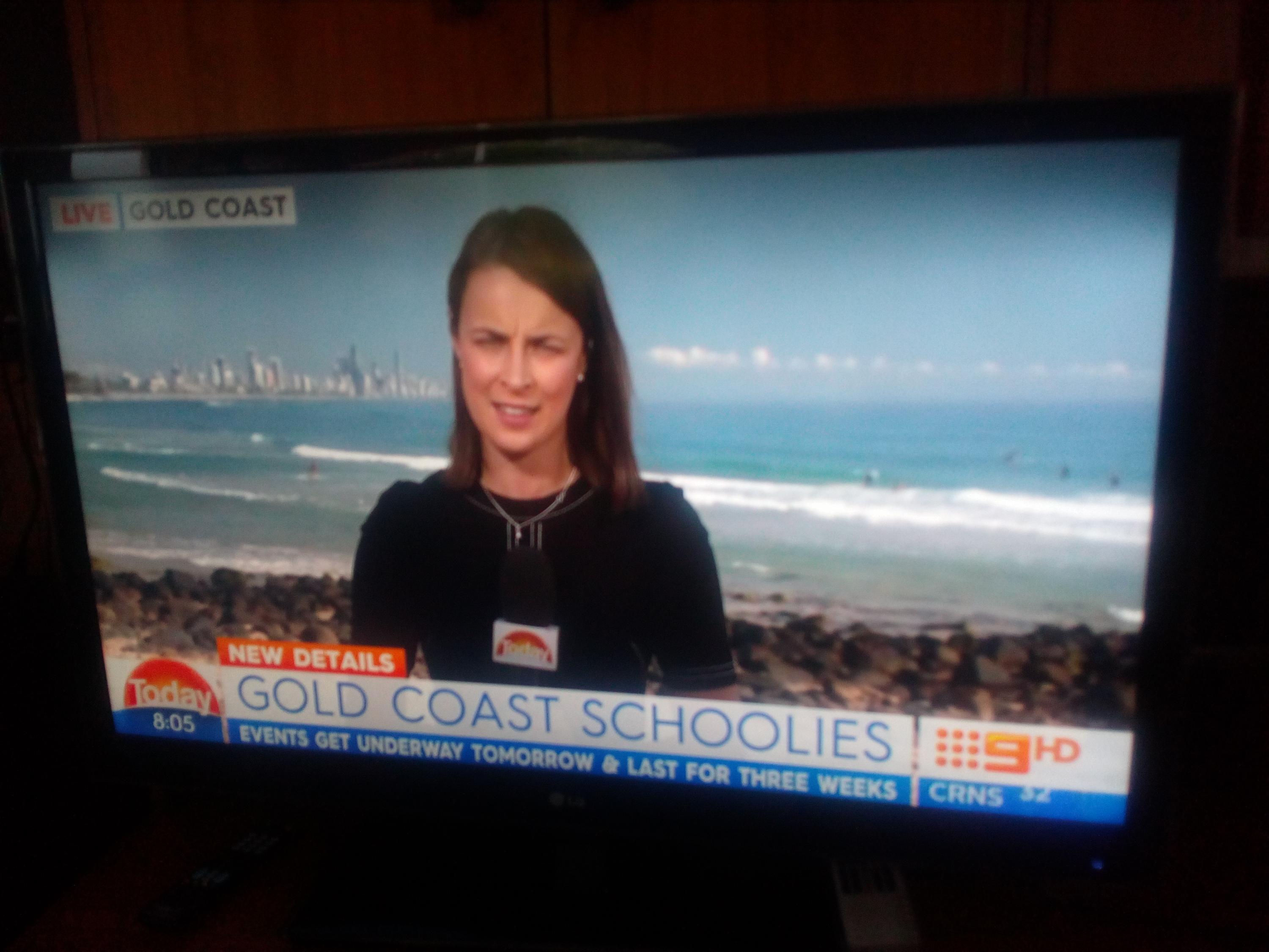

              With the set seemingly going OK I turned the backlight setting up to 50 and then noticed a few gray areas around the screen edges. These are shown in pic below. So either some LEDs low in output or not working - don't know the circuit setup for these.
                I think this is an Edge-Lit backlight set up. Since turning down the Backlight setting produces this effect I think you may have some dimly lit LEDs. Only long term solution is to crack open the Panel and replace the LED strip.

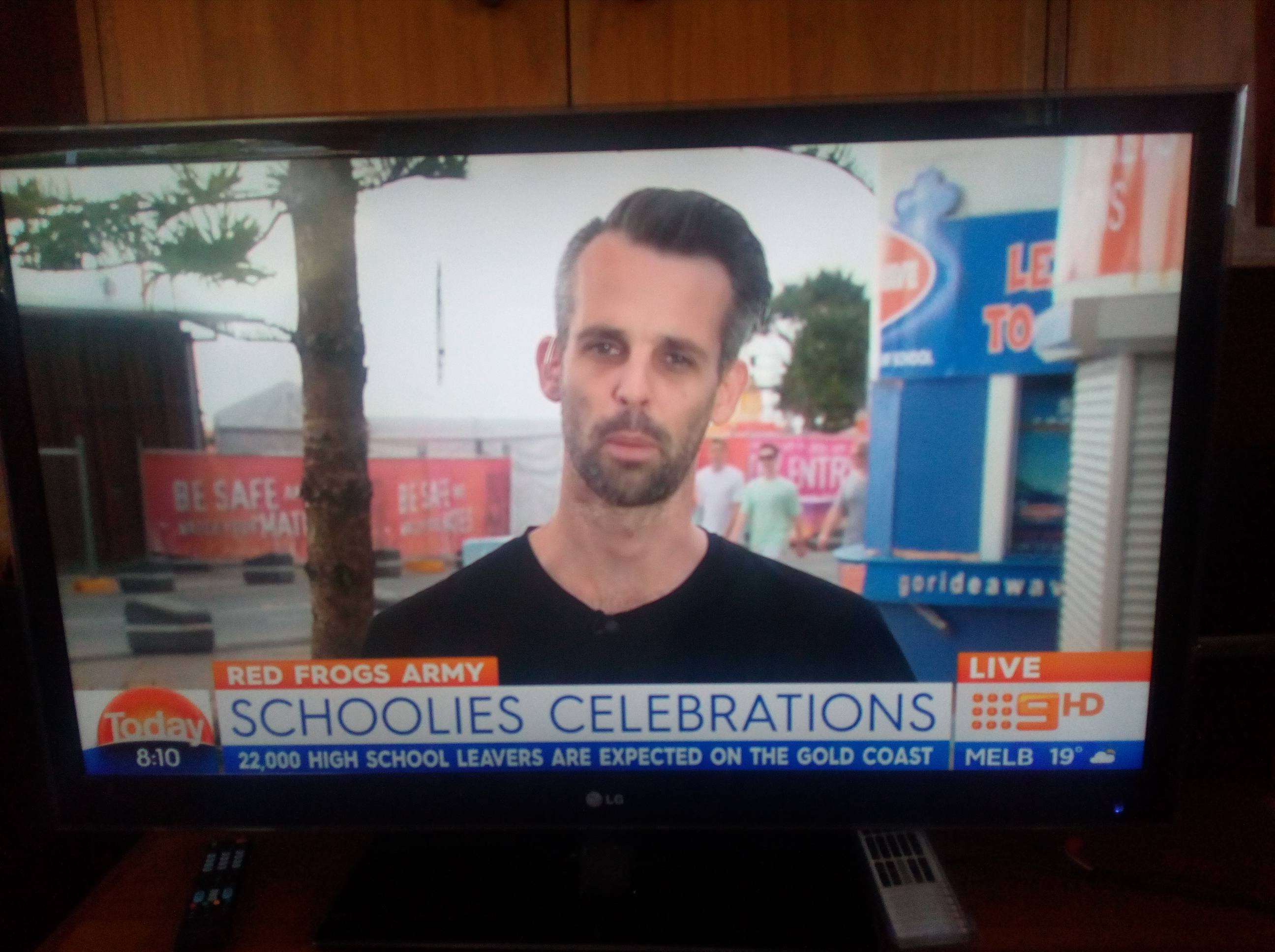

                  Thanks Andrew F. Getting too old and cantankerous to go far with this set but something a bit strange as well. Turned set on this morning and no sign of side lights problem although top edge definitely dull and moreso top right side. It occurs to me that I hadn't noticed the unevenness before but then I had only ran the set for shortish times and at low backlight settings. When I first noticed the problem the set had been going for around 4/5 hours at 50 setting. Today been going now for 1 hour at 60 setting when attached pic taken. I'm starting to wonder about mura now as well as other reasons.
                    Just adding that power board I put in although same eax number did come from a 42" set. For both boards have found with set going OK but with backlights turned up to around 60 when activating menu that causes backlights to immediately turn off ! Why ??

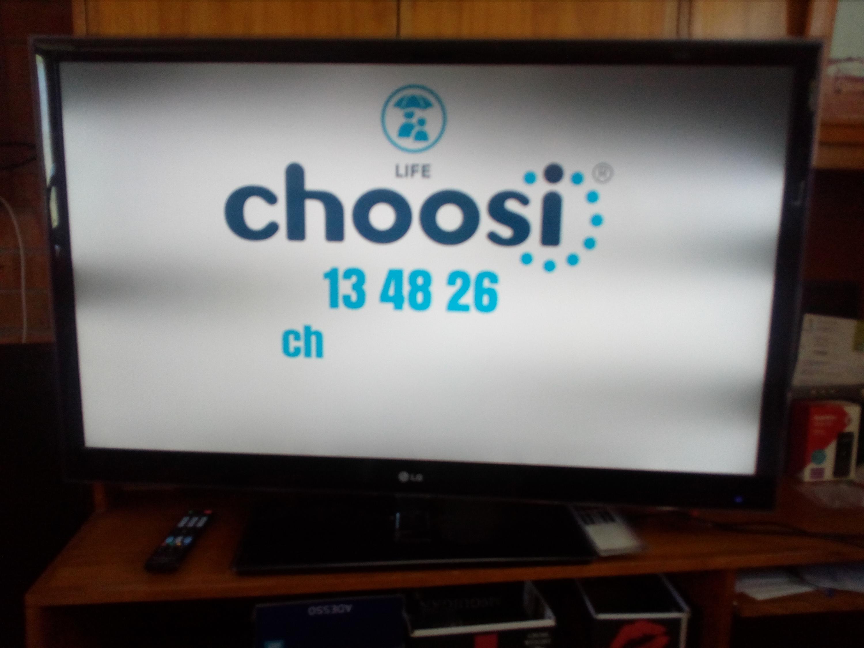

                      Very evident now that with lowish LED setting (45 in pic) the display is acceptable and unblemished at switch on, however shortly afterwards the greyish cloud shows across top of screen and slowly extends down about 4/5 inches. The darkening from the sides happens much later. To me as the edge lighting is from the sides it seems a combination of mura effect and some LEDs later dimming possibly due temperature may be at play. Monitoring holes on rear of set though I cannot see any dimming of brightness in them??. Anyone care to comment??
                        Seems like if you have same problem with either power board installed, looks like weak or faulty leds, if the voltage going to the leds is correct and steady that is.
                          No getting away from it. You have to replace the bad backlights if you really want to get this dolly going again.
