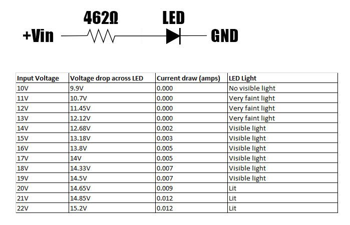

            Okay I carried out a little experiment with the one LED that is still fully intact. I measured the 500 ohm resistor and it is actually 462 ohm to be exact. I started at 10V and worked my way up to 22V.
            Any opinions would be welcome.

              tbh perhaps a CC PSU at 5mA-10mA to pass through the LED and measure the voltage across it will be the easiest way to figure out the voltage.
              strange though, looks like 14V is best, alas these things are annoying if one has to stock different voltage LEDs. Easier to stock regular ones and a bunch of resistors since likely you'll need resistors for other things anyway.

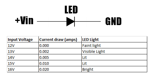

                  Okay I thought there must be something else other than just an LED going on, so I hooked up directly to the voltage this time.
                  I'm gonna just buy a few different 14V through hole LEDs with built in resistor, see which performs closest to this and use it. I will just use the one colour and put labels beside each LED.
