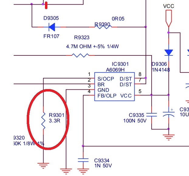

    I know this can seem to be a stupid question, but how do I find a replacement for this resistor of a TV power supply?
    If I check the band resistor colour code, It's 1 ohm, but on the schematic its marked as 3.3R
    Anyone can clarify ?
    Thanks!

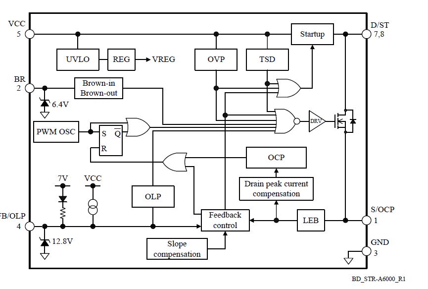

      the sanken pdf for the IC sez for that resistor to be 1.5 Ohm 1/2Watt in their test circuit.

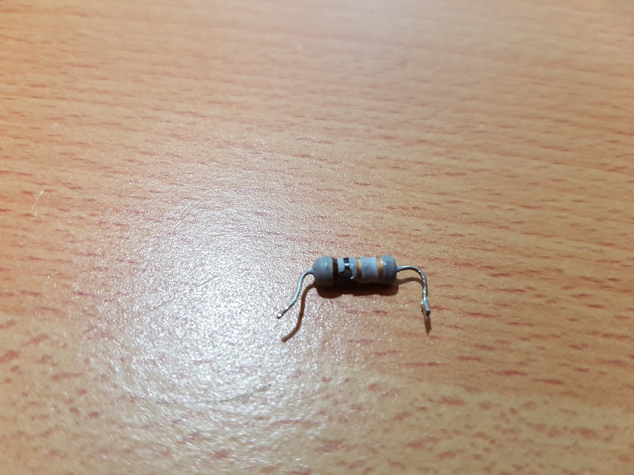

        Well, I know that the resistor coloured bands should mean 1 ohm resistor...
        Not sure about the wattage...

          If I check the coloured bands I get 1 Ohm resistance as value
          Feel kinda tempted to get an 1 Ohm resistor 1/2 watt ...

              That Source resistor for the Internal MOSFET of the SMPS IC will go open circuit if the MOSFET shorted out. Is that resistor tested open circuit?

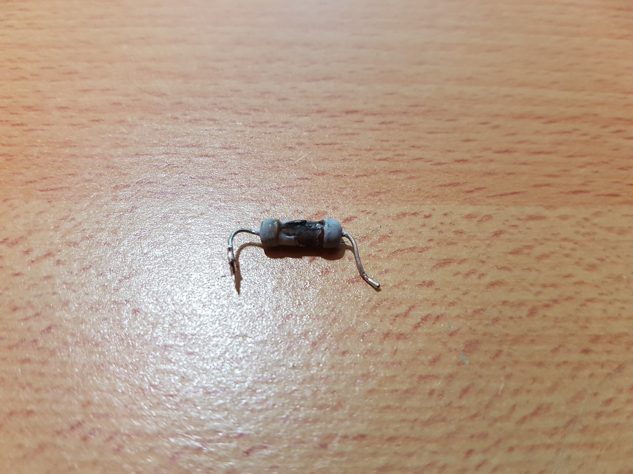

                The resistor is shorted and clearly burned underneath it.

                  The resistor would be open and not shorted. The reading would be infinity or increased.
                    Re: Find replacement resistor
                    I agree with Andrew, The resistor is ok, and the board is likely discolored do to heat from the resistor. hard to tell without a picture.

                      Finally had time to take a look again at the resistor.
                      You guys are totally right, the resistance is OPEN not shorted
                      Some pics attached.
                      Should I definitely go with a 1 Ohm 1/2W?
                      Ty all!

                        As Budm says in Post #7 there's every possibility that the IC is damaged and replacing the resistor without checking out the IC may just result in it burning out again. Check the mosfet with the meter in diode mode between Source/Drain (Pins 1 and 8) reversing your leads for the second measurement. Set OFF.
                          I would replace that IC.

                              Why do they put 3.3R in the schematic for this resistor? any idea?
                                Could be an update on the board design. 3.3ohm maybe an original design flaw that was never updated.

                                  It looks like a 1.5 ohm resistor to me. The second band looks green, not black. However, it could be how colors show up here - you decide which it is.
                                    Looks like 1 Ohm.
                                    You can use MOX (Flame proof Metal Oxide) non inductive.
                                    Measure the dimension to get rough idea what the wattage is.
