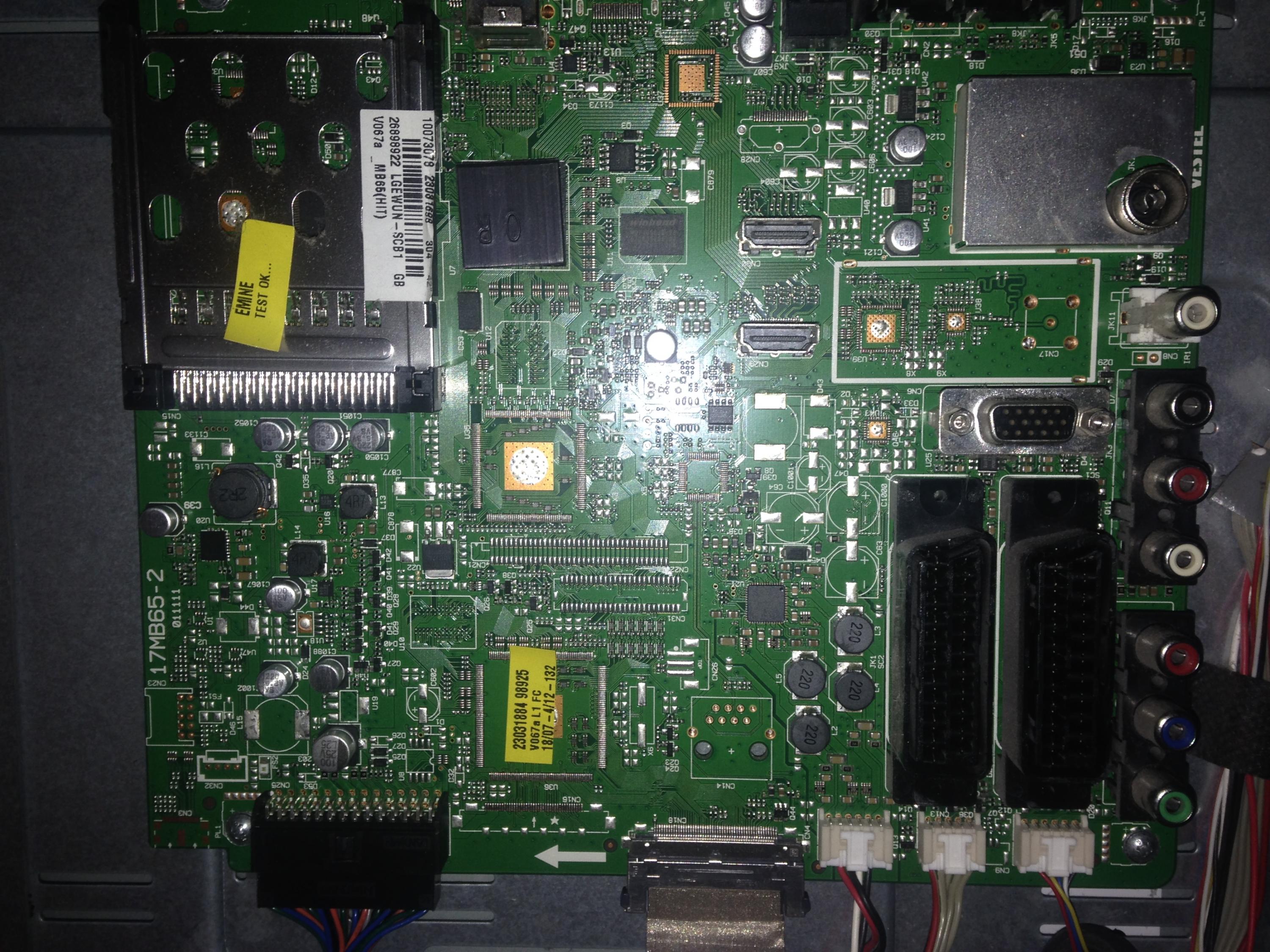

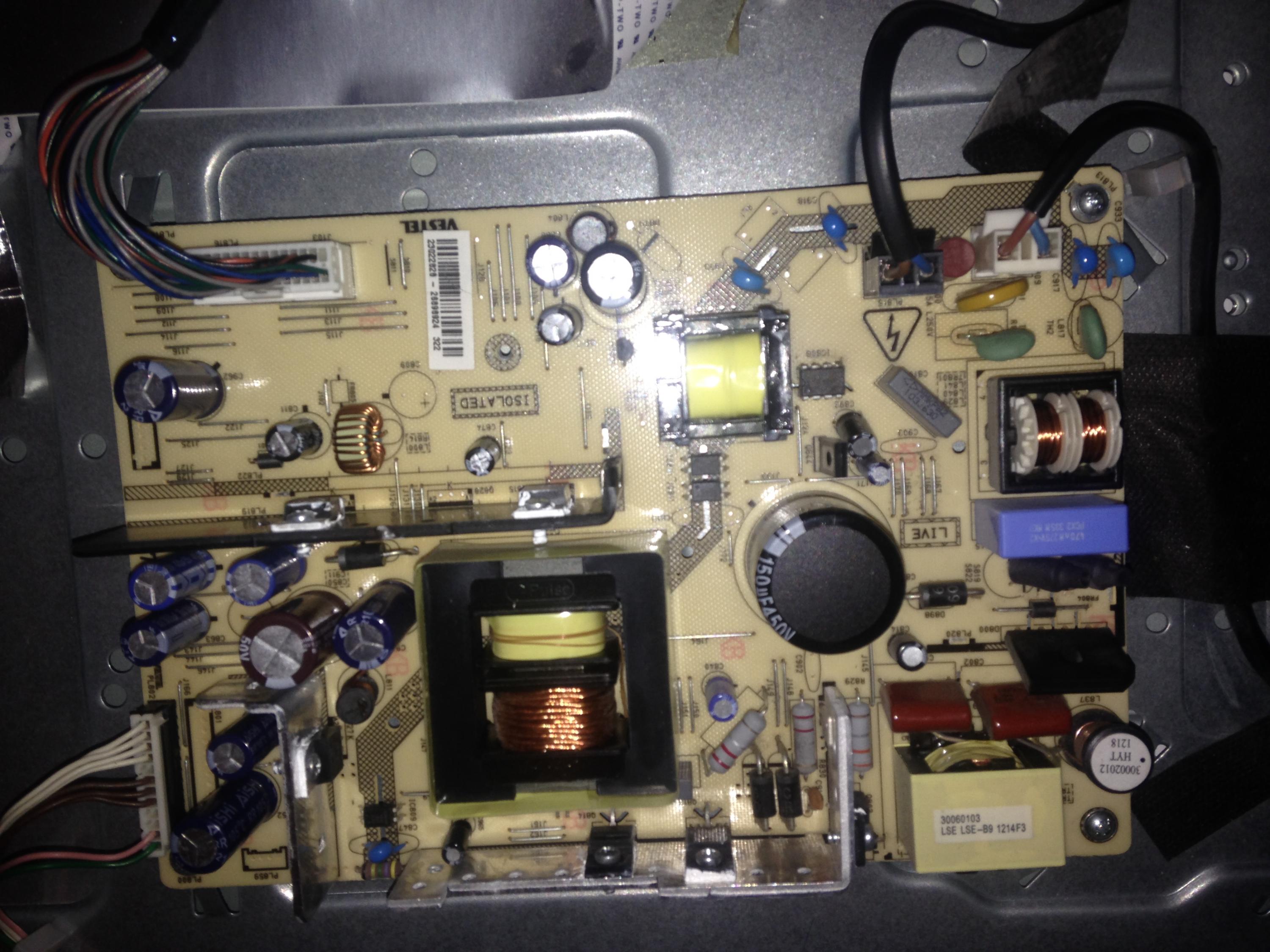

    The power supply is a vestel 17PW26-5 v.3.
    The main board is a 17MB65-2.
    I have replaced the inveter board and it does the same. Ive disconnected the inverter board but still the same.
    On the power supply the white connecter top right hand corner I get the following voltages
    Starting at the top with column on the left hand side
    readings are
    standby voltages /on voltages
    0 / 0
    7.86 / 8.97
    2.57 /0
    0.36
    0 /3.57
    11.86
    5.03
    3.39
    0 /3.39
    0 /3.39
    0 /3.39
    0
    0.23
    0.23
    Power supply top right column nearest to main board
    standyby voltage / on voltage
    0
    0
    0
    0
    0.11
    11.85
    3.39
    0 /5.15
    0.24
    0.24
    0.1
    0.28
    0 /3.15
    I have checked some of the caps on a meter and they are fine theres no leaks
    Any pointers would be really appreciated -

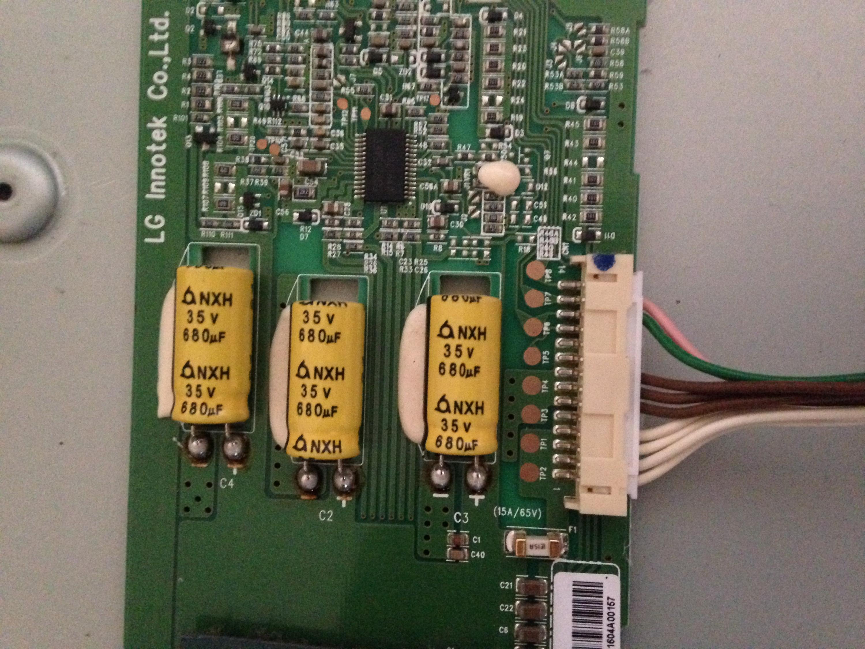

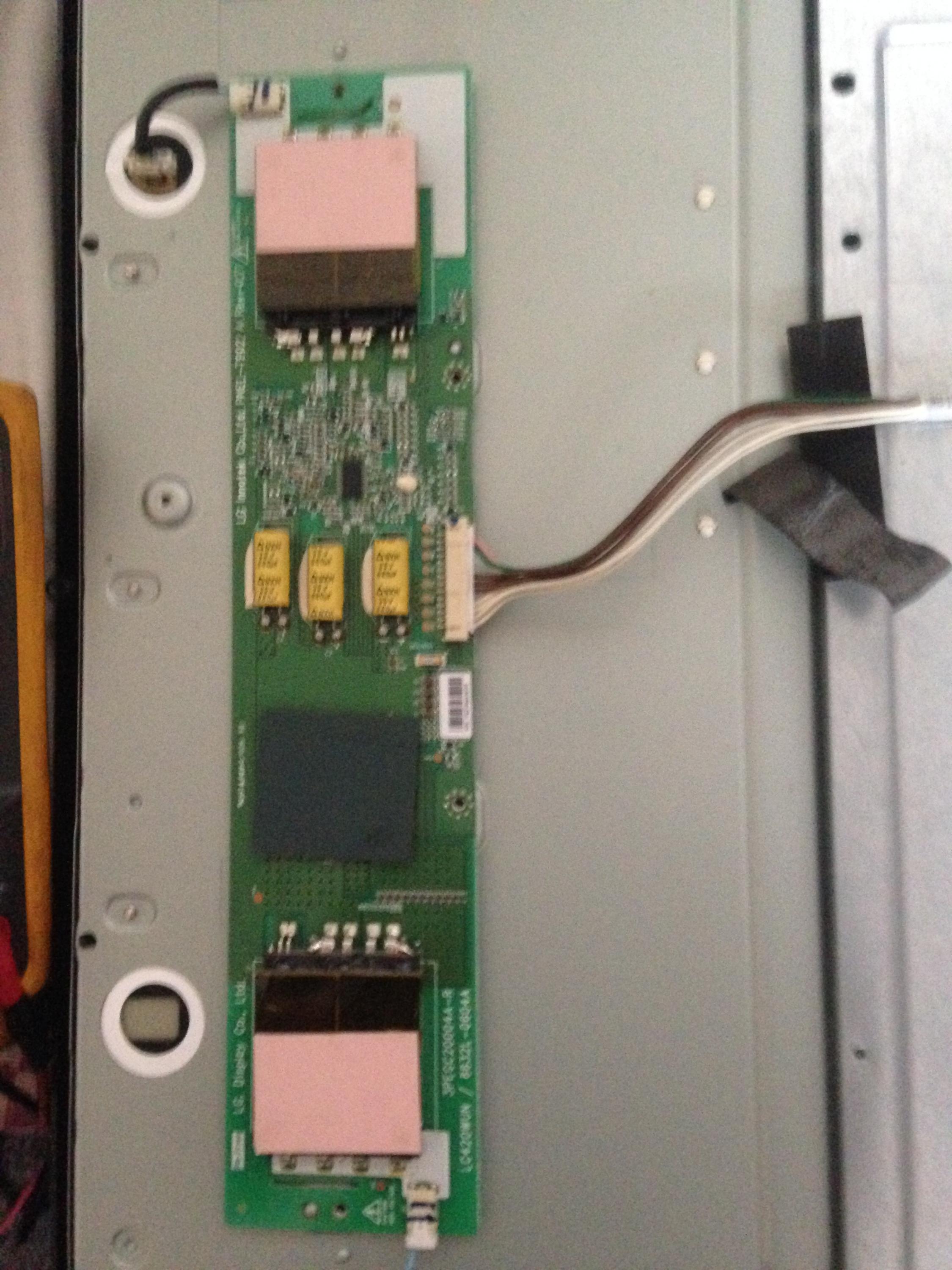

              Can we see the pcitures of the Inverter board without the metal shield?
              What Voltages do you get on the connector of Inverter board that goes to the power supply board? Pin names for those pins?

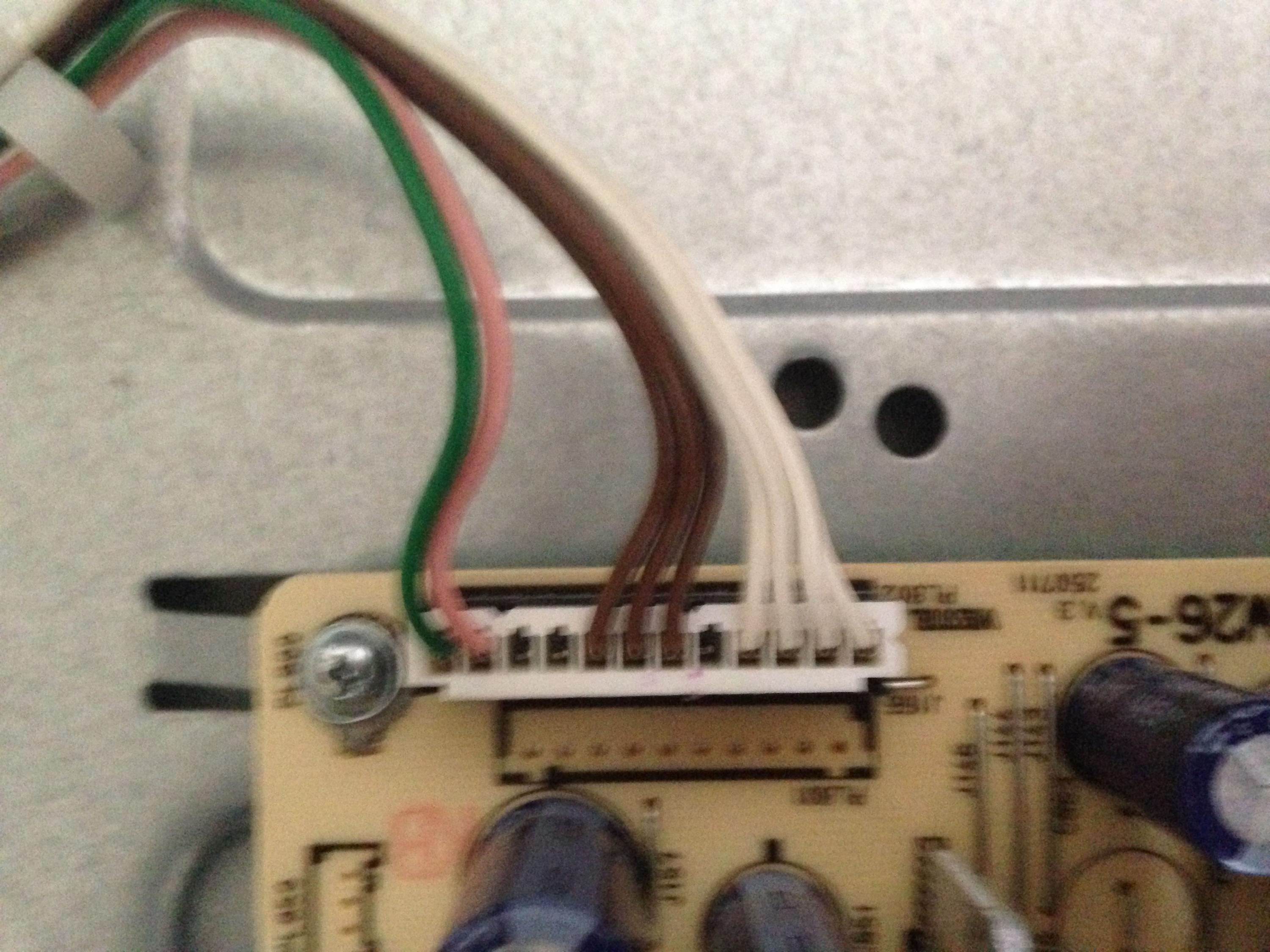

                As req With ref to the new attached photo of the connection wires that go from the psu to the inverter board.
                Ive started with the green wire as number 1. (standby/ on voltage)
                1 green wire on psu (standby /on voltages)- 0.6v/0
                2 Pink wire 0/3.38
                5 Brown wire 0/0
                6 Brown wire 0/0
                7 Brown wire 0/0
                9 white wire 0.2/24
                10 white wire 0.2/24
                11 white wire 0.2/24
                12 white wire 0.2/24
                Ive have tried two inverter boards- still the same results

                  Try disconnecting one of the lamps from the inverter and see if the backlight still comes on for 2 sec. Then reconnect that lamp and disconnect the other lamp and try again. There may be a faulty ccfl

                      check these transformers first, before you take stuff apart.
                        Re: Hitachi lcd tv L42VK04U not staying on
                        #1 green wire on psu (standby /on voltages)- 0.6v/0
                        #2 Pink wire 0/3.38
                        One of those two wire should be for BL-ON, another one will be for Dim control.'
                        The Voltage on #1 looks to be too low, you should keep the meter on that pin ten turn the TV on to see if it jumps up over 0.6V and then drops own to 0V or not, then try disconnecting just that wire #1 from the inverter board and see what Voltage you will get on that pin of the inverter board when you turn on the TV.

                          My mistake the green wire has on standby 0.6v but today switched the TV on backlights came on for two seconds and the voltage went to 3.36v and then dropped
                          Cut the green wire same result as above just no backlights flash forgot to mention transformers seem fine

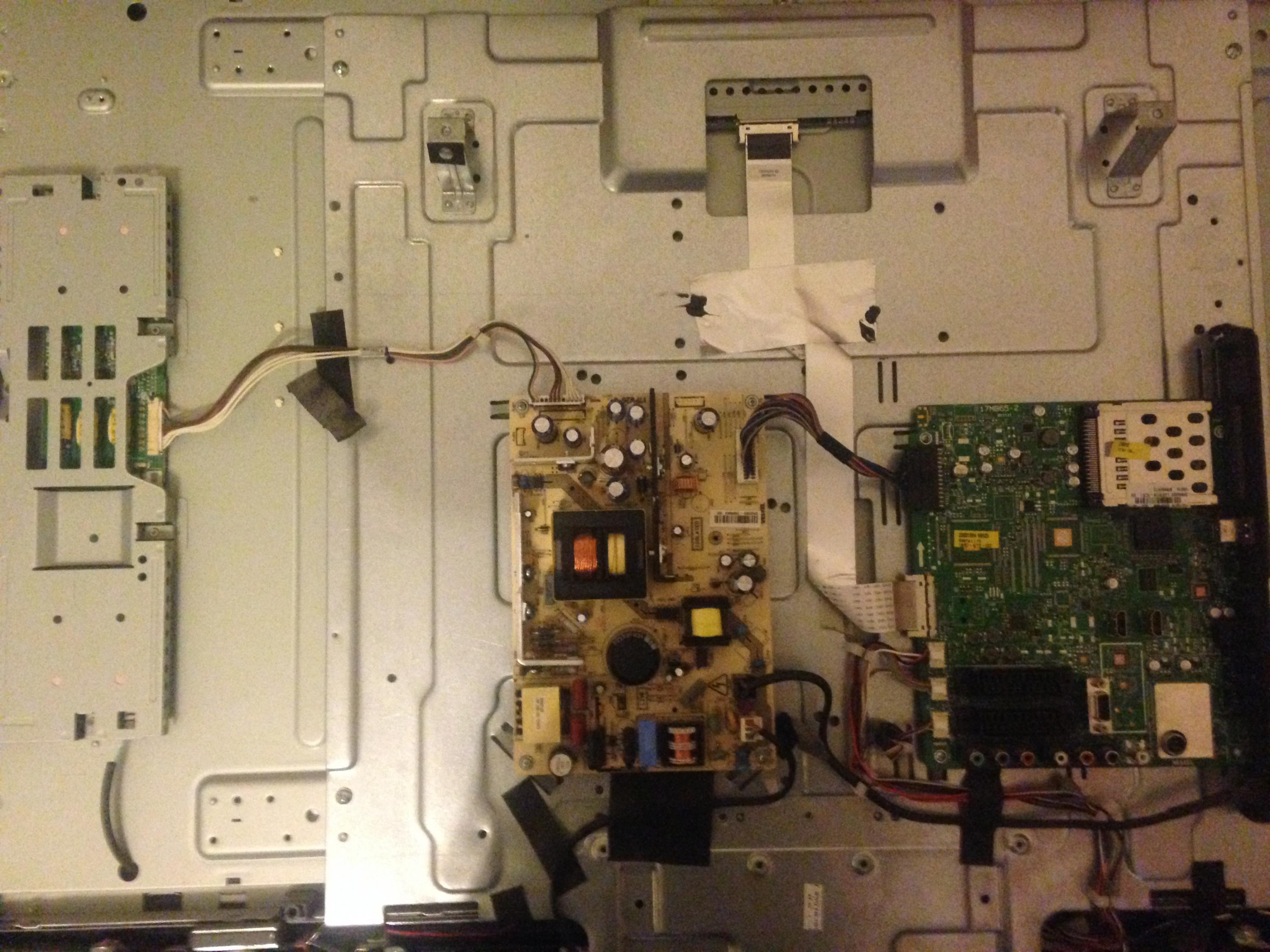

                            It's definitely the psu I repaired a 17pw26-5 (one main white plug)out of a toshiba that was lying about and the tv fires up fine- but not with the 17pw26-5(black and white plug)
                              The control signals for the inverter are generated by the main board, they are just routed through the power supply board for neat wiring.

                                Just sourced another psu worked straight - couldn't work out what was wrong with original psu
