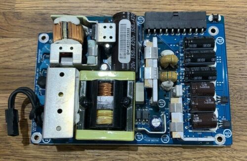

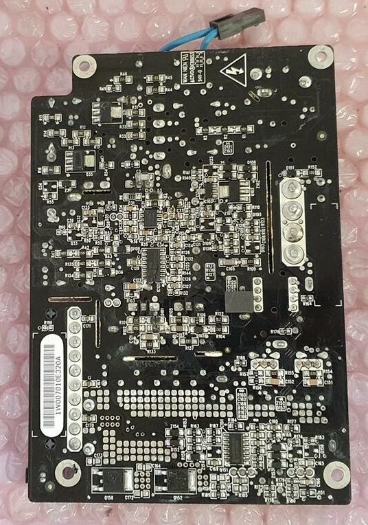

    I'll include more photos as I take them. These are of an identical unit.

          The two chips on the pcb side are a 16-pin L6599 HV resonant controller, and an 8-pin 1PCS02G, PFC controller (.pdf's attached)
          On the top-side, coming off of the 380vdc positive of the bridge rectifier, there are two 24k 1W(?) resistors in series, followed by a bulbous diode, an NTC and a TO-220 diode before arriving at the 'Drain' pin of a FET, whose 'Gate' pin is connected to pin-8 of the PFC controller and whose 'Source' connects directly to the primary windings of the transformer.
          What is confusing me, is that this 'Source' pin is also directly connecting to the negative terminal of the bridge rectifier. So if the FET gets triggered it would create a direct 380vdc short across the bridge rectifier, no?

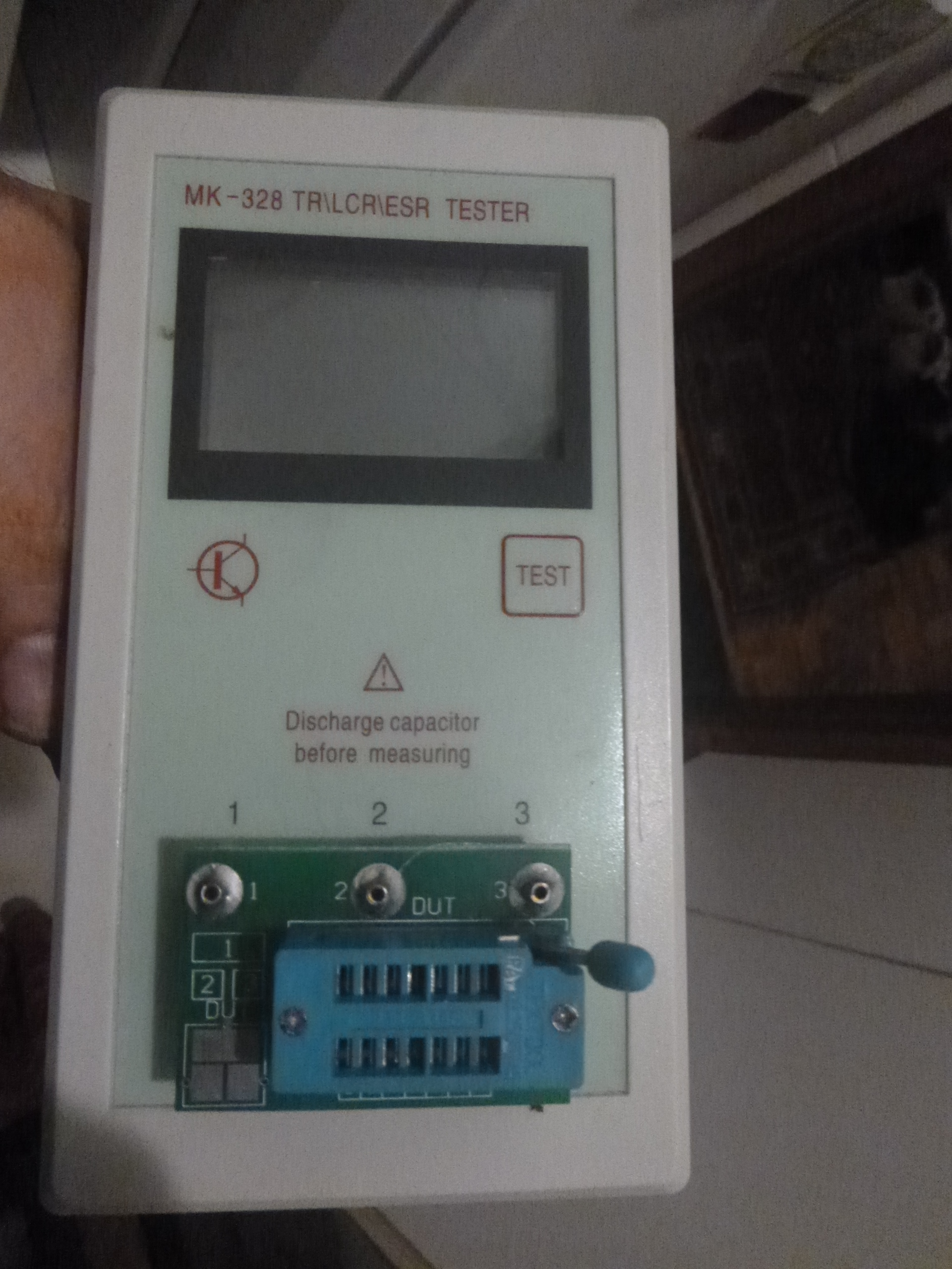

                • Crystaleyes
                  • Sep 2021
                  • 493
                  • Brazil
                  Re: iMac A1224 PSU, 614-0421 - no standby voltages
                  Maybe I should?
                  It wasn't something that I was aware of...
                  I have a second one which is intermittent which would be great to resurrect

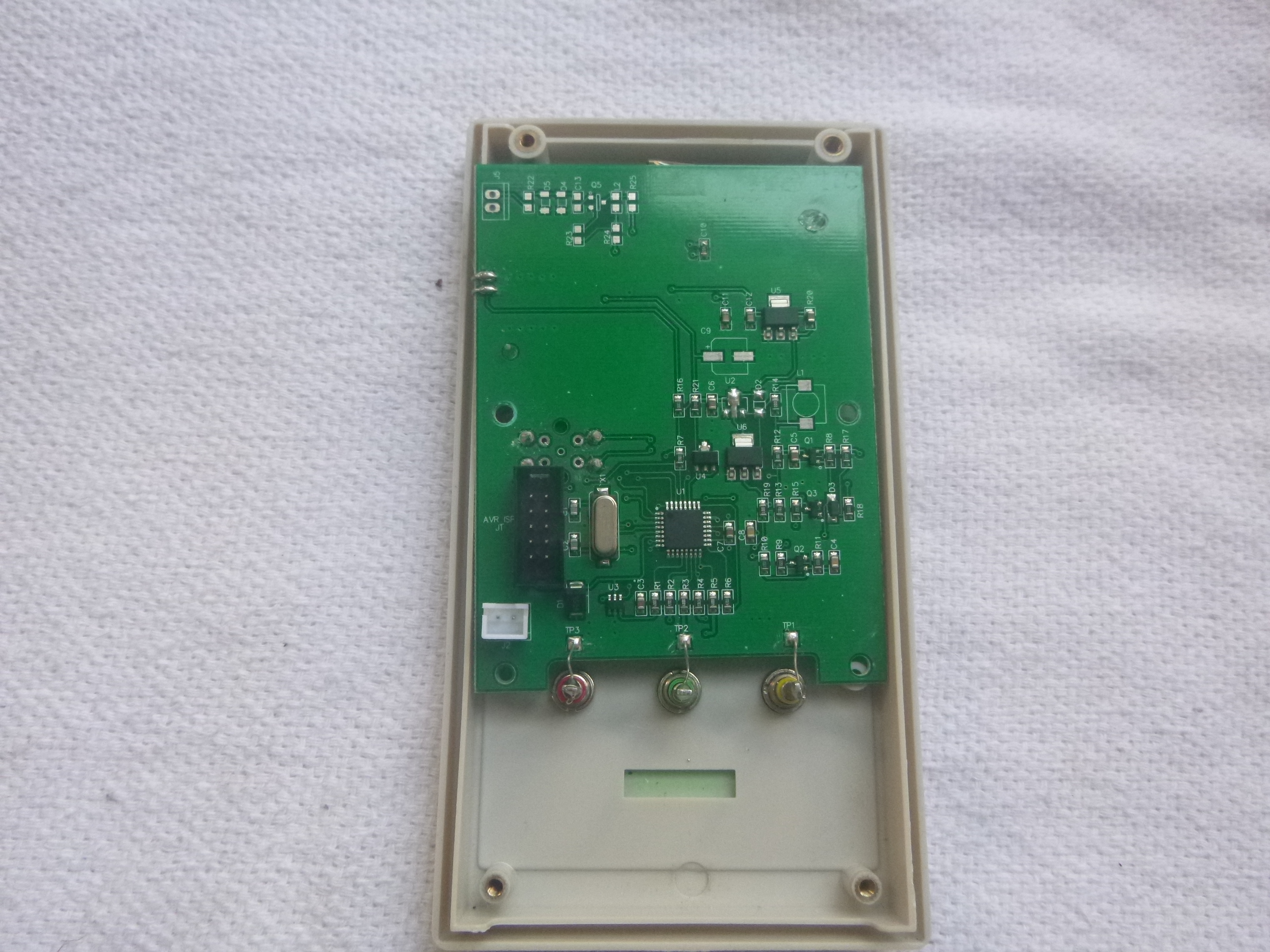

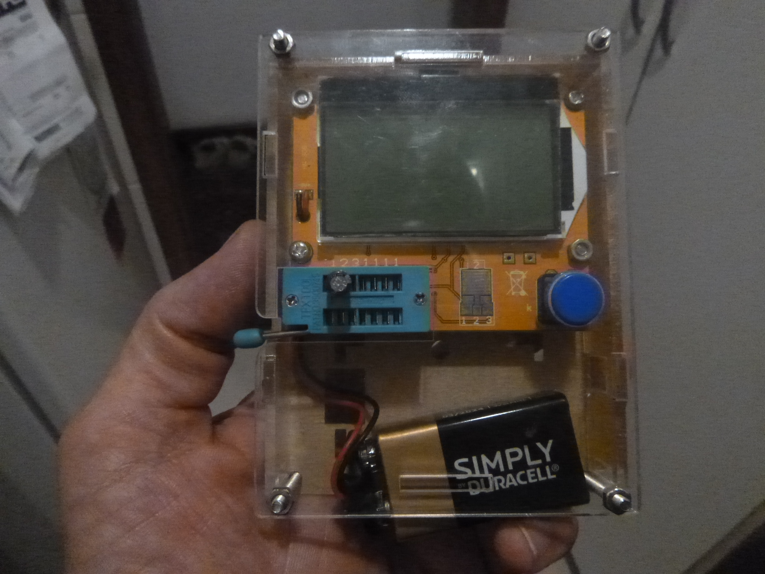

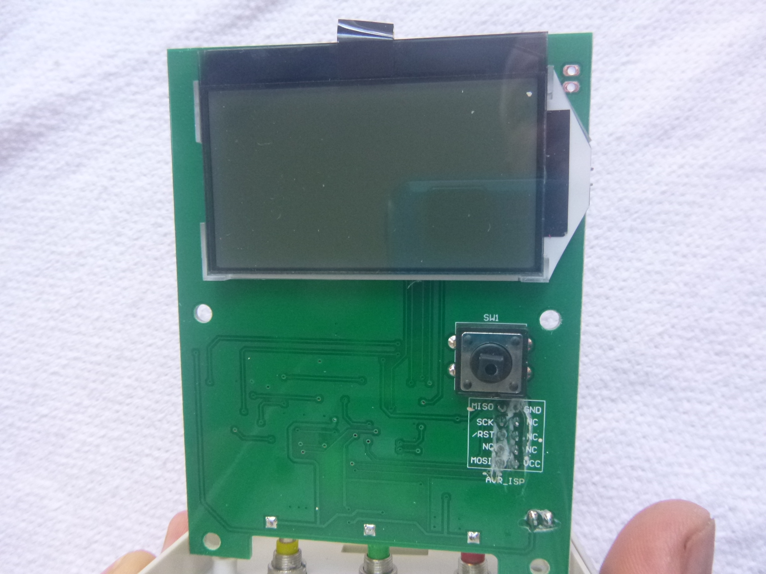

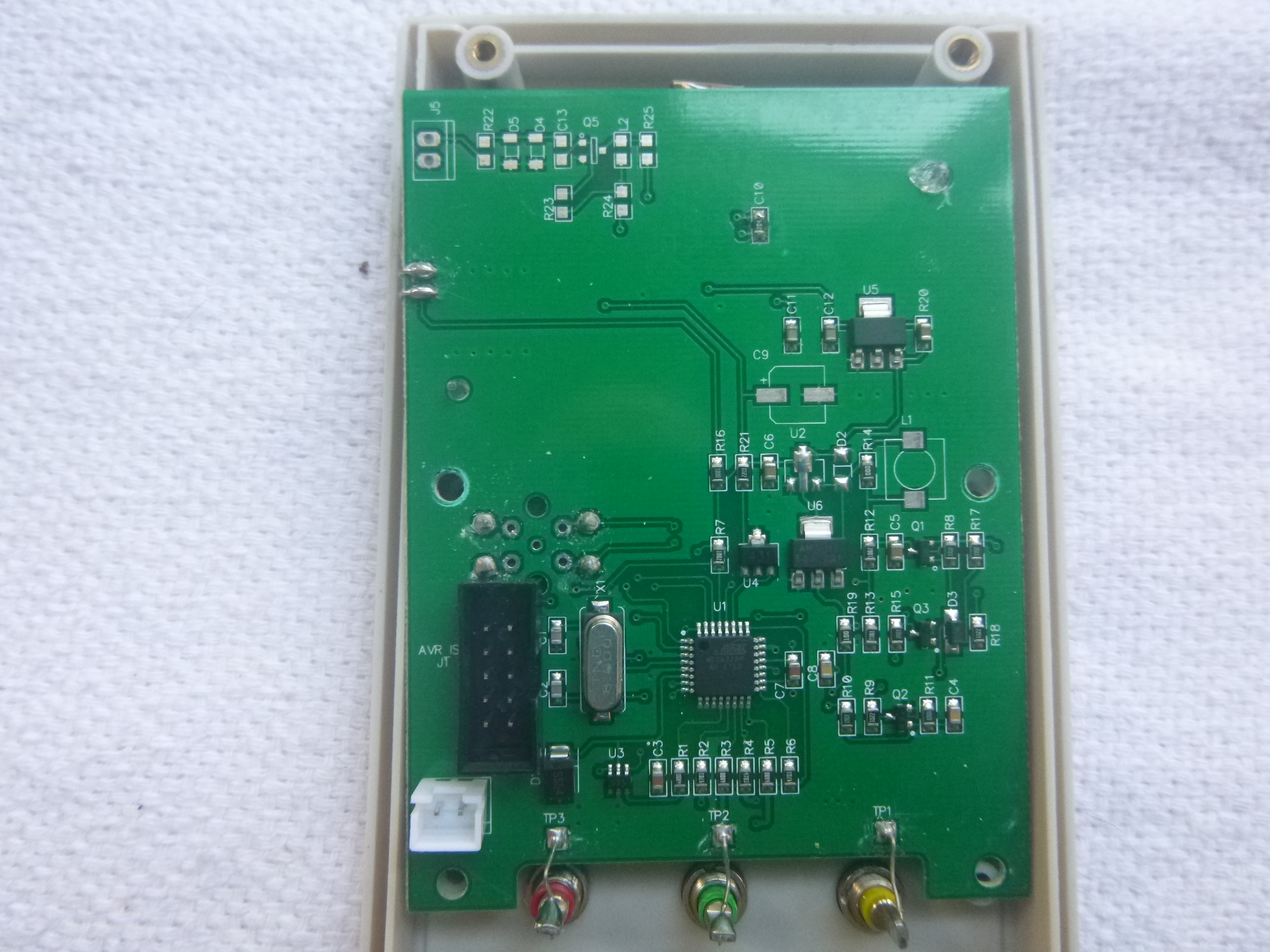

                    • 31262
                    post pictures of them - so i know the hardware they are based on.
                    • Crystaleyes
                      • Sep 2021
                      • 493
                      • Brazil
                      Two images attached.
                      Pulled the 22uF cap and it reads
                      ESR = 0.55Ω
                      V Loss = 1.2%
                      Captnce = 21.20uF
                      Had hoped it would be clearly damaged.
                        • 31262
                        test the big mains caps - as it has pfc
                        the yellow tester in the acrylic is a T4
                        not sure about the other one - never seen that before.
                        wanna take internal pcb pics?
                        • Crystaleyes
                          • Sep 2021
                          • 493
                          • Brazil
                          The larger tester has 'MK' 328 on the case, although it displays 'GM' 328 when switched on.
                          Just noticed all that goop below the on/off button, which may be why it has been problematic..?
                          I'll have to test the cap later.
                          So do you not think reading short across the transformer secondary terminals is a problem?
