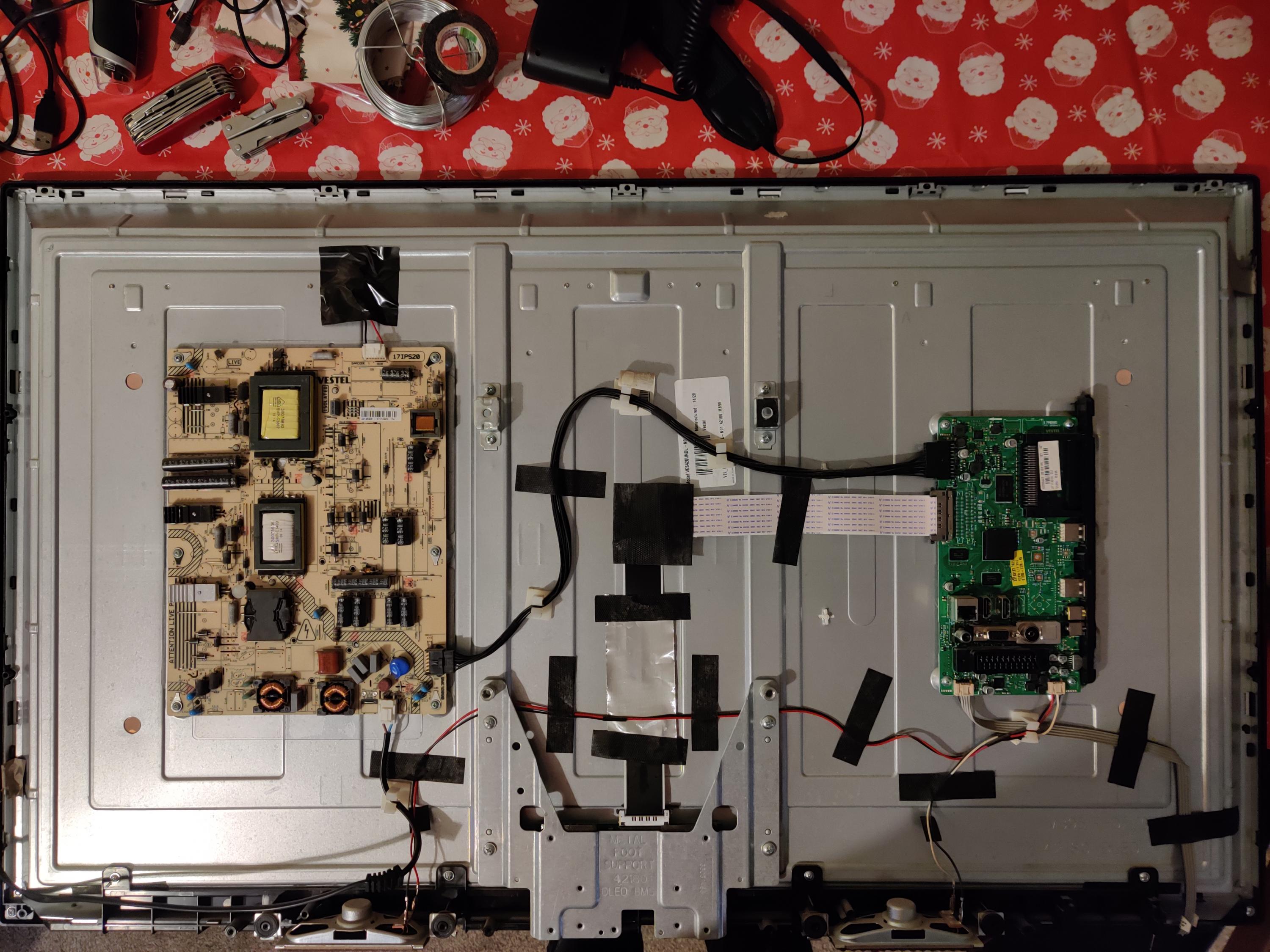

    I've recently come into possession (a freebie!) of a Hitachi 42HXT12U LED TV which does not work.
    It does the following:
    - Plug in
    - Standby LED flashes alternating RED and BLUE approx 6-7 times
    - Does this approx twice
    - Standby LED stays solid BLUE

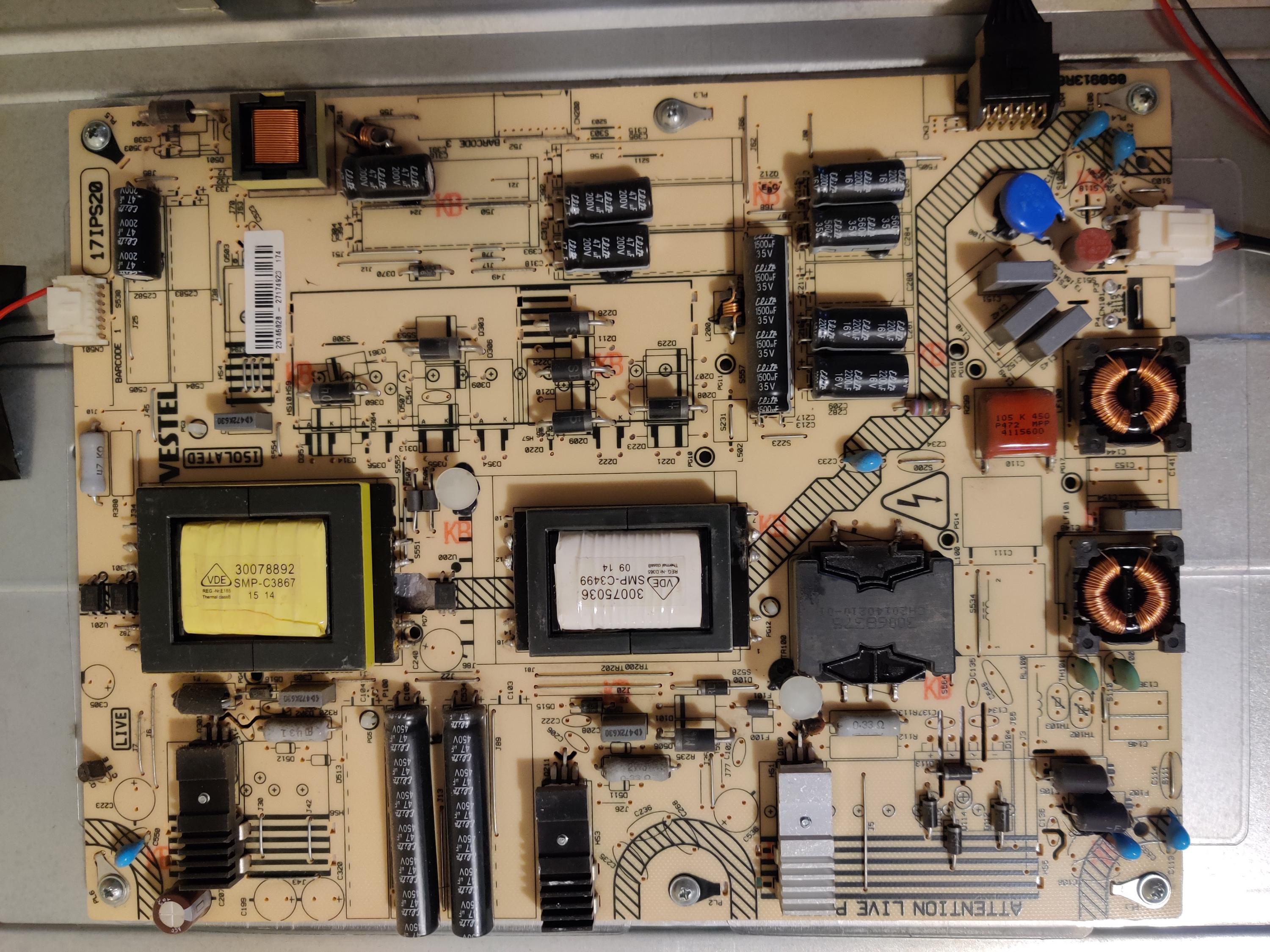

    I've opened it up and had a look at the PSU board (which is a 17IPS20 23145828) for any bulging caps and there aren't any.
    Any ideas folks? If you suggest replacing the PSU board then I'll go ahead and do it - only about 30 quid off ebay.

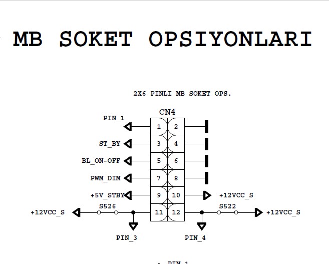

      Re: Hitachi 42HXT12U - Not working - Standby LED Flashes
      Take some voltage readings from CN4 and report back.

        It's pretty wacky to be honest. I unplugged the cable so I could get readings and I got this:
        1 - PIN_1 - 0v
        2 - GND - ok
        3 - ST_BY - 0v
        4 - GND - ok
        5 - BL_ON-OFF - 0v
        6 - GND - ok
        7 - PWM_DIM - 0v
        8 - GND - ok
        9 - +5V_STBY - 0.1v
        10 - +12VCC_S - varies between 7v and 11v, not stable at all
        11 - +12VCC_S - same as above
        12 - +12VCC_S - same as above
        Hope that helps, thanks for your input.

          Sorry for the double post but I figured a way to measure whilst the unit is plugged in.
          Here's the readings:
          1 - PIN_1 - 0v off, 24.29v when powering up
          2 - GND - ok
          3 - ST_BY - floating, ~2v when powering up
          4 - GND - ok
          5 - BL_ON-OFF - 0v
          6 - GND - ok
          7 - PWM_DIM - 0v of, 3.3v when powering up
          8 - GND - ok
          9 - +5V_STBY - 5.3v
          10 - +12VCC_S - can't reach whilst plugged in
          11 - +12VCC_S - 12v bang on
          12 - +12VCC_S - can't reach whilst plugged in
          EDIT: Tested what I think is the LED inverter power (no idea, the black/red 2 wire connector at top of board) and it just floats between -1v/+1v.
          Double EDIT: Tested between red wire + chassis as ground and I get a bunch of different readings. Sometimes 180-190, sometimes just falling from 120, can't seem to get it stable
            It looks like you have no BL-ON-OFF (Backlight On) control signal being fed to the power supply from the mainboard.
            What dc voltage do you have across C105 (ie between the two legs of that capacitor.)
            What voltage do you have on each wire of CN501 as you power up.

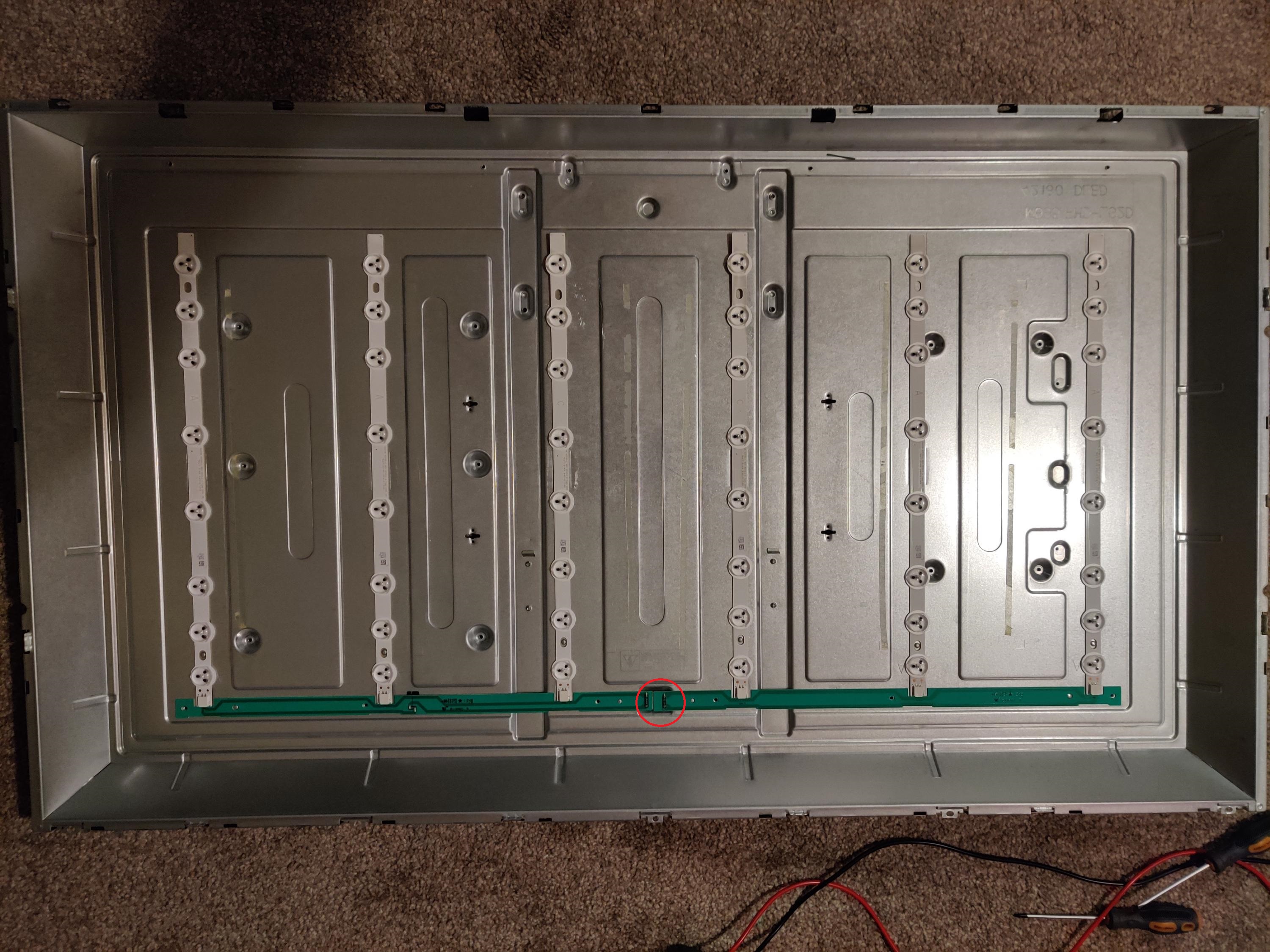

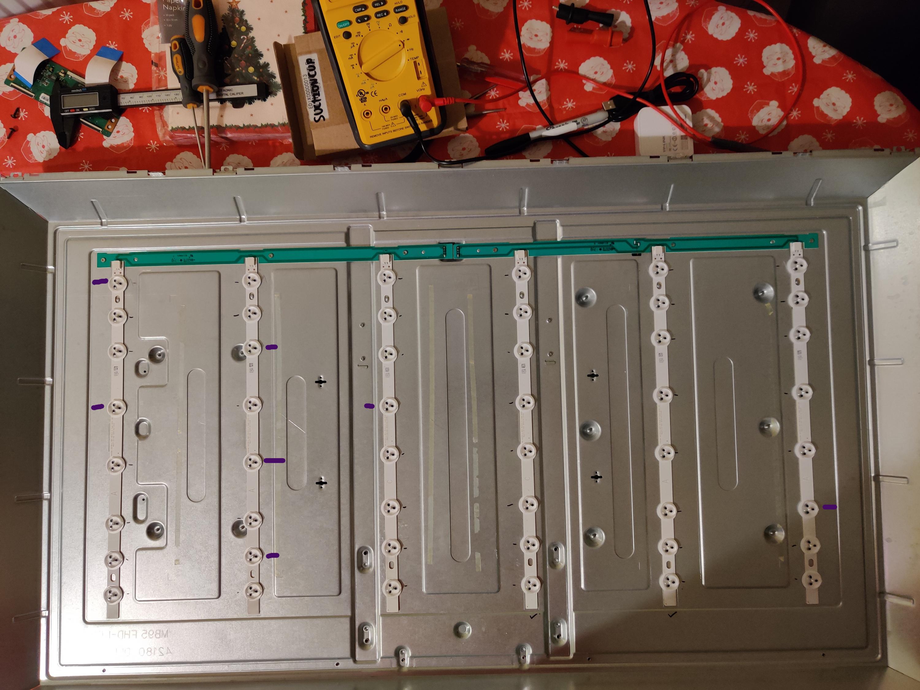

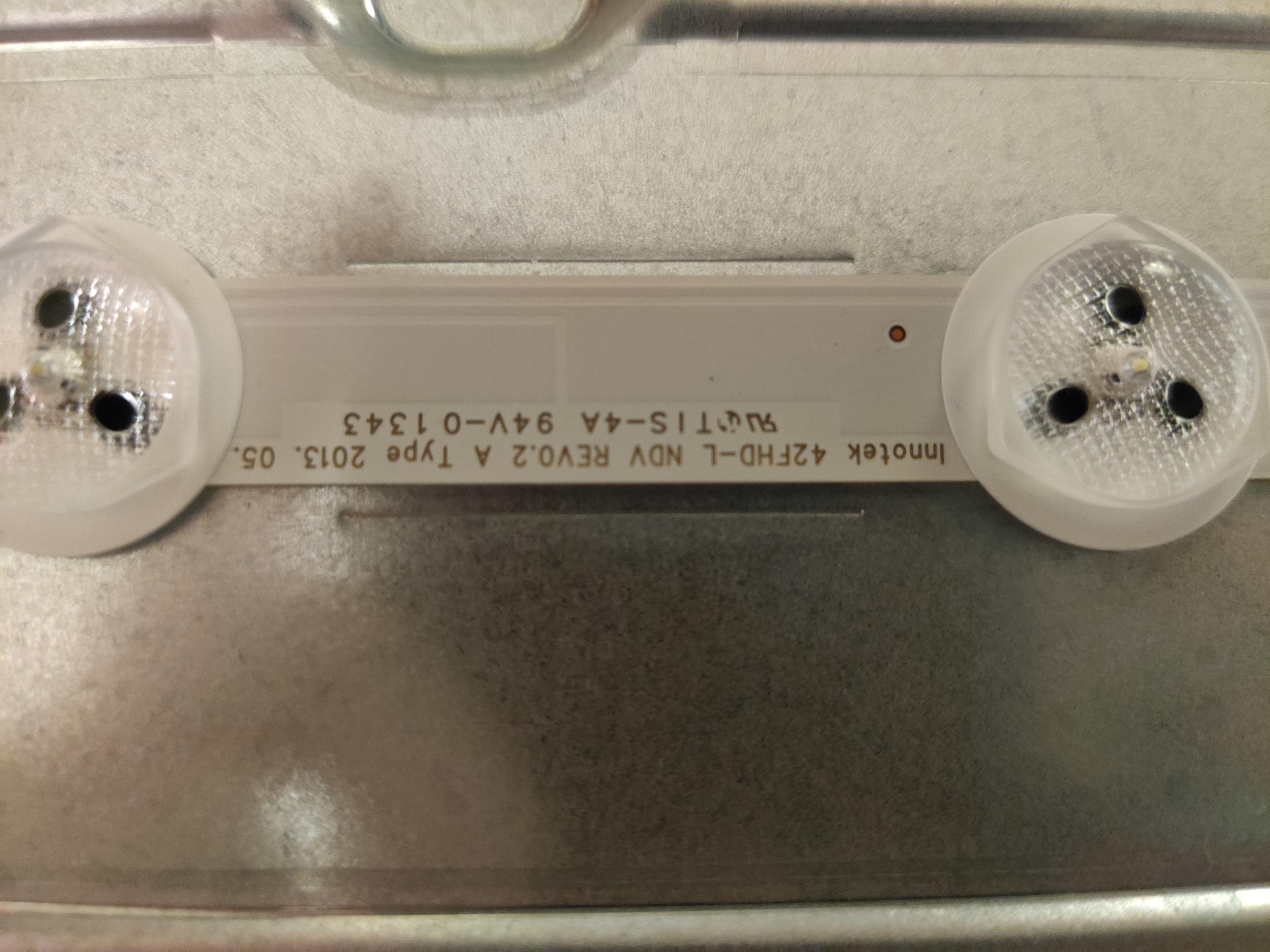

                          Righto, managed to get the whole thing apart to check the LED strips.
                          Continuity between strips is fine, but putting the multimeter on diode mode and probing the little + and - test points doesn't make any of them light up at all.
                          EDIT: TIL, you can scratch the solder mask off and test each LED individually, just gotta figure out what goes where!!

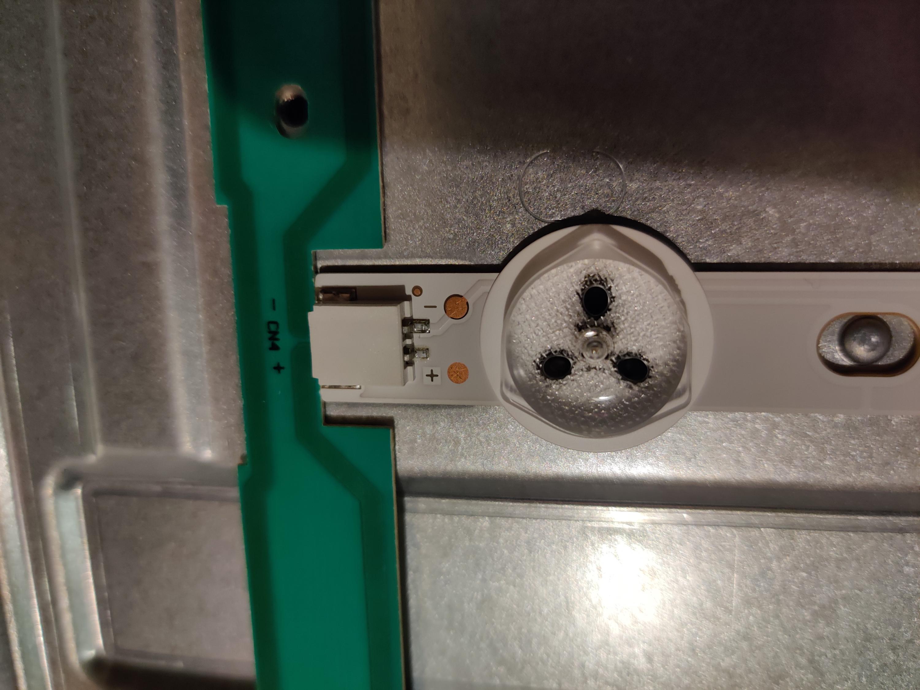

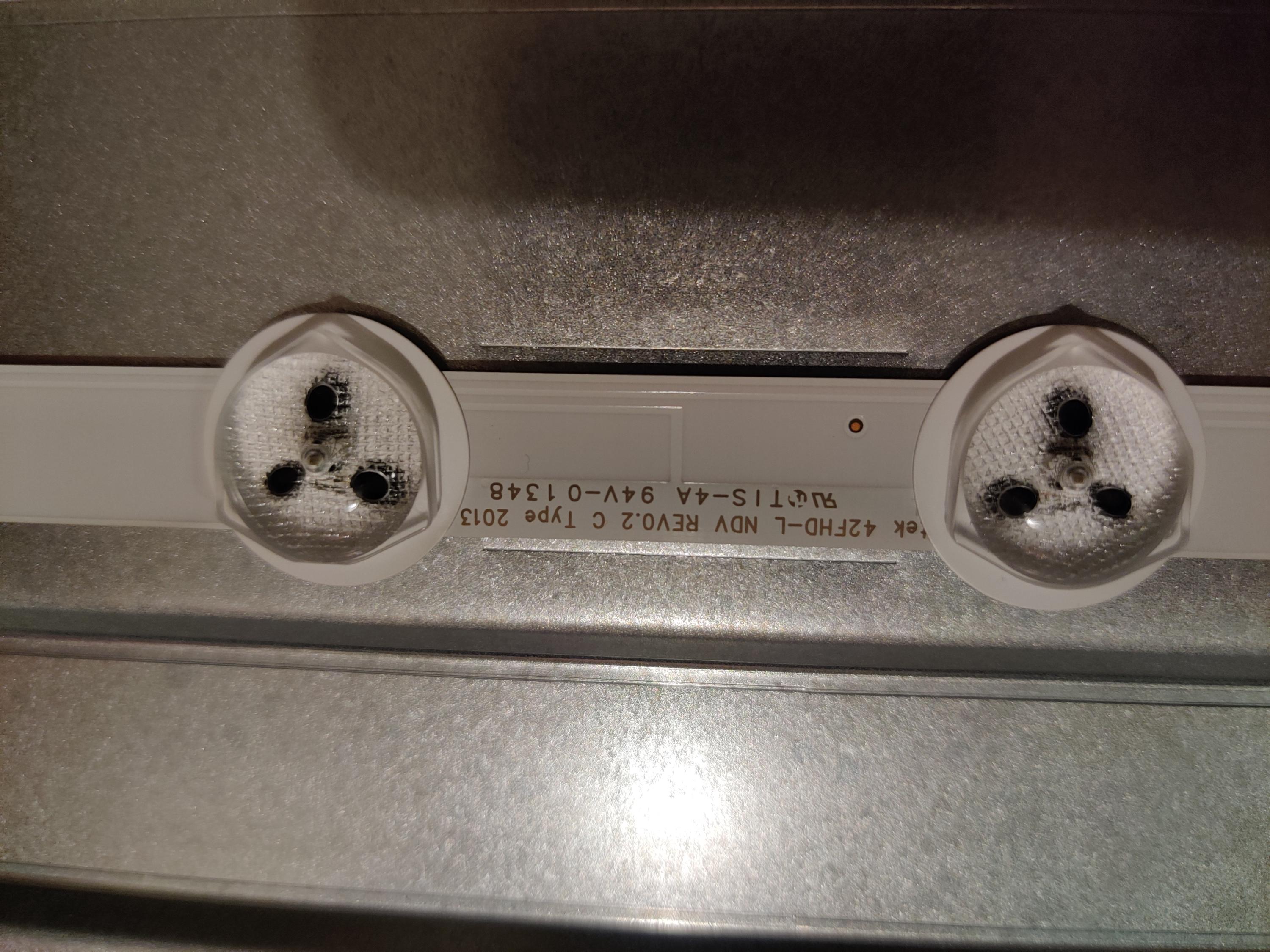

                                        I did manage to test the LEDs individually - see attached for the believed broken ones.
