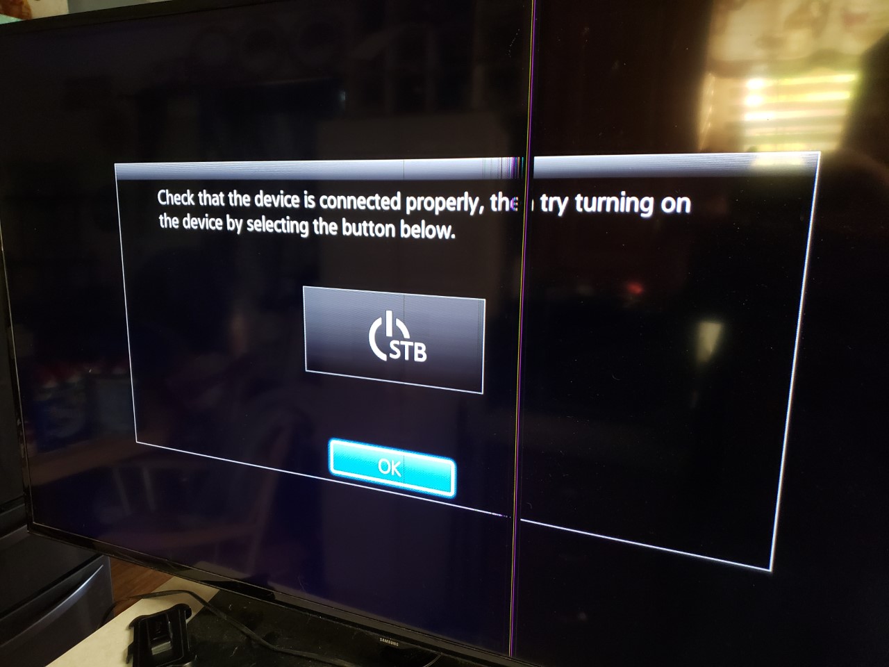

    samsung un58tu7050 single vertical line.
    by sputnikoff
    Had a friend drop this tv off and initial issue was no power.I could see faint glow when powered up .Lamps all fired up fine.I removed flat lvds cable and reseated it,then tv screen came on.After i reassembled it now has single line pretty well dead center of screen.Is there ongoing display issues anyone is aware of.Any input welcome.
