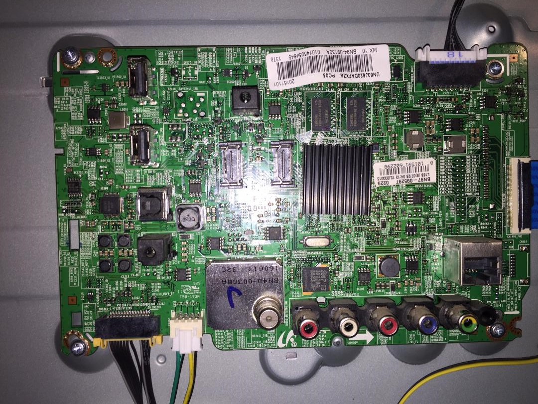

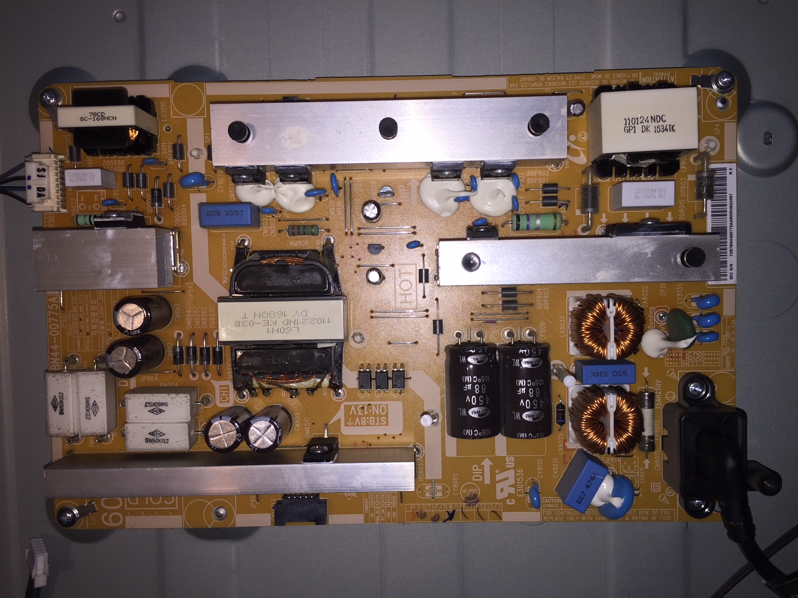

    I have this 60" Samsung that is 18 months old. When plugged in to AC, the red power led on the front of the TV AND the backlights flash in sync with each other once every second or so. This will happen indefinitely until AC is removed. I have unplugged the main board from the Power Supply and symptoms repeat as before. I have enclosed a few pictures to start, but will take more later as it is dark outside. Thank you.

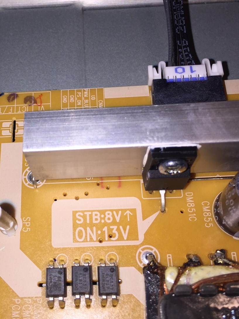

    With everything connected see if STD-BY5V is constant or pulsating, also.

        Andrew F. Ali - Expected to see STB-5V by the connector shown in the upper center of the attached photo, but did find this SB:8V on the power supply board. If it is somehow related, I got 3-5 VDC fluctuating wildly. It didn't match the beat of the power led and backlights but maybe my meter isn't fast enough.

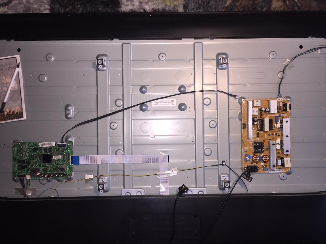

        Mr. CapLeaker - when plugging in to AC and seeing that flashing spell, I saw nothing that resembled picture. But with LEDs disconnected from PS and plugging in to AC, the power LED behaved normally and by turning on and hitting source on the remote, me and my flaslight were able to see the source menus at the top of the screen. The set powered down by itself shortly thereafter.

          SB:8V is the stand by voltage. I do think you have a LED Backlights problem Do you have any experience at all in disassembly of the Panel and removing the fragile glass screen??

                              Lift one leg of the diode D9001C or remove it off the board and then check the RESISTANCE in both directions of that diode, report the resistance reading, make sure that you do not touch the probe tips with your hand because I want to make sure it is not showing your body's resistance.

                                    OK, that reading does not make sense if it show 0 Ohms in one of the reading and 235K in another. Are you testing by putting the probes on each end of the diode?
                                    I think you may have the same diode failure like in this thread with the same diode P/N.

                                      Yes, I repeated the test several times. Digi-Key and Mouser both have the SF28G or would you recommend trying to upgrade? Any suggestions?
                                        Re: Samsung U60J620DAF Power and Backlights blink
                                        I would get a couple of them for either place then, and when you mount it on the board keep the legs long so the body will be 1/4 ~ 1/2 '' above the board to help cooling the diode.
                                        https://www.badcaps.net/forum/showth...t=72153&page=2 the diode did fix the problem on that OP board.
                                        I ask Jason to see if he can ship the extra one to you.
