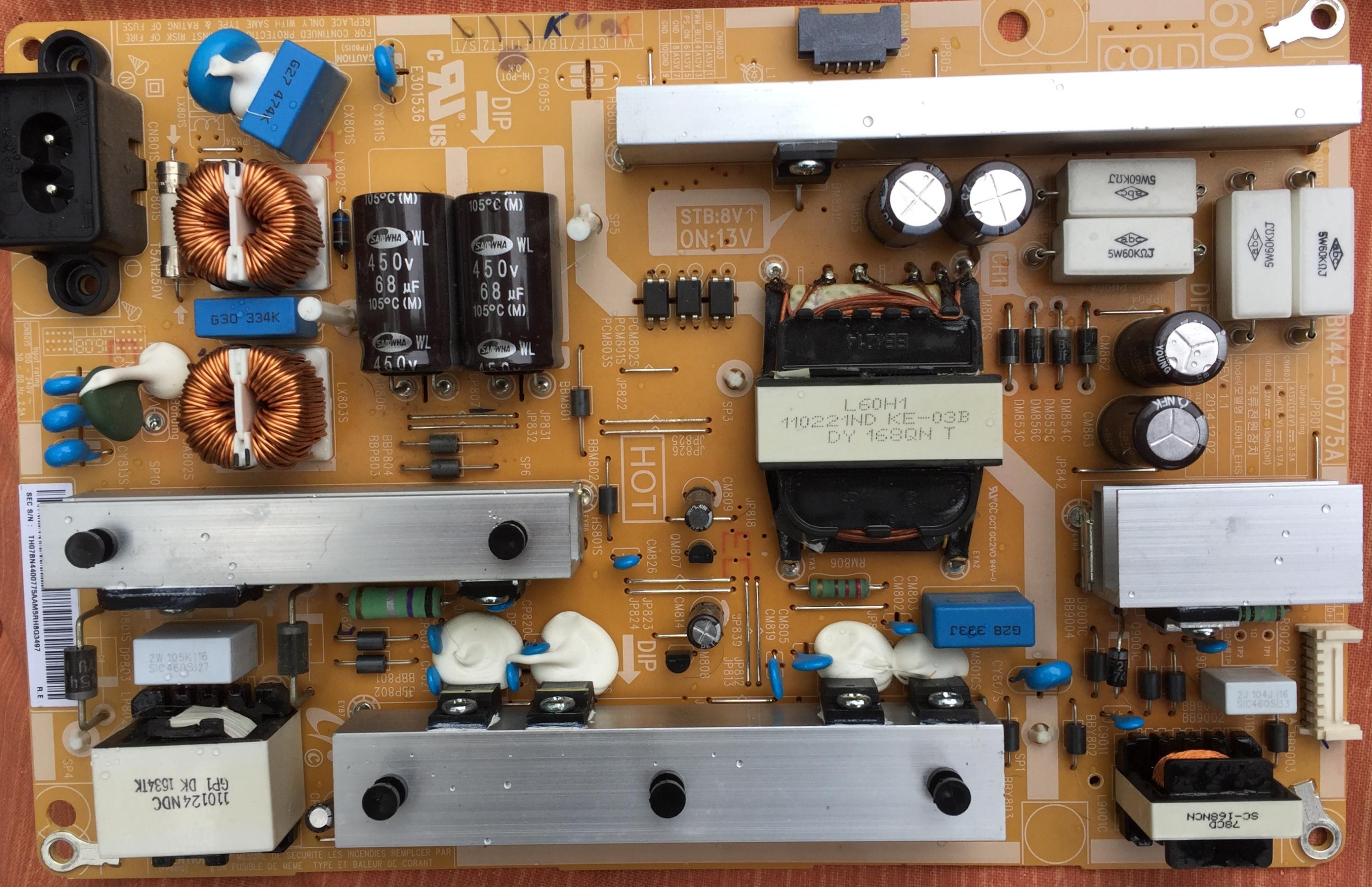

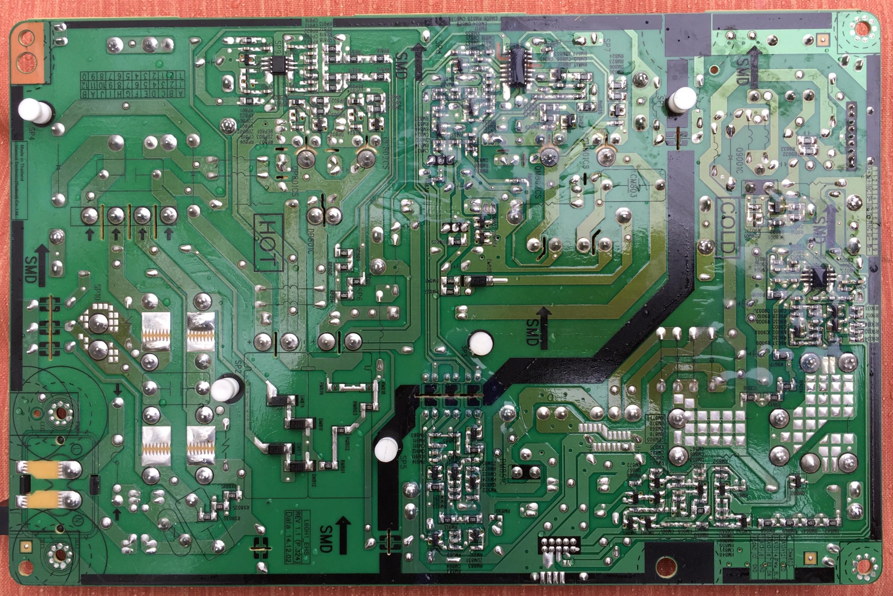

                      #30
                      Re: Samsung U60J620DAF Power and Backlights blink
                      Here are some better pictures of the front and back of PS. Am currently trying to read up on LED Driver circuits and will attempt to trace circuit on board.

                        #31
                        Am trying to make a schematic of the LED Driver section of BN4400775A power supply for this TV. I ran across a 7014X which is addressed on the board as IC9151. I can not find a datasheet for him, but this one keeps popping up in my hunt. OB2268/9. It is a PWM Controller with 8 pins like the 7014X. I don't know if this is just a coincidence or if I have run across something useful. I searched for 7014X on this site, but only found it mentioned on jason123 post about his Samsung, but it wasn't his problem. May still have to get into the LEDs, but figure I might try to learn something along the way.

                          #32
                          Found a broken display TV identical to mine on Craig's list. Took the PS and put it in mine. Same flashing backlights issue. Bought this little led tester thing which is advertised everywhere. The TV has 2 strings. Using the tester on one string at a time disconnected from the power supply, both strings lit up and stayed on but at a low level as seen through the holes on the back of the display. Both strings had the exact same reading of 107 on the tester. Am not really sure what the 107 DC means. Looking for input before I disassemble the display. Thanks.
