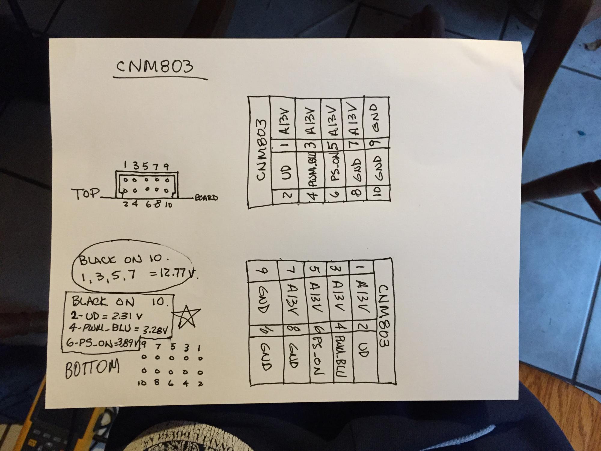

    Pin 1 - UD - +13V
    Pin 3 - PWM-BLU - +13V
    Pin 5 - PS_ON - +13V
    Pin 7 - +13V
    Pin 9 - GND = 0 volts
    These were taken with the black lead on pin 10 GND.
    PS board is only attached to AC.
    You must have counted the connector wrong that is why those reading are wrong, no way the control signals can be 13V, please recheck your connector pins.

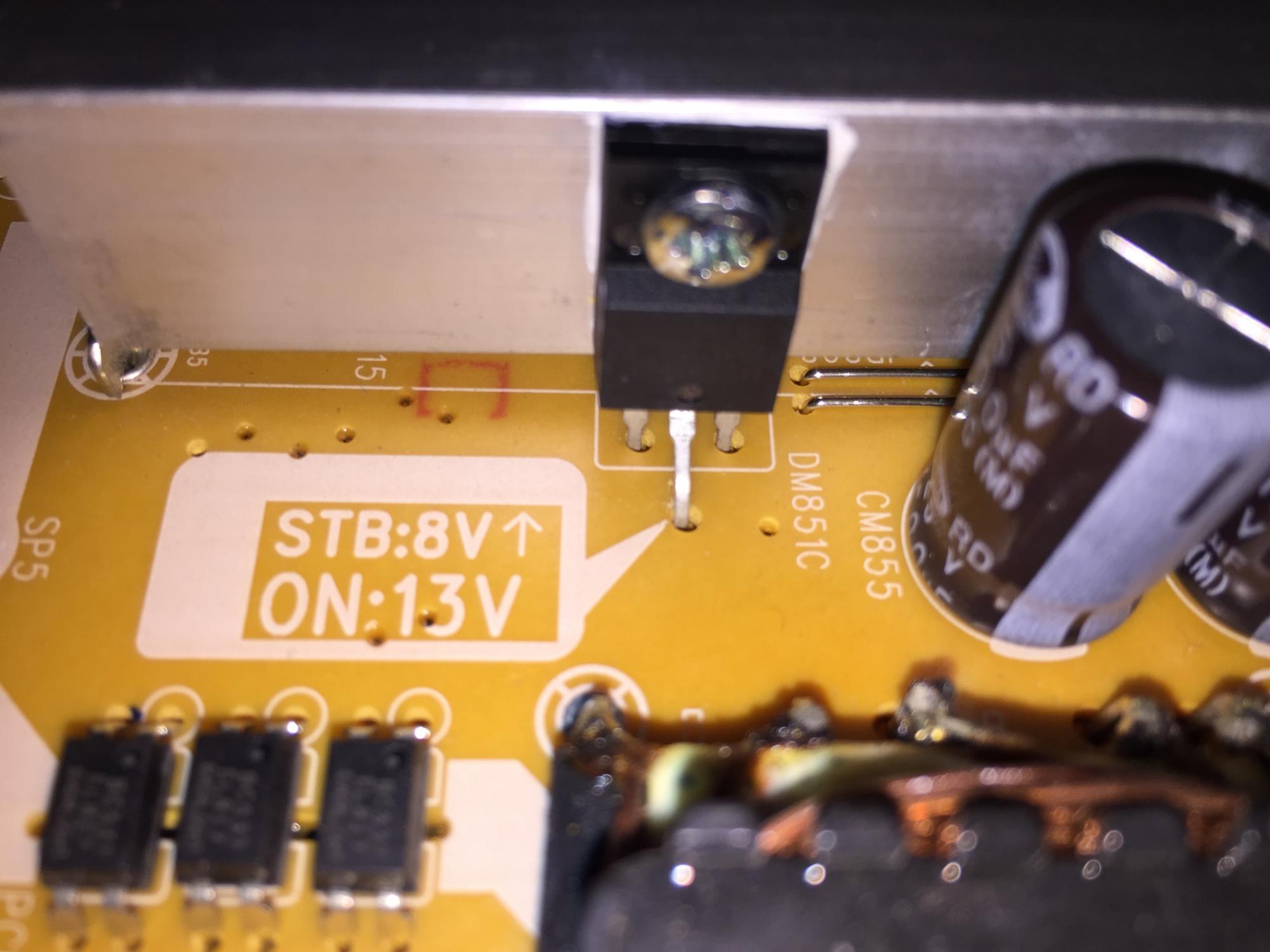

        Re: Samsung U60J620DAF Power and Backlights blink
        Yes, I did.
        Pin 2 - UD = 2.31 V
        Pin 4 - PWM_BLU = 3.28 V
        Pin 6 = 3.88 V
        Pins 1,3,5 and 7 = 12.77 V
        Also center leg of DM851C = 12.7 V
        Hope this is better.

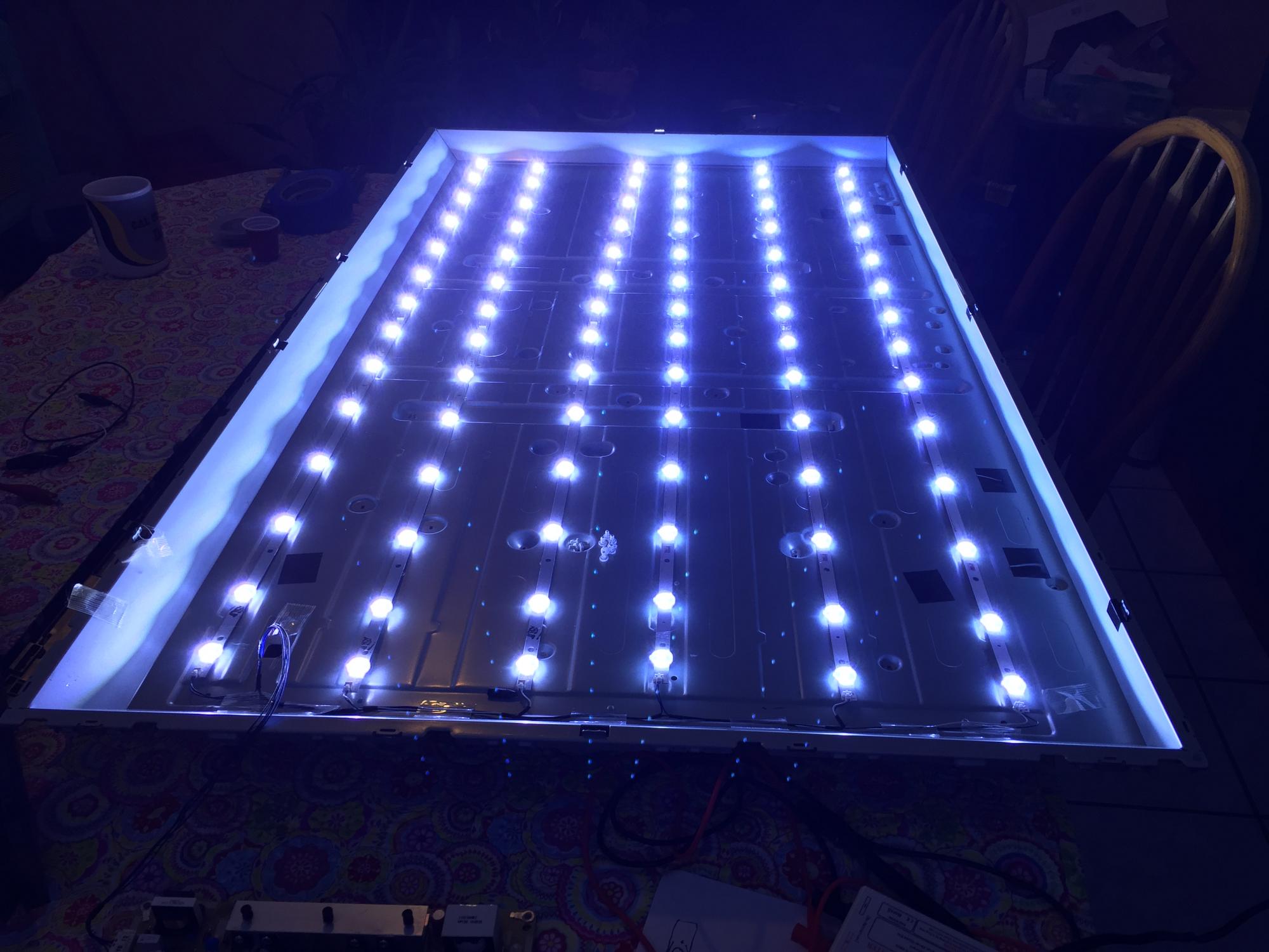

                      So based on your post 34 & 36 when you test the LED strips outside the panel and powered by the power supply board; they light up OK without flashing ? correct?
                      • MEB
                        • Sep 2013
                        • 371
                        #51
                        Sorry to be confusing. I tested both strings with little led tester with the power supply to LED connector disconnected from the power board. I could light both strings up that way. When powering LEDs from either one of the 2 Power Supply boards I have, LEDs (both strings) always flash. This is with the LED connector connected to the PS board and the main board disconnected from the Power Supply board.
                        So, with the PS board connected to the LEDs, whether the main is connected or not, always gives flashing LEDs.

                              Thanks, bud. The LEDs have all been lighting in the panel connected to the power supply but continue flashing. I removed the power supply again and removed all the electrolytics. They all tested fine. I ordered new ones to replace all of them just to eliminate them being a possibility. With the power supply back in and powering it up unconnected to anything else but the LEDs, a noise came from the panel, and using the LED tester, I determined the top string of LEDs wouldn't light. This is the second time I have lost the top string. I will take the panel apart again to see what happened.
                              My wife has issued an ultimatum. I have less than 2 weeks to fix this or I have to buy a new TV before the Super Bowl. I have to fix this one regardless of the outcome of that but am nearly out of ideas.
                              I ordered another set of strips from SJ and they will probably be here Wednesday. I will test them outside the panel as you suggested this time. Before I do, I want to have a fairly good feeling about the power supply. Can I test the following voltages without burning something up with nothing but AC connected to the board, and what should I expect to see. D+ to D-, D+ to chassis and D- to chassis. I think I should also check the actual wires from the power supply to the LEDs. Also is there any advantage to placing a voltmeter in the circuit to monitor current. I doubt I might be fast enough to pull the plug before damage would occur but was just wondering. This little adventure is getting quite costly but I can't stop now. Thanks for your help.

                                Aha, seems like the first new set of strips I bought had problems. I put 3 of the good originals and 3 of the good new ones in there and it is working. As budm eluded to, I think even though the bad strips tested fine under low current with the little led tester, when the PS board was used, they failed under high current.
                                I think the original problem of the LEDs flashing on and off, must have been some protection circuit on the PS board that shut down and started over and over in a vicious loop. Is that possible?
                                So I didn't need the 2nd new set of strips I just received, but I am going to put them in there anyway. I don't want to have to do this again any time soon. Thanks to all who helped.

                                  Nice job, seems like it's the backlights 99 percent when you have flashing issues.
