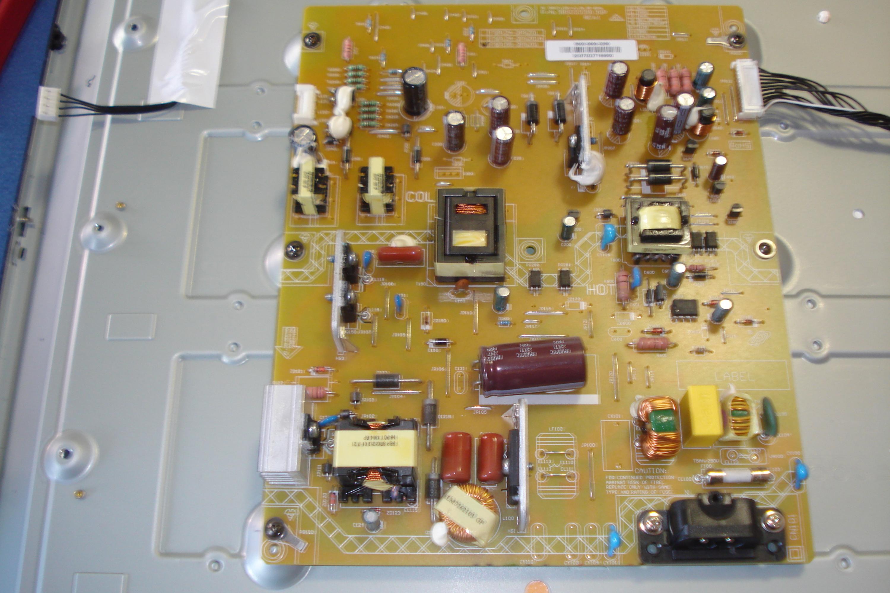

    I posted this earlier but can not find it on here. not sure why..here we go again with more information..TV Screen went black while watching it. turned the tv off and back on..has a picture again for awhile..went black again.now does not have Backlights...has 123 volts DC at CN301 on LED1+ and LED2+ when tv is first turned on...leaving the volt meter hooked up the voltage starts dropping until it reaches about 67 volts DC, this occurs on both LED 1 and LED 2 pin connector CN301 as seen in picture....I remove the connector at CN301 and have the same results as far as voltage checks go...Thanks in advance.

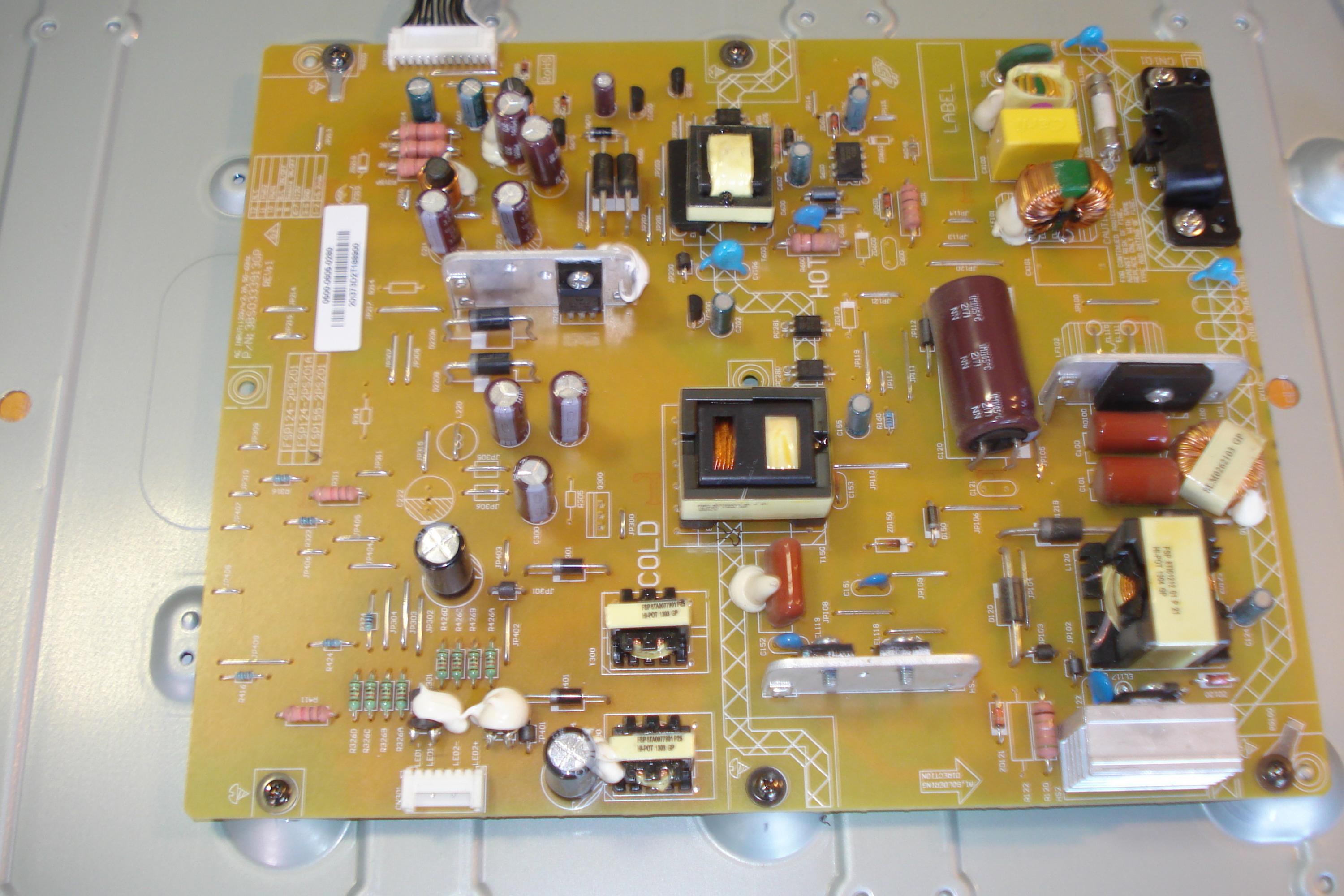

      Re: Vizio E500I-AB No Backlight has sound
      your pictures are too blurry for me to read anything off the PSU. Also recheck the model number of the TV. So far I couldn't find an "AB". It should be some thing like "A1" or "B1". Sounds like a backlight LED problem to me. Does the LEDs turn on for a second when you turn the TV on?

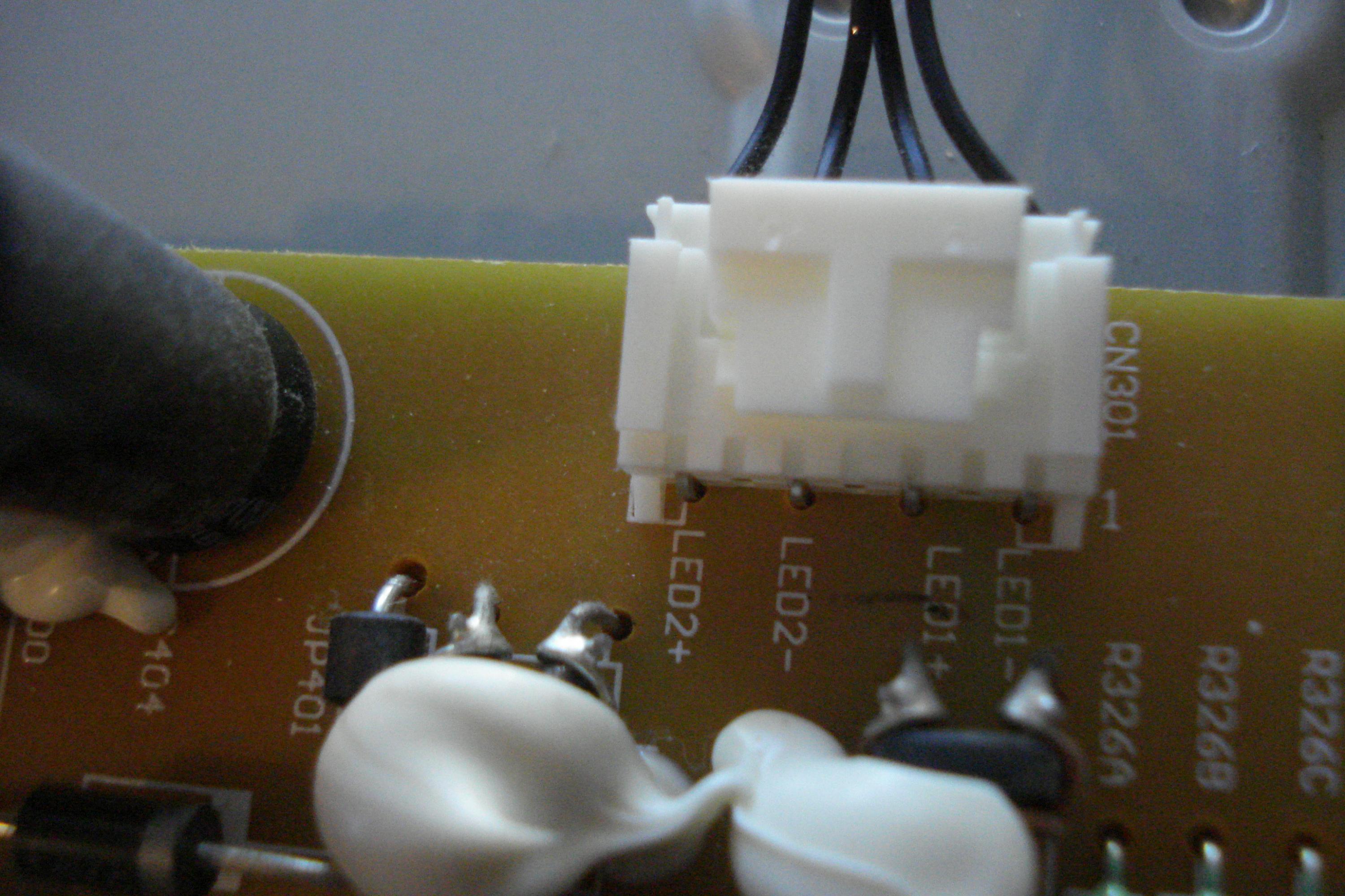

        Sorry for the blurry pictures, this camera will not do good close up shots like it used to...I do Not see the LEDs turn on at all..I'm thinking one of the LED strings is open since the voltage drop at CN301 is the same whether the LEDS are connected or not.
                  That power supply board has two boost converters, one for each LED string, so if you put the LED connector back in place and then leave the black probe on the chassis and red probe on one of the two LED 1 + then turn on the TV while watching the meter to see how high it goes up to and then back down to, record the value then turn off the TV and the repeat 3 more times on the other 3 pins of the LED connector, report the result.

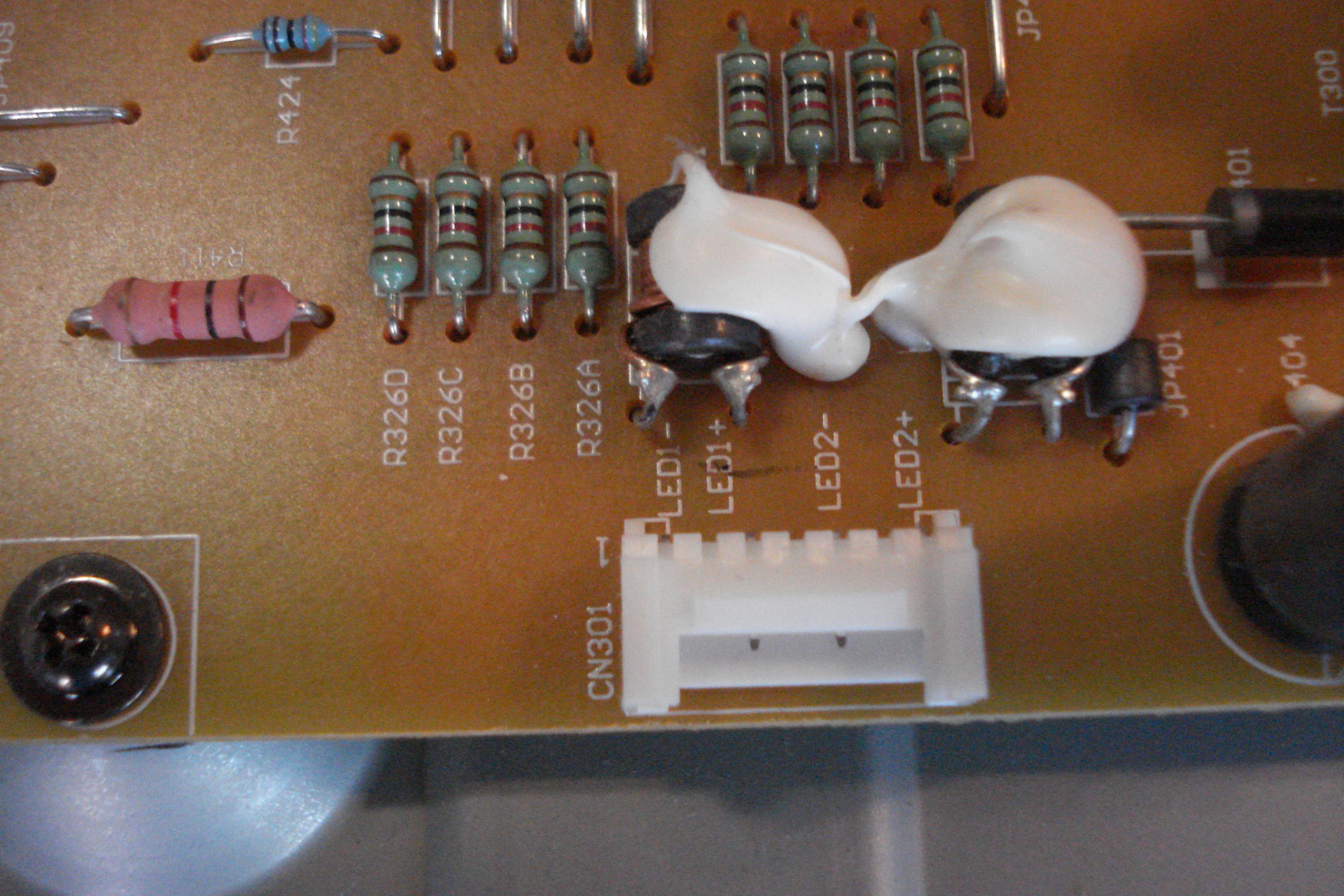

                    Voltage Readings at CN301 on the Power Supply Bd.
                    LED1- 19.5 V when tv first powered on then it dropped to 0.1V
                    LED1+ 128 V when tv first powered on then it dropped to 66.9 V
                    LED2- 12.1 V when tv first powered on then it dropped to 0.4 V
                    LED2+ 128 V when tv first powered on then it dropped to 66.9 V
                    Reply for budm
                      So the feeding Voltage to the boost converter is 66.9V.
                      It may have shorted out LEDs on the LED 1 - because the Vdrops on the PWM control is higher than the LED 2 -.
                        If I unplug the connector at CN301 the voltage at both LED1+ and LED2+ starts out at about 67 volts and maintains that same voltage without any drop. I did not test the LED1- and LED2- with the connector unplugged...I'm not sure if this information helps...Is there a was to test the LED strips without the LED Tester like Shopjimmy sells? Thanks.

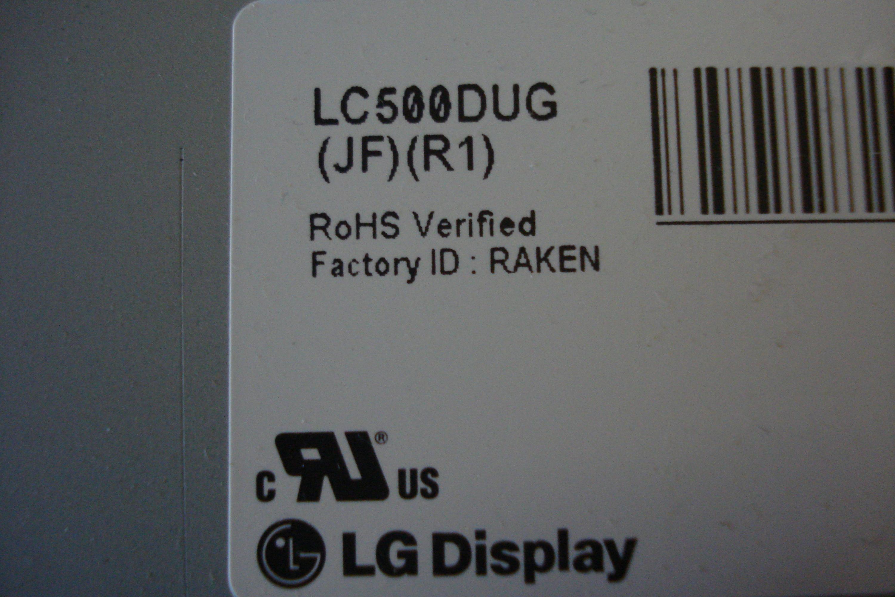

                            From the voltage reading seen here it is definitely a LED backlights problem and not any other fault/s. You would have to strip the Panel down to reach the backlights and take a note of the filter sheets order of which goes first to the last and where the plexi-sheet is placed.

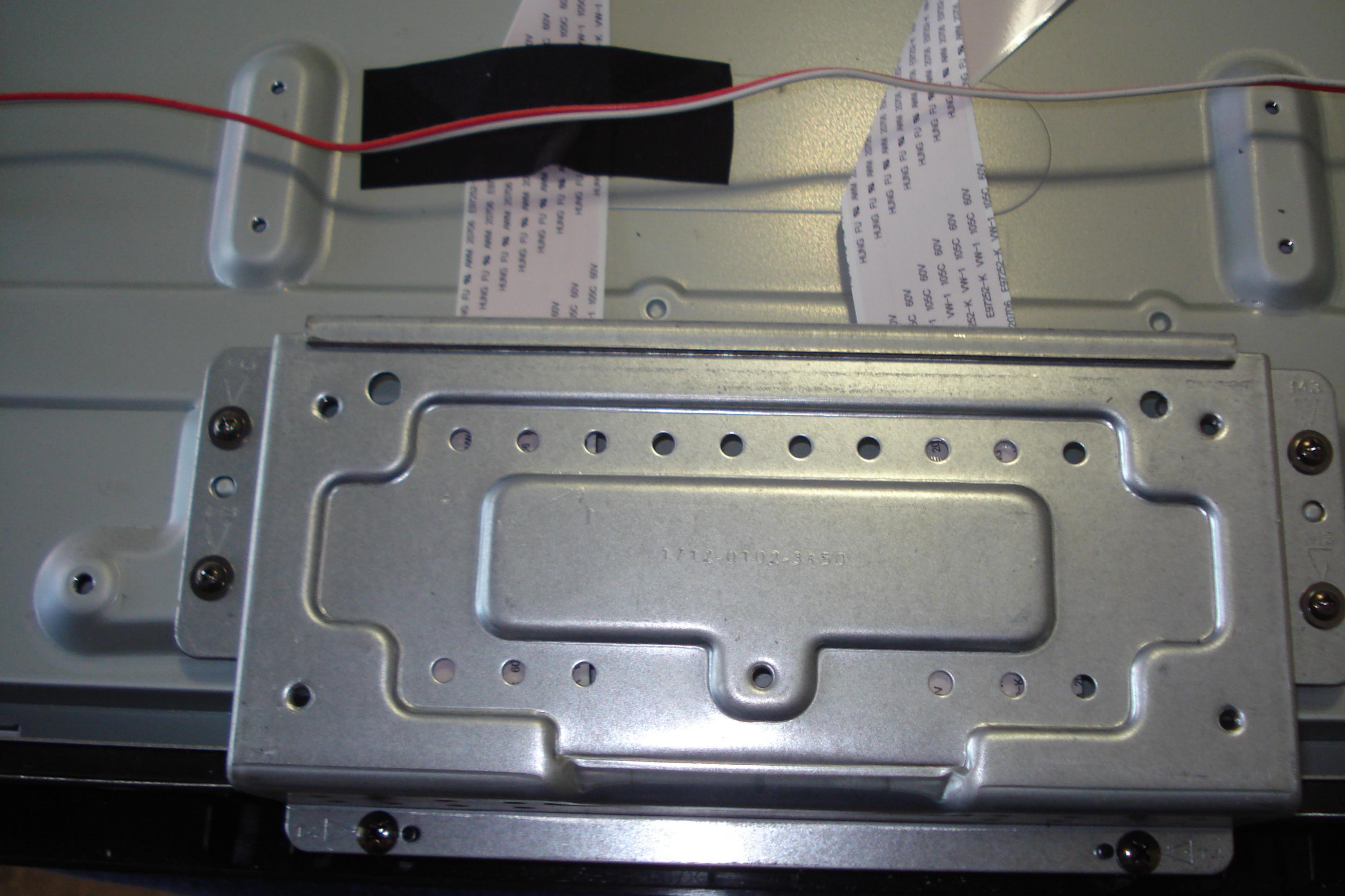

                                    • MisterD
                                      • Oct 2012
                                      • 668
                                      My friend and I disassembled the TV Today, I took three 9 volt batteries wired in series by plugging them into each other, then ran two leads for positive and negative off the batteries..this gave me 27 volts. I hooked up the leads with the correct polarity to test each LED Strip of 10 each LED. 4 of the strips lit up all the way across and two of them did not light at all. so my friend ordered a full set of replacement LED strips from Shopjimmy. once these come in we will replace them and reassemble the TV..Thanks to all for the help. will post results.
                                      • MisterD
