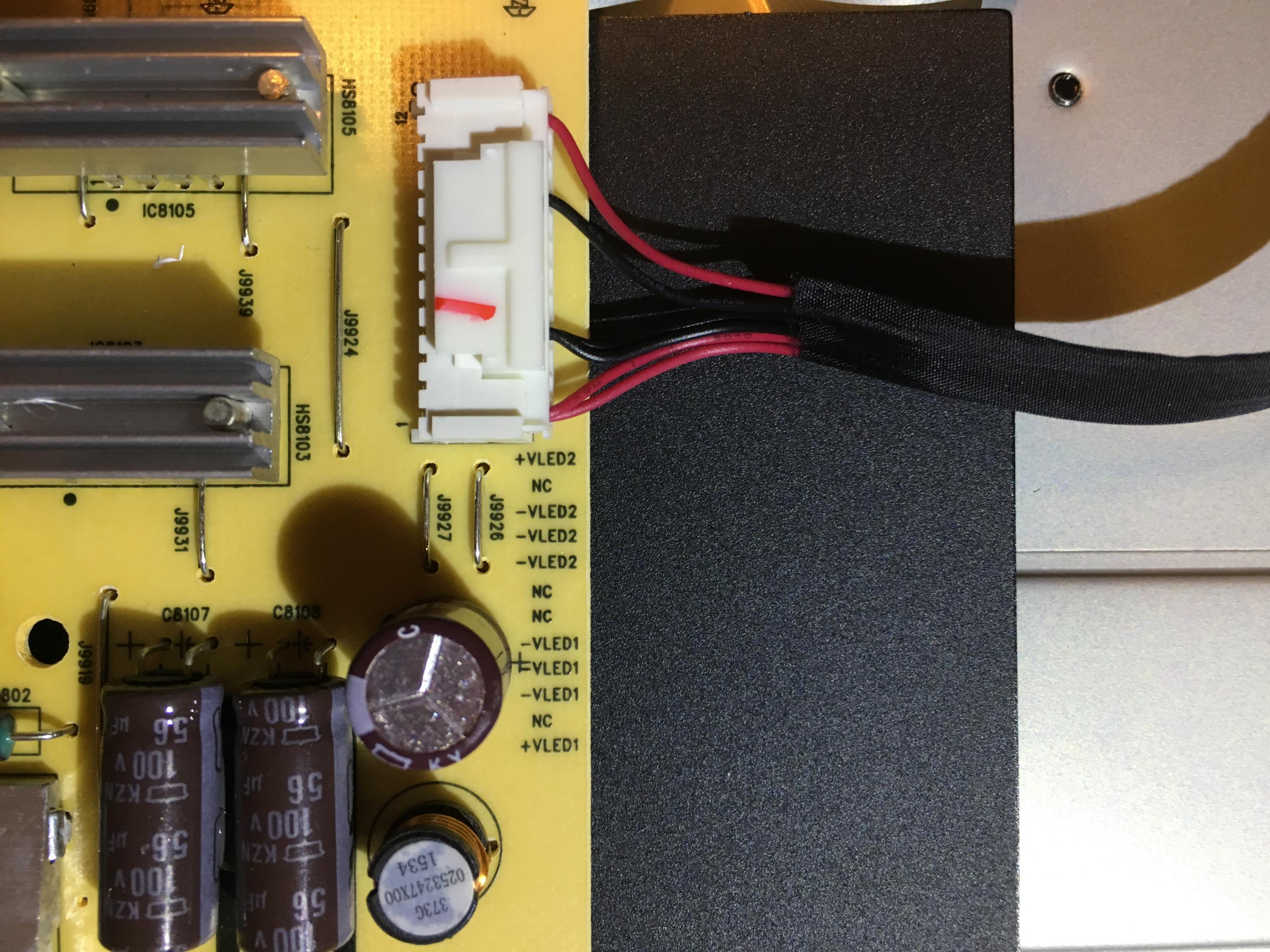

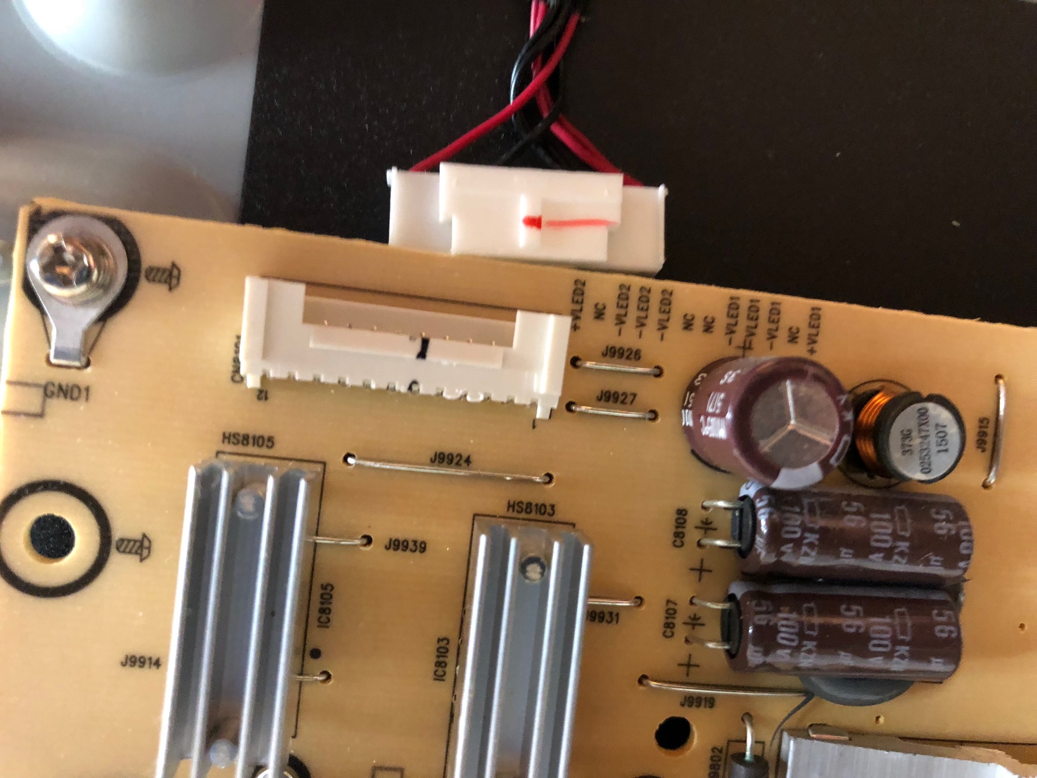

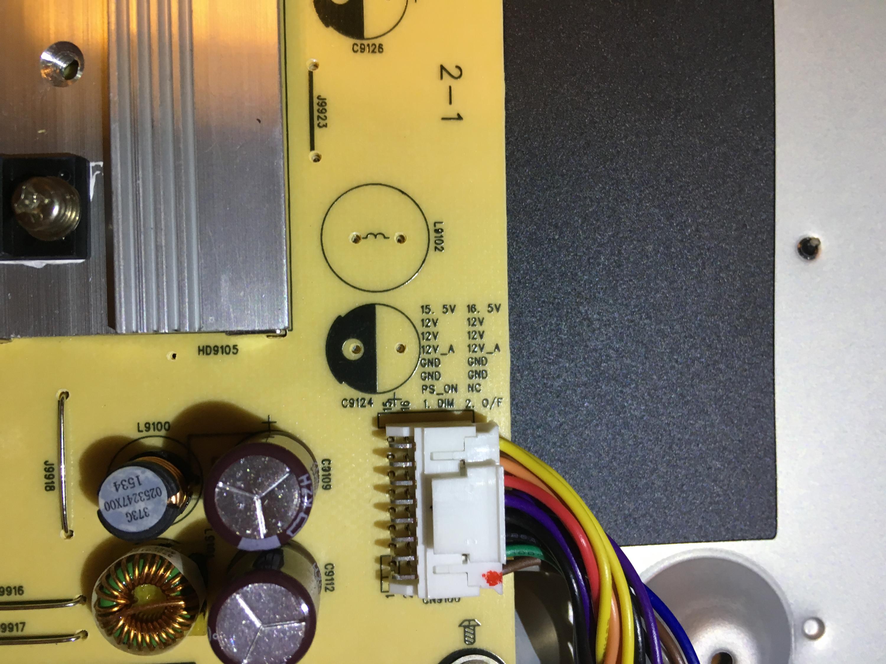

                            Re: Sharp LC-50LB370U no backlight
                            Couldn't get to check it last night, but here's what I found tonight.
                            The VLED + pins would jump up to ~97vdc and then settle down to 65vdc relative to GND.
                            The VLED - pins did not jump, but stayed around .05vdc relative to GND.
                            I checked the pins on the cable to the main board. All the voltages seemed to be okay based on the pin description, except for the 2 pins that were supposed to be +15.5vdc. Both of them were around .8vdc.
                              1)You have open circuit on the LOAD (LED string, wire, or linking connectors) that is why the boosted Voltage went up to 97V so it goes into shutdown and goes back down to 65V, basically you have Voltage feeding the Anodes but nothing comes out on the Cathode sides.
                              2) The 15V circuit is not used so the parts are not installed, that is why you do not have the 15V.
