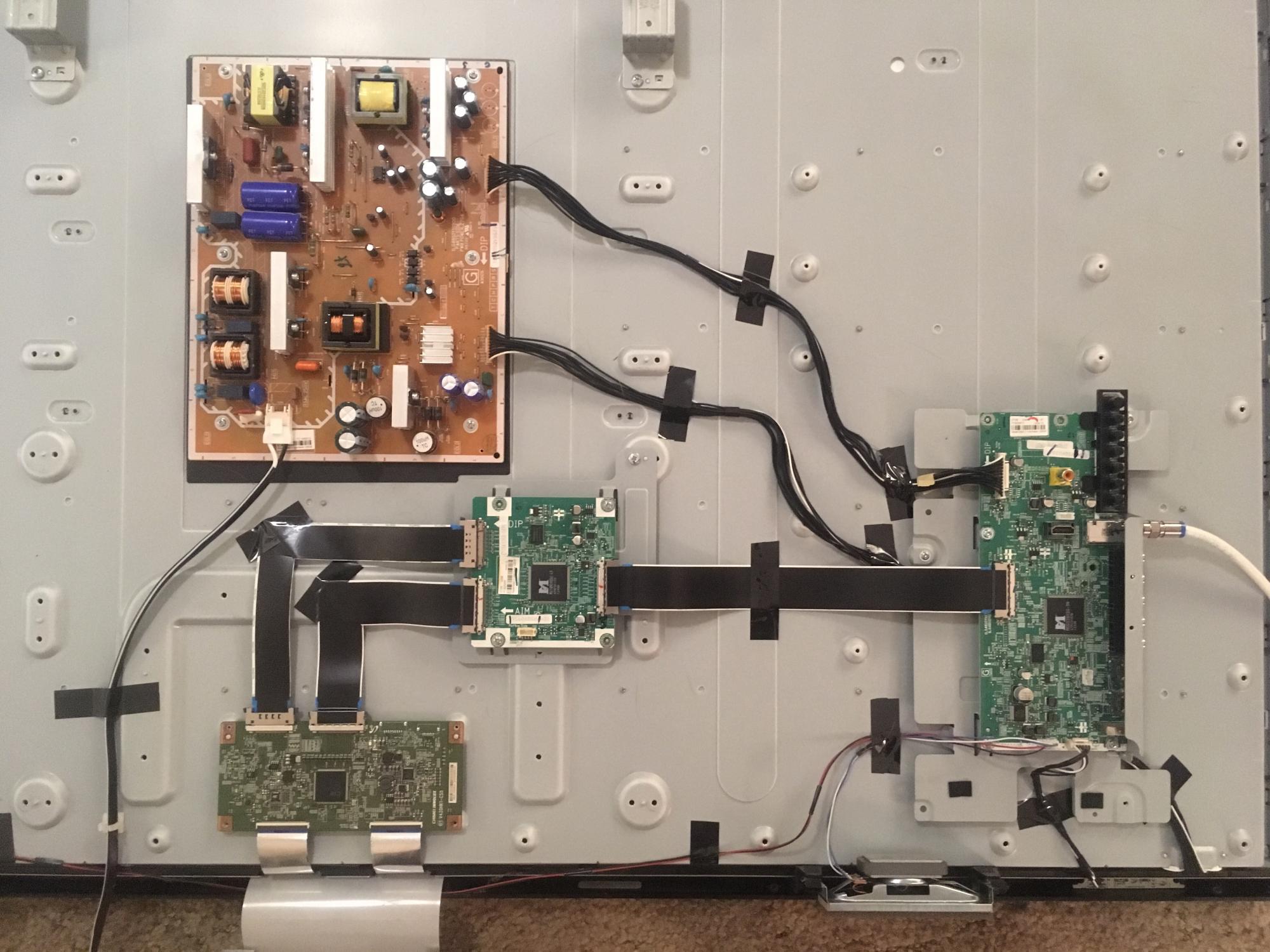

    1) We need pictures of the whole back side of the TV showing all the boards.

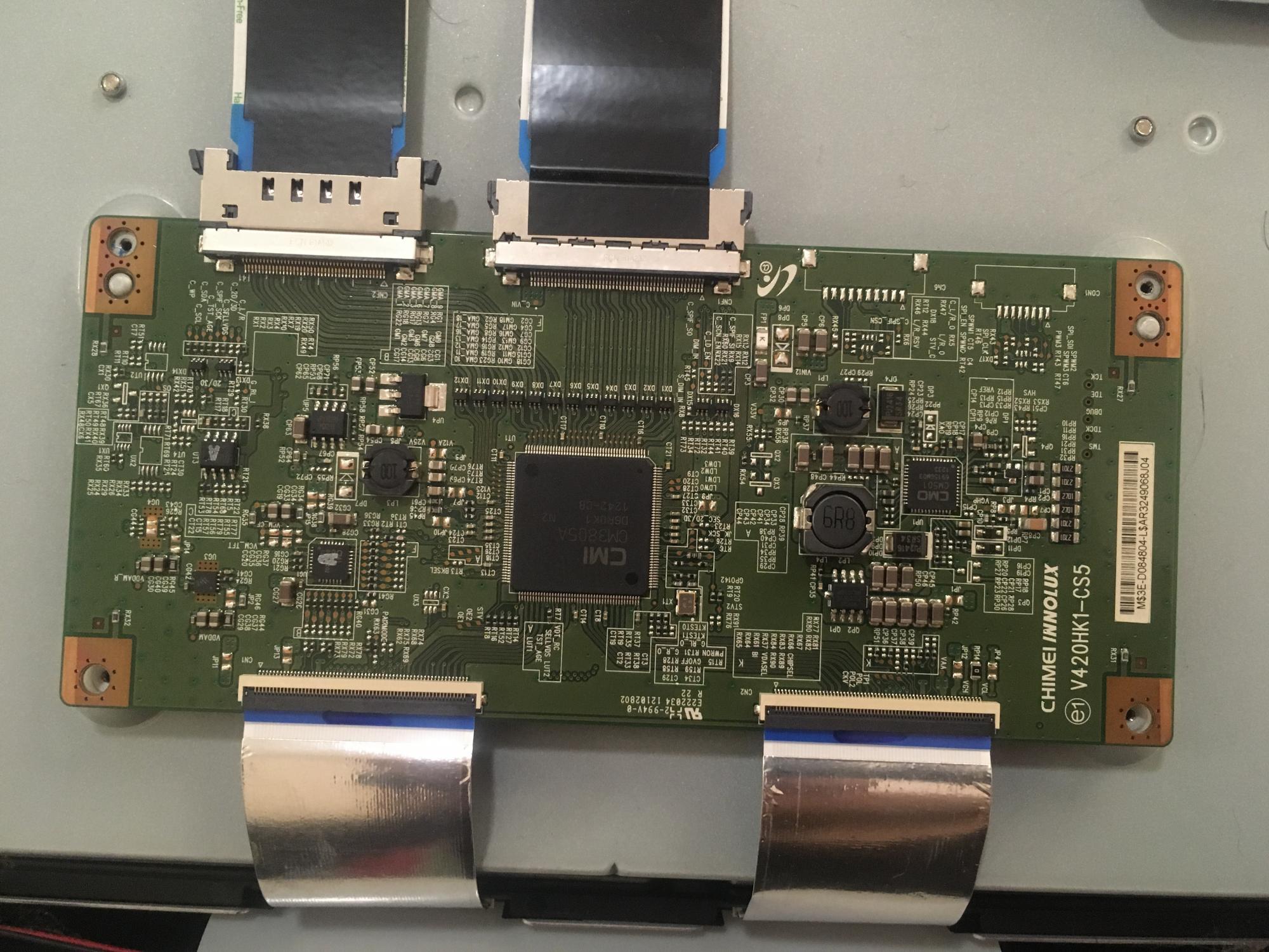

        Re: Sanyo DP58D33 sound but no picture

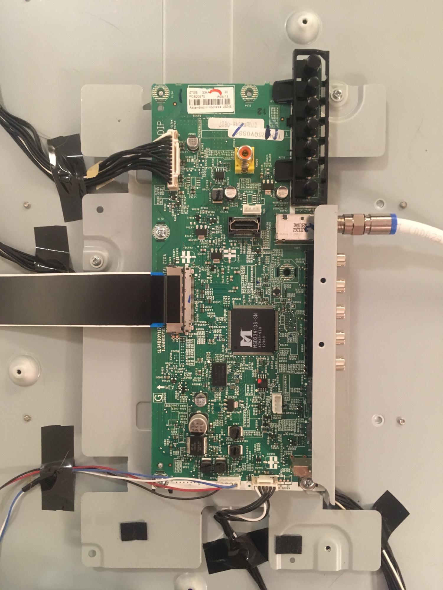

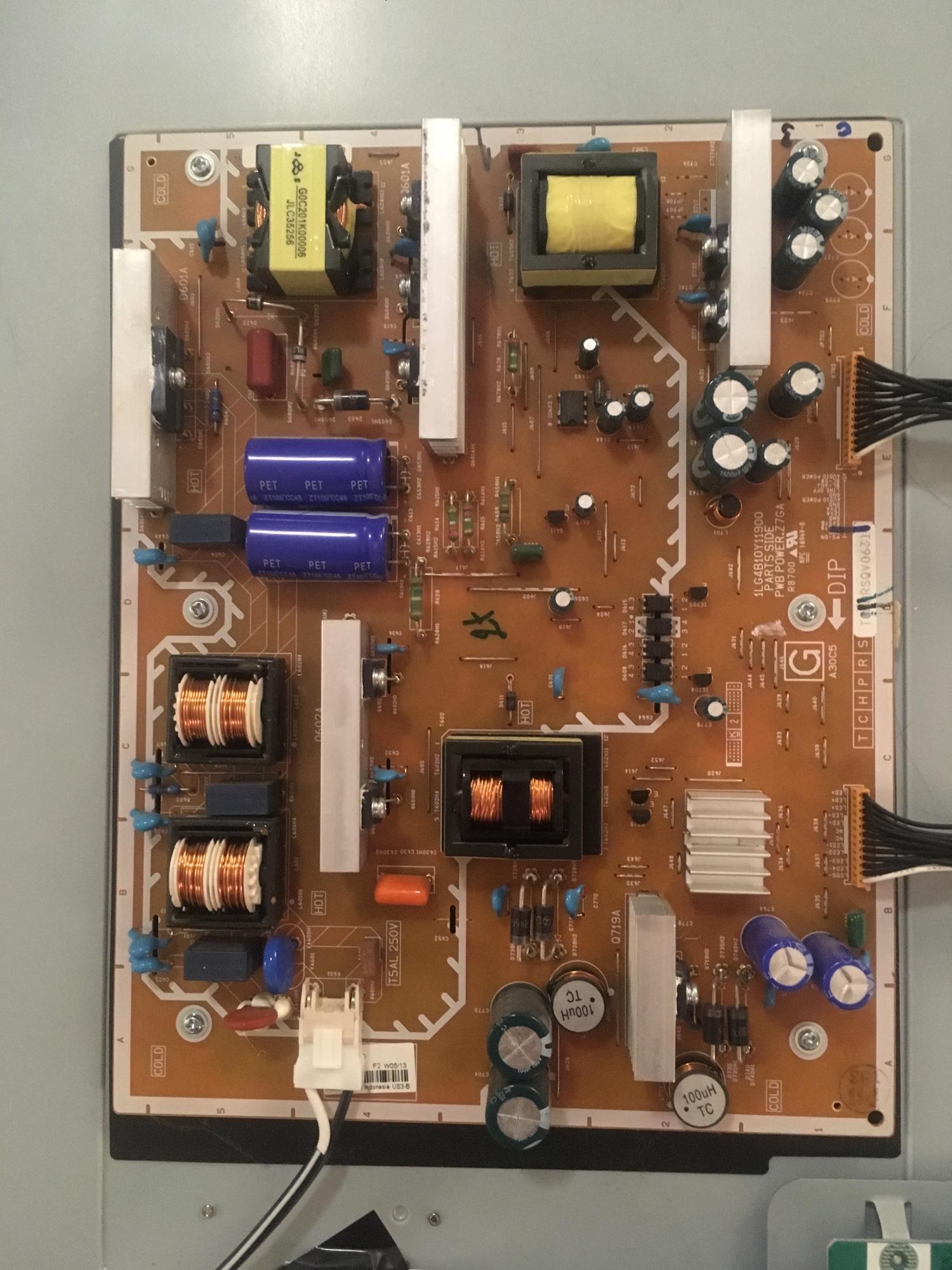

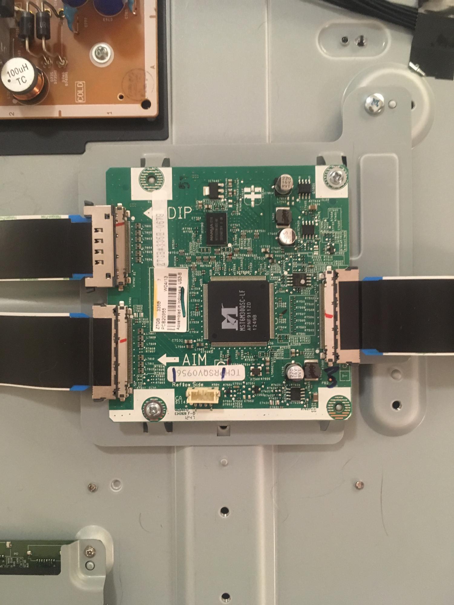

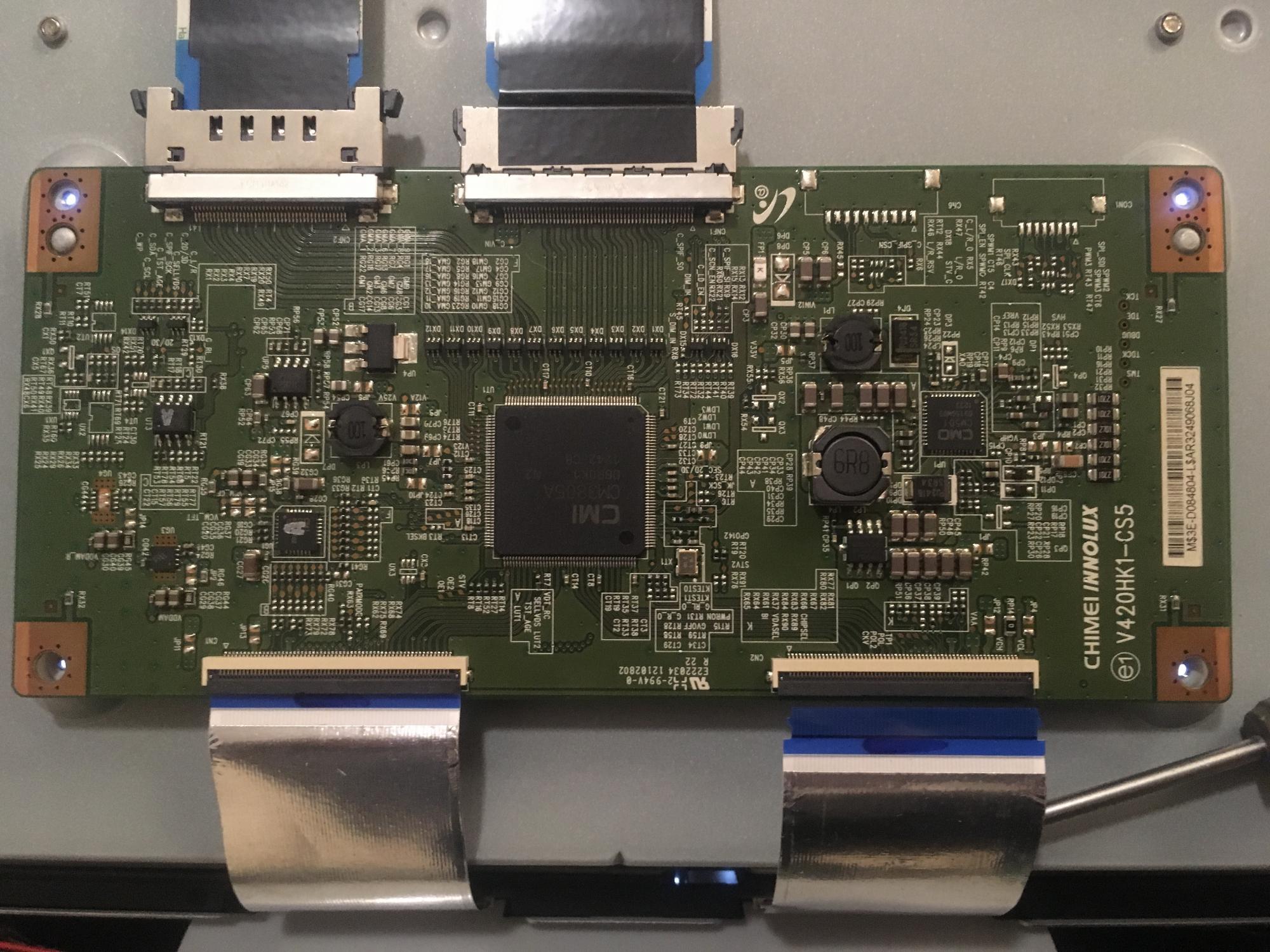

        Picture 1: Overall
        Picture 2: Powerboard
        Picture 3: Mainboard
        Picture 4: Subdigital board
        Picture 5: T-Con board
        I'll need help finding the fuse you're talking about. This is my first time troubleshooting something like this. Same with the second suggestion. Thanks in advance for your time and effort
          https://www.badcaps.net/forum/attach...8&d=1536713331
          Fuse = FP1 (white body witj 'K' printed on top). You can also see Voltage test pad 'VIN12'

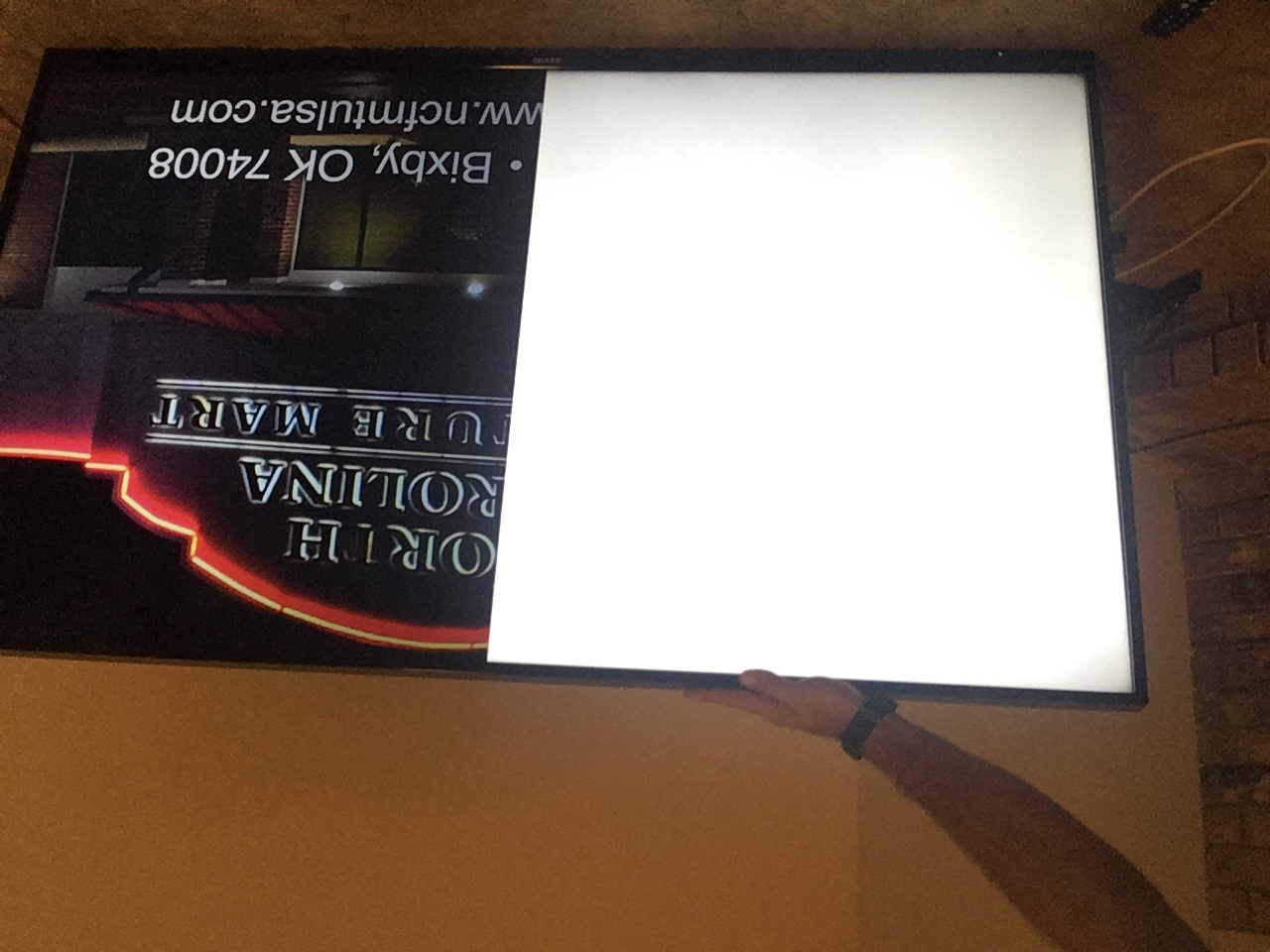

                      Looks like you were on to something, I'm not sure what it means though. Second picture shows which one was disconnected when I got the half screen.
                        I would start looking for bad (shorted) caps on the tab bonding board where the Cable from the T-CON to the panel goes to.
                                Originally posted by budwich
                                what happens when you do the other side as suggested? It more than likely a panel problem but wait til you see the result... more suggestions there after.
                                I attempted the left ribbon connector first, the screen stayed black. When I removed the right one, that's when I got the split screen.
                                    ok... soooo... with that new information, it would appear that the problem is on the side that was disconnected and you got a picture on the other side.
                                    you need to provide pictures of the bottom area showing the edge boards along the bottom all the way to the side corner. Then you need to look at long the side to see what tabs (like the ones on the bottom) that connected to the side of the panel... note you have to see these by removing the front bezel IF they, the tabs, exist.
