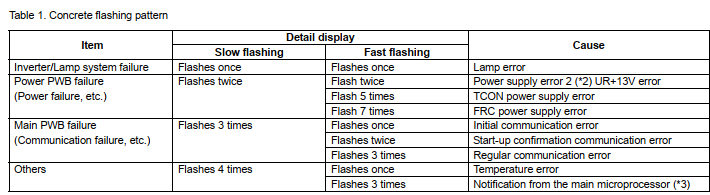

    Hi guys, I have a question about a sharp TV M# LC-60UD27U This TV when plugged in the front light will stay steady for about 1 to 2 mins and then it goes into the blinking... here's the thing.. it will blink 2 times slow and then 7 times fast .. I cannot find anything on this code I called sharp and they just had me do the reset and the hard reset I think all the resets ave been done but I cannot find anything on this code 2 blinks slow 7 blinks fast .. hope someone can help .. Thanks Guys .. Michael

    Re: Sharp TV Model# LC-60UD27U
    frc power supply error is the blink code i will attach the service manual once its downloaded page 69
      Yes I did my research and it is a blink code.. the thing is I cannot find anything on that particular code 2 blinks slow.. 7 blinks fast ! have you seen this code? Thanks
        yes that what that code means it says it in the service Manual 2 slow 7 fast blinks so check the supply to/on the frc power supply board.
        here is the direct link to the service manual scroll down to the bottom of page and wait for a minute i will then say get manual click that and download it im having trouble uploading it too the site

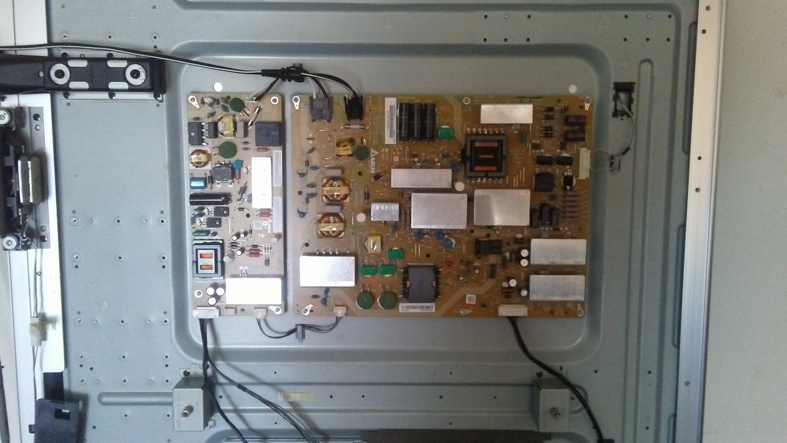

                  We need to see the pictures of the whole back side of the TV showing all the boards.
                  Then you have to start checking to see the FRC (Frame Rate Conversion) board/circuit is getting the Voltage to run or not.

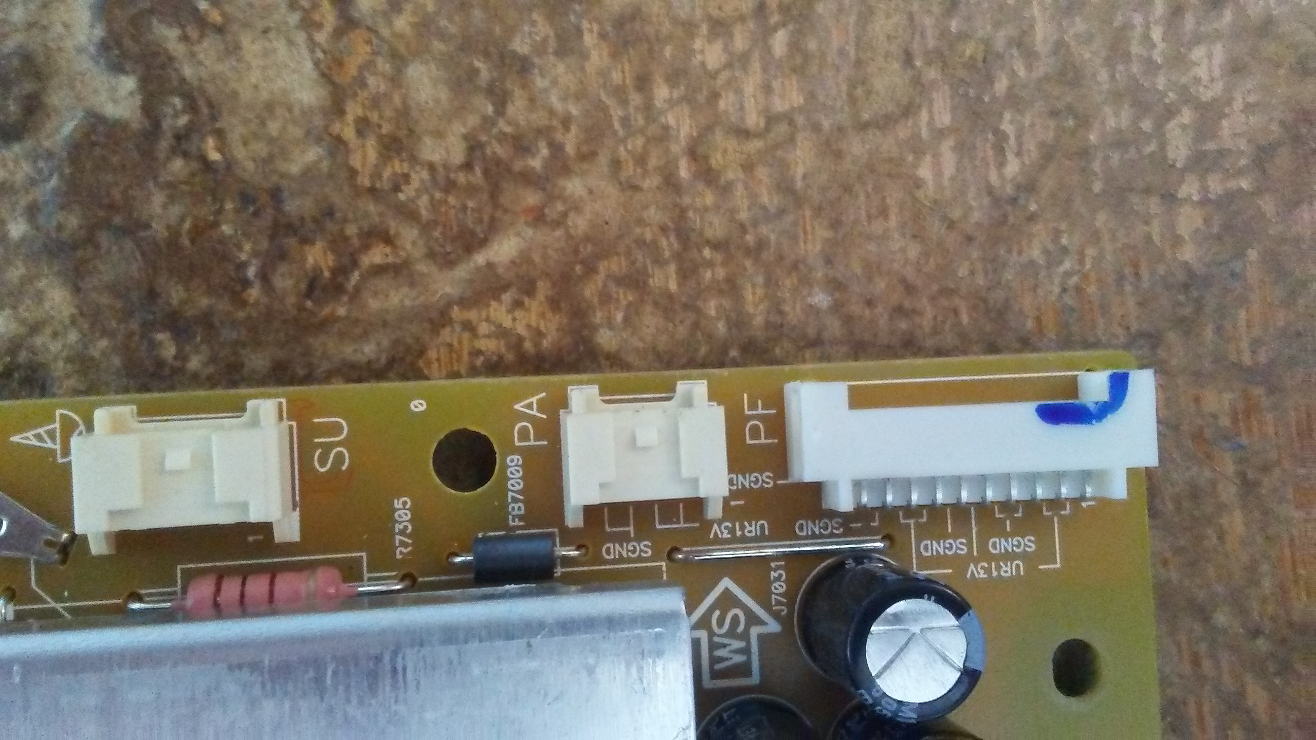

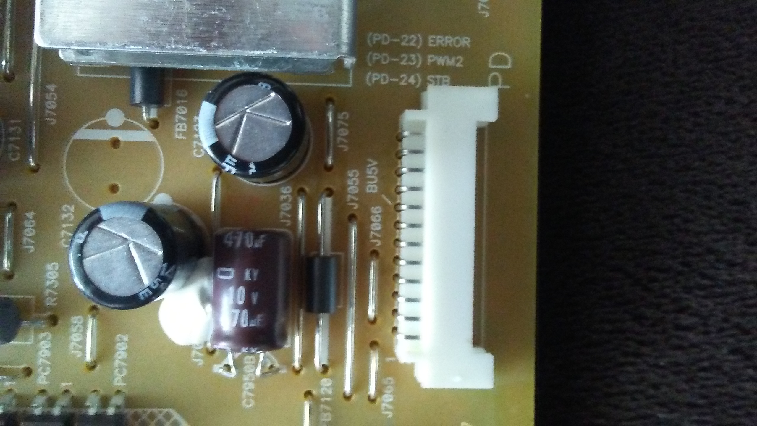

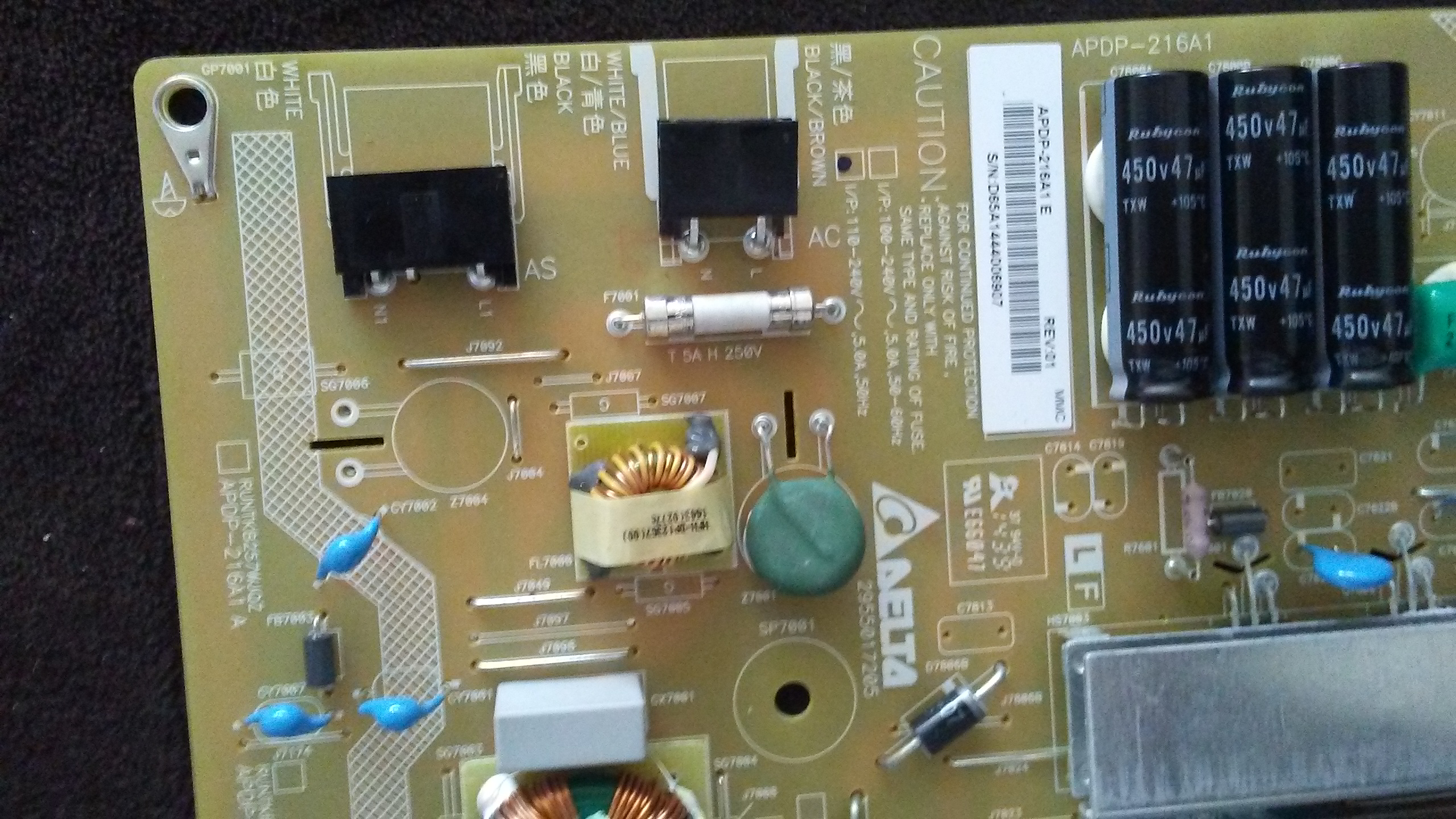

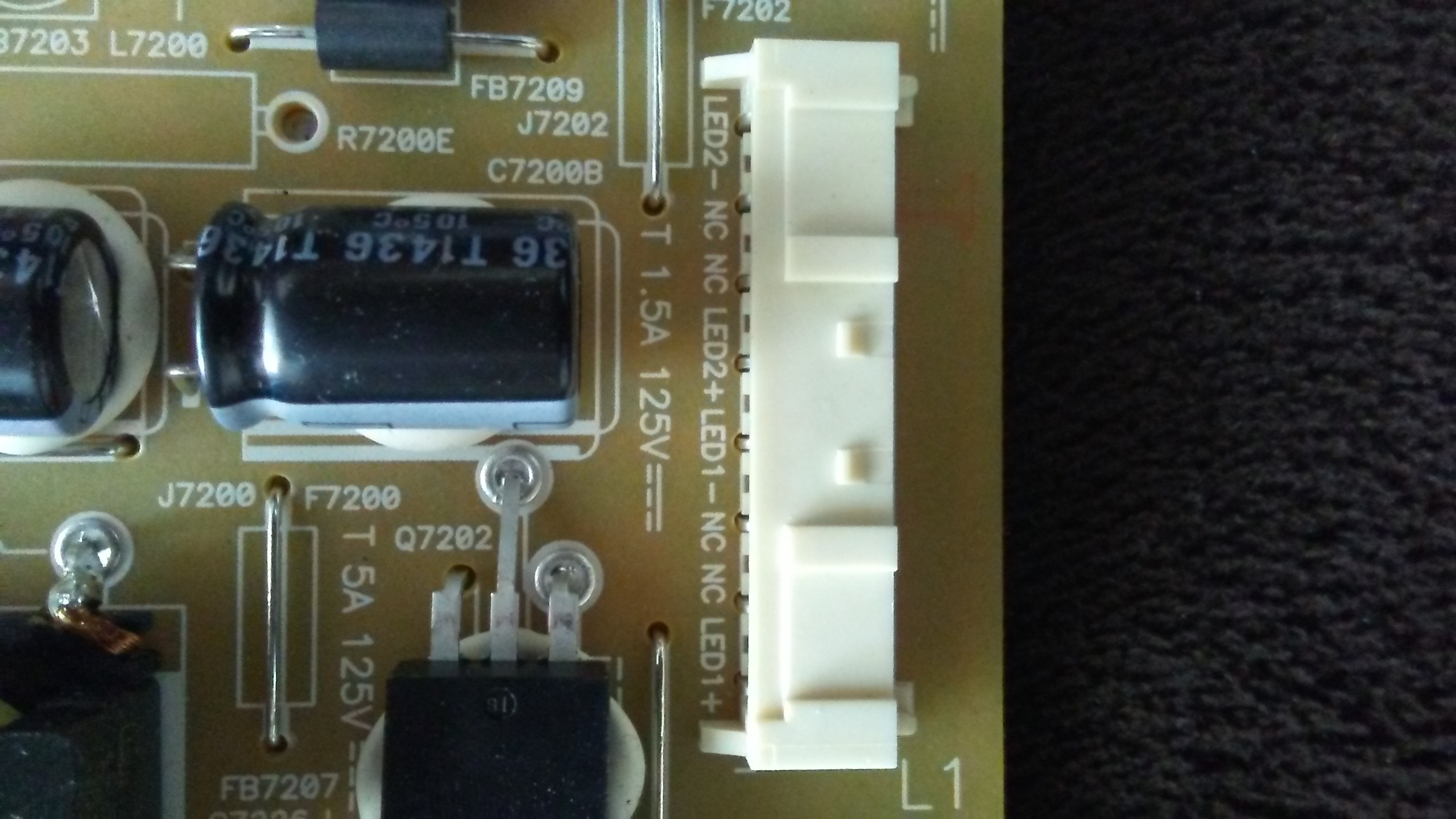

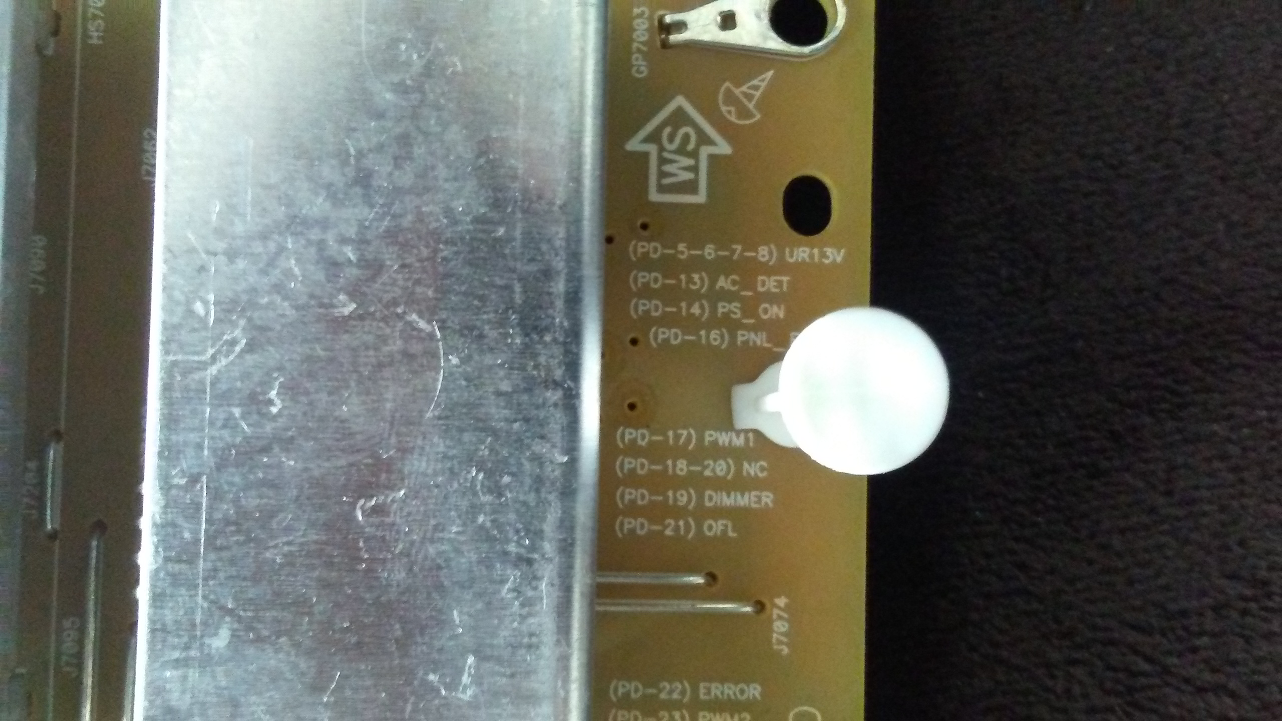

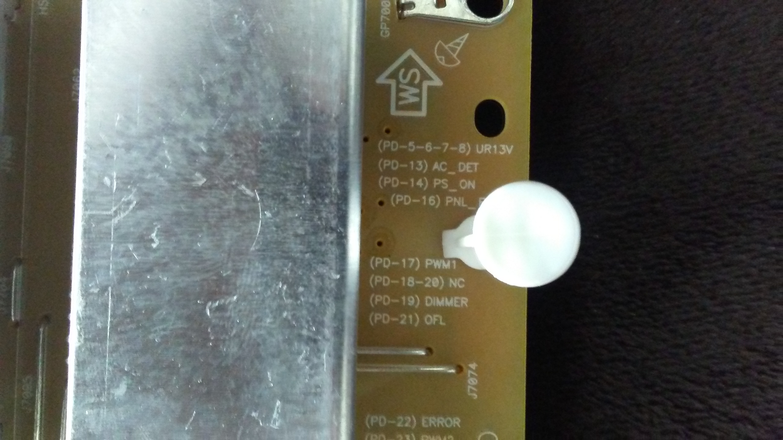

                          if there is a fault you wont be able to force it on can you post a clear picture of the power supply used in your tv
                          • Michaels3e
                            • Mar 2011
                            • 11

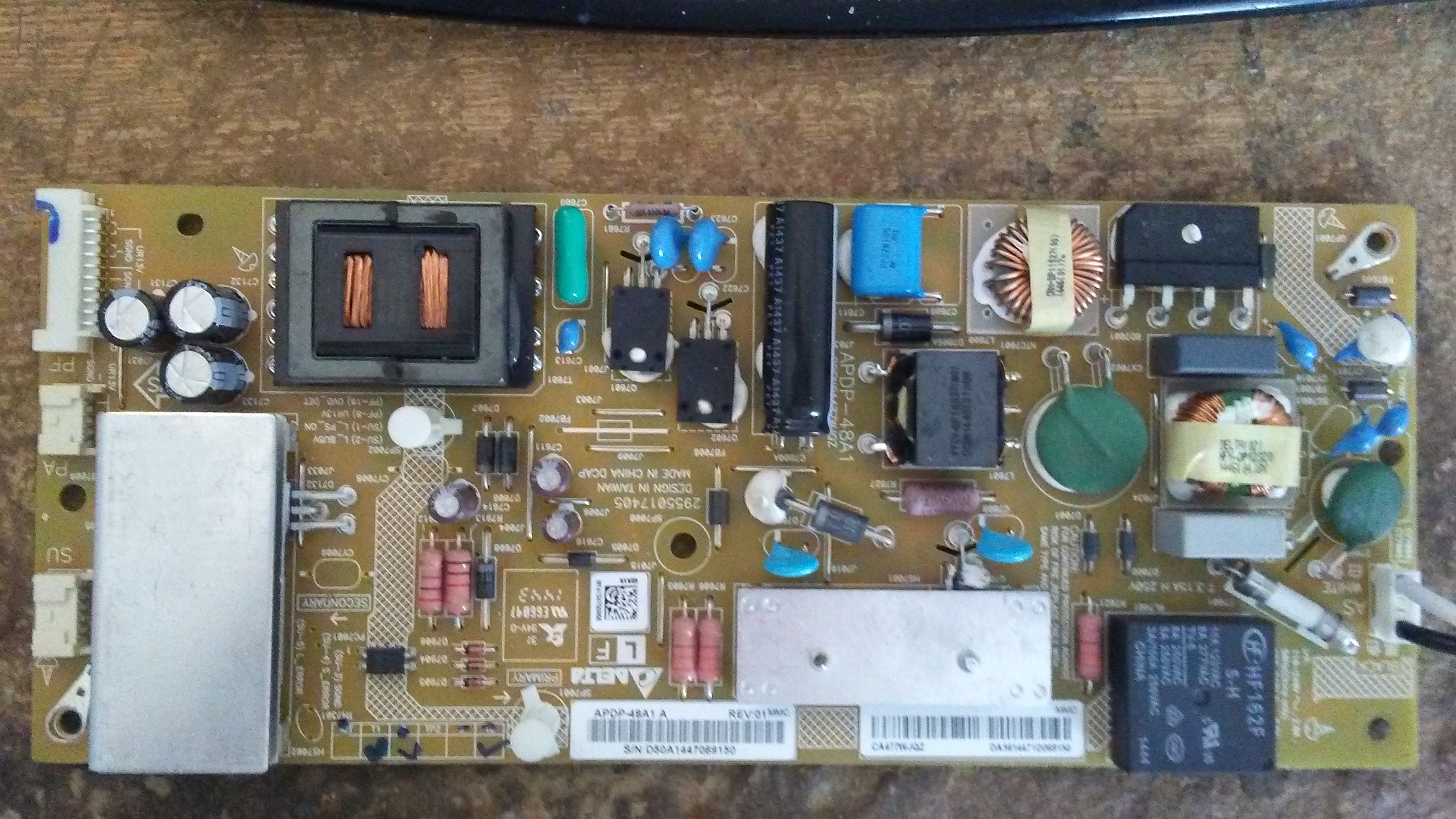

                            Thats the power supply
                            • vinceroger69
                              • Mar 2012
                              • 6714
                              • uk
                              the picture is no good to help fault find as when we zoom in its to out of focus whats the psu board number?
                                All I asked so far are the good clear pictures of the whole back side of the TV showing all the boards.
                                The TV has two power supply boards but I cannot tell what each power supply boards are being used to for in the circuits.
                                1) How does we suppose to give help from thousands of miles away when we do not have the TV in front of us to look at so please provide good clear pictures?
                                2) To all people that ask for help, if you look at the pictures you provide and cannot read anything or see anything clearly then we can't either.

                                  +1k....We have to see if the FRC is getting power or not. DO NOT try to jump any connections to 'force' the PSU on at this time.

                                    Ok guys the problem that is causing the blinking power lights with no on is a bad low voltage regulator located at (Q7120) at the right top of the power suppl, replace problem solved.
                                        OK, Those are the power supply pictures , and Im gonna check the part you was talking about
