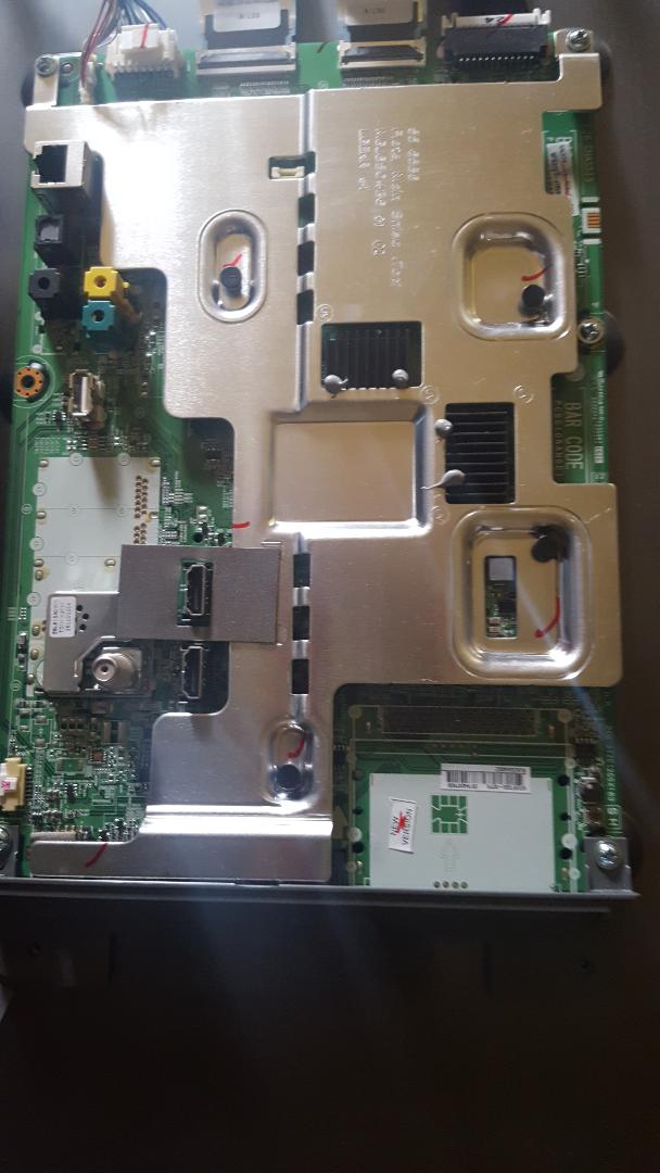

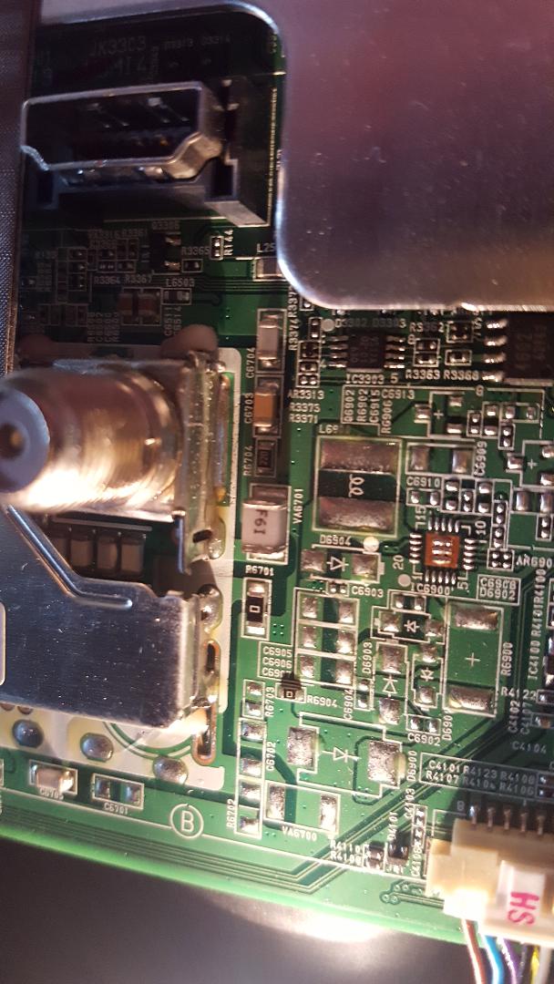

    I'm working on a LG oled with a bad main board. I found a blown surface mount fuse marked F61. Anybody know the specs of that fuse? here's a pic. It's at VA6701...thanks

    1) What is the TV model and the main board model? It does not look like fuse.
    2) What Voltage do you have at both ends with ref to circuit GND?
    3) Is one end connected to circuit GND?

      VA varistor .

            Re: Help identifying a surface mount fuse
            EAF62990001 Varistor, Sg300Q 300V 30% Or Glass Discharge Tube
            F = Type code = SG300Q
            6 = Year code (last digit) = 2016?
            I = Month code = September

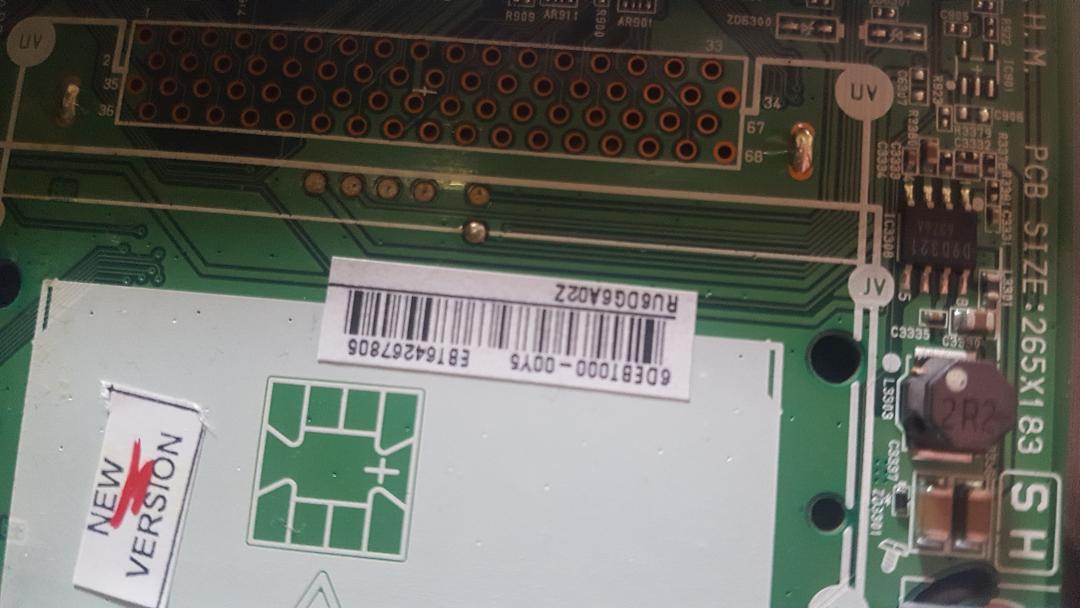

              Looks like it main board part number EBT64267805. here's a pic. No voltage on either side and shows open. here's a pic.
                It is for protection of that Tuner module in case the surge comes though the RF cable.
                  Looks like a gas discharge SMD device for surge arresting.
                  Not sure how well a little SMD like that is going to do, but nice to see that they've at least tried to add some protection on these vulnerable inputs.
                        Good news. I got this varistor in and it turned on fine. I did get a message I've never seen that said to hit the ADJ so have a LG Factory SVC Remocon remote handy. Hit the ADJ and the Tv will turn off. Then hit the power button and the Tv fires up. The remote stayed paired so I didn't lose any customer settings. Thanks R J for helping me identify it and it does act as a protection from a lightning surge through the coax and this time only took out that varistor so my customer dodged a bullet as the main boards are very expensive and had a factory back order of two weeks. That was the last thing I wanted to tell my customer right before football season starts. I almost told him the part wouldn't come in until after the first game so I could watch the game on this fantastic picture. Underwater diving scenes and the 4k Youtube video's of Costa Rico wildlife video's are very nice. Gotta get me one of these.
