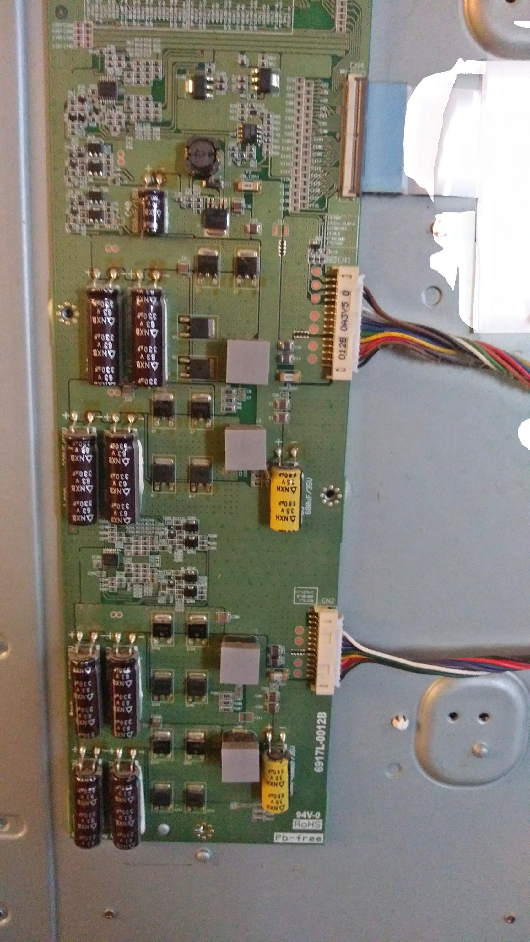

    Hi there.
    I'm having a problem with my TV turning off. It's shutting down when the LED driver board starts up. I've taken the power supply out in the hopes of finding some swollen caps, but all of them look fine.
    So I put the power supply back in and found that if I only plug in one of the LED driver board power plugs, the TV turns on and works. If I plug them both in the power supply turns off. So basically the problem seems to be on the 24V rail. All the voltages are present without the LED driver board plugged in. 5v,12v,18v, and 24v.
    My question is, what does the "slave" plug on the LED driver board do if the TV still works without it? , and do you think that replacing the caps on the 24v rail will do the trick?
    Thanks!!
    -Wade

    Can you hold the tv in front of your monitor so we can see the boards or provide some pictures.
    How many driver boards are used? Are there 2 driver boards One Master and one Slave?

        There is only one driver board.
        Here a couple of pics.. Sorry if they suck my phone is a piece of garbage.
          Re: Vizio VF552XVT Power Problem.
          Can we at least see GOOD CLEAR FOCUSED pictures of the whole backside of the TV showing how all the boards are connected together? borrow better phone?
          We do not have the TV or the boards in front of us to look at, so it is not easy to do long distant troubleshooting, pictures are all we have to go by.

            So which is the plug you disconnect that causes the tv to stay on? I don't see "slave" marked on any of them. CN?

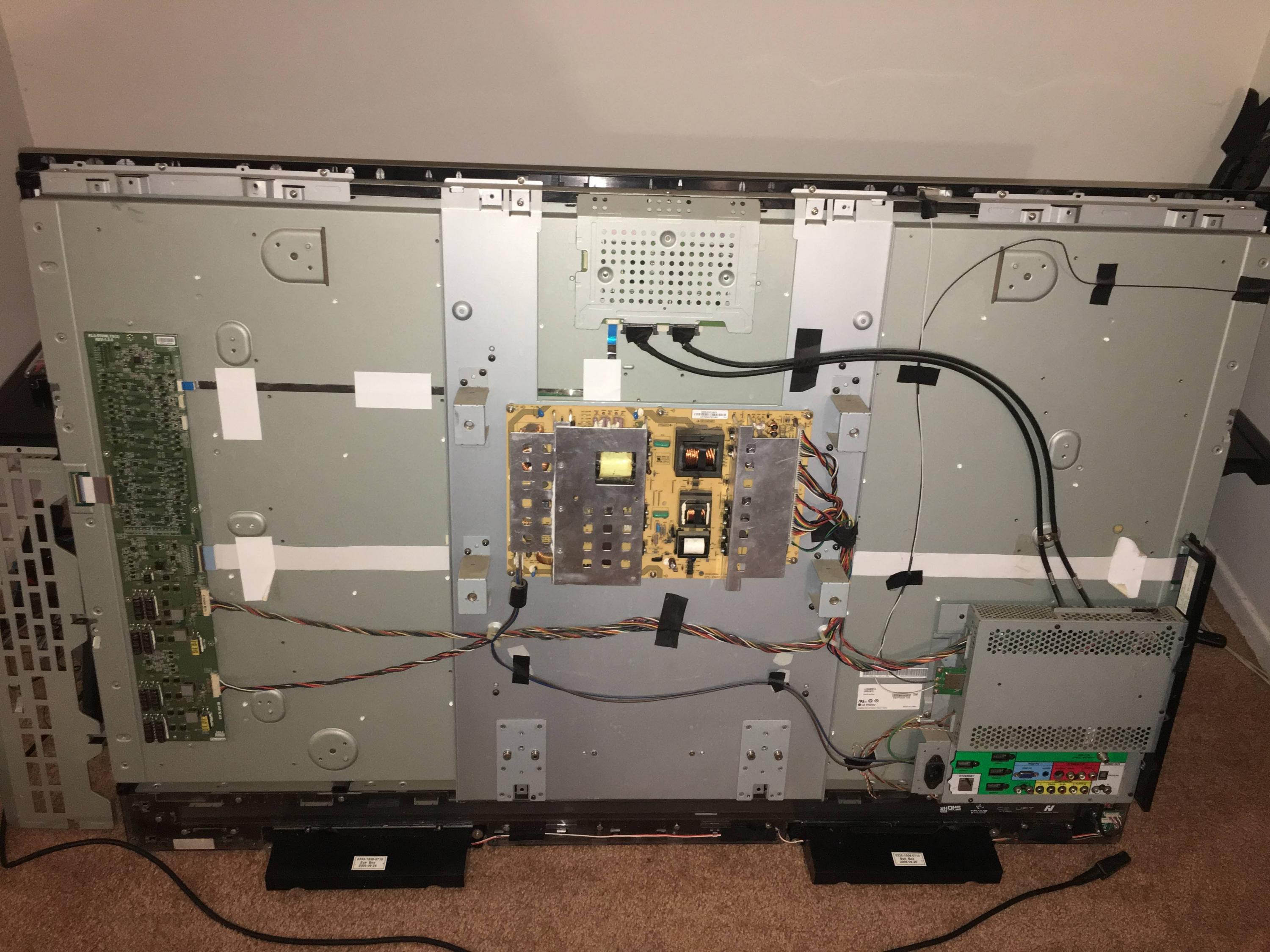

                    Here is a Pic of the back of the tv
                                So only 24V power supply shutdown but the all other power supplies still on?
                                I also want you to try this: get the backlights to come on then go to the on screen adjustment and then turn down the backlights level (not Brightness) as low as possible on all inputs, then turn off the TV and connect all the cables back in the LED driver board and see if the backlights will come on and stay on.
                                    The 24V has its own power transformer T1 for making the 24V.
                                    The 12V and 18V are generated by another transformer T2.
                                    The standby power supply is generated by transformer T901.
                                    So something is not right that the 12V/18V section gets shutdown too.
                                    You may want to monitor the PS-ON pin to see if it drops out when shutdown happens.
                                    The power supply also PFC Voltage booster circuit that you should also check the DCV right between the two legs of the main filter cap to see what happens to that boosted Voltage.
                                    This is your power supply, right?
                                    http://www.shopjimmy.com/vizio-0500-...pply-unit.htm#
                                    Vizio 0500-0507-0670 (DPS-450RP A) Power Supply for VF552XVT
