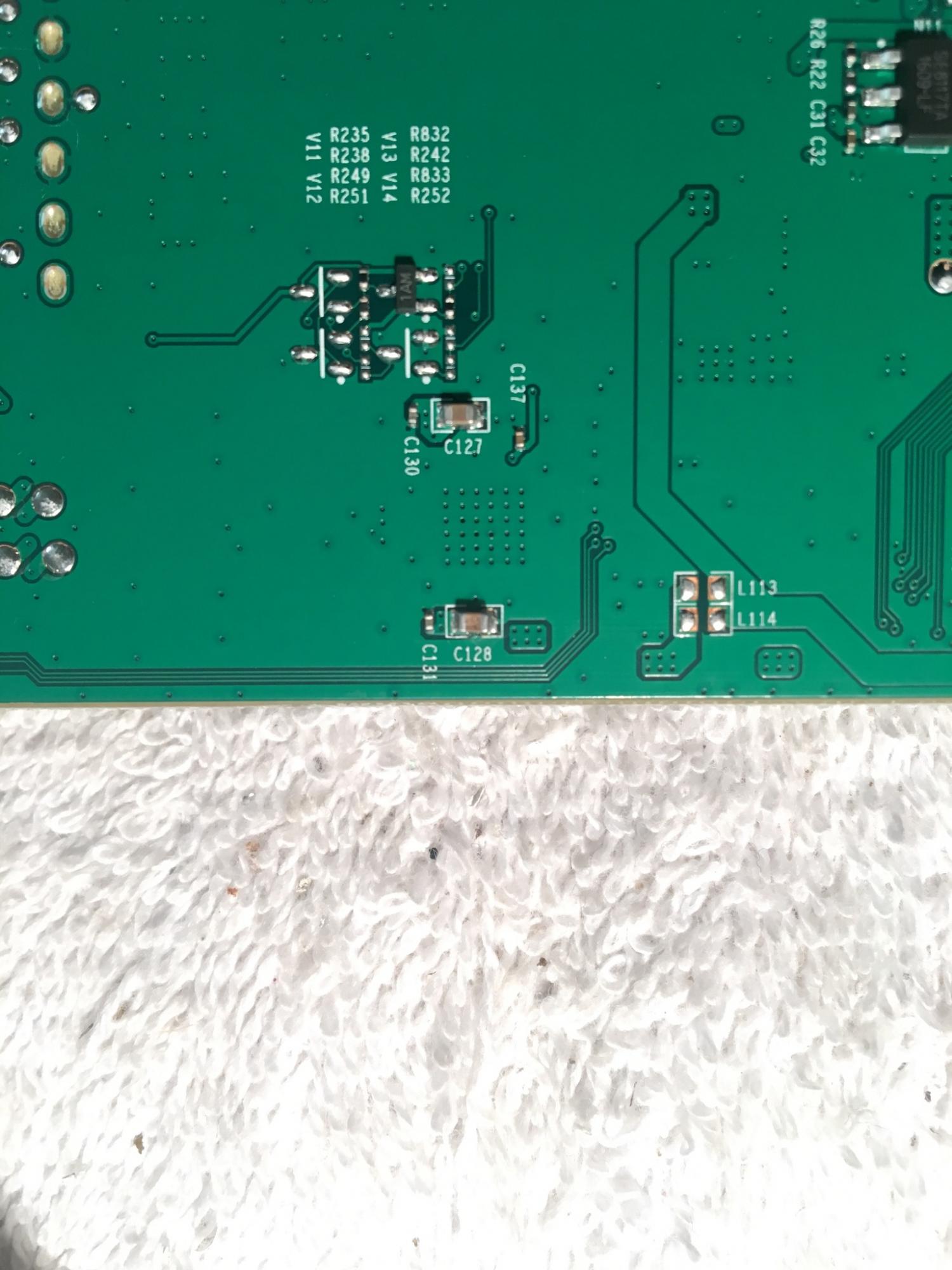

    Those caps for the PVDD pins were so incredibly small. Seriously doubt I have the skills to replace. Can I go back with a electrolytic making sure I have polarity correct? Thank you

      Both sides of L37 and L108 show a short to ground. What next? Thanks budm!
      Remove L37 first and then check both empty pads of L37 to see if shorts goes away, if not then remove L107 and test the empty pads of both L37 and L108 to see if shorts will be present or not.

        Removed L37 and had a dead short on both pads. Removed L108 and only had a dead short on the two L37 and L108 pads on the AMP IC side, closest to the large SMD cap C2. Thank you budm.
          Re: Sharp lc-55n620cu no sound
          OK, so if you check the resistance on the burnt out MOSFET Drain, the shorts should now be gone.
          I have you done this test to verify for sure that the shorts is in the Amp section. I would remove the caps first, removing the IC will be harder because it has exposed pad that is solder the copper plane to use it as heatsink.

            I do not have a short on MOSFET drain now. I have previously removed C121 and C141 caps output of PVDD pins and still had a short. On the bottom of the board I have two caps C127 and C128 that show short. I'm going to remove those and see if the short goes away. Divide and conquer! I'm including a picture of the area. The dotted square is under the AMP IC. Hopefully that will be the culprit. Thanks for hanging in there budm!

              C128 was the culprit. No more shorts to ground after removal!! I took a look at it after I took a picture with a magnifier and noticed a slight defect. Removed it first and now no more shorts! Thank you so much for helping me through this budm!

                So the problem was a burned MOSFET N104 near plug XP1 on the top of the mainboard and a bad SMD cap C128 on the bottom of the mainboard near screw ground S1.

                    I am glad it is not the IC. Hopefully when you put in the new MOSFET sound will work, then you can remove C127 to check the capacitance which I believe to be the same as C128.

                      What should I replace the tiny SMD caps for the PVDD pins for the AMP IC. C128 won’t be a problem. It’s larger and easier to replace from a donor board. I’ll remove C127 and verify capacitance and replace it with the same. Would electrolytic be an option? I’m glad it wasn’t the IC too. That would have probably been beyond my abilities if I could have even got a replacement! Thank you

                        Those small cap may be 0.1uf caps. Do you have cap meter to check the capacitance? The Voltage rating should be 35V.
                        c127/128 (probably 22uF) you may be able to get away with low ESR lytics type cap 47uF 35V rating.

                            I checked the two small caps for the PVDD pins and they were .1uf. Removed two from a donor board that were the same just slightly larger so easier to install. They were .1uf and 50v rated according to the schematic for the donor board. I installed a new MOSFET N104 and replaced C127 and C128 with two tantalum 106 caps. Checked C127 the good cap and it was reading 10uf. Verified my connections with my meter. Everything looked good. Plugged tv in and powered it up. No sound but it powered up fine. Reading 21.6v on all 4 of the PVDD pins going to the AMP IC just no sound. The short is definitely fixed thank goodness. Just following up on my progress. Guess I have more work to do. Thank you
