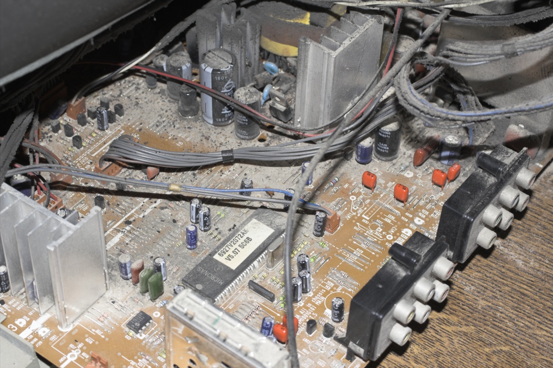

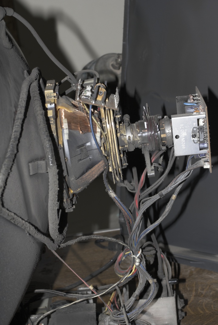

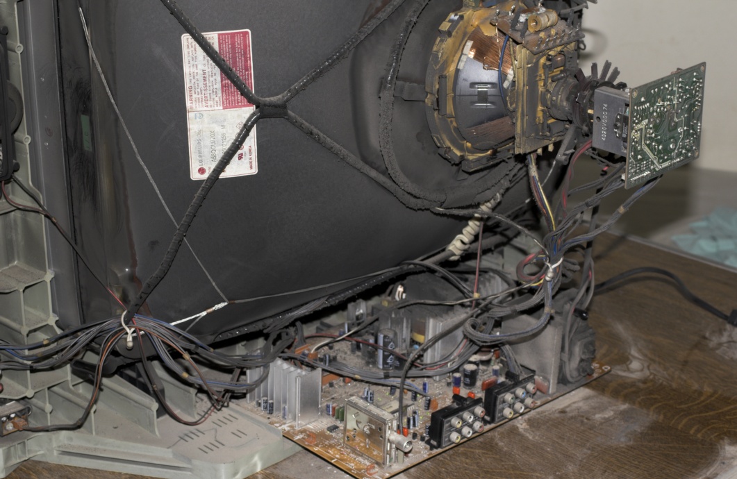

        Re: Weird 29" LG Flatron Problem

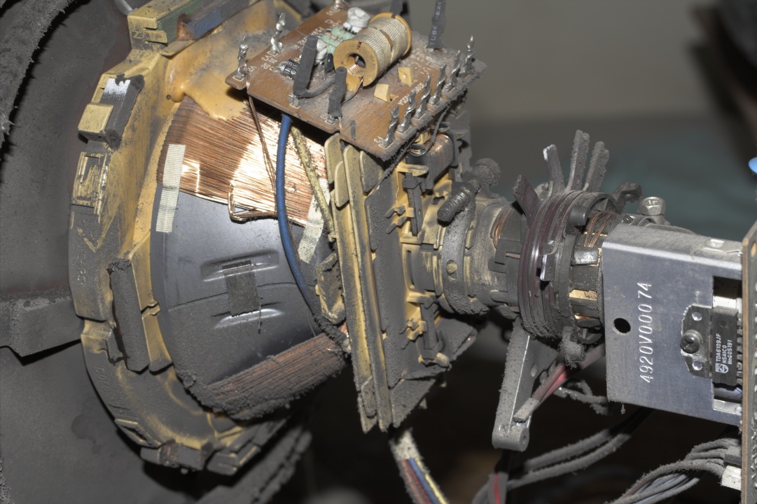

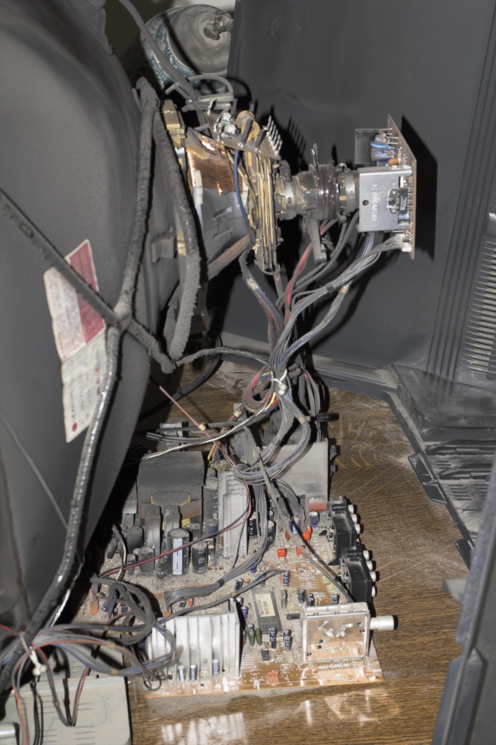

        Sorry I forgot to post the photos
        here it is
        including the model #
        but what about that electric shock very high noise?does not say anything?
        also the sequence in which the case happened?
        I would really like to fix it, the TV set has a very good bright picture, so I am assuming it is has not been used that much
        and yes I think the cap was not the prob at all
        but I changed it because many said a domed cap + turning off by itself means a bad cap
        • dick_barton
          • Aug 2015
          • 6643
          • Wales
          Can you check out how close the schematic is to your set. The power supply may be similar. See page 34
          The set is so dusty it's difficult to see any components markings. Also if brushed out you may see where the electrical smell / burning was coming from.

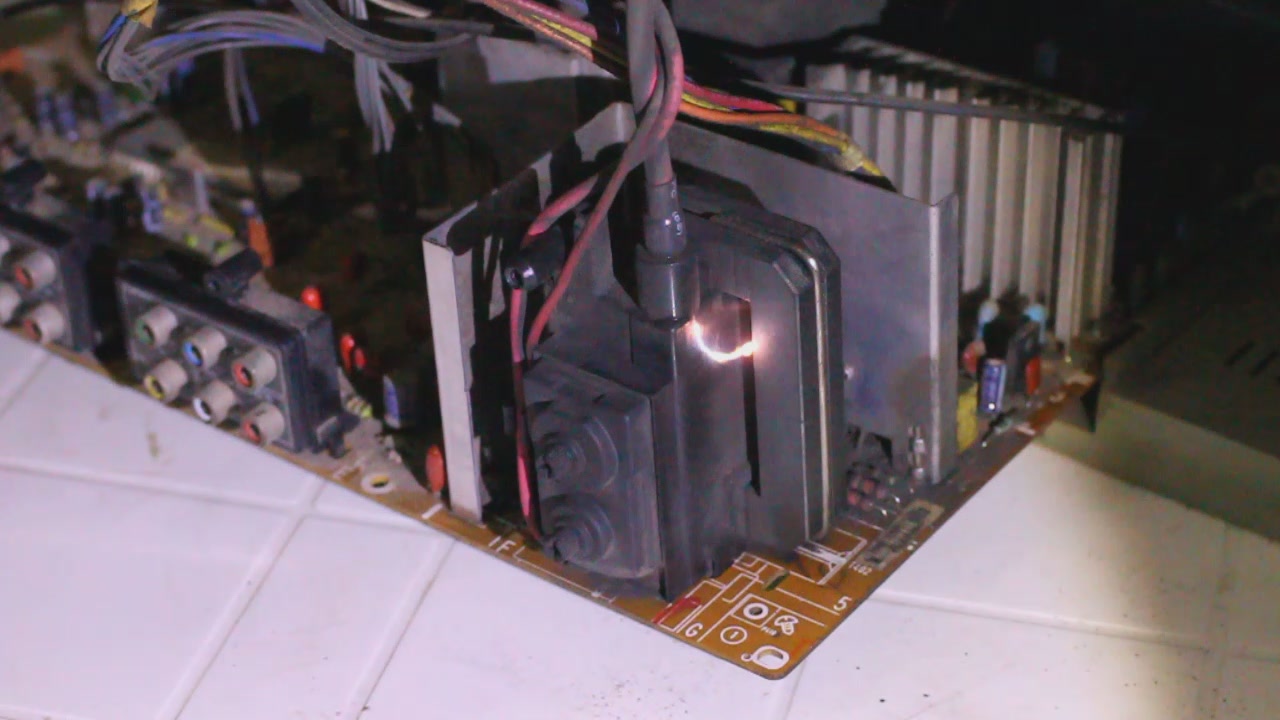

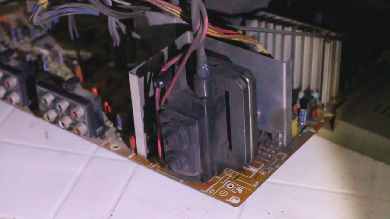

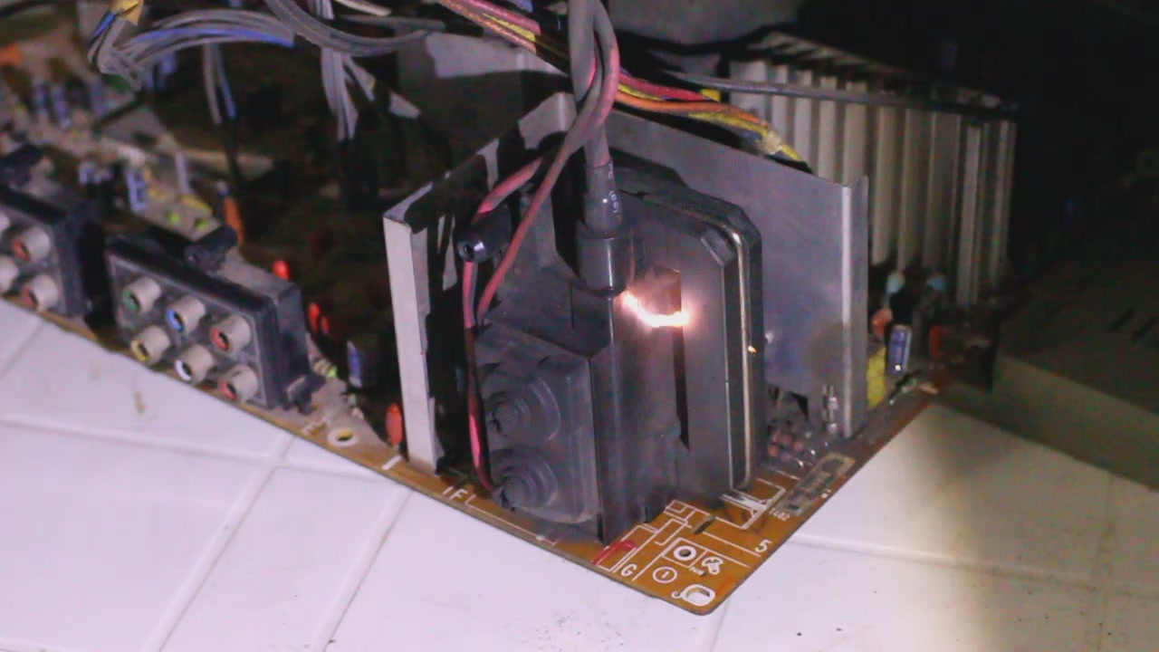

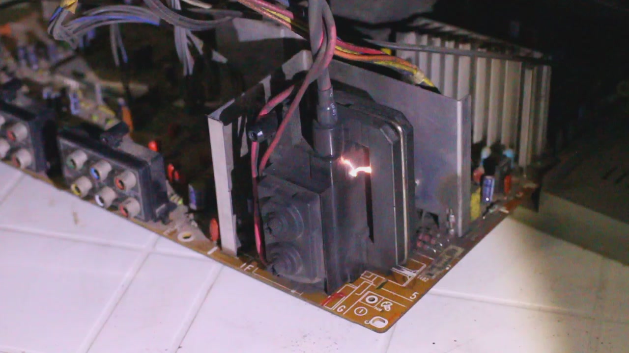

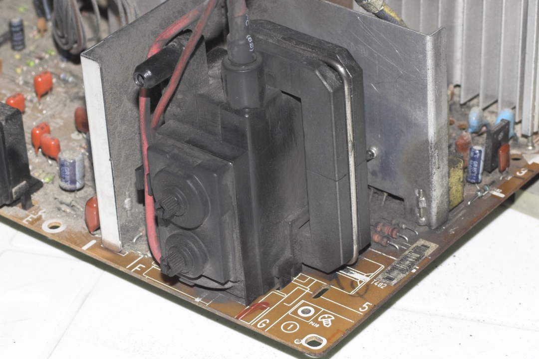

                                    • GraphicMan
                                      • Aug 2018
                                      • 124
                                      • Egypt
                                      I think it is clear now
                                      I have already recorded a video but for ease i am uploading this screenshots of it
                                      the sound is much less without the cover, seems like the cover was scaling it a lot
                                      the arcing is coming out from the flyback transformer as few members said (many thanks to them)
                                      I have also uploaded a clear pic for it, I cant see any cracks, it look so new!
                                      what do you think guys?!
                                      • petehall347
                                        • Jan 2015
                                        • 4448
                                        • United Kingdom
                                        that is cracked or lost its insulation .. new fly-back will likely be expensive if you can even find one .. i used to scrap sets with bad fly-back transformers as they simply wasn't worth spending that sort of money on .
                                        you may get lucky and find a new one cheap enough .
