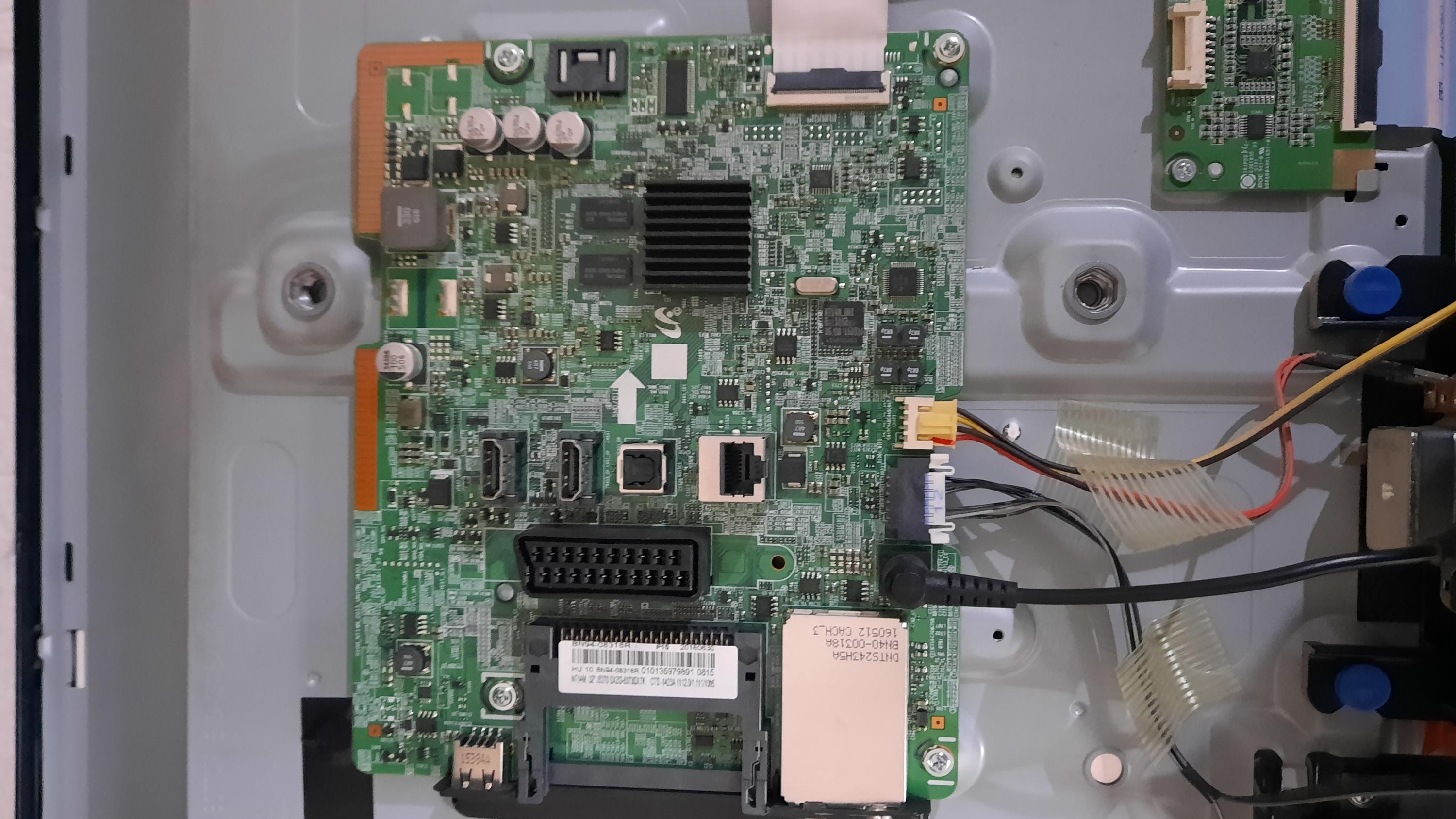

    Hi all, first time seeing a LED problem this weird so I wanted to discuss with y'all before handing back this TV to my costumer.
    This TV came to my shop with no picture but sound present. So I thought ok this must be a LED problem and I shine a light with my phone's torch amd and yup I see the image. So I disassemble it and before changing the LEDs I check the motherboard voltages (this unit works with an external 16V DC brick) and I see 54 volts at the input pin of LED strip, considering this TV has 2 strips of 7 LEDs which at 3~ volts it must be equal to like 42 volts. I remove the power and power the LEDs with my tester and they all shine ok at arounf 42 volts. Next thing I power the TV confirm that there's a picture which is dim and while the TV is still on I inject voltage into the LED strip and they all shine bright.
    Next thing which is what's bothering me that after I remove the tester probes LEDs continue to work!! And now they're at the correct voltage which I assume aroubd 42 volts. I tested it likr an hour and it still works.
    So what was the problem? I don't get it did I kick started the led driver circuit by injecting voltage? Is this now ok to hand it back to the costumer or should I replace the LED strips anyway?

    Replace the led strips.

      if you have a backlight setting on this one play with it, turn it way up test it for a while, turn it way down test it, if no backlight setting use the brightness the same way, see if there's any difference, like it shuts off or something with it turned up but not as fast or does not with it turned down, if you have a bad led/s it should make itself known with the backlights or brightness turned way up, but I wouldn't leave it turned way up for normal use, it just puts unneeded stress on the backlights.
