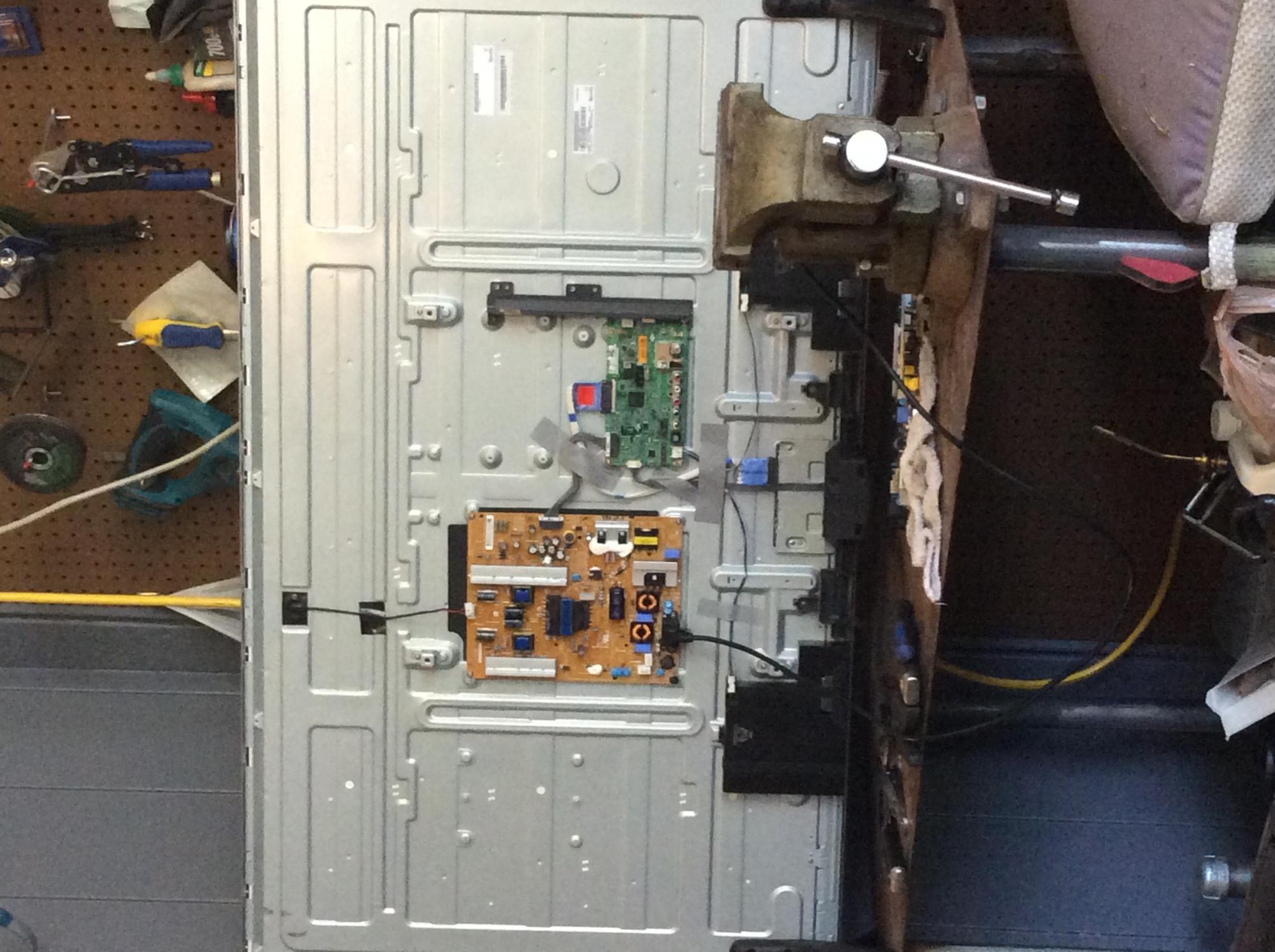

Need help! I have an LG tv that's flickering. The model number is 55LB5900. I have replaced the power supply board & mainboard.

You probably have a led or two that are shot. You'll have to open her up and check the leds. I just finished repairing an LG 47" with exactly the same problem and it had 4 leds that were the problem - 2 burnt and 2 shorted.

You will get a lot more help if you upload pictures.Never stop learning

If you turn on the TV in the dark room and watch backlights coming through some of the holes on the back of the panel, do you see the backlights flicker?Never stop learning

You have two strings of LED so there are two pair of wires so check the DCV on all 4 pins of the LED connector to see what Voltages you have against chassis GND while the backlights are flickering.Never stop learning

Thanks for your help. I just realized I have managed to crack the screen in the upper right hand corner. I’m currently looking for a way to repair it but I know that’s a needle in a hay stack. I have been having bad luck all dayComment
