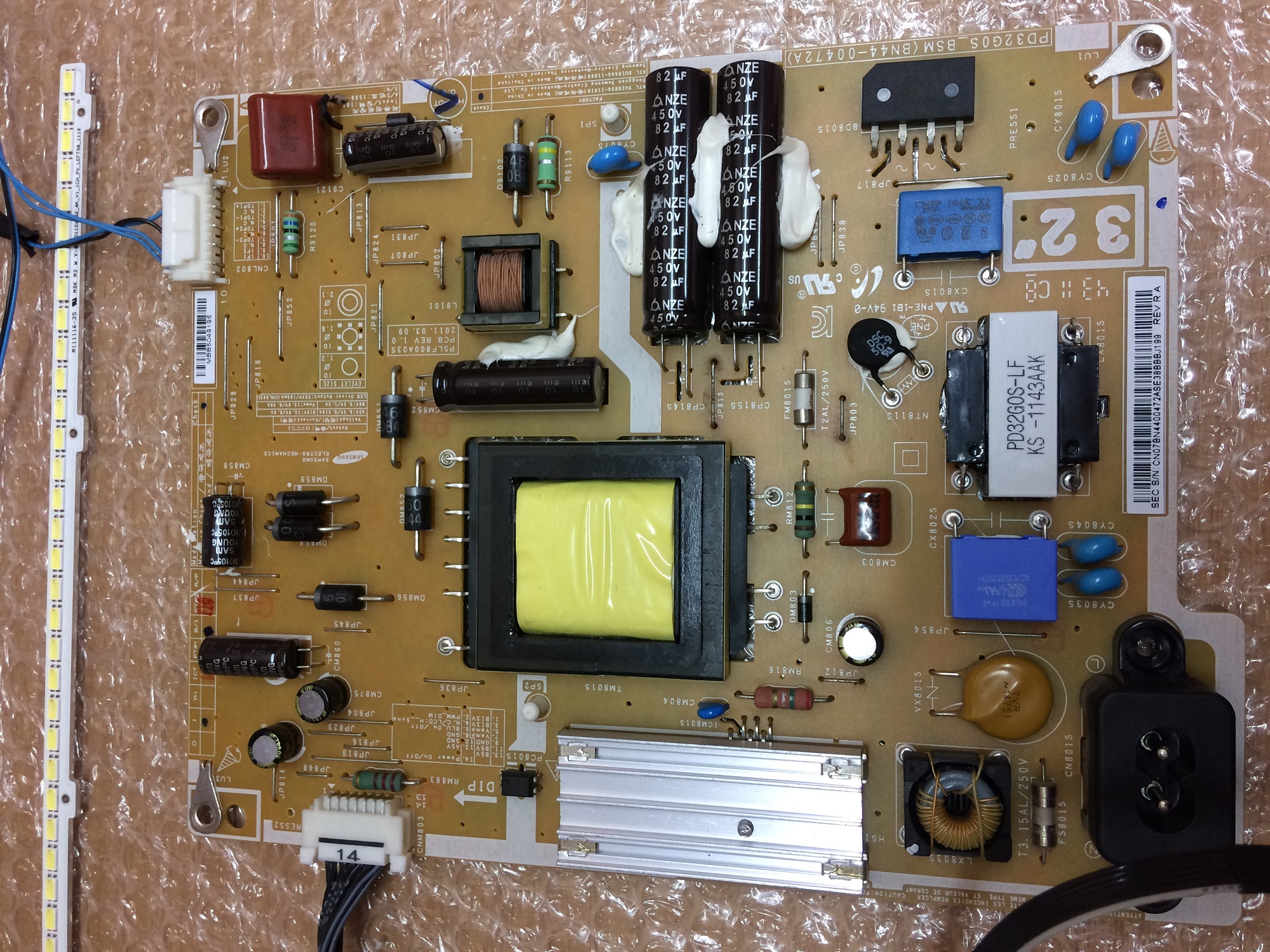

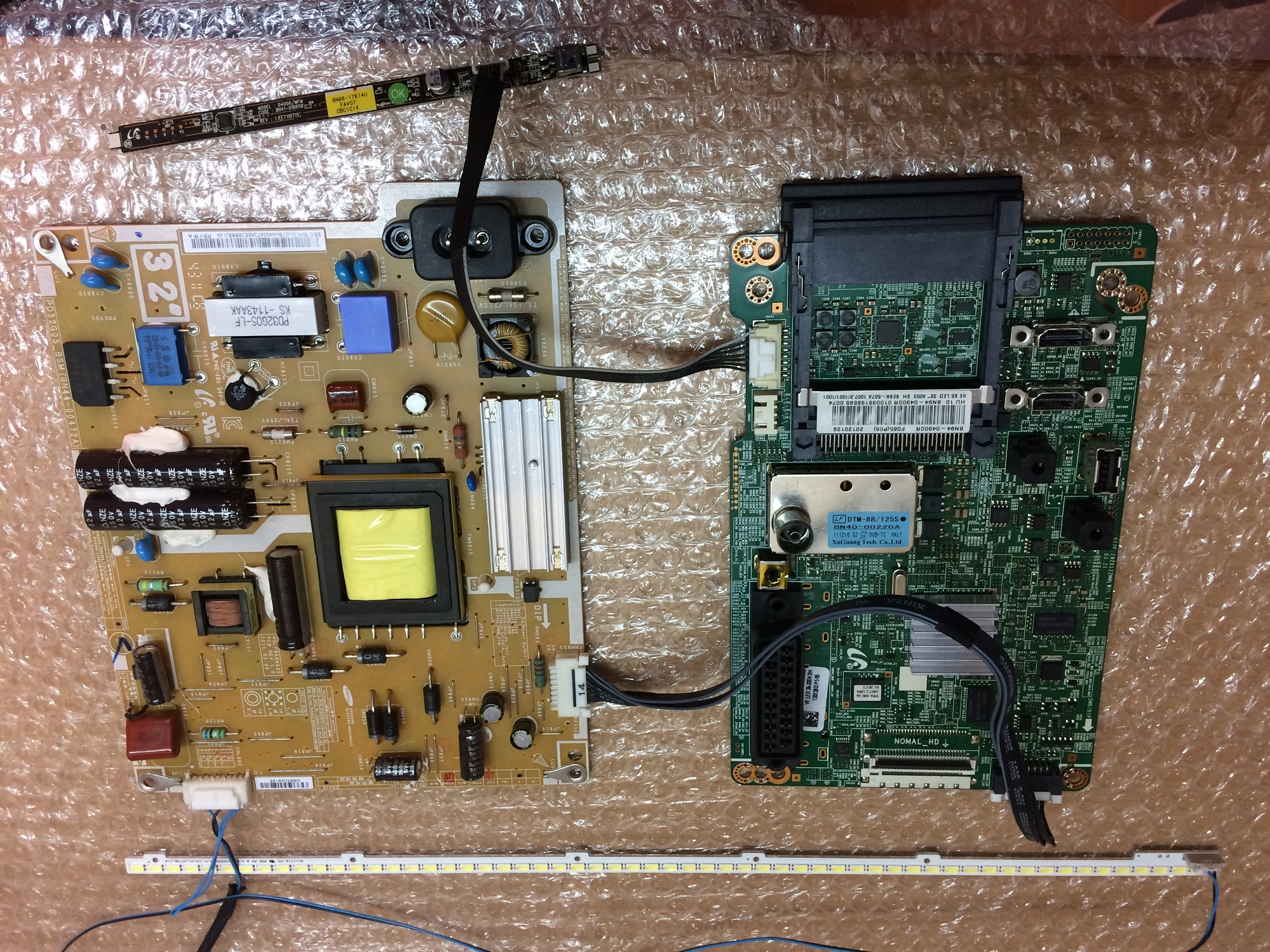

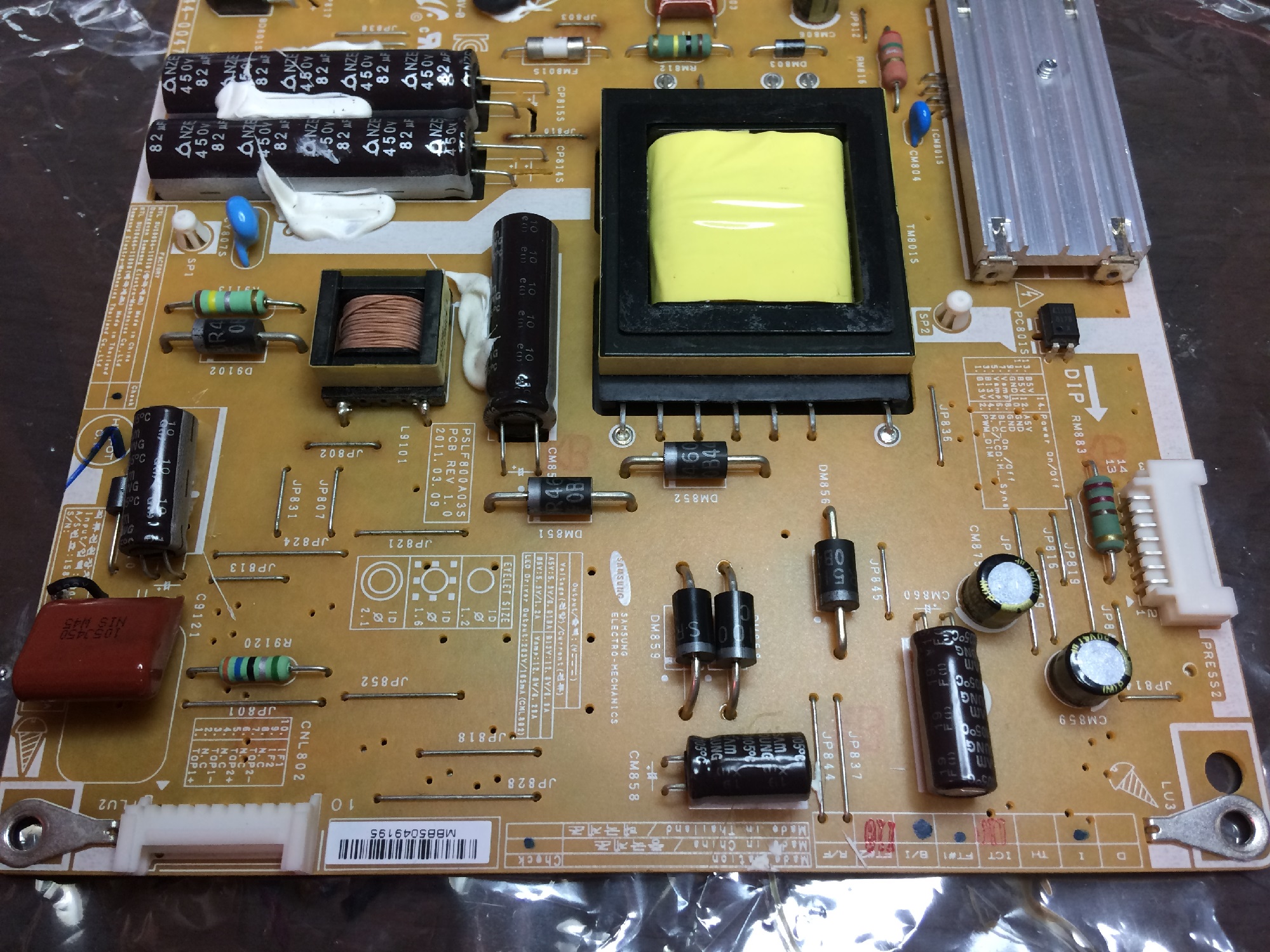

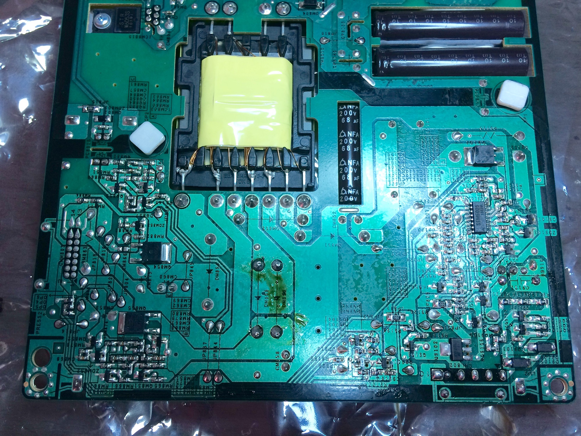

    Re: Samsung UE32D4003BW Backlight problem.
    Here are a couple of closeups near the led output socket....

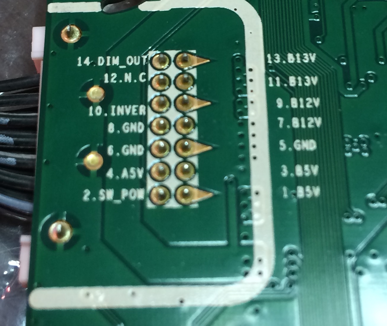

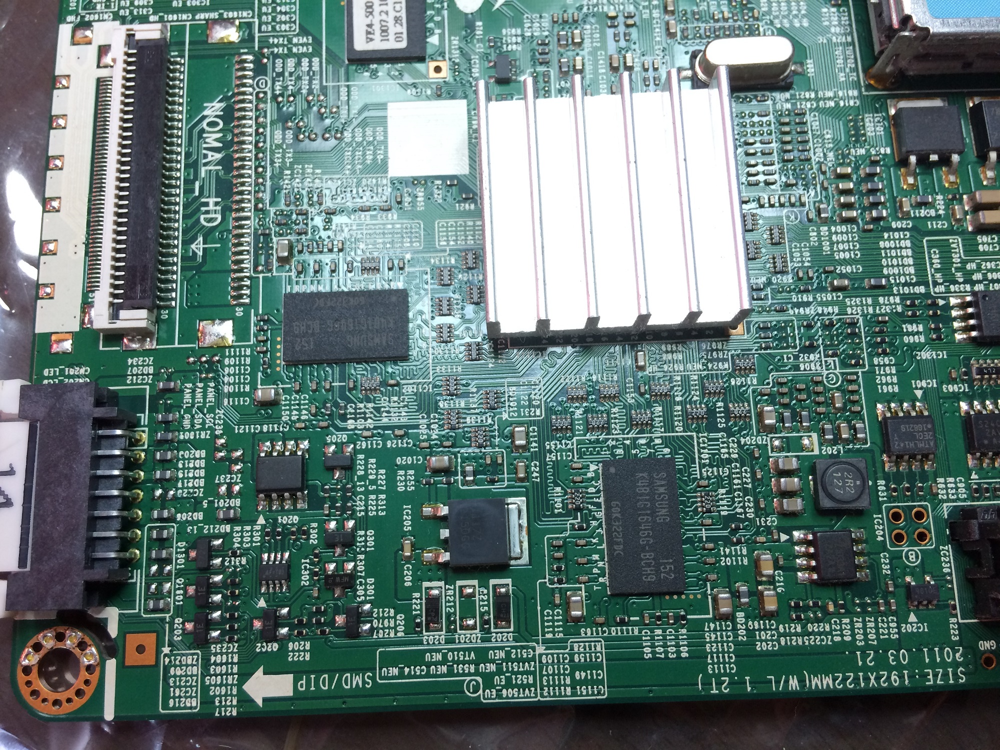

                                Here is another find....
                                The pin 14 on the main board (Dim_Out) , outputs 1V volt when I turn on the TV, but drops to 0,3 after a second and stays there.
                                All the other functions are working fine.
                                How can I manually output 1 Volt there??
                                Here two Pictures under and over the board zoomed near the plug.
                                  So right now you are able to get the backlghts to come on and able to see image on the screen, and get sound, etc. correct?
                                  If you go to on screen backlights level adjustment (DIM), can you set the backlights level at all?
                                    I have cut the Dim_Out cable from the board to the PSU and I have reassembled the TV .
                                    The TV works with max backlight, a solution that is not perfect, but I am OK with...
                                    All the other settings except brightness, like sound, colour, etc. work fine....
