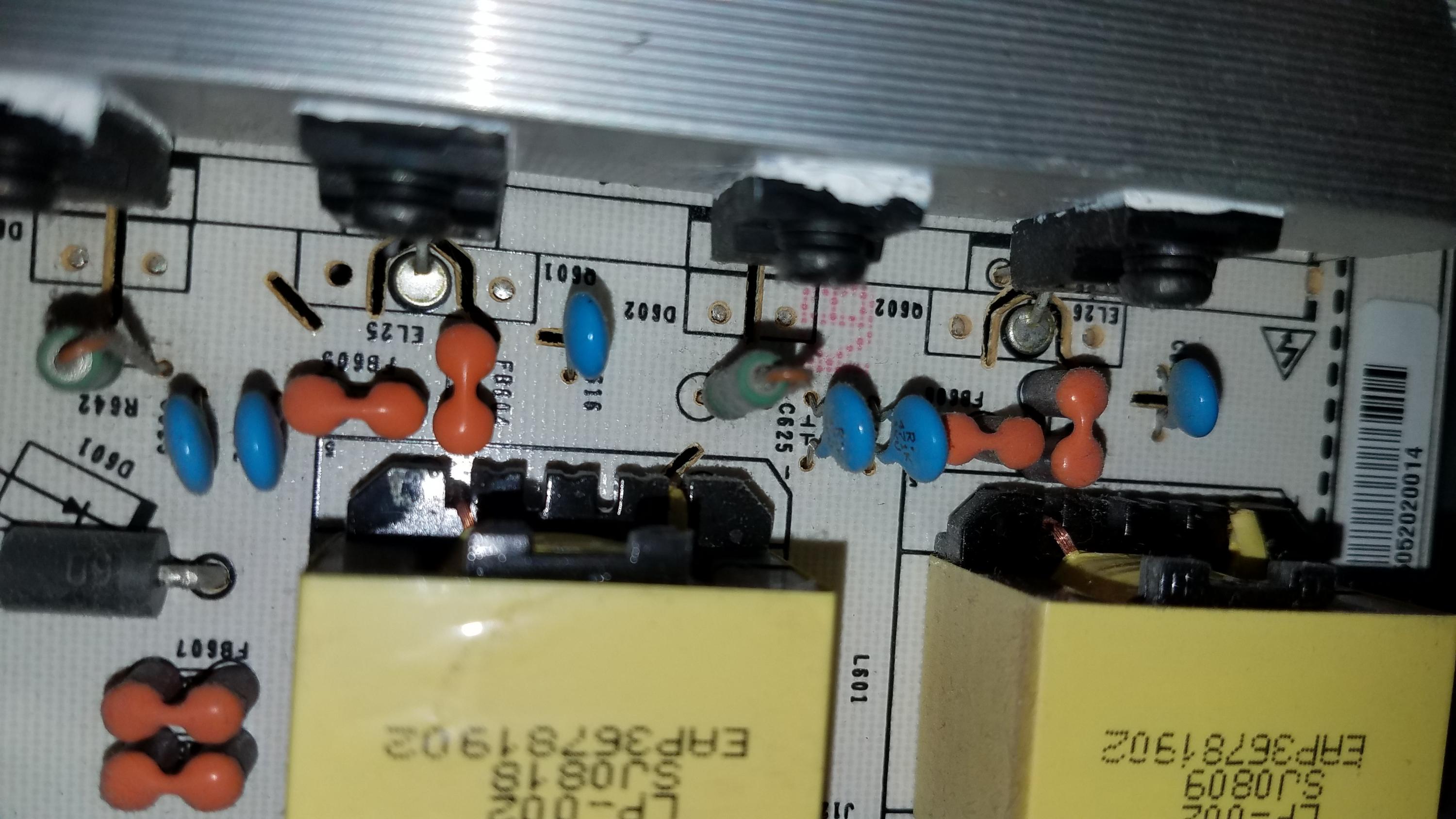

                                      Can you inspect the blue polymer caps on the psu next to the transformers on the bottom left hand side? Look for any signs of damage.
                                      • Daveleone
                                        • Apr 2016
                                        • 267
                                        #39
                                        Re: LG 42LG50 no backlight or display
                                        I gave them a look over. No visible damage.
