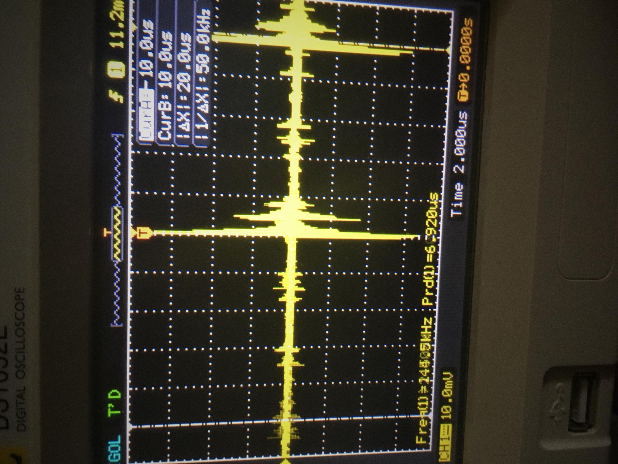

    Hi Everyone,
    Trying to diagnose a TV that does not power on. The crystal clocking the main application processor looks suspect to me, I have attached a pic of what my scope is detecting on the crystal pins.
    This should be a 54mhz device, but obviously isn't running properly.
    Before I order a replacement part, is there anything else I should check that might be causing this erratic clock signal?

    If you have already checked that all the voltages at the source and they are fine also if you checked all the voltages of the dc-dc converters and voltage regulators of the main motherboard and they are fine then yes

      Using the oscilloscope to measure the crystal I much doubt would work since the scope probe capacitance and impedance will load the crystal.
      You could look to see if any of the pins of the IC are clocking a decent waveform.
