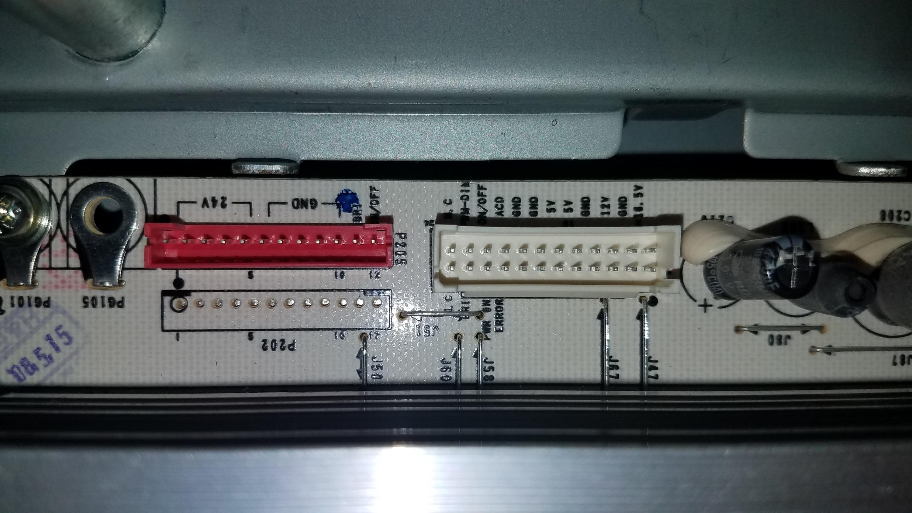

    Hi all! I have an LG 42LG50 that, when plugged in, shows a flashing red LED on the front, then the backlight flashes for a brief moment, then the front LED turns a very dim blue. (similar to this thread: https://www.badcaps.net/forum/showthread.php?t=52947)
    Here are the connector pinouts with [expected voltage when on]:
    P201
    (left pins)
    23 N/C
    21 BR1 [1.7v]
    19 PWR_ON [2.8v]
    17 ERROR [0v]

    I've checked the voltages at the power supply during power on, during the time when the backlight flashes, and after the backlight flash. As a convention, if I've listed a single voltage, that means that voltage is stable throughout the startup process. If I list multiple voltages it means the voltage changes during the cycle, with the format Vpower on->Vbacklight flash->Vafter backlight flash. I've underlined the values I think are suspect.

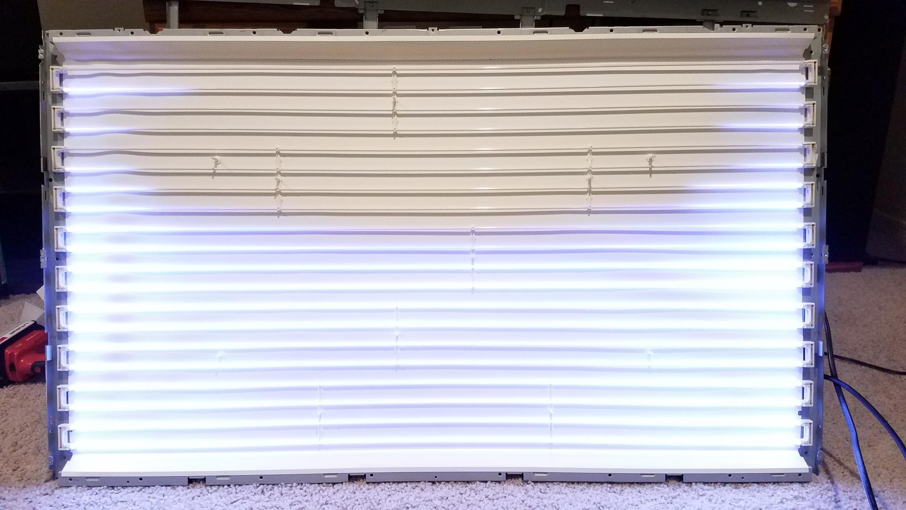

    • I took apart the panel and was able to see all of the CFL tubes light up momentarily, so the CFL tubes themselves seem ok. (I've attached a 2 jpg sequence of the bulbs powering up)

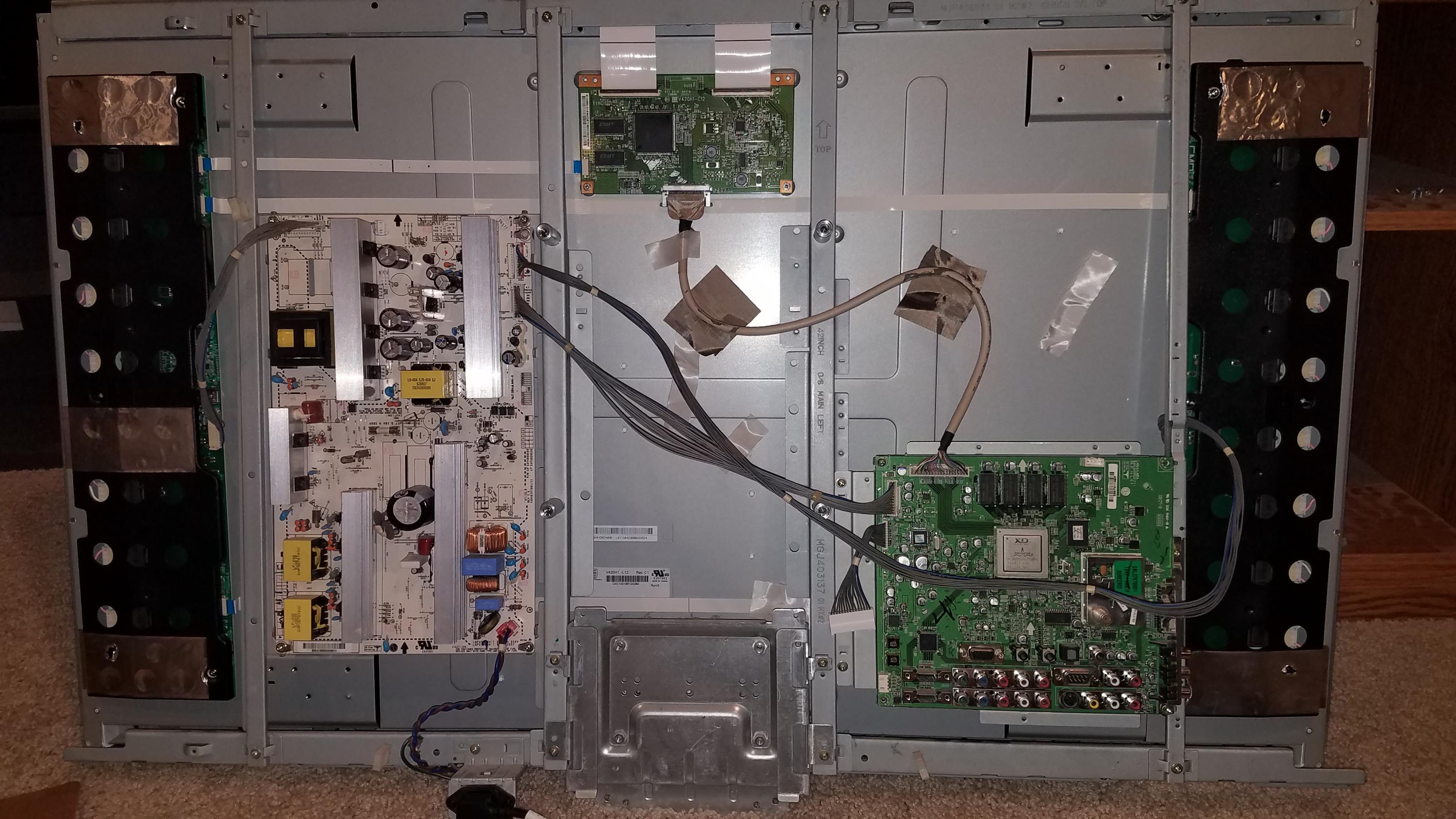

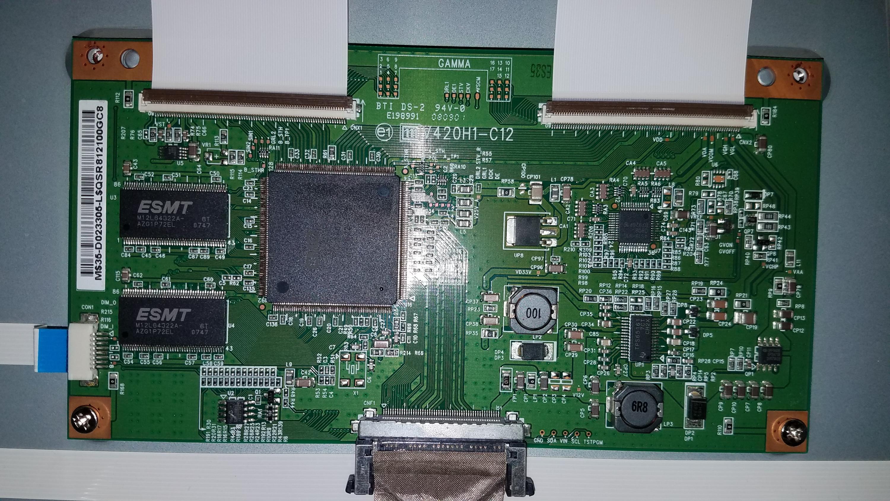

    Check the T-CON Bd. The little white fuse might be open due to a shorted component on the T-CON Bd. Are there a blue LED on the Inverter section that comes on and then go off? Also are there any blue LEDs coming on, on the T-CON Bd.?

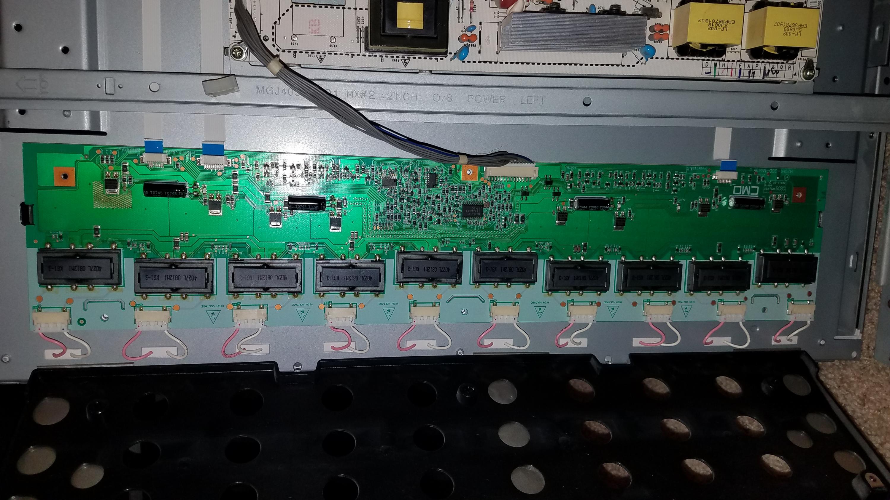

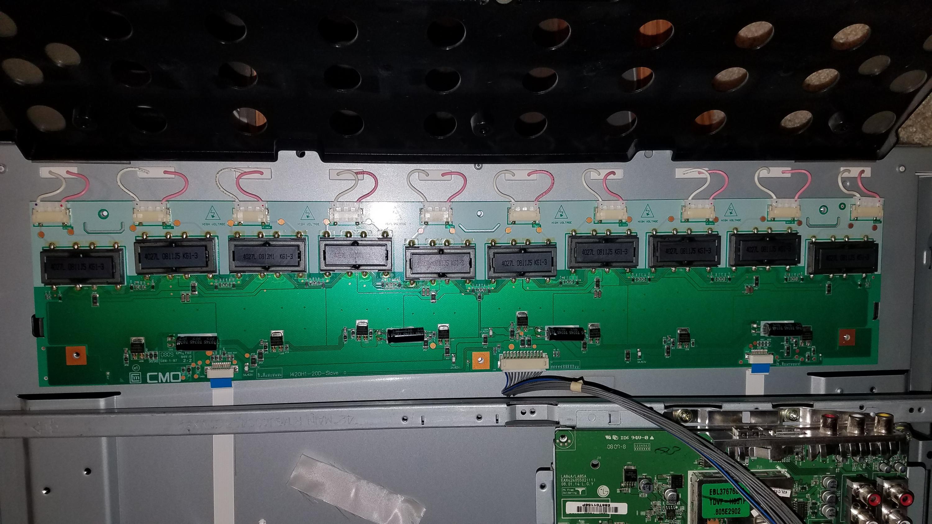

      You need to remove those two black shield from the inverter boards so we can see what they look like and how they are setup.

              Re: LG 42LG50 no backlight or display
              Check and compare the output winding of the ccfl transformers on the inverter board with your DMM in Ohm mode. They have to be within 3% of each other.
                Pics attached.
                Could you please point me to the points I should test in the attached photo?
                Andrew - In the attached picture is the correct fuse the one marked FP1 on the attached image? That fuse tests GOOD. I didn't see any LEDs turn on on either the T-Con or the Inverter boards. The only LED I see is a green LED on the main board. It stays lit as long as power is applied to the TV.
                Thank you all for all the help!
                  Are the desired test points the copper pads next to each CFL connector? If so, the resistance between those are all in the range of 3.28-3.31kohms.

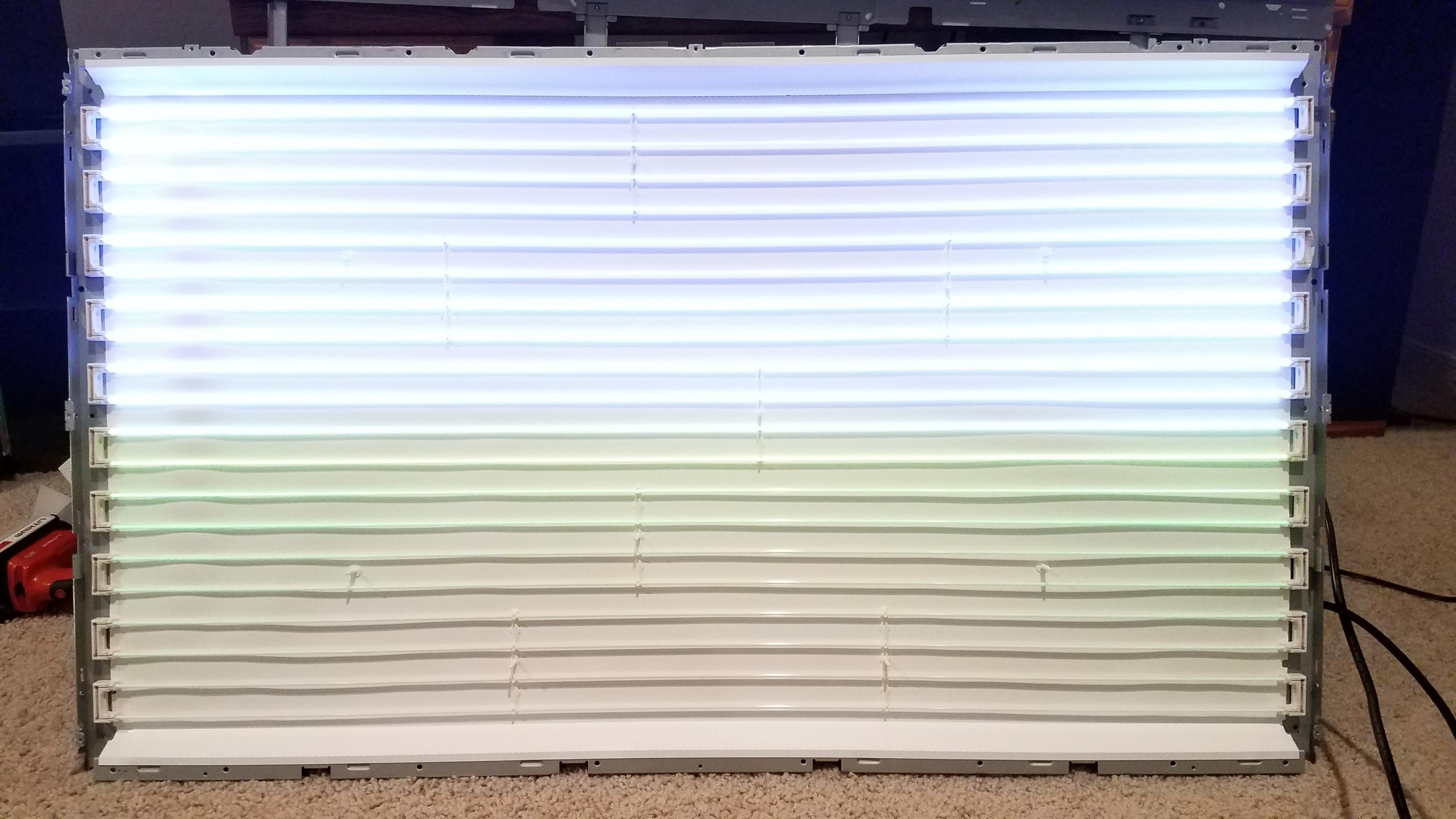

                        Disconnect the ribbon cable which connects the T-con to the inverter and see if the backlights will work.
                        ------------signature starts here------------
                        • Daveleone
                          • Apr 2016
                          • 267
                          They do!
                          With the ribbon cable from the master inverter to the T-Con disconnected, the backlight stays lit (The cable from the main board to the T-Con is still connected). Of course, there is no picture on the screen.
                          What does that mean? Does it mean the the Master & Slave Inverters are ok and we can narrow the root cause down to T-Con, Main Board, or LCD Panel?

                              I had an LG 42LB5D, which is very similar, and it worked the same. I think I replaced the T-con on mine, but it was so long ago that I can't remember. Someone with a bit more knowledge than me will probably be able to tell you how to determine if it's the T-con or the master inverter.
                              Main board is probably OK. Power supply is OK. Slave inverter should be OK. This narrows it down to T-con and Master Inverter.
                                That T-CON controls the dimming function.
                                Since you can remove that cable and able to get the light source to come on, so if the main board, t-con, and panel are OK then you should see pictures on the screen.

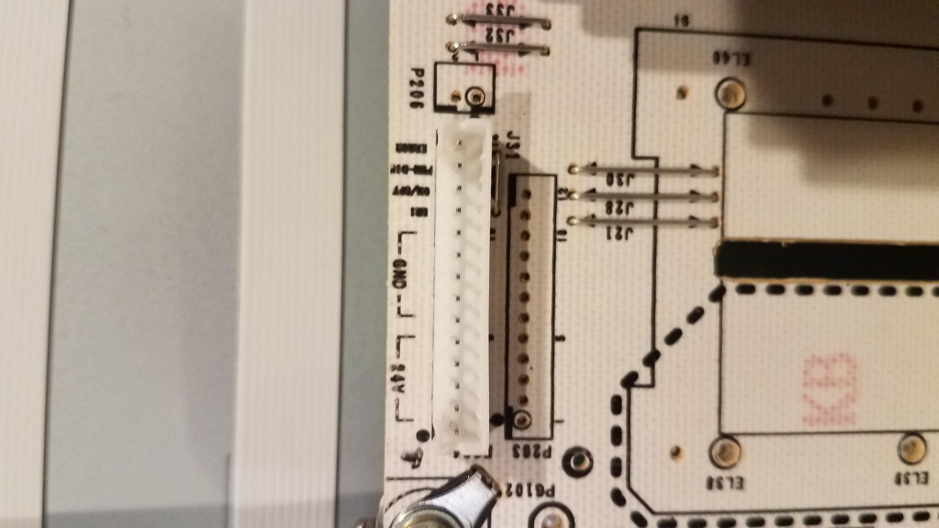

                                  On the T-Con the connector is named CON1
                                  On the Master Inverter, I don't see a name, but the connector pinout:
                                  DIM_OUT
                                  GND
                                  GND
                                  GND
                                  GND
                                  GND
                                  DIM_IN
                                  E1
                                  budm, do you think the Master/Slave inverters are ok? Or could the problem still lie in the Master inverter? If it's for sure the T-Con, main board, or panel, how to determine which?

                                        I suggested looking at the T-CON Bd. in post 32 of this thread. I am still thinking the T-CON Bd has a problem. Yes, probably dry solder joints on the T-CON and Main Bds. as lookimback suggests.
