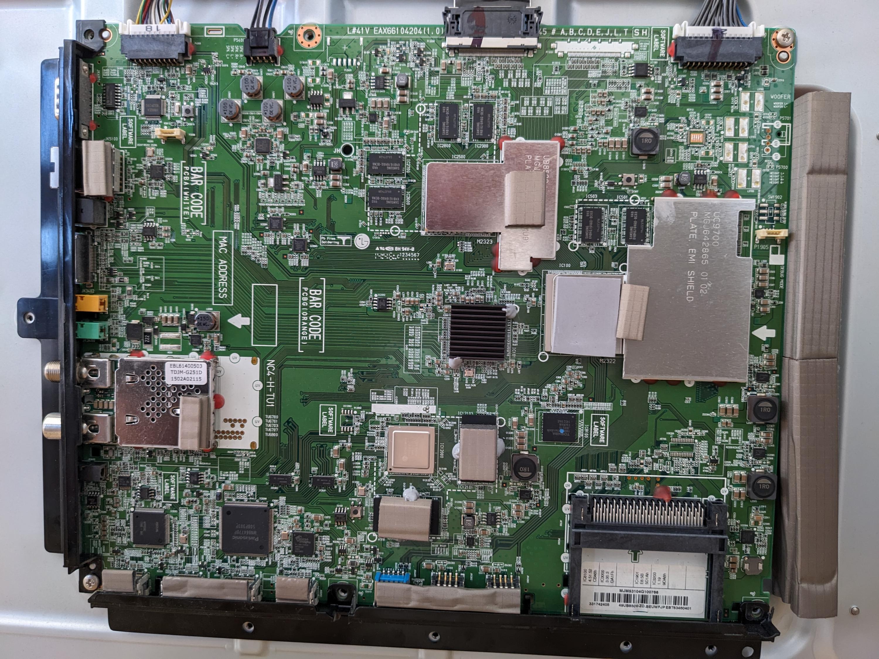

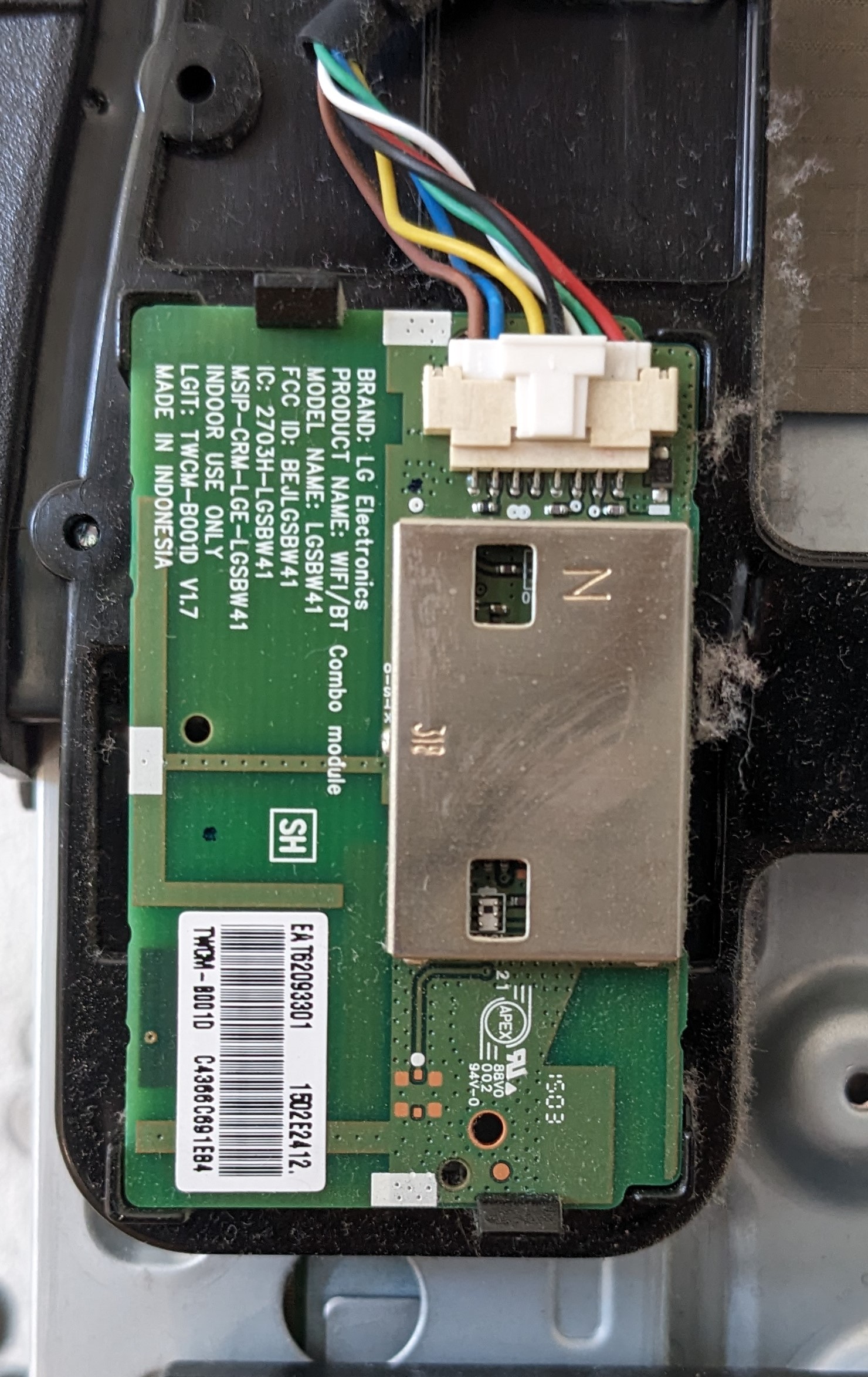

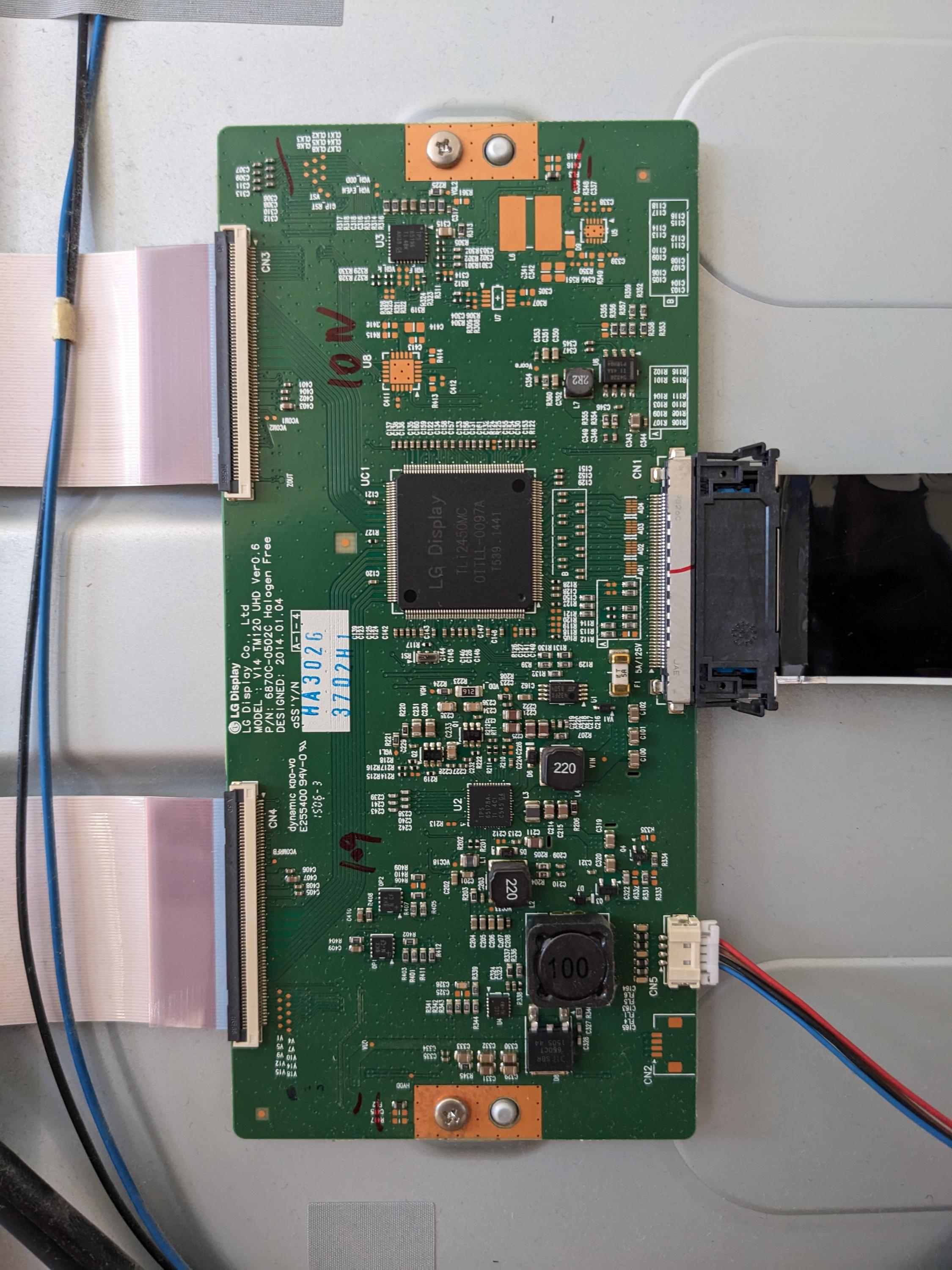

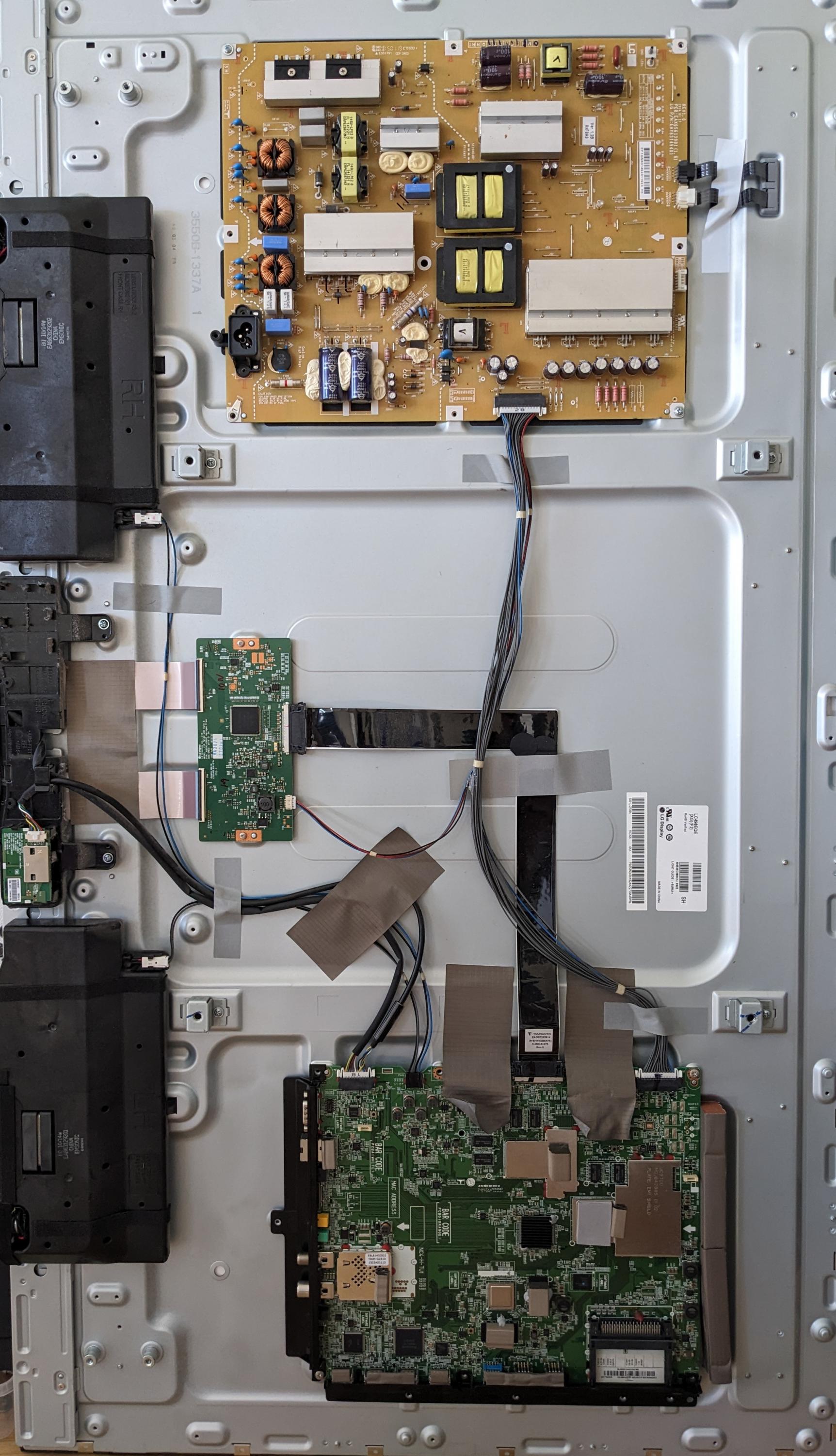

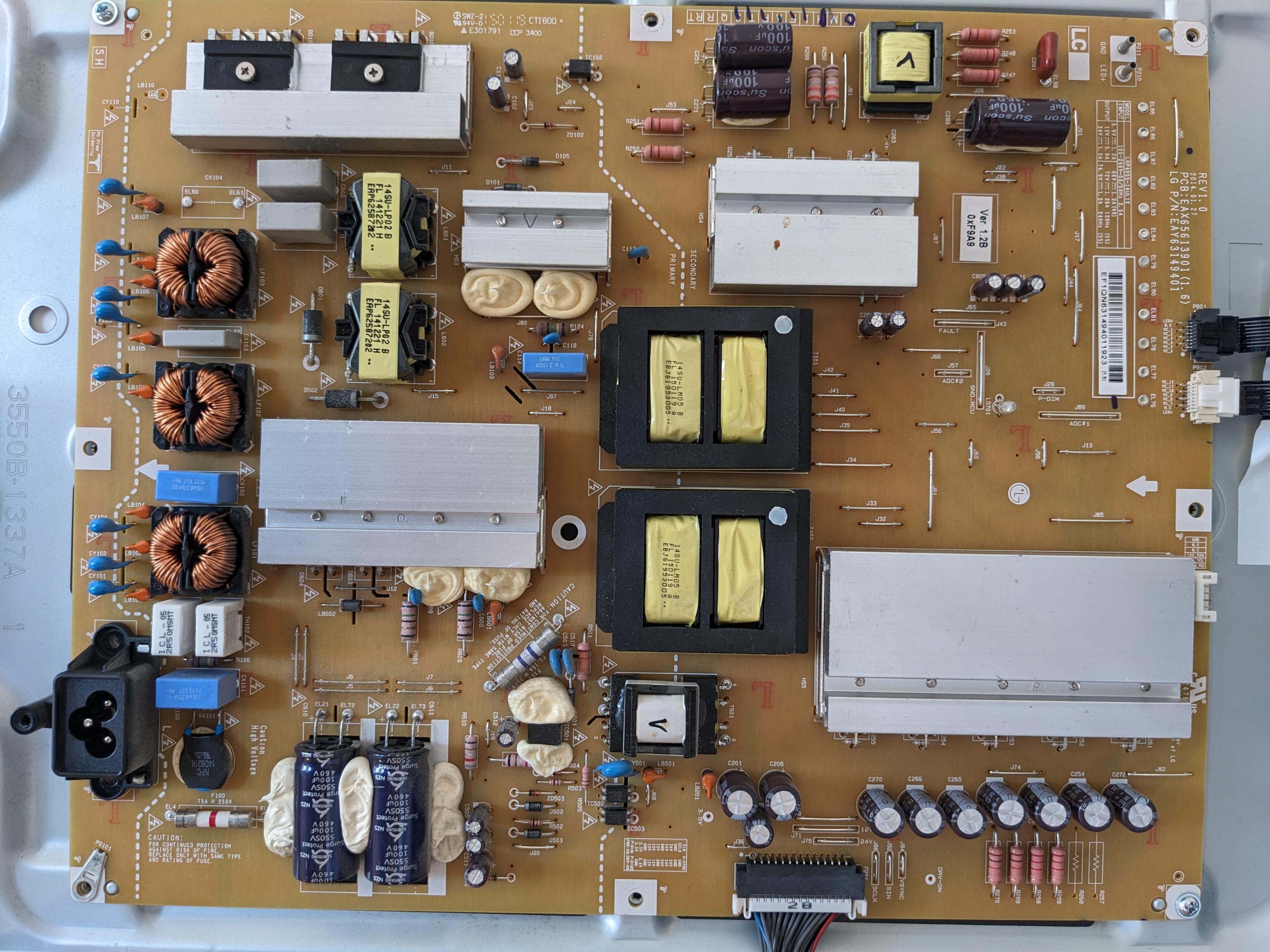

    Re: LG 49UB850V not switching on / standby LED off / LD701 blinks 5x
    Good focused straight on pictures of each board and one of the whole back as to see how everything is connected.
    • Seb932
      • Sep 2023
      • 23
      I've attached the requested pictures, hopefully sharpness & resolution is ok, otheriwse i need to use better camera.
        Easy things first, check over the solder joints on powerboard, reflow any that look suspicious, check all the resistors and diodes on top of the board, youtube is your friend for how to videos if needed, examples of bad solder joints there: https://www.google.com/search?client...h=599&dpr=1.09
