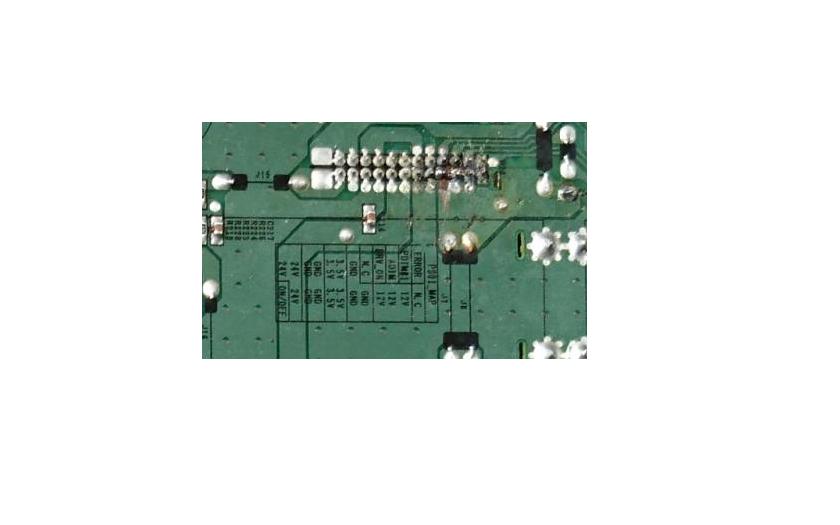

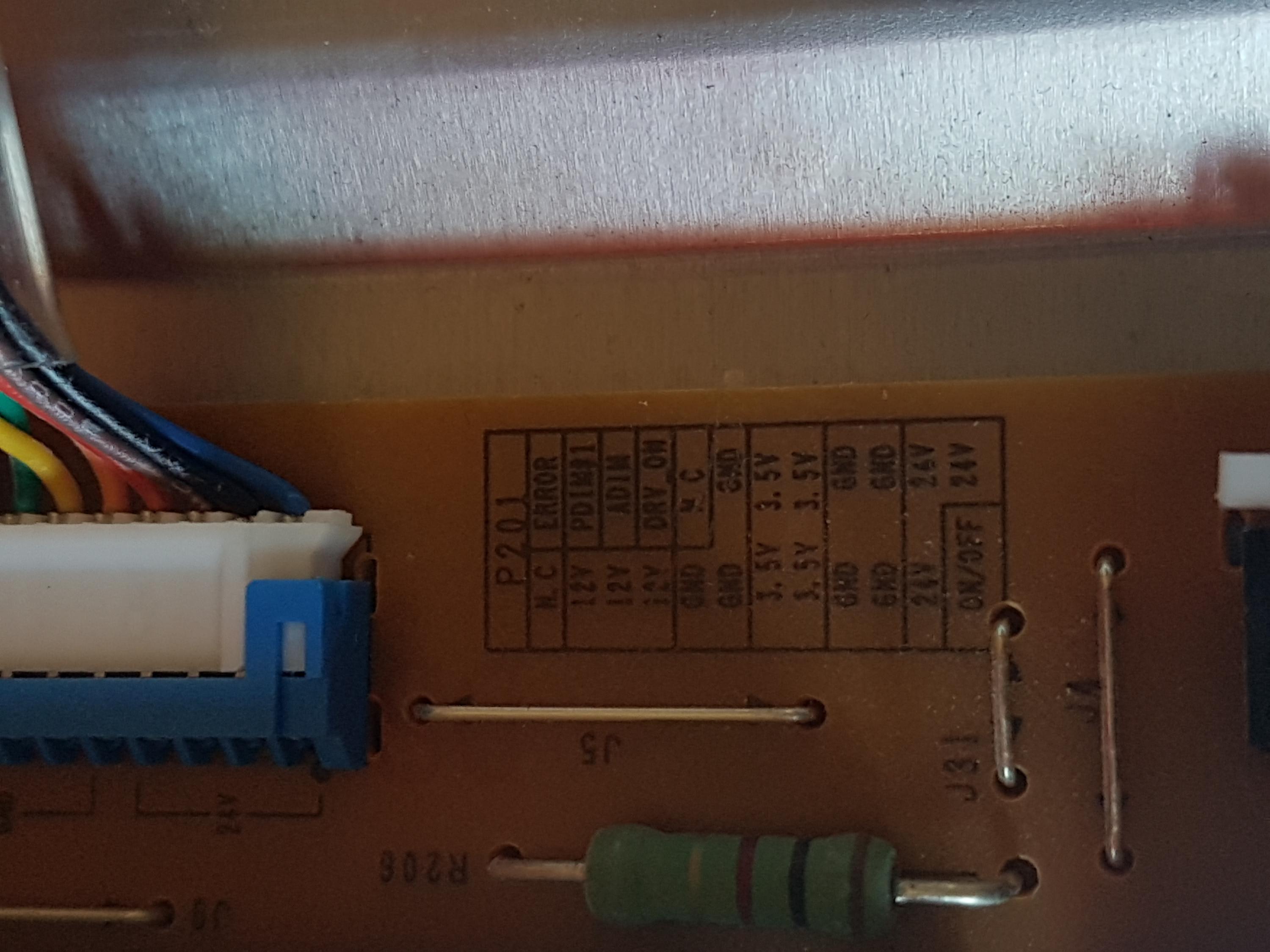

    But when the cable connecting the mainboard to the psu is connected at an angle like this "/" the backlights come on but there is still no picture! All voltages are correct from the power cable to mainboard except the second to last 24v which sparked when I tested it with my multimeter and has left a slight burn mark... I've posted a pic of the voltage chart and the damaged caused by multimeter on 24v point! Will post further pics soon! There is a thread about this TV but the advice was to resolder some points but I've done this and it hasn't helped!

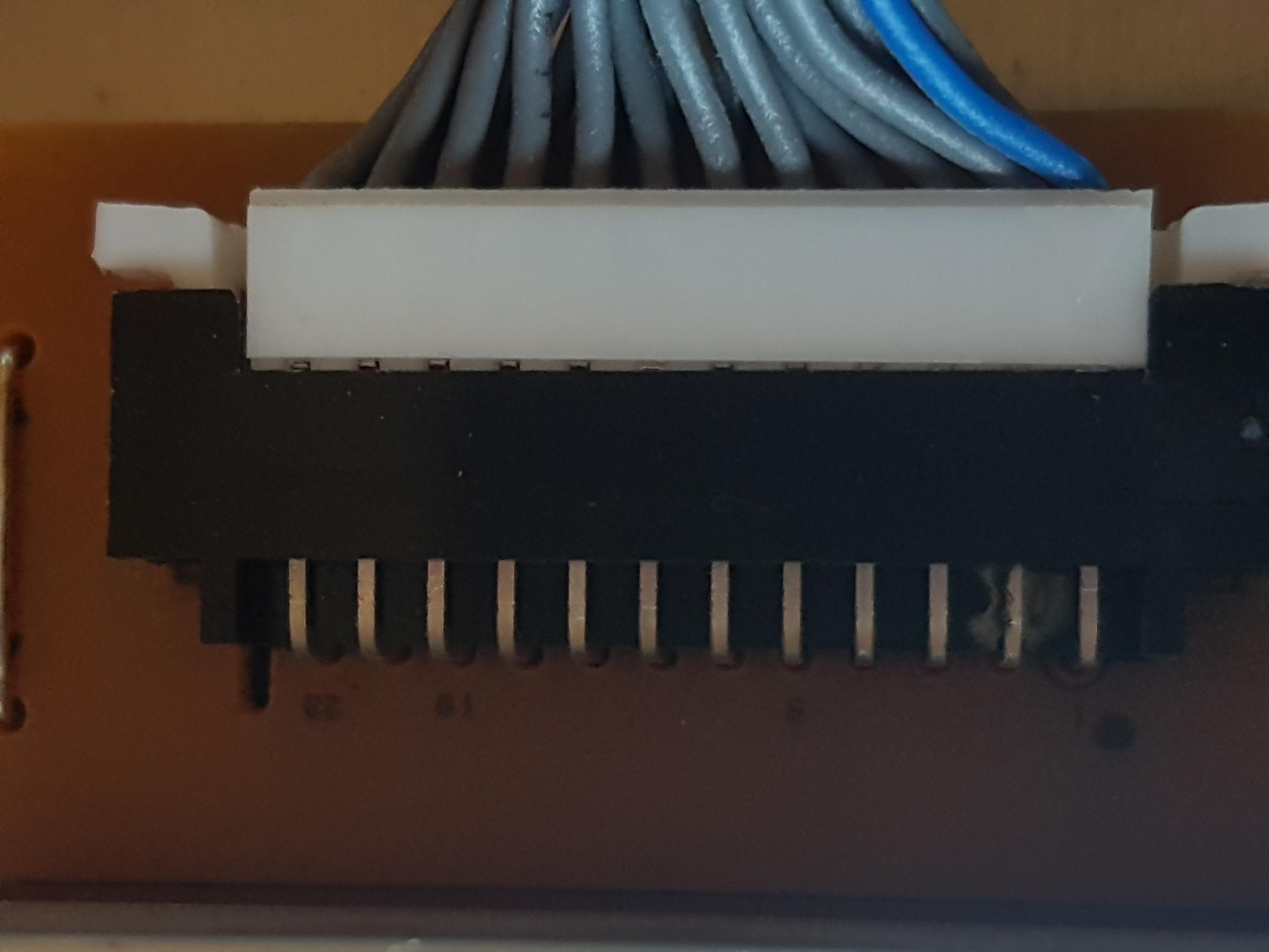

      Solder points look fine but I've resoldered anyway but makes no difference! Like I said the one of the 24v pins sparks when I test it with multimeter! I've attached a couple of photos to show you how the backlights come on when cable put in at a particular angle!

        So what Voltages do you have on all those pins of the connector per Voltage chart?
        Can we see the pictures of the bottom side of the board where the connector is?
        You have three 24V pins, so only one of the the 3 pin sparks?

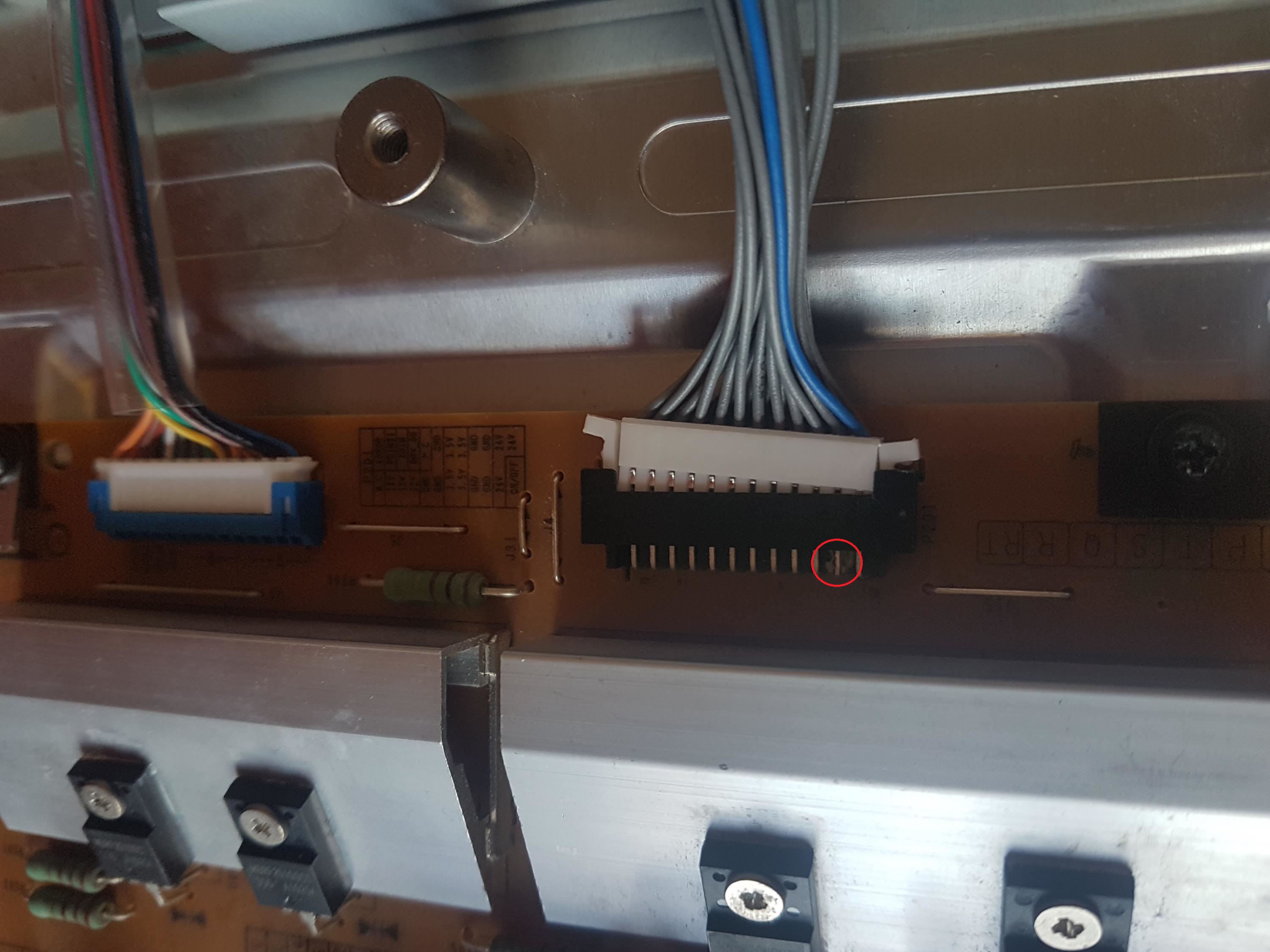

          I've put a circle around one of the pins which appears to have some staining on?
            I think he made that mark during testing, shorting that +24 volt pin to ground
            When that plug is at that angle you are removing the error signal from the led driver board

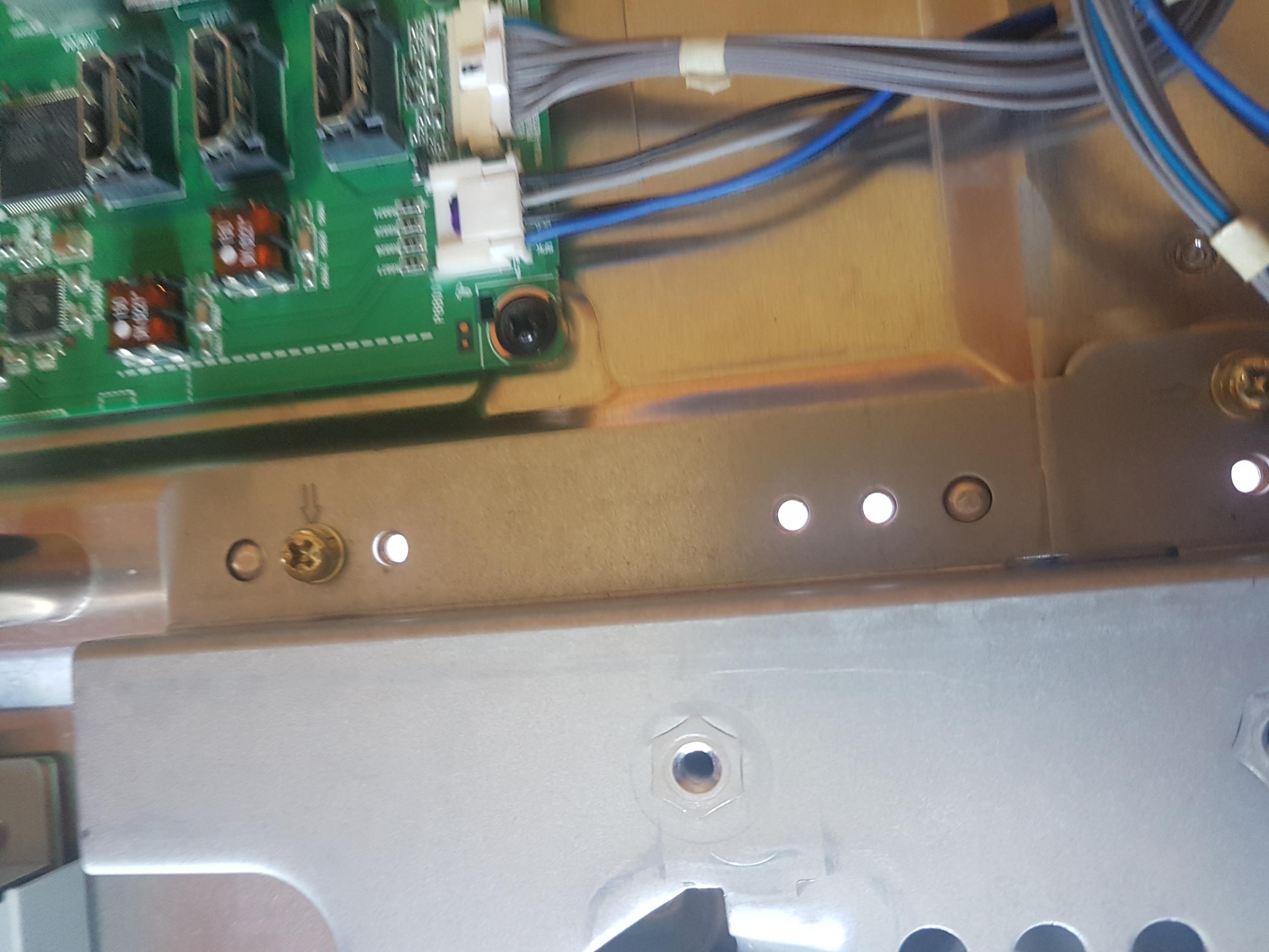

            You could also check if you have 12 volts on the t-con board fuse, the fuse seems to be just left of the lvds cable and marked [P]
              Yes I did! I think it might have been my fault! Here are the voltages
              1..NC ERROR = 0
              2.. PDIM=12
              3...ADIM=12
              4...DV_ON=12
              5... GND=0
              6...GND=0
              7... 3.5v=3.5v
              8....3.5v=3.5v
              9.....GND=0
              10. GND=0
              11...24V=24V
              12...ON/OFF=3V
              PIN 11 24 VAULT WAS THE ONE THAT SPARKED AND CAUSED THE MARK (USER ERROR I THINK) but is now reading 24v
              Cheers!
                OK will check tcon!

                  Re: LG 32le4900 issue
                  There are 2 rows of pins (24 total) on that plug that goes to the main board the pins you labeled 2,3 & 4 are just +12 volts, the PDIM, ADIM, DV_ON are on the other row
                  On 1..NC ERROR = 0, you are checking the NC (no connection) pin not the ERROR pin
