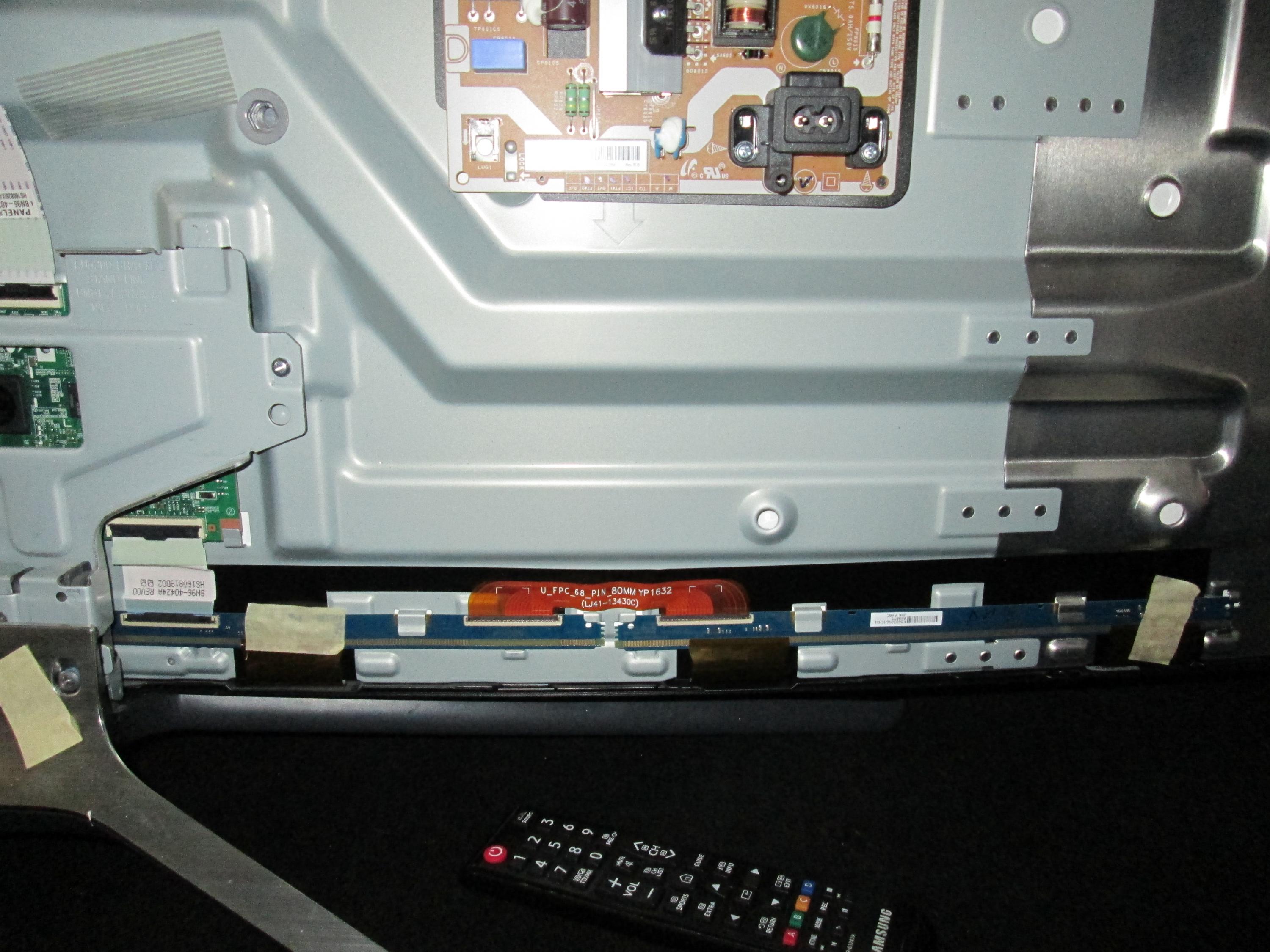

    Hi all I have a problem with a UE49k6300ak curve it has audio but no picture.
    BN41-02534B
    I have checked all voltages they seem to be present tv switches on backlights are on and when connected to a source has sound.
    I have replaced the T-con board to no avail, I am thinking the actual main board could be the problem.
    The main board is producing quite a lot of heat is it possible the main chip has lost contact with the board much like graphics cards.
    Also noticed that can't seem to put tv in standby by the power button only by remote.
    much appreciated for any advice.
    Thanks in advance

    Also the display can be faulty, disconnect one of both cables between the t-con and display . Connect the TV to the mains and see what picture you get, after that switch disconnect the other cable and connect the one you disconnected and see what picture you get.

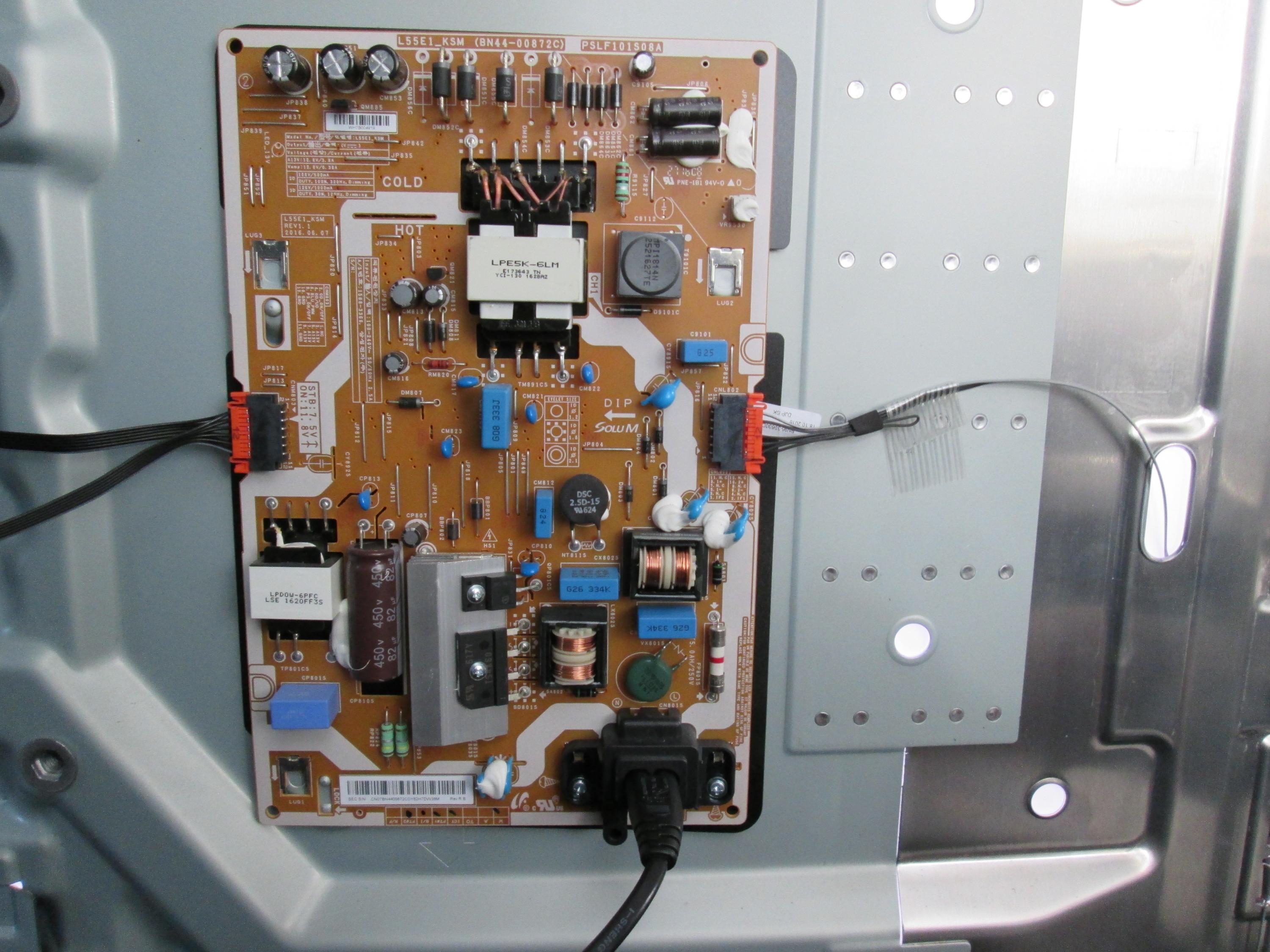

          Can you post pictures of your boards and also what voltage readings you have taken along with their designated pin number and names. Perhaps with that information someone may be able to offer further help.
          If it tripped your RCD then I would be suspecting a power supply fault.

            Hi here are the voltages from the PSU connector CNM803
            1 NC =0
            2 OD_ON/OFF =3.15V
            3 A13V =12.69V
            4 OD/UD =0.1V
            5 A13V =12.69V
            6 Blu_Pwm =3.29V
            7 A13V =12.69V
            8 Ps_ON/OFF = 3.29V
            9 A13V =12.69V
            10 GND
            11 GND
            12 GND
            STBY 7.5V = 9.3V
            ON 11.8V = 12.69V
            Whilst this Tv did trip my RCD it has now been stable however still no picture but has sound. And the tv/backlights will blink when changing inputs/channels and make the beeping noise.
            Any advice would be greatly appreciated

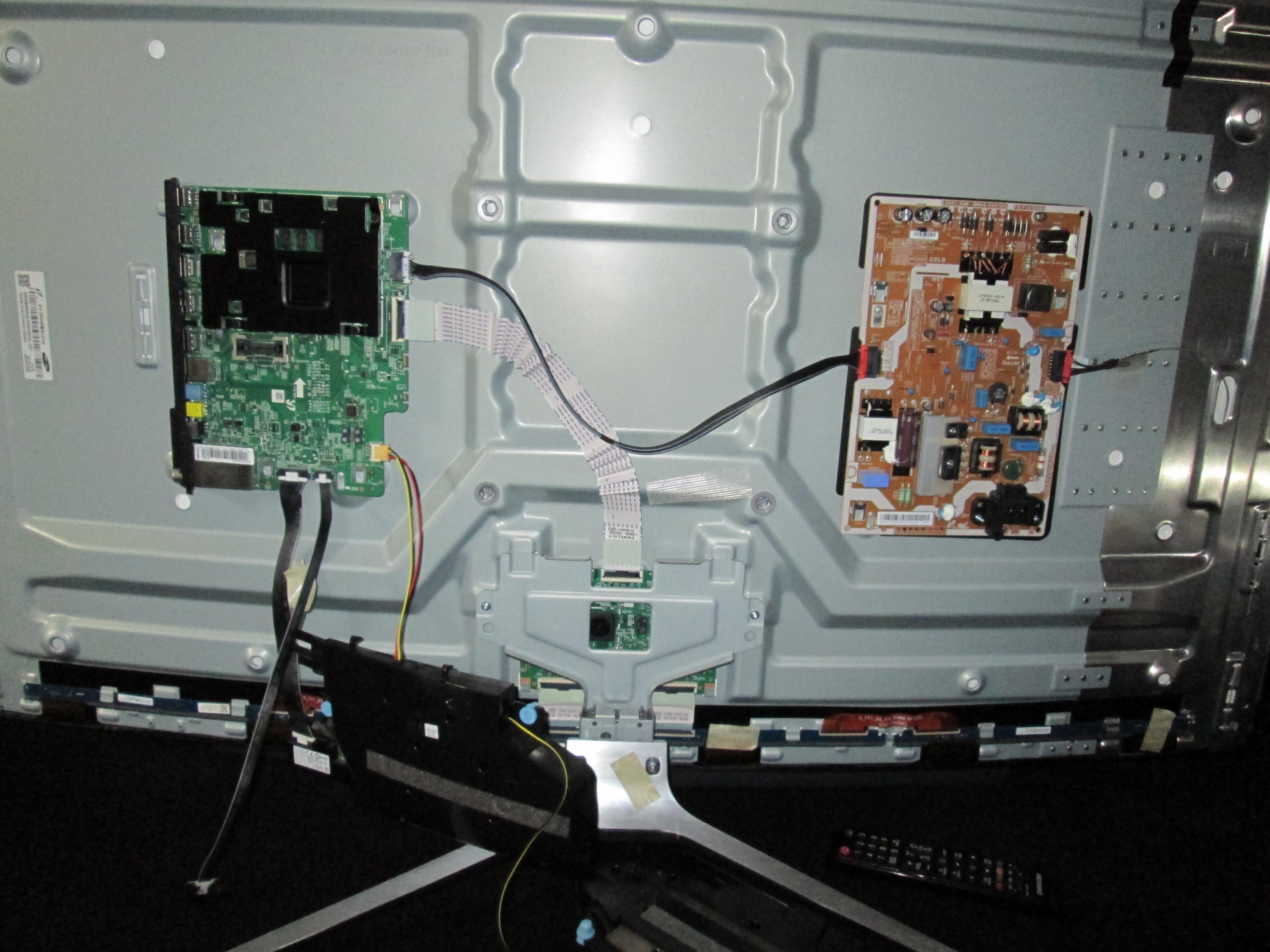

                      Can you post a photo showing how all the circuit boards connect to each other.

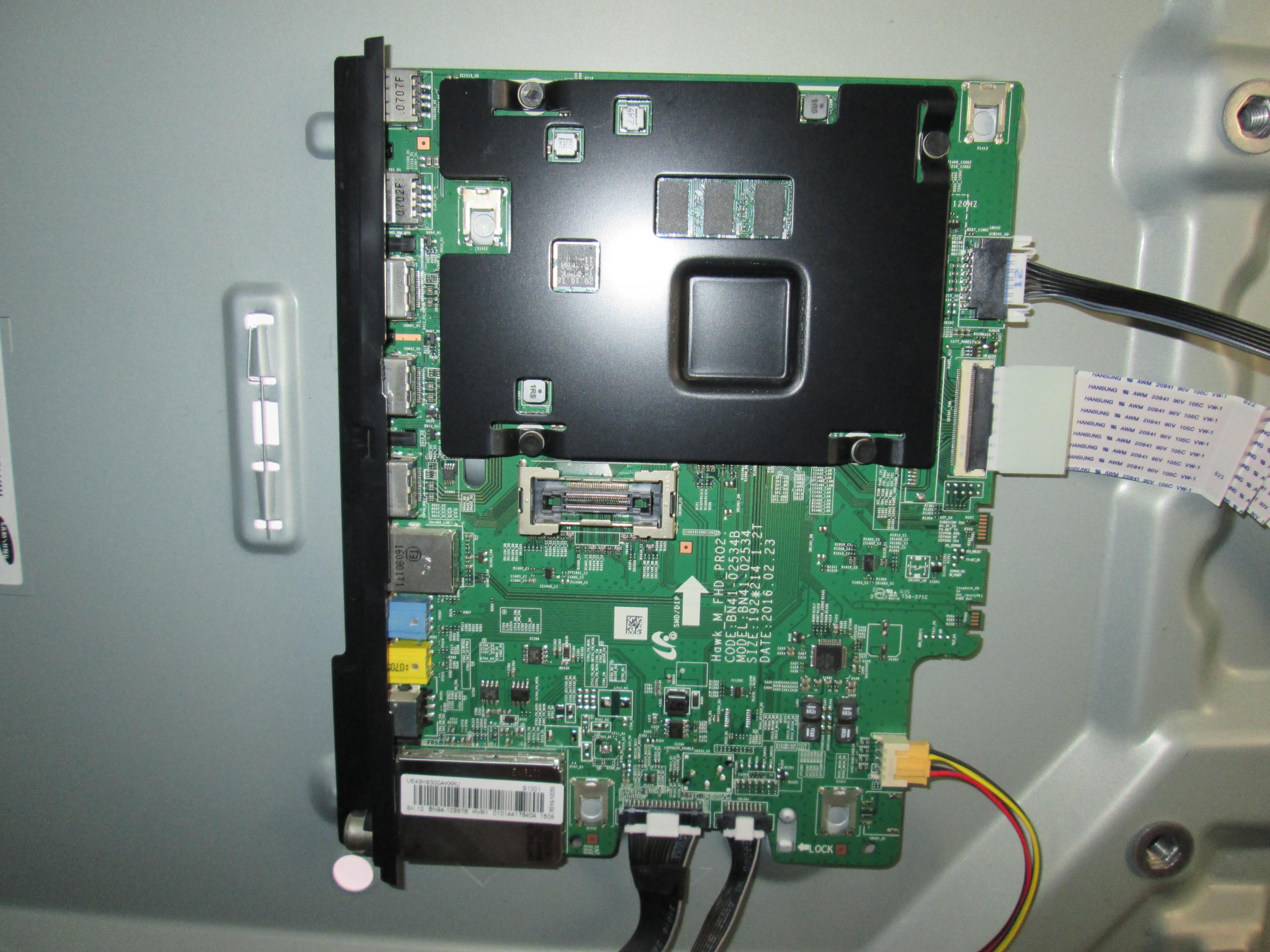

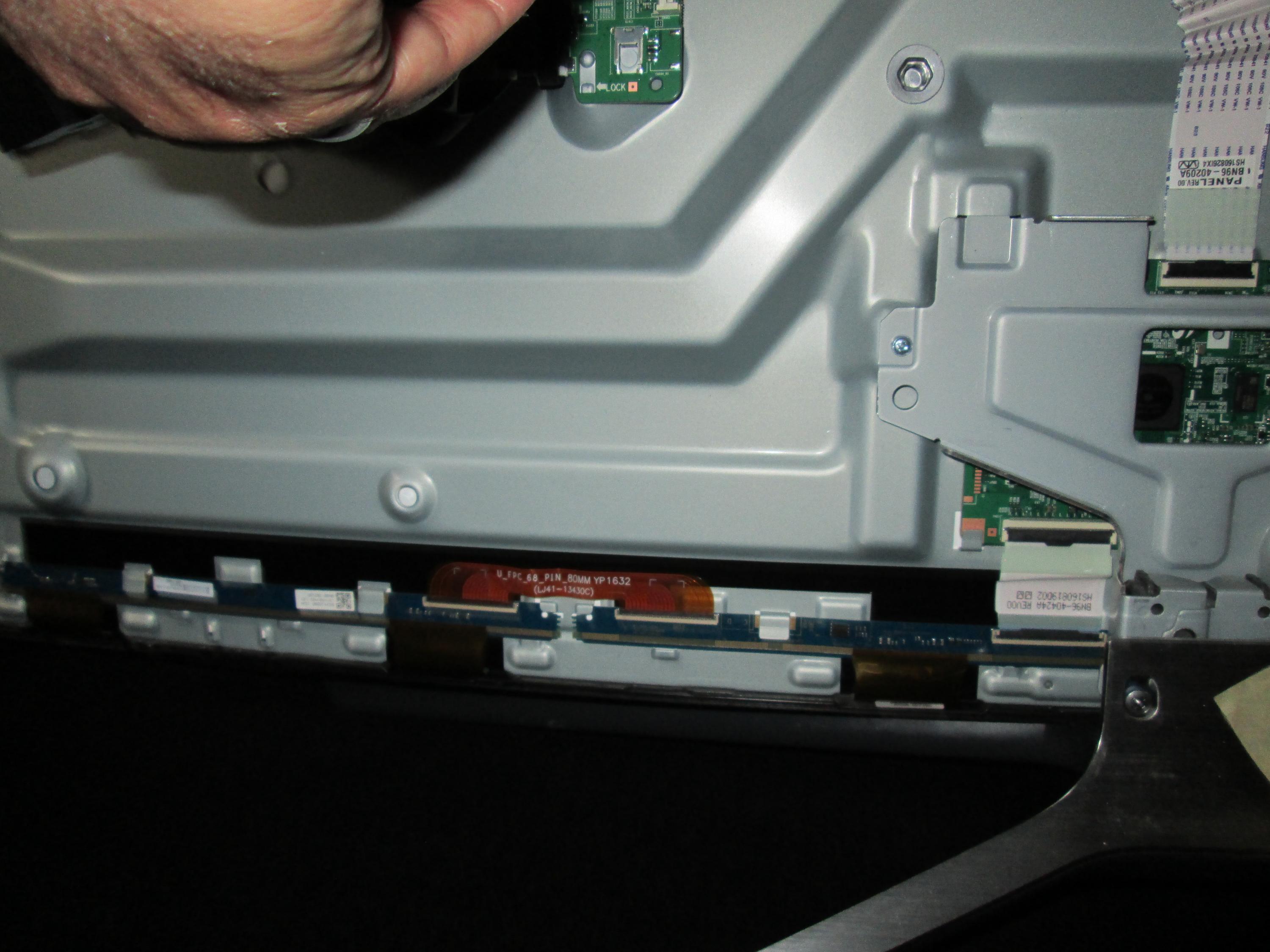

                        Re: Samsung ue49k6300ak
                        Hi yes here is a couple of photos not sure how clear they are:-
                        Also included pics of the panel boards which connect to T-con
                        thanks

                          Where does the thinner black cable from the mainboard go? Is it to an ethernet card. If so it may be worth disconnecting it and seeing if the picture will come up.
                            Hi yes already tried that its for the WIFI module, saw tampatec (you tube guy) had an issue with this on a different brand.
                            Did reset tv by the button config method but just hear the sound still no display.
                            Is there anyway to test the boards that connect to panel as I have tried the method of disconnecting these to see if either side produce half a picture still nothing.
                            Its getting to the point of throwing it (OH THE PAIN OF THOSE WORDS)

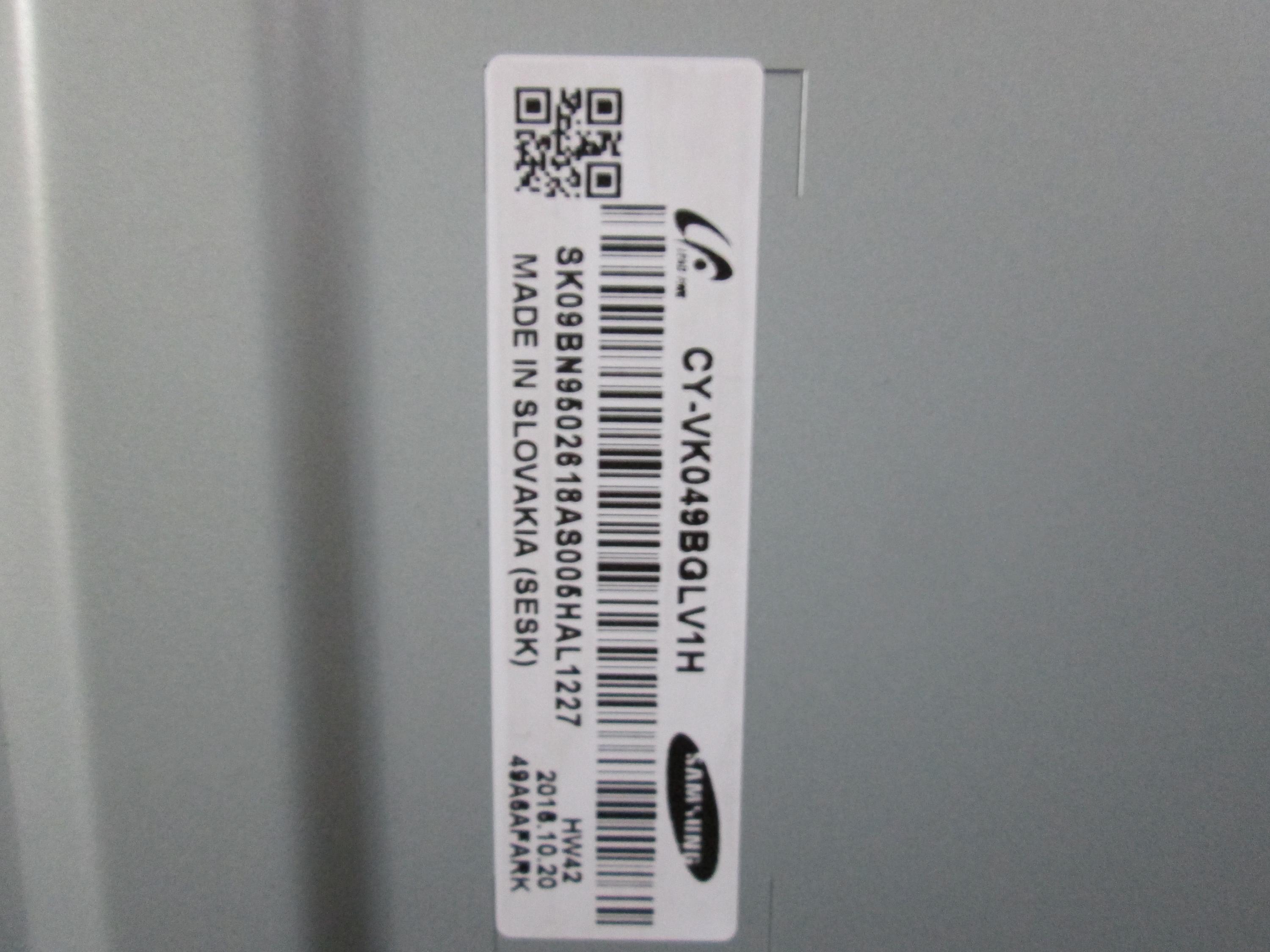

                              What is the panel number as given on the sticker. Are you 100% certain that the backlights are on and can be seen from the rear of the lcd panel? Do you have full control with the remote ie volume up/down, change source, power on/off?

                                The symptoms I have read here are Backlights ON, Audio ON, Dark screen. Main Bd and T-CON Bd was replaced with hopefully working boards. then this points to a bad Panel. Did you try removing one side of the FFC from T-CON Bd to Panel and then the other side to see if there was any picture at all??

                                  Hi guys yes 100% all backlights are on just displays a lit black screen if this makes any sense.
                                  With regards to testing the panel boards I have tried this, disconnecting each side individually made no difference.
                                  And on some of the threads on this forum people tried this method and had some good results however not in my case.
                                  Not sure if it is the actual panel or something silly like SMD ic on the panel boards.
                                  To think this TV was working fine then tripped my electrics and on switching everything back on tv did this.
                                  Thanks for the input looks like a trip to the dump is on the cards

                                    you should try checking smd components on the edge boards near where the tcon to panel / edge boards are connected. Further, at the edge boards, there should be some places where voltages are coming from the tcon (15v or so depending on the panel).... see if you can find such voltage.
                                    further, although most panels display a white screen when the cables are disconnected, some don't as designed. However, those that do... if there is a significant panel / cabling issue at the lower tabs, there are large black areas in cases that I have seen. This to me indicates that the panel is seeing voltage (ie. charge) but no path (thru resistance / capacitance) to "bleeding off" hence the panel section remains black.

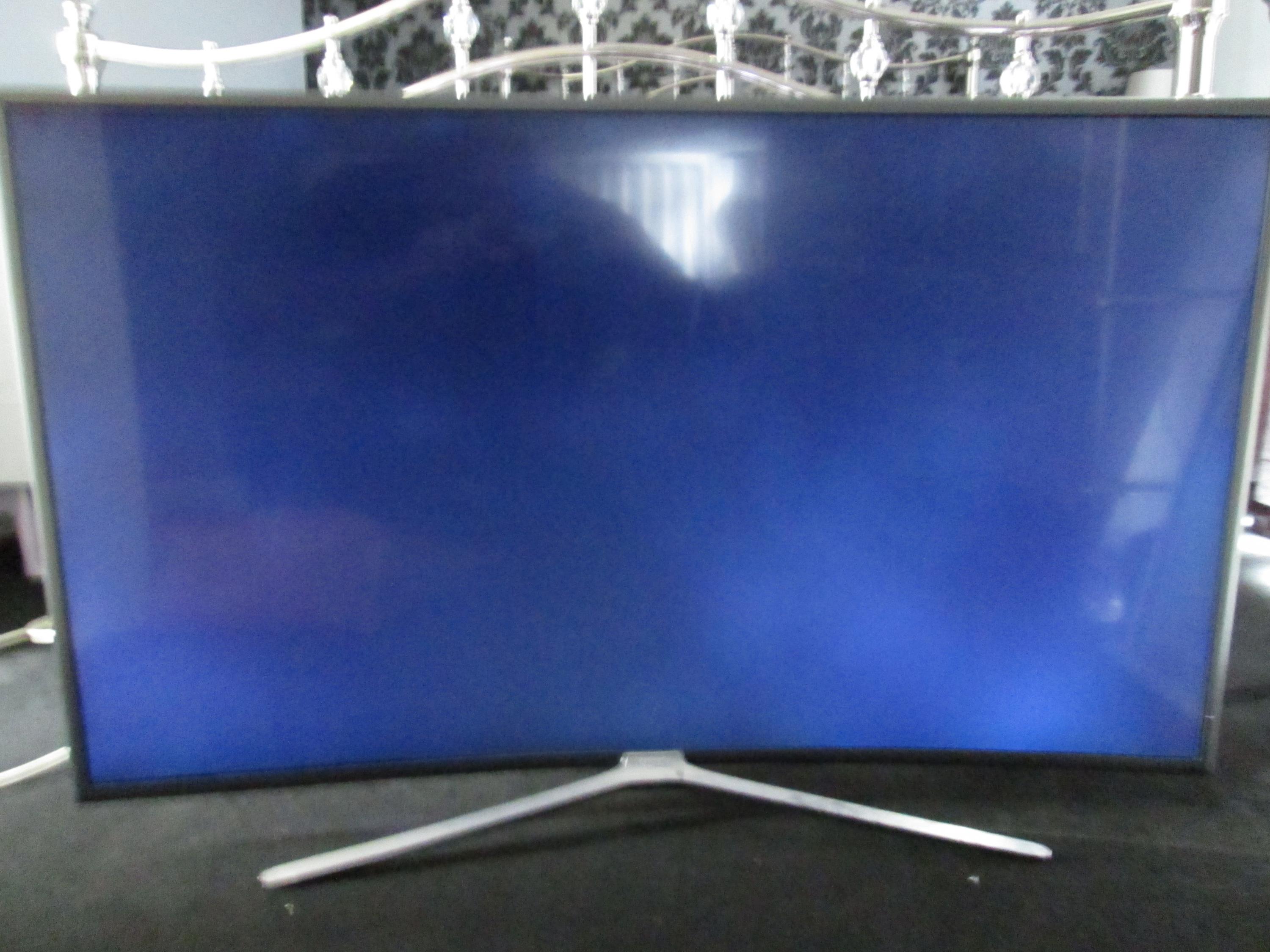

                                      Hi guys well I have put back together at mo as misses giving me stick over having it apart in our bedroom oh dear.
                                      I have post a pic of the actual screen when on looks a lot like backlight bleed has a blue washed out look thanks for your help

                                        did you check the fuse / any fuses on the tcon? (on both boards) I guess since the tv is "canned back up", your testing will be limited. You likely need to check for voltages at the edge boards to see if they are getting there. There are some smd components in around those areas that you should check with a meter to see if they are OK.
                                        Lastly, you checked voltages at PSB but did you also check voltages at the main board to see if they made it there and further that they appear at some of the points in the card.
