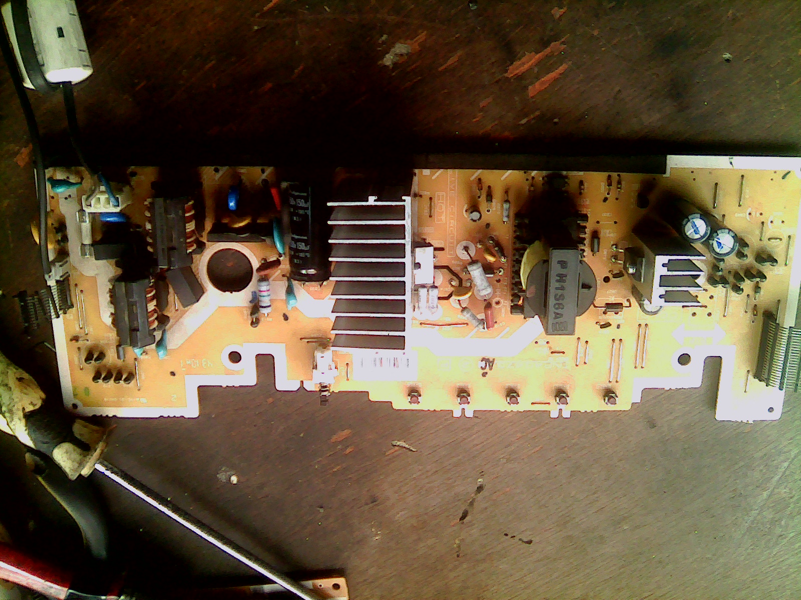

    Hello friends, i have panasonic th-l32c22m dead, no red light nothing i need help, schematic if possible please

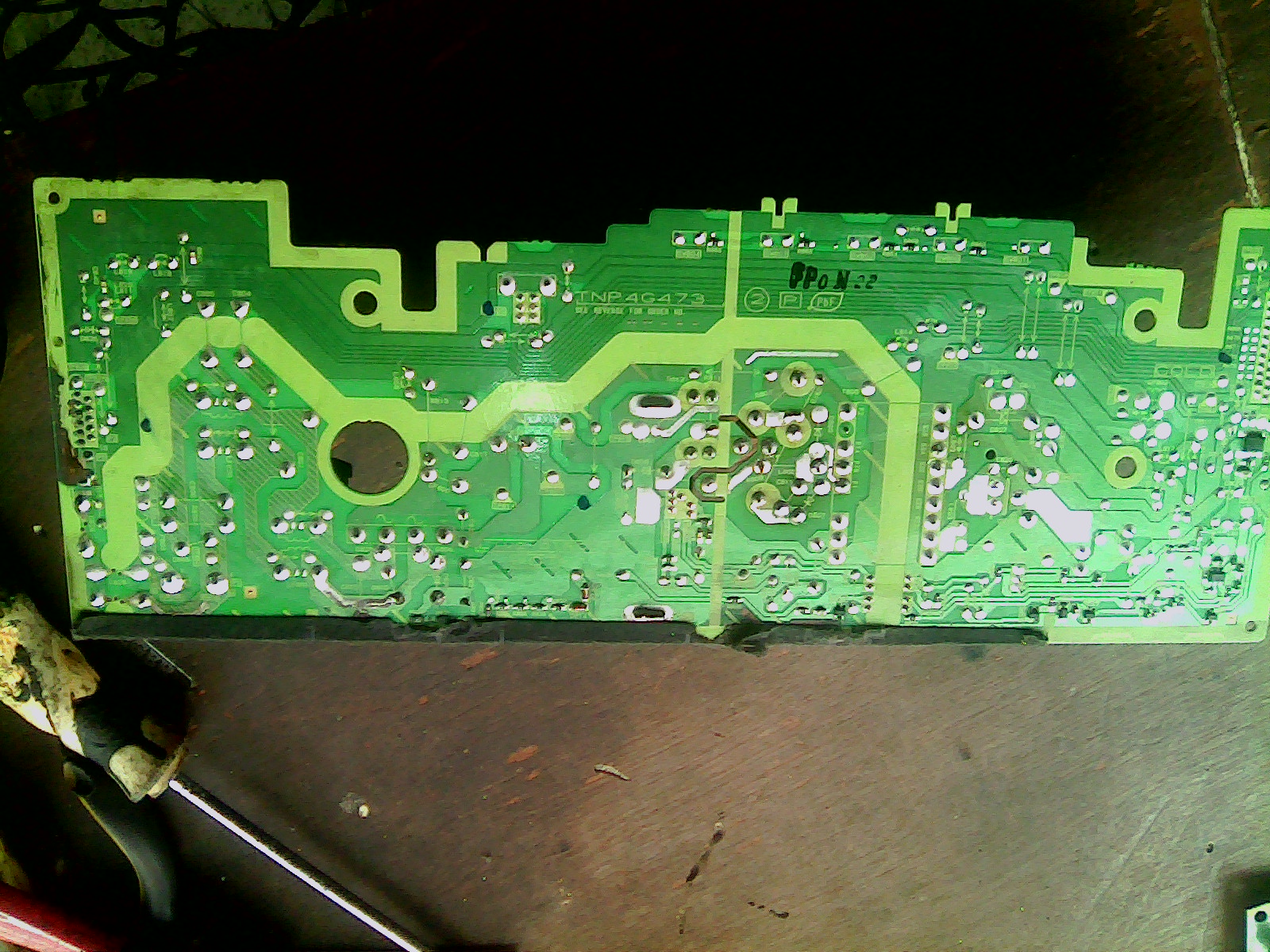

    Re: Panasonic viera th-l32c22m
    here is the picture of the panasonic tv
        Can you post better pictures of the power supply.
        Have you checked the On/Off switch is working OK and what voltage if any do you have across the two legs of the large capacitor.
        What voltage rating is given on that capacitor.
          yes the power swich is ok, i get over 300v from the big cap,
              Over 300V does not help much. What is the actual voltage? Do you have StdBy voltage?
                And what voltage is written on the capacitor?
                  What is the P/N of that SMPS IC mounted on the heatsink in the hot side?
                  Since no PFC so he is probably getting around 330VDC.
                  There is small lytic startup/running cap in the hot that shoud be checked or just replaced it.
                  The rectifier diodes on the cold side all tested good?

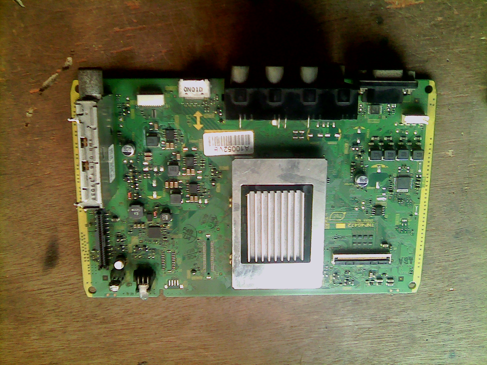

                    Andrew, the tv is LCD not LED , it looks like crt by shape
                    You mean CCFL backlight? There's no such thing as an "LED TV" unless it's an OLED. LCDs are all backlit and later LCDs have an LED backlight array in place of CCFLs, because of people freaking out about mercury, LOL.
                    The red-power-light Viera LCD TV, does sound like something pre-2012, if not pre-2011 or pre-2010. You can tell it's that period, if you see a mercury warning on the back. I have an October, 2010-built Viera TC-L42U22 that was given to me, the only problem, seems to be some image retention.
                    It looks like you haven't showed us the boards for the backlight. If it's CCFL-based, there will be inverter transformers and often little blue things, which I believe are KV caps for the CCFLs.
