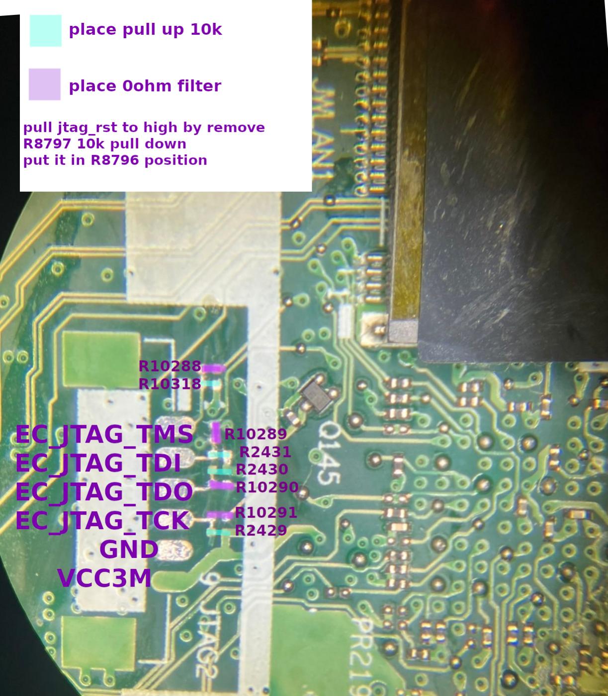

                          jtag pinout guide here from studying schematic and probing around board. the jtag is covered by silkscreen and under the WWAN card on front (side with cpu) of board jtag reset JTAG_RST pull up/pull down located near EC check silkscreen to see where. Hope this helps

                            Re: Required t480 nm-b501 schematic
                            Thanks alot!
