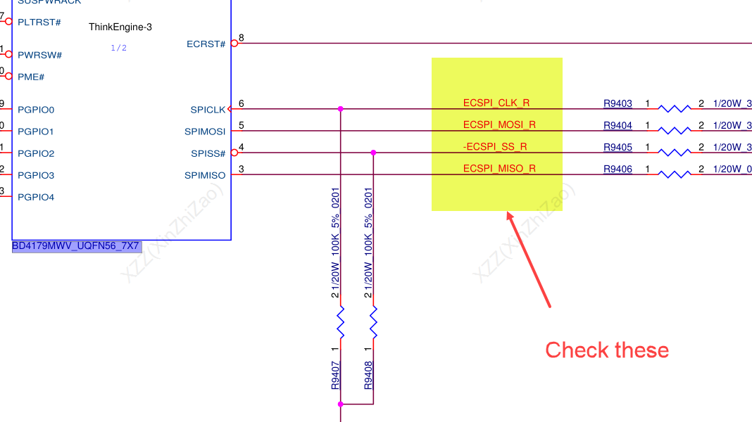

    What is the history of this machine? BD4179MWV has SPI lines linked to the EC -> check them for a voltage. Also check the SPI lines without power, in DIODE mode. This is to confirm the lines are not damaged and that this ASIC is able to extract the required firmware from the EC (or does it supply it to the EC - not sure?). On SPI, there will always be a bus master.

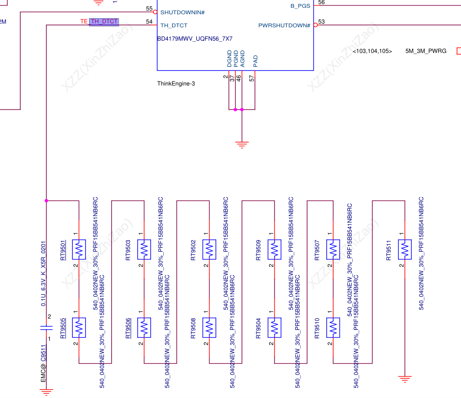

      Thank you sir for your help, this board came dead and clean, sir on R9512 pin 2 I have 3.3v and 0v on pin one, the 33k resistor R9512 is fine, sir what SPI signals should I check thank you , I compared it with a normal board which is suspicious is pin 54 TH_DTCT 3.3v on a normal board the measurement is 0.5v, thank you sir for your interest in helping me

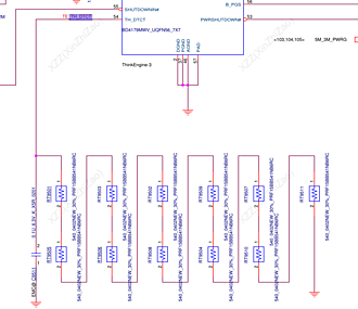

        TH_DTCT may be 'thermal detect' signal but is only a guess.
        Update - guess is correct - this line is connected to thermistors on the board.

        Click image for larger version  Name:	SPI_lines.png Views:	0 Size:	74.5 KB ID:	3261461

          Check this thermal sensor line in DIODE mode. Remove all power. Meter in DIODE mode. Red meter probe to ground. Black onto this pin on the IC. What is the measurement?
          Compare to the known good board. You may have a defective thermal sensor. Perhaps you can rig it by grounding this line for a quick test.

            Sir, my normal board measurement results are 718, the dead board is 718, the results are the same, thank you
            • fredyjbi
              • Feb 2021
              • 144
              • malaysia
              Sir, if I try to measure TH_DTCT avometer scale resistor black probe groud red probe pin 54 TH_DTCT the results are different, the normal board shows 6.6k and the dead board shows 3.4m, thank you
