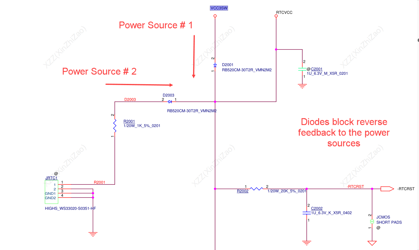

    Remove all power. Meter in resistance mode (not diode). Measure the resistance to ground of VCC3SW.

      Thank you sir for your help, sir, is it true that the source of the VCC3SW is the CMOS battery
      VCC3SW. meter auto range resistace 550k

        See attached. I believe that VCC3SW is created by an internal LDO regulator inside of UTE1B.
        The arrows show the direction of the power path. Diodes are oriented to stop a reverse feed to the source(s).

          sir, that means if the resistance of VCC3SW is 600k, then I replaced UTE1B because it didn't produce LDO, thank you

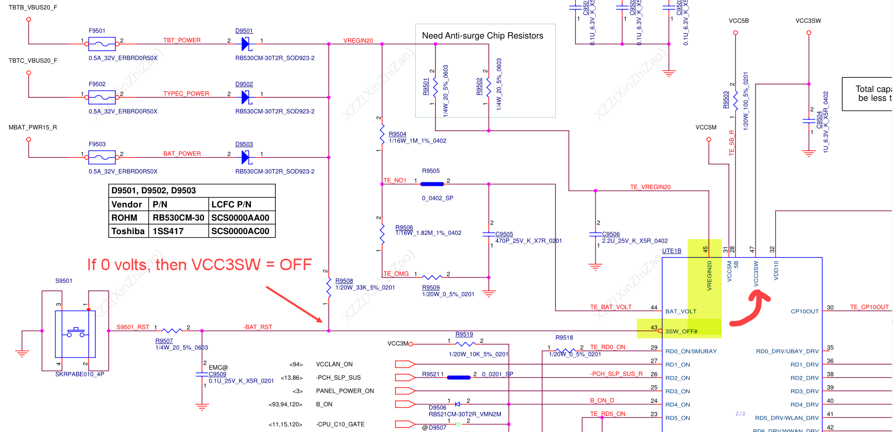

              The resistance to ground of VCC3SW is ok. It is not shorted. For now, we do not know if UTE1B is defective or not. From my understanding, if pin # 45 has a voltage from the external power source and pin # 43 (3SW_OFF#) is a logic HIGH, then VCC3SW should enable.
              Pin # 43 (3SW_OFF#) of this IC is the enable pin for this missing power rail. What is the voltage to ground on pin # 43 ?
              This pin label has a suffix (ending) of '#'. This means if this signal is logic LOW (0 volts for example) then the VCC3SW pin will be OFF. That is, this is an 'active LOW' signal to turn the rail OFF.

                sorry for the delay in replying sir, because I am in Asia, sir I checked Pin # 43 (3SW_OFF#) 19v and pin VREGIN20 20v, can it be confirmed that the UTE1B IC is damaged, thank you

                  sir, I just replaced the UTE1B chip, now VCC3SW is ok 3.3v but PQ0008 pin1 0v lost voltage -PWRSHUTDOWN, R9512 pin 2 3.3v pin 1 0v, the measured resistor is fine 33k even I also tried replacing R9512 the result is still the same -PWRSHUTDOWN 0v, thank you love

                    Is the UTE1B a known good part? Not sure if the device requires a pre-flashed firmware to operate correctly. Or is the firmware applied through a bios update? Was it removed from a donor board?
                    Also, what is the voltage to ground of SHUTDOWN (R9515) ?

                      Sir, I tried to replace the UTE1B from a donor with the same board series, it turns on normally, only the camera has a problem, SHUTDOWN (R9515) 3.3v, I have several of these boards with the same problem, thank you very much sir for your interest in helping me
