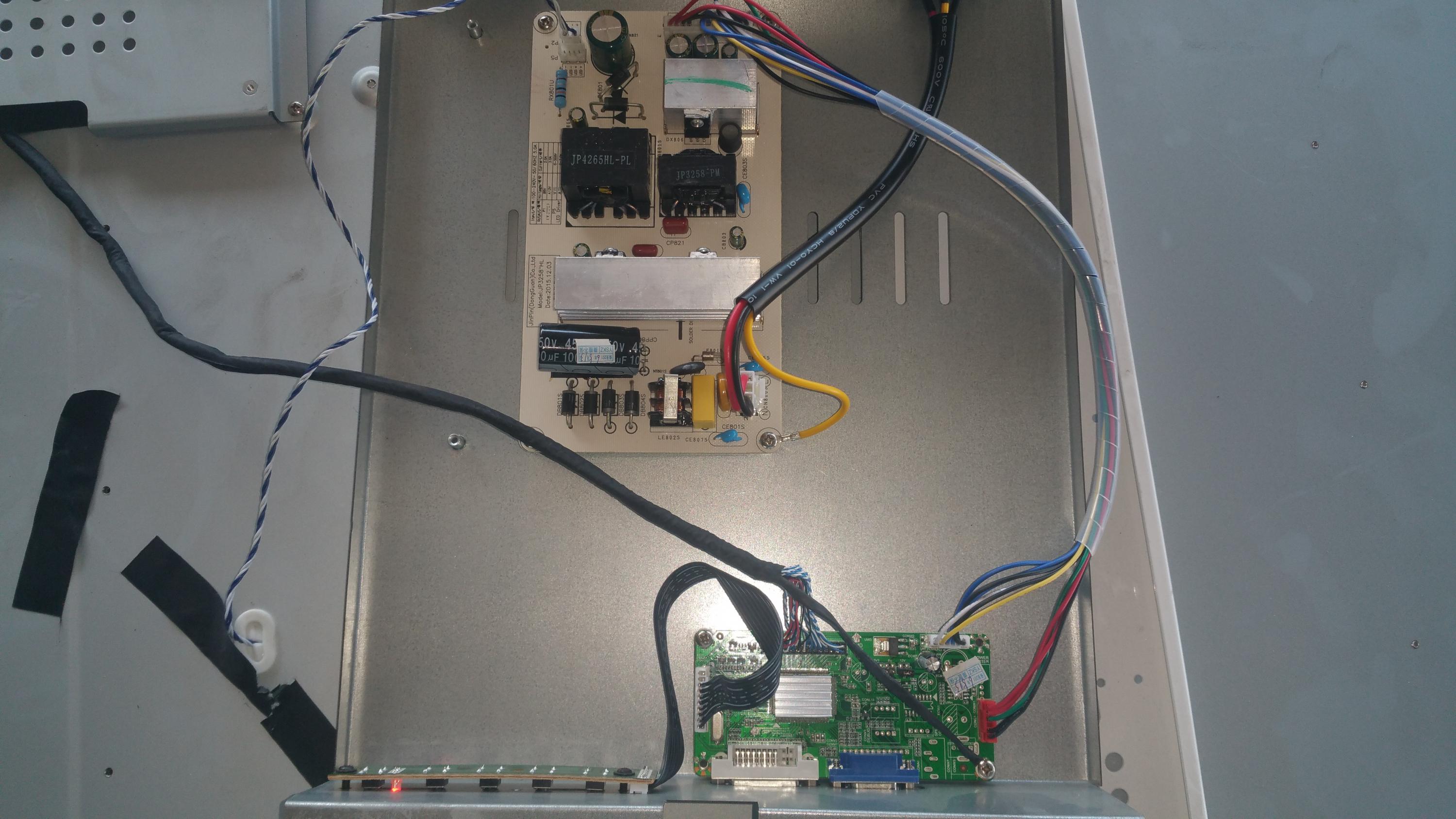

    Got a weird one in..
    It's a custome built 55" LED Monitor.. Just has DB15 and DVI hookups..
    I push the power button and the LED Power Light goes GREEN, then RED after a few seconds.. After a min or so, the Power LED starts blinking red...

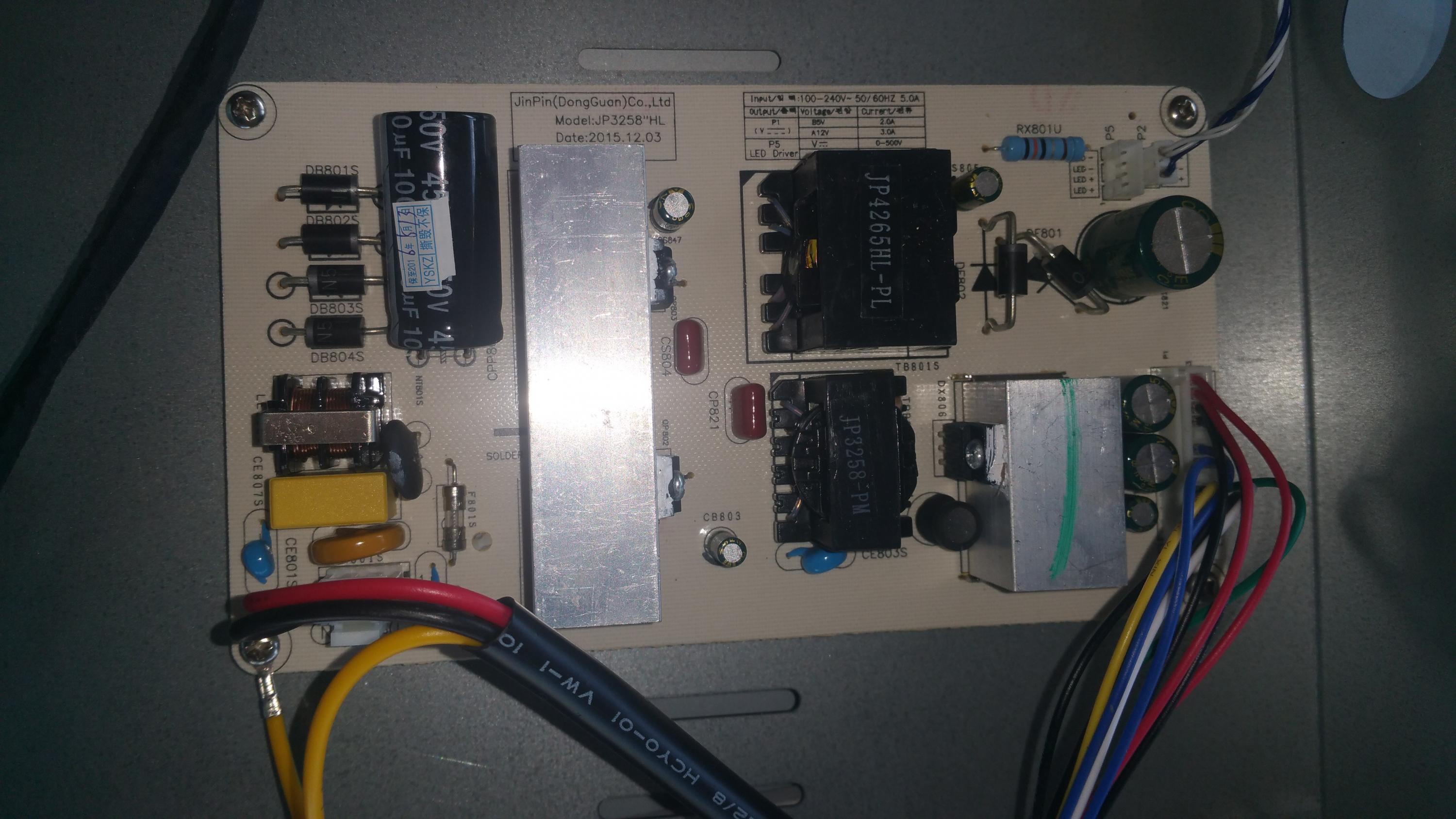

    There were some loose pads on the TRACE side of the Power PCB. I fixed those and still have the same problem..
    All the other components on the Power PCB and the "Main" video board look OK..
    Voltages look OK.. I get around 175V steady on the LED connector
    At this point, I am leaning towards a bad LED Strip, but I want to exhaust all other possibilities before I break it down that far...

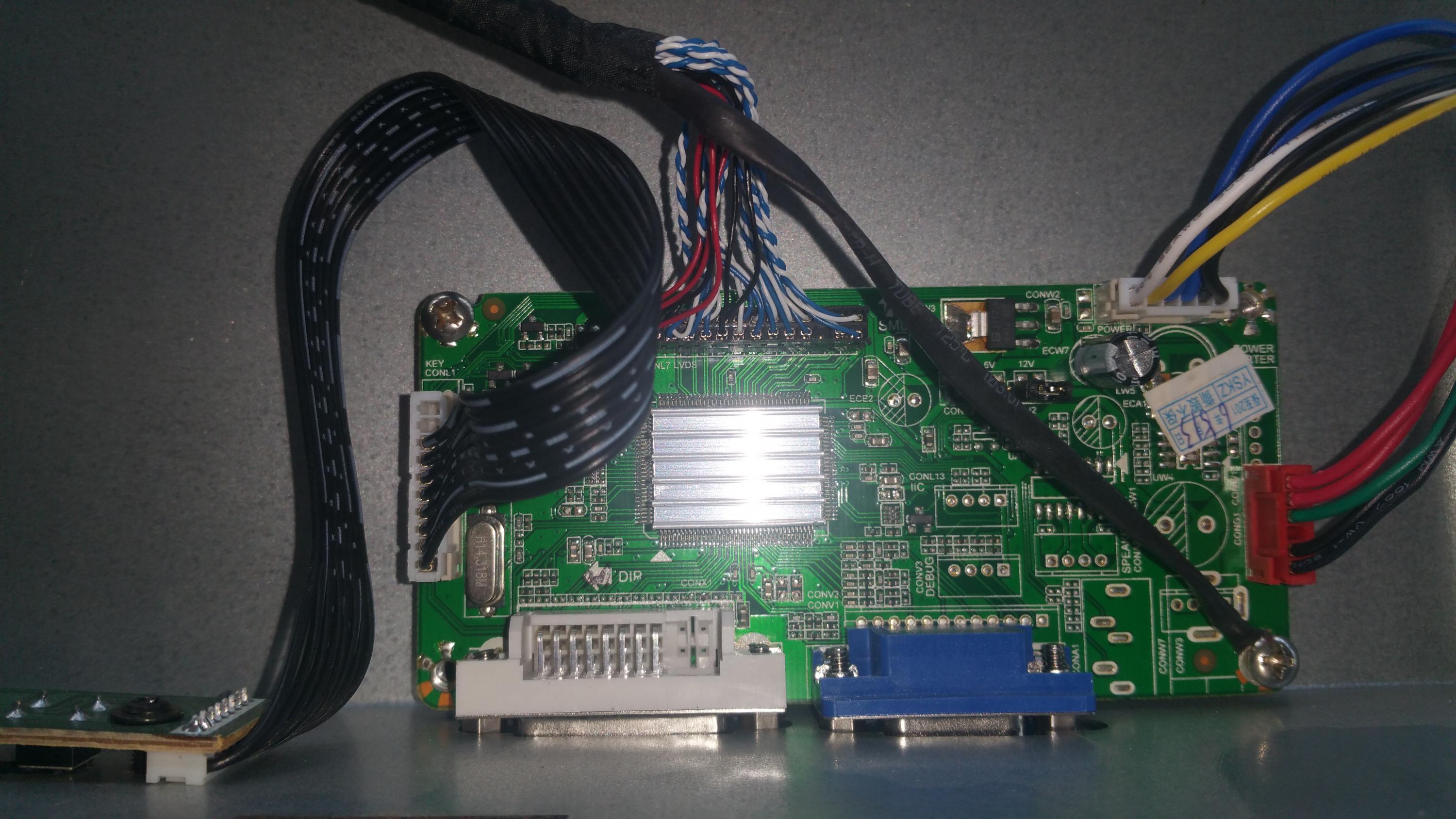

    It gives the led driver voltage on the board but I can't read it. Have you applied a signal. Some computer monitors turn off if no signal present.

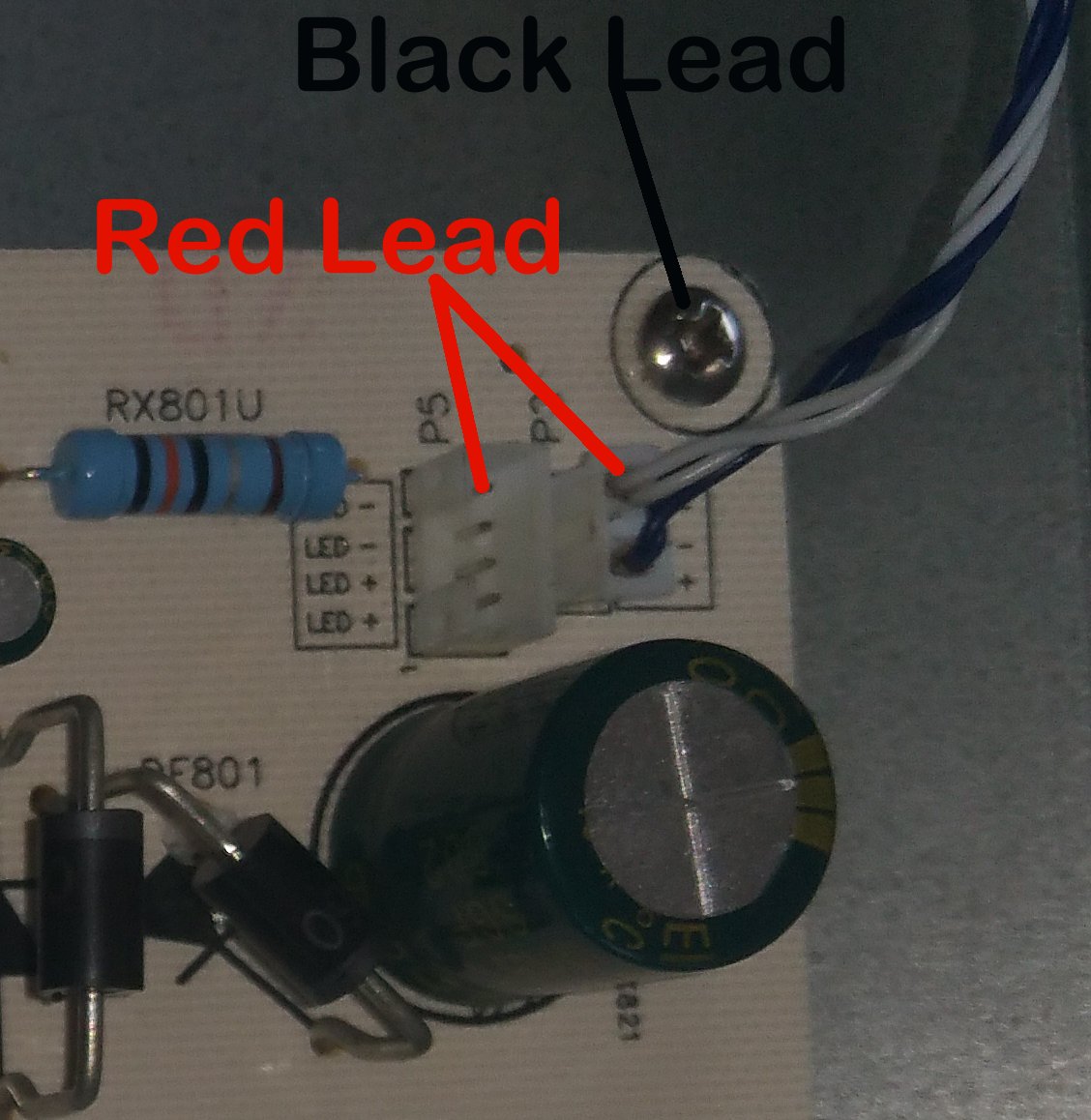

      The Backlight LED strips seem to be connected in parallel and what you are seeing is perhaps an open string . Measure WRT GND the -ve pin voltage as you said you have 175V on the +ve pin.
        These help???
        ACK!!!! Good point!!!!
        Lemme do that..

          If you have 175 volts across the led leads going to the panel the led's should light up unless the circuit is open, open led or open connection on a plug etc.

            OK It does appear the be the backlight issue.. The LED Power light goes green and I can see a latent image on the screen from a laptop...
            Andrew, can you simplify the WRT GND -ve thing??? Am a little slow this morning.

              WRT GND.....With Respect To Ground....The RED lead on the -ve pin and the BLACK lead to chassis ground.....to check if you have return voltage to the Driver....NP (No Problem)

                0v or, more accurately, .003mV
